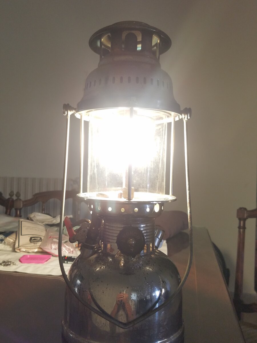

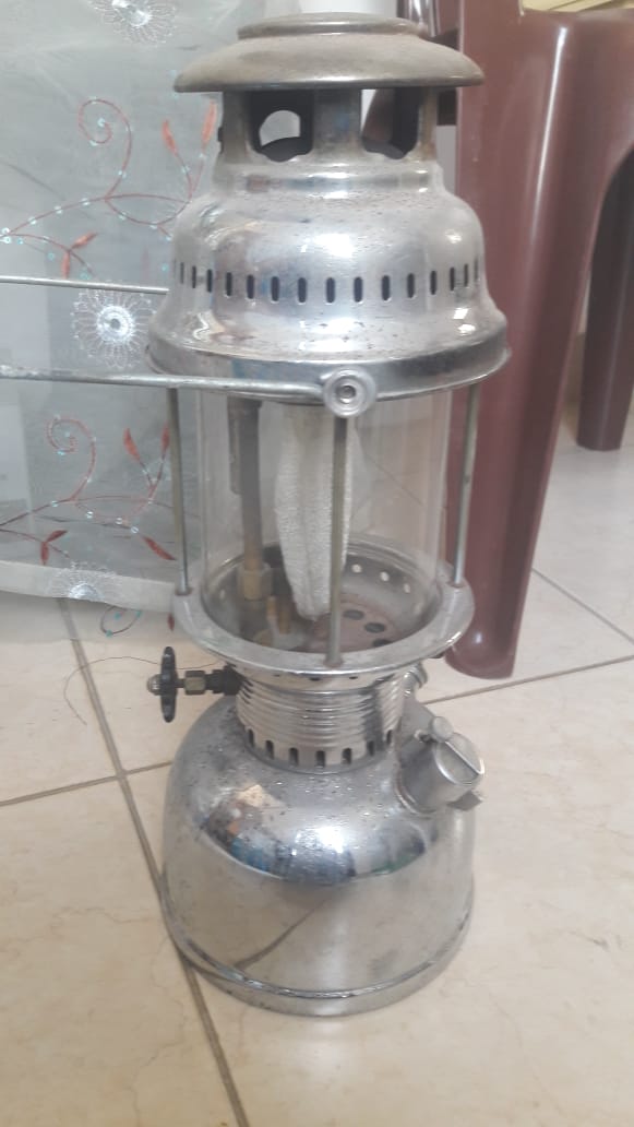

    In the nine pictures, the second, third and fourth are the taken for the same lantern which is closest to or probably the Petromax with possibly some parts missing or swapped. However, all nine do not show the original Petromax hood.
    The first and fifth pictures are the same, showing the another lantern which, is probably a Light brand with the original globe but the red pump knob could be something else. Light brand usually have green pump knobs.
    Pictures number six and nine (possibly also Light Brand) are the same lantern, without a globe.
    Pictures number seven and eight are taken for the same lantern(possibly a variation of the Anchor brand) with pump spring wrongly installed.
    At most, there are only four different lanterns, not nine.
    Nevertheless, you can buy them all if the price is not objectionable. Its quite common in many places around the World for people to simply refer them as Petromax although they are entirely different brands.

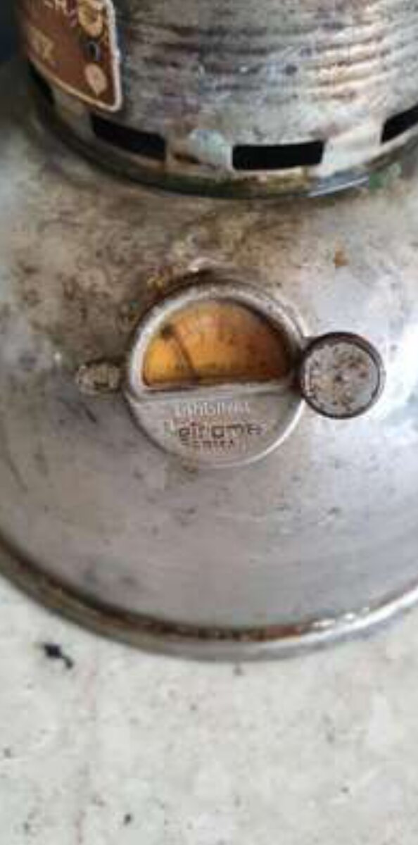

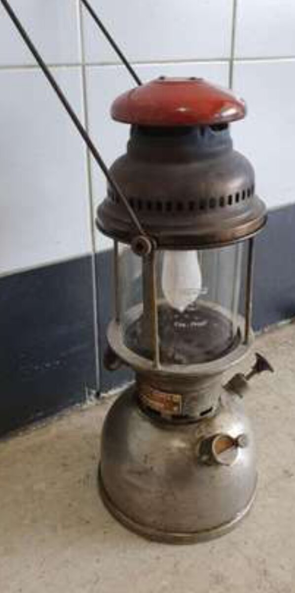

    Actually I visited the shop today. The 4 of them lanterns (9 pictures) had different parts for other lanterns as mentioned in the most of the comments, also the globes weren't genuine. The 4 lanterns had the light brand hood/cap.The petromax lantern had the globe and the cap also light brand (Not sure also about other hidden parts). Hesitated frankly on buying any of them (as usual ). Another guy sent me the below pictures, he is selling this one for 60 USD, I think it also requires some close checking, but looks decent somehow (will be getting more information about this lantern throughout the day), with best regards. Screenshot_20210806-063256_OLX Arabia.jpg Screenshot_20210806-063312_OLX Arabia.jpg Screenshot_20210806-063241_OLX Arabia.jpg Screenshot_20210806-063326_OLX Arabia.jpg
  4. WimVe
    3,531
    Well that is or was a petromax lantern. Oldy too.
    It looks beaten up and the dents will not come out.
    Again you can spend your money only once. Make sure all the parts are good. A non working pressure gauge will iritate at some point. The inner burner can be rusted way or from another brand, check that too.
    And ask for sharp pictures.
    Aks a seller if he can light the lantern. Does it hold pressure, what state is the bottom ?
    But first: how are your repair skills, why do you want a pressure lantern ?
    What do you want? a nice shining, original, well known brand lantern or a dented but working all day usable lantern ? Dents don't influence the workings, holes are.
    Edit: 60 us dollars is why to expensive.

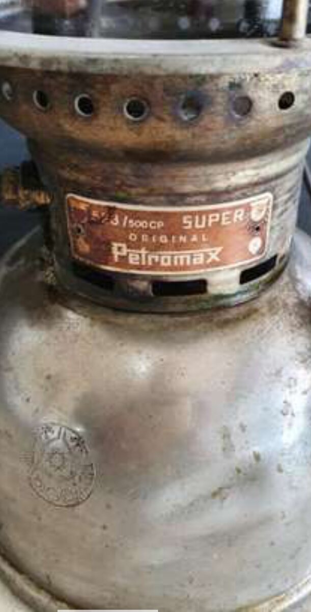

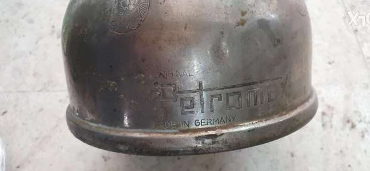

    The last pictures, (the 60 USD one) is a genuine Petromax. In my area, that asking price isn't that high. It can cost the equivalent of between 80USD to 110USD for a non-working Petromax in the condition similar to the one in the picture.
    That is a Petromax 523. Rated 500cp. However, the red enamelled hood with two holding screws on its cap might not be original to it but possibly an earlier Petromax. It might also have an older inner hood that's attached with the two screws.
    From the looks, the lantern in the pictures might date from the late 1950s to early 60s. I think it has a 'G' in the logo, not 'E&G'. The resolution of the pictures isn't sufficient for me to make out more details but I think this one looks ok for your consideration.

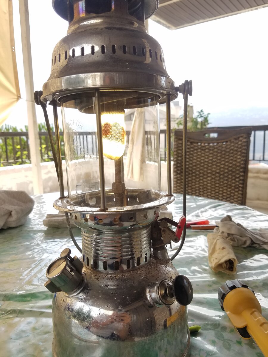

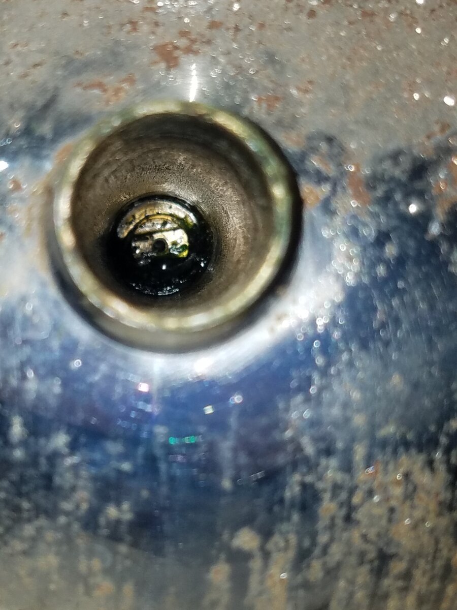

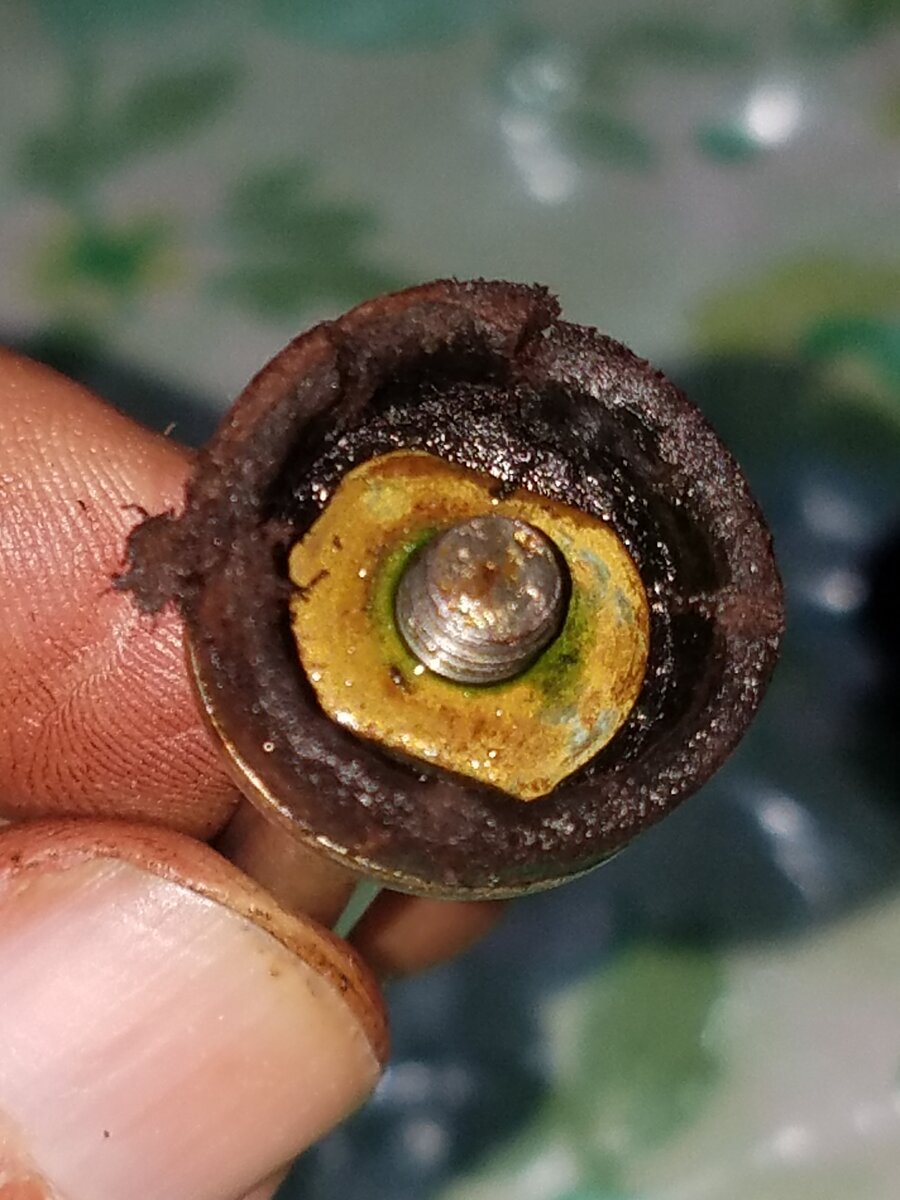

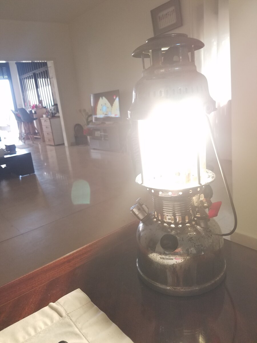

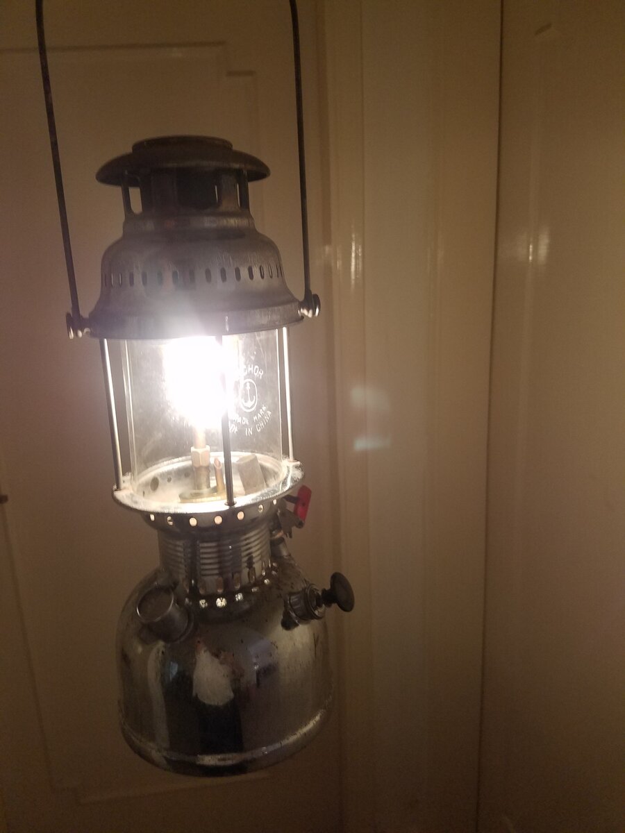

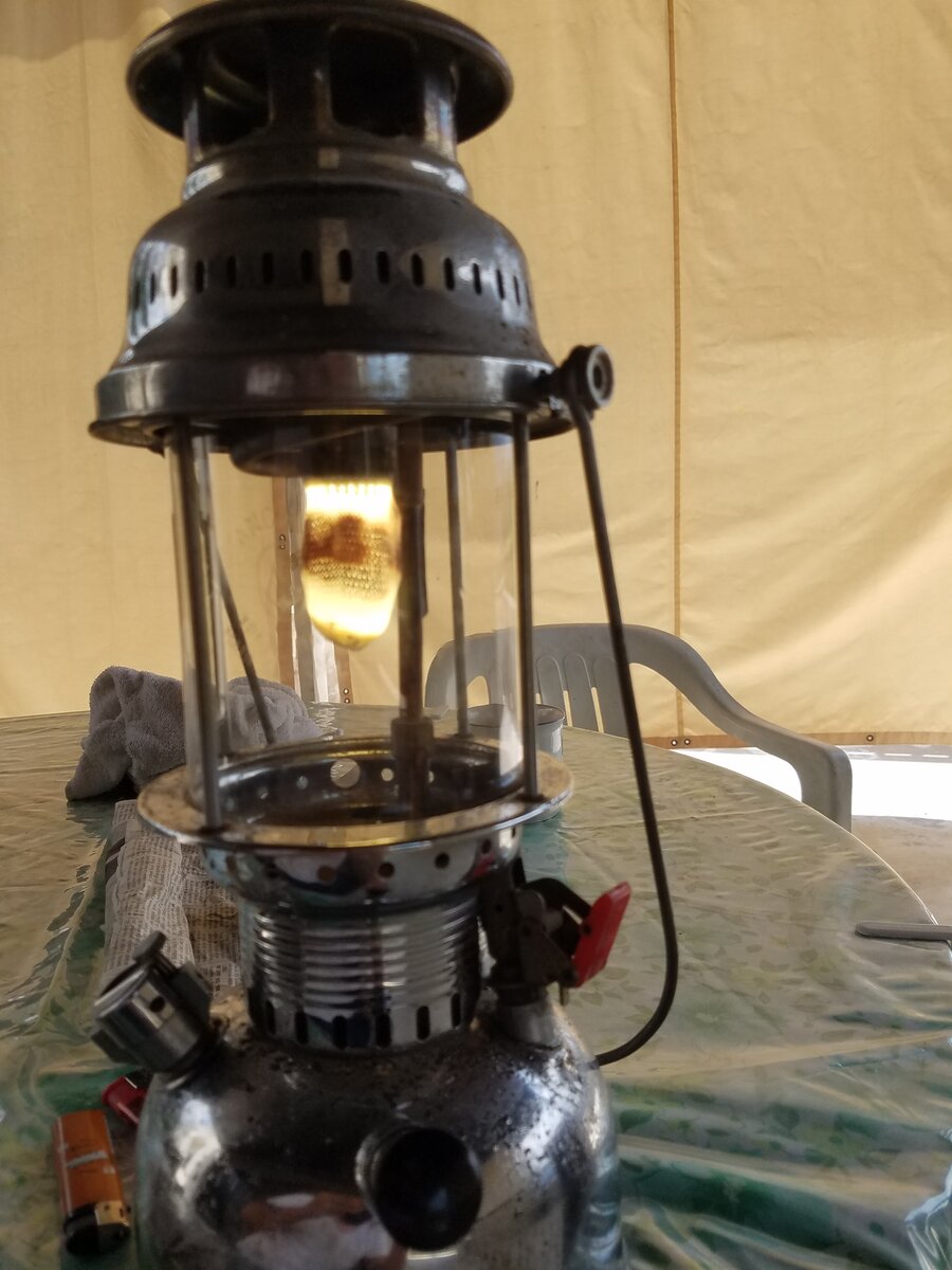

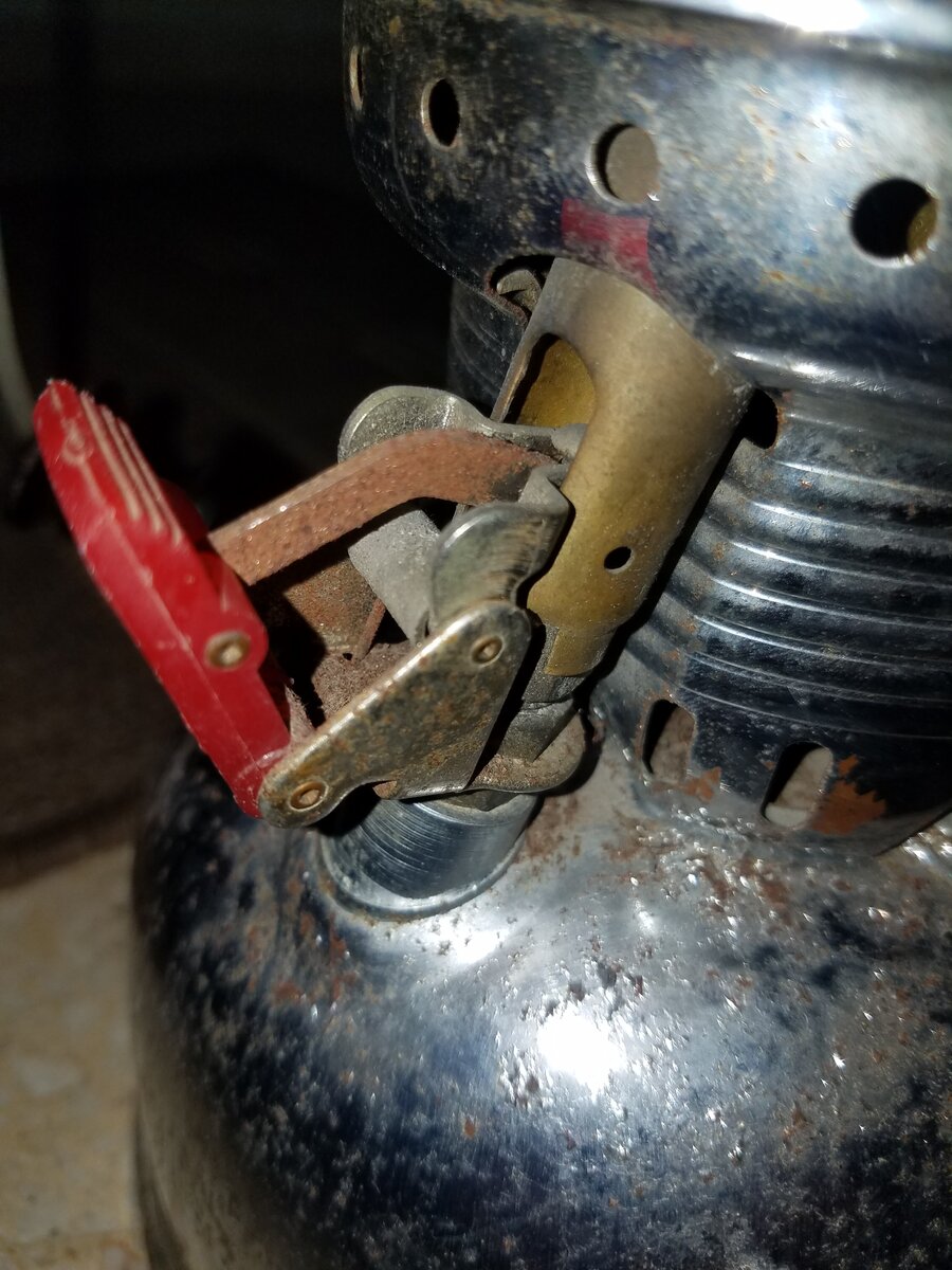

    Hi everyone and thank you for all the support provided. Got the one in the pictures at the end. Checked it, did a small disassembly based on instructions received from this forum, which was shared earlier by you friends; changed the pump leather (Used a substitute from the 5r stove pump), the needle looked okay and also other parts . No pressure was passing to the tank, I gave the tube a kerosene bath and kept baby oil (contains mineral oil) overnight inside it. Some pushes at morning and the pressure was felt inside the tank. Cleaned the tank with some kerosene only (4 to 5 washes). Closed the gauge and warmed up the system using denatured alcohol. Less than a minute, while pumping continuously (the needle of the pressure gauge wasn't moving), then turned the main knob on. It took a bit of time to have the mantle all bright. On a second try, I've turned a bit anticlock wise the screw that sits on the tube above the needle, to tweak the combustion mixture of fuel and air, the mantle this time went very bright (The lantern still requires lot of work). Below are some pictures during preparation: IMG-20210804-WA0029.jpg 20210807_205934.jpg 20210807_191358.jpg 20210807_191144.jpg 20210807_191118.jpg 20210807_181235.jpg And below are 4 pictures showing the 2 trials, the bright ones are from the second try (Noticed, when the lantern was very bright, that the gauge needle didn't pass the quarter or 1 kg/ sq.cm out of 4): 20210808_111241.jpg 20210808_110921.jpg 20210808_121140.jpg 20210808_121019.jpg
  9. ColinG United Kingdom
    4,815
    It works! This is excellent news! It seems to be an 'Anchor' lantern (or one of the very similar brands) as the tank is showing signs of rust coming through the chrome plating. Regardless, these lanterns are fairly robust and work reliably when cleaned and fixed. The rust can be treated with one of the readily available products but there will be small pits left behind.
