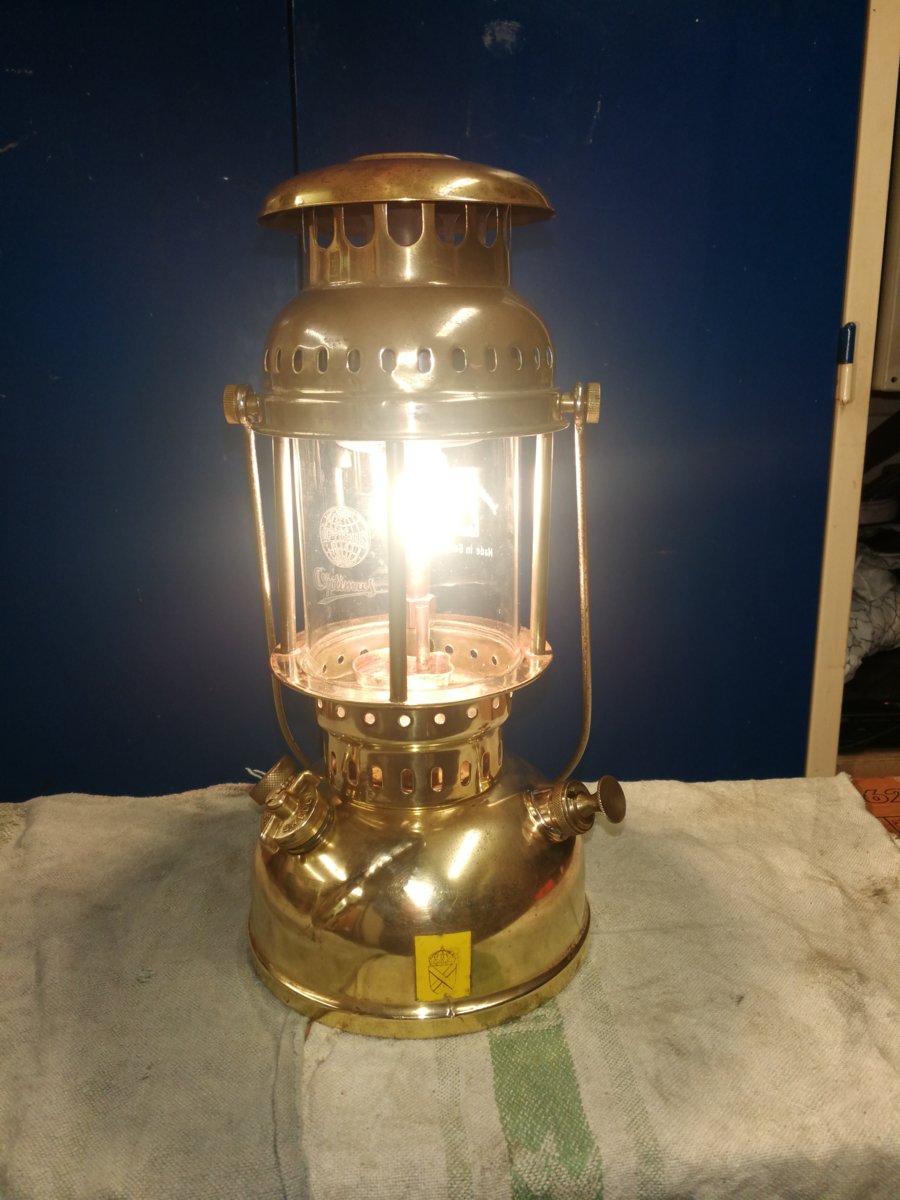

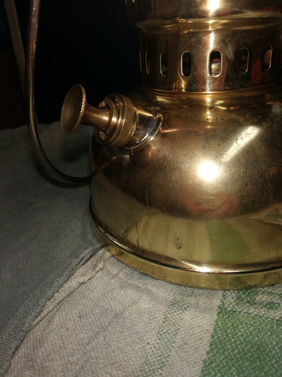

    And finally I got some time to assemble the 200P. Here it is, a rugged but now usable workhorse. Now the glass frame sits straight.
    The long dent pressed out but still very much there.
    I had to solder a little around the pump tube, I guess the ice moved it a little bit during freezing, since it leaked a bit from there.
    /Matti

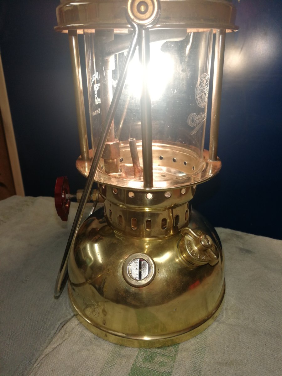

    Just got a late night idea! Have a Radius 119 with the top of the tank compressed. Just filled it with water and pushed the garden hose to the fill hole.
    Even though I couldn't hold quite tight, the tank popped up! The thread on the radius tank lid seems to be half inch - same as a garden hose connector.
    I will try that tomorrow on another lamp with the same problem. I think pressure here is 5-6 bar so at least the tank can stand that. Leaked a little through the jet, but that didn't matter.
    Next step is pressure car washer - if I can lower the pressure - 120 bar would surely blow the tank apart.
    Has anyone ever tested how much pressure a tank can hold! Should you blow the bottom out I think water is much safer - much less stored energy....
    /Hans
