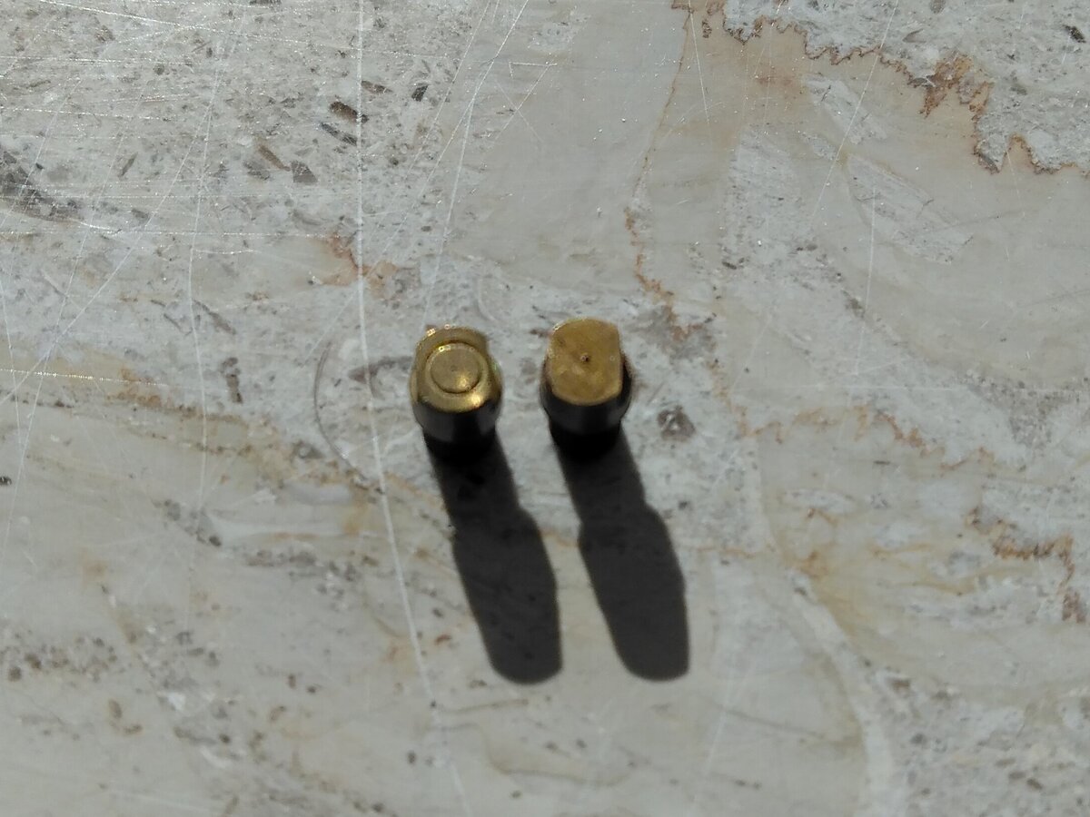

  14. Darryl Durdin
    1,652
    @Barry Purkins
    I believe there is a stamp
    Number or letter on the jet or gen,
    If you have pulled the vaporiser apart.
    Shellite has a fine brass mesh as the flow restrict or, kero has a curly spring like restrict or,
    I hope this helps
  15. Nils Stephenson
    3,414
    Outwardly there should not be any difference between the kero or shellite generators. As Darryl has said, there is a difference in the packing and the jet is different. The shellite jet has an O stamped on the top. Here you can see a shellite and a kero jet side by side. A bit out of focus, but you can see the O.
    I have seen one example of a Handi with a different generator. It was more the size of an Austramax generator. I don't know any more details about it.
  16. Barry Purkins Australia
    Nov 15, 2021
    2
    Kenmore
    Thanks Darryl and Nils
    It has a fine brass mesh. I will look for a number on jet
