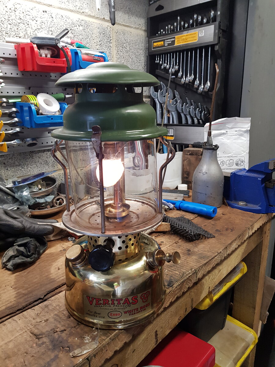

  7. rayw United Kingdom
    Sep 13, 2020
    457
    Yes as I remember the UNF and BSF threads are the same up to 7/16
    Thanks for the link to Austramax lamps spares I was not aware of those, I have ordered a Petromax 350 jet and needle, but I would be more happy to leave the threads alone and fit the Austramax jet.

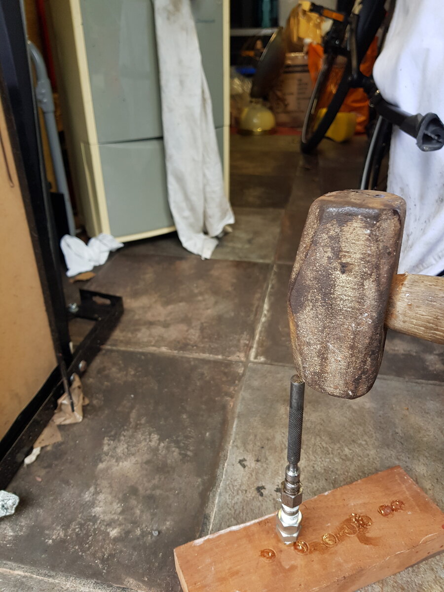

    Well thought I would hive it a bit of a clean while I'm waiting for the taps to arrive.
    Then postman showed up with my package.

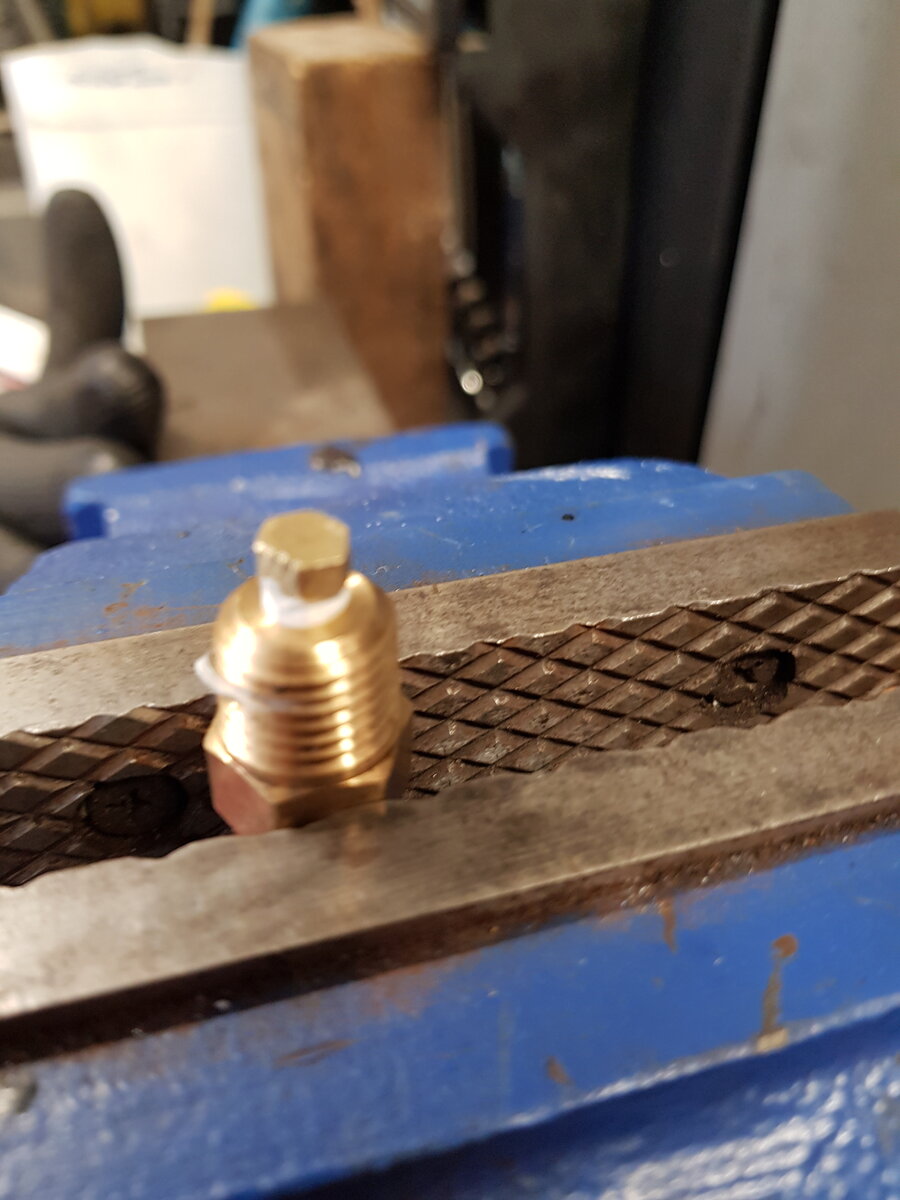

    So, I tapped a fitting 3/16" bsf
    Screwed the nipple into it with some PTFE tape.
    Then screwed on the other fittings and filled the assembly with oil
    , put in a pin punch which was a decent fit, then applied some pressure
    After a couple of blows oil was coming through so I took it apart, sprayed brake cleaner into the nipple and I could see it coming through.
    I assembled the lamp and filled it up.
    Well it lit but only a small patch of the mantle was glowing, I suspect the needs probing with a needle, but i ordered a petromax 350 needle to modify maybe that will work, or maybe the jet has had it, let's see.

  13. george
    Surprised the PTFE is holding.... figured it would burn away.
    :-k

  15. rayw United Kingdom
    Sep 13, 2020
    457
    Strange stuff PTFE tape its pretty stable up to about 400C when it will start to deteriorate quite quickly, i used it when i was trying to clear the jet to try and make sure the pressure shock went to the right place this time, just left a small amount on the threads when I put the jet back in the lamp.
    Just waiting to get the petromax needle and modify it then see if it will clear the jet completely, I think it will be a delicate operation

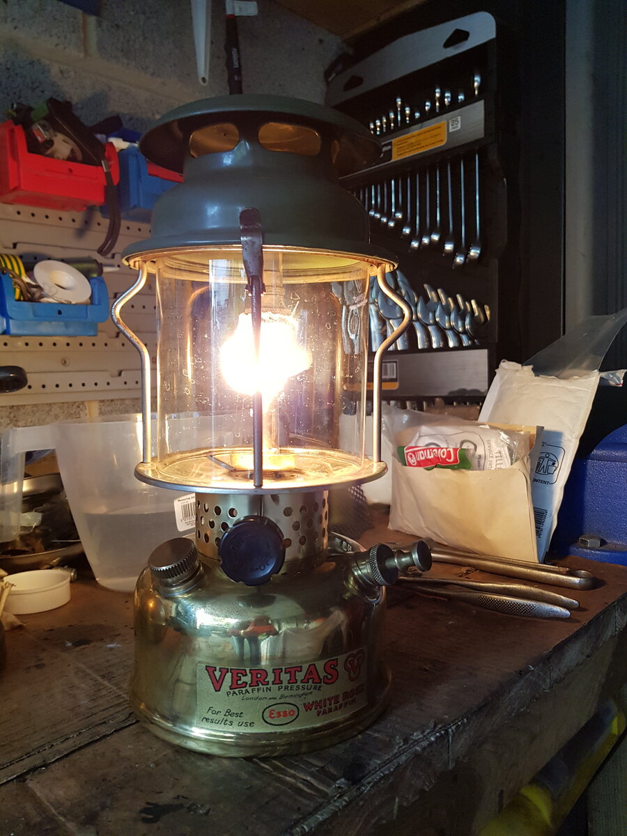

    But With the kind help and advice of Mr Henry Plews the old girl lives again,
    It's been lit in my garage for about an hour now and burning nicely.
    I've given it a bit of a clean up but not decided how I want to continue, maybe keep it looking like a good old'en
    Given the story of spares for these lamps I think it should only be lit now and again, but it's great to know it works ok.

    Well @rayw - you must be very pleased - look like a keeper to me !
    Chris
  18. David Shouksmith
    That's nice - not over-done... :thumbup:
  19. ColinG United Kingdom
    4,816
    From the photo it isn't obvious what else you might want to do to it... the nickel plating looks good, the enamel hood is too as well as the frame! I'd leave it like if is and give it a quick rub over now and then.
    Good job getting it running again, she looks great!
