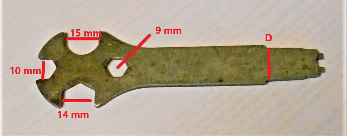

    Sorry for the confusion, when I said "immediately below "pump check valve . . the "foot valve" , I meant the images on this web page Restoration of a PETROMAX 829 Lantern To be honest, there is a better webpage than this but I can't find it. Does anyone else know of it ?

    Polytetraflouroethylene tape as used by plumbers, gas fitters and some lamp fettlers. It comes in different grades which are usually distinguished by the colour of the reel it's on. If you choose to use P.T.F.E. tape, Yellow is best. This may explain it better
    Thread seal tape - Wikipedia
    As with any new venture, there's a learning curve, we've all been there at sometime in our life and some of us are still learning.
    For the tools, have another look at Petromax Spares Price List
    about half way down the page is #66 spanner/gauge. D measures the 'air gap' i.e. distance between the jet #50 (a.k.a. nipple / gas tip) and the mixing tube (a.k.a. J tube). If the air gap is not set correctly, the lamp will not work at maximum efficiency.
    The notch in the screwdriver blade makes it easy to undo the nut #112 which holds on the control wheel #111.
    10 mm fits #107, 15 mm for vapouriser lower part #153, 14 mm for upper vapouriser #152 and 9 mm for the jet.
    It's a useful tool but it does have its limitations, especially the 14 and 15 mm sizes so it's best to get proper spanners in these sizes. Personally, I also find a 19mm spanner very usefull for holding the nut that's soldered to the tank where the vapouriser screws in - very handy when removing the vapouriser, especially when it's very tight.

  14. Henry Plews
    3,066
    @Fiona Farrell
    Would have made more sense if I'd remembered to attach this image :doh::oops:
  15. WimVe
