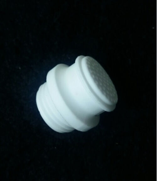

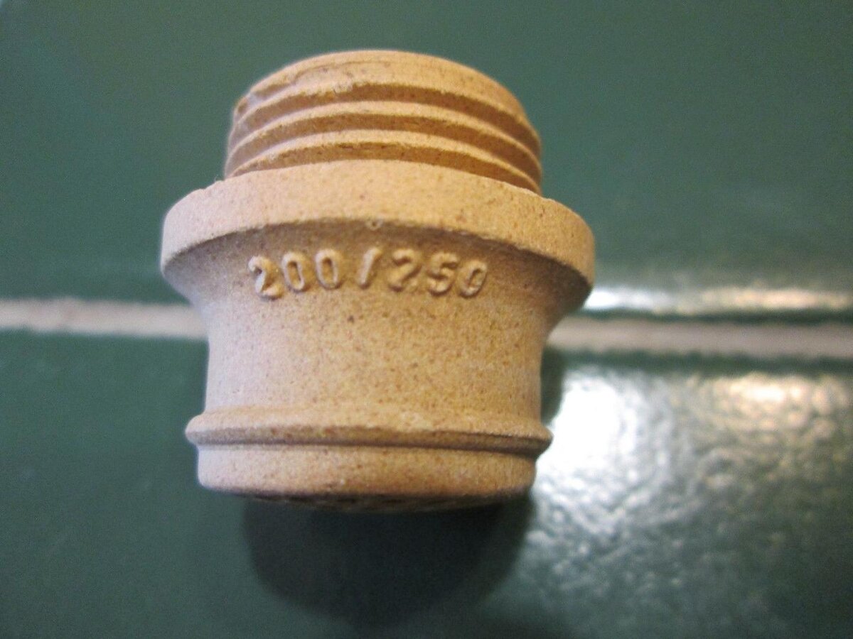

    A clay burner is made of heat-resistant clay(original style) similar to this:
    An oxide burner is made of almost pure aluminium oxide and is even more heat-resistant and harder. It is usually very white in colour:
  3. WimVe
    3,547
    Just a warning: I bought 250cp clay burners some time ago and guess what the amount of threads was different. So make 100% sure you get the right ones.

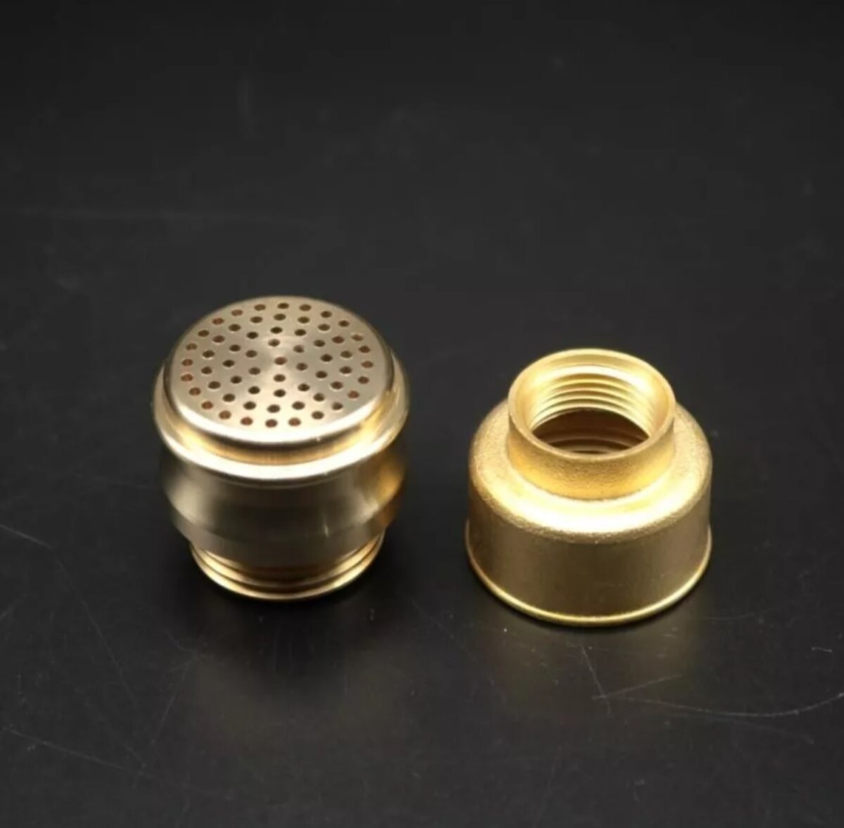

    Since we discuss burners, I have seen brass burners too (#3). They are expensive but what about them? They come with the part than they screw to (#34). I try to examine my options. 10 euros for clay, 18 for oxide, 25 for brass, all these plus shipment and customs. None of those exist in EU (which is kind of strange when Petromax is in Germany).

    Sep 16, 2019
    180
    Samos, Greece

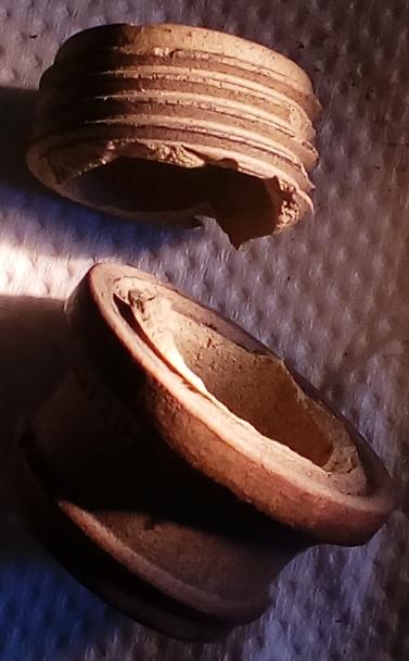

    Do you think exhaust putty can fix this somehow? The two pieces do match together.
  7. Fireexit1 United Kingdom
    3,538
    I do not think so. Even if it stuck together it would drop off at some point costing another mantle.

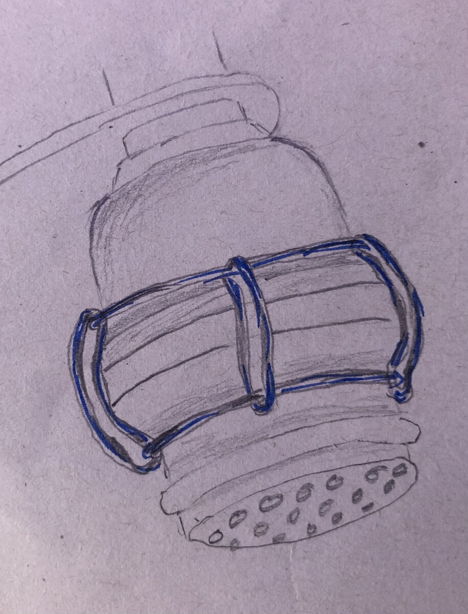

  8. podbros
    4,119
    May be worth trying a repair? use the exhaust putty to glue it back together then maybe use some stainless or nickel wire tied to hold it in place?
    the wire would have to be thin enough to be flexible but thick enough not to oxidise?
    i thought I had read of some members affecting such a repair :/
  9. Antonis Tsolomitis Greece
    Sep 16, 2019
    180
    Samos, Greece
    Interesting repair with the wires. I will try it out of curiosity. At least Base Camp ships to Greece.

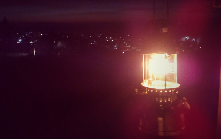

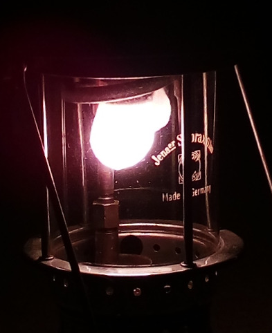

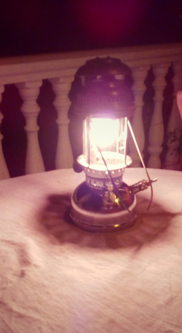

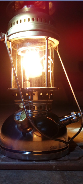

    It took quite some time to get the needed parts for the 250 and test everything. So I cleaned the vaporizer and the Preston loop with a Bowden cable. Also repaired the pump valve, replaced the burner and the nozzle with new ones. So I tested it yesterday using a Pmax pump adapter and a Pmax fuel cap with pressure gauge so I know at what level is the pressure. The mantle looks a bit on the yellow side but my tablet can not really show the color although I tried. Maybe I had to adjust a bit the screw on the J tube but I forgot about this point. Here are some pictures:

  12. Henry Plews
    3,073
    That looks very bright. :thumbup:
    There's nothing to stop you adjusting the screw but it could just be the mantle. Older mantles used thorium which gives a bright white light but many modern mantles use non-radioactive yttrium which gives a softer slightly yellow light. As long as there are no flames outside the mantle the lantern will be fine.
  13. MYN
    The mantle looks pretty bright in the pictures. Don't know how it appears in actual.
    You can adjust the J-tube 'flap' screw until the mantle glows with the brightness or whiteness you desire.
    What mantle are you using for this?
    Usually, but not always, the older radioactive thorium types tend to be 'whiter' in terms of light colour appearance.
    They might or might not necessarily have a greater luminance than the newer types.

  15. Fireexit1 United Kingdom
    3,538
    Looks great ! - although do I see the top cap/ventilator not where is should be ? - this can disrupt airflow. nice looking lantern :content:
  16. Antonis Tsolomitis Greece
    Sep 16, 2019
    180
    Samos, Greece
    The mantle I use is a modern Petromax mantle for 250. I actually like the golden glow of my lamps, I am not into the whitest possible. So this is OK for me from the color side if the fuel burning is correct. I do not see flames around the mantle. So I assume the lantern works properly. But I do have an observation I would like to ask about:
    The fuel cap with the pressure gauge and the pump adapter get much hotter than on a Petromax 500. Not to the point of not touching them, but noticeably hotter. I thought that this could be due to the fact that they are closer to the mantle, as the 250 has smaller dimensions than the 500. Is it so? Same goes for the fuel tank. It is a bit hotter to the touch.
    The burner (forgot to say) is not a clay one, but an aluminum oxide. I do not know if these burners burn hotter or not compared to the clay ones.
    The vaporizer, I had written before, is not straight but somewhat bent. I did not attempt to fix this, as the rod and the needle work properly with the nozzle.
  17. Antonis Tsolomitis Greece
    Sep 16, 2019
    180
    Samos, Greece
    Oh, yes, I put the ventilator after the lantern was lit and it was to hot to place it properly. I will fix this.

    The situation for ceramic versus stainless steel is clear with all the above. But it remains unclear the choice of brass burners. Judging from Coleman they should be OK. Coleman uses a brass burner I think. Say in the current 639C model. Brass burners are sold together with their housing, I guess to compensate for expansion. @MYN says that it is metal and in the presence of oxygen it will oxidize. And is this important? Even if it oxidizes what could the problem be? Will it chip? Again, Coleman is my typical example for this.
  29. MYN
    This:-
    Also, in general, the burner region of an operating Petromax gets considerably hotter than those found on most Coleman lanterns. In particular, 350 and 500cp units.
    Sometimes, even the loop of the vaporizer would glow red.
