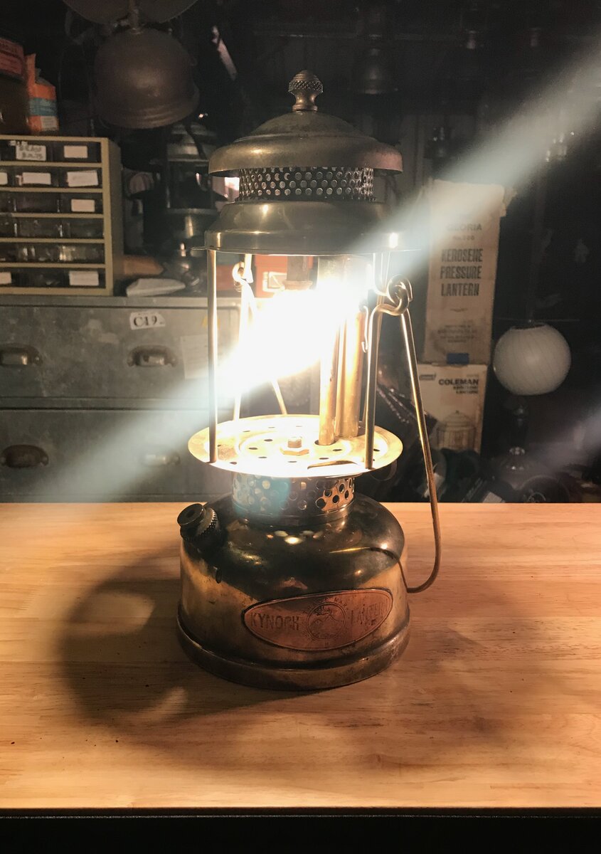

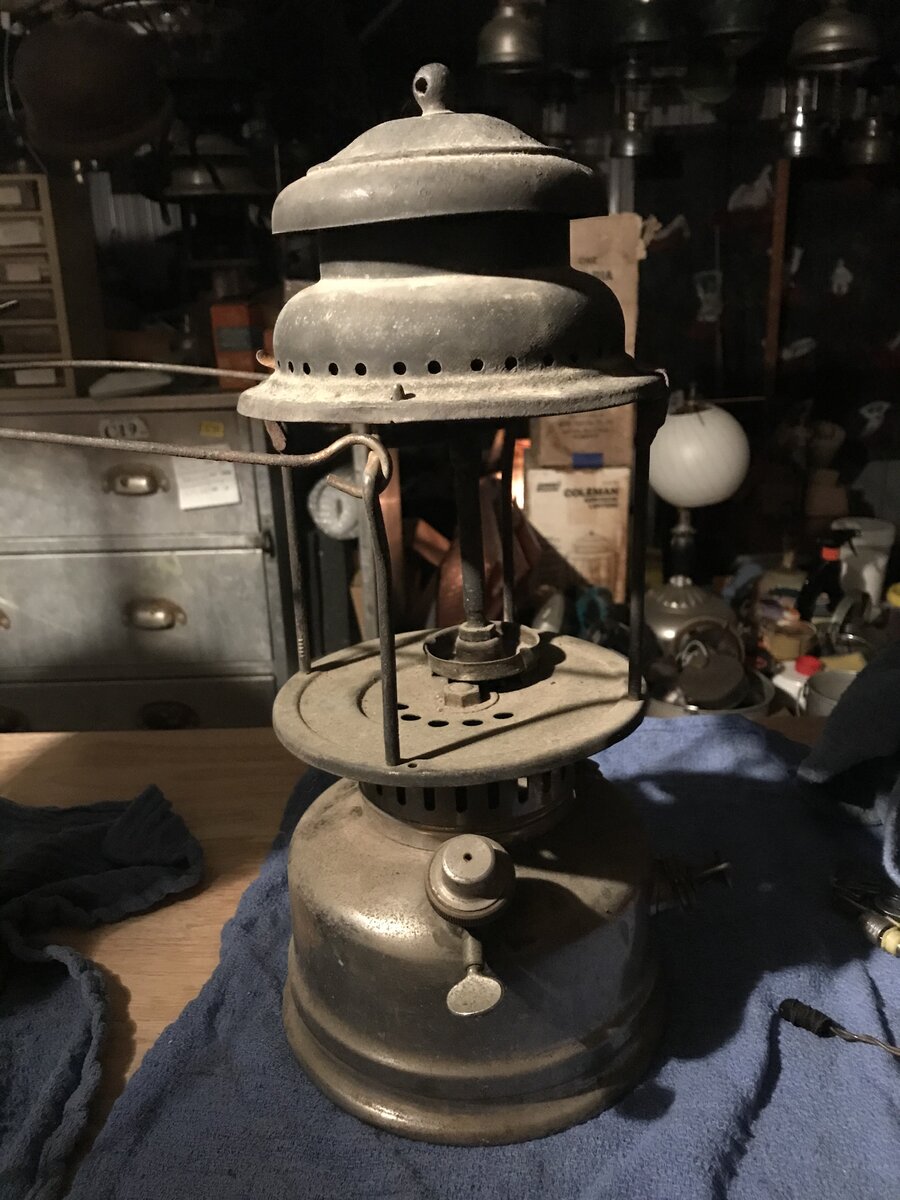

I’ve started on the Gloria pile!
Discussion in 'Lamp Action Gallery' started by Tony Press, Dec 26, 2018.
  1. kero-scene Australia
    Jan 23, 2013
    365
    Australia
    Tony, just how big is this 'Gloria pile'?
    @kero-scene
    Quite big... I’m about 1/3 through it (it has stoves as well).

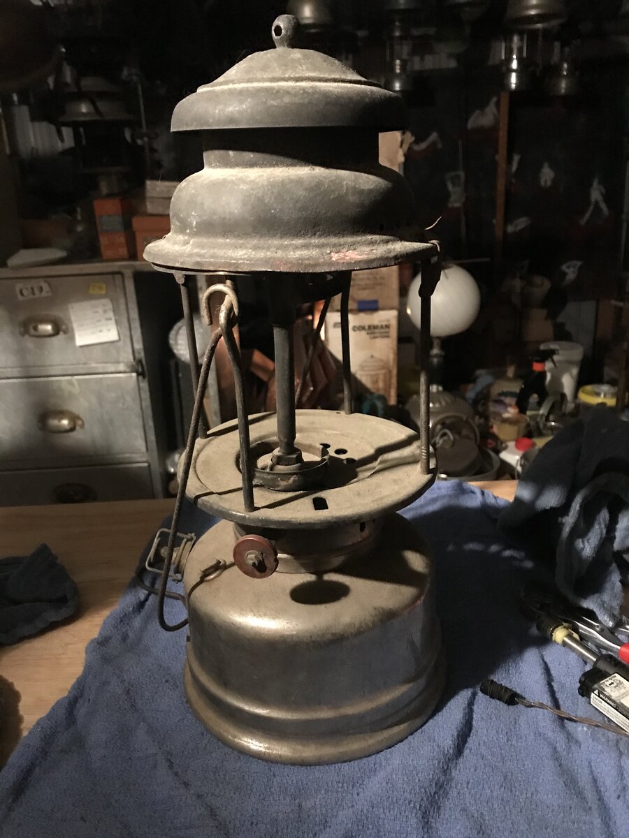

    The large box...(also from the Pile):
    @Lamp Doctor
  5. Nils Stephenson
    3,405
    That will be interesting to know what is stamped on the tank. From appearances it should be a Radius 119 from between 1934 and 1937, but it looks like it has been fitted with an Aladdin handle.
  6. Tony Press
    Nils
    It has “Aladdin No. 12A Made in Sweden” stamped on the tank; “Radius Made in Sweden” on the pump; and the plugged pressure gauge hole.
    @Nils Stephenson
  7. Nils Stephenson
    3,405
    That is interesting. All the Aladdin 12A lamps I have seen (not many) have had the pump higher up on the 'corner' of the tank and the filler cap with the pressure release screw. This would mean that there are at least two variations of the 12A (I am not counting the 14A here).

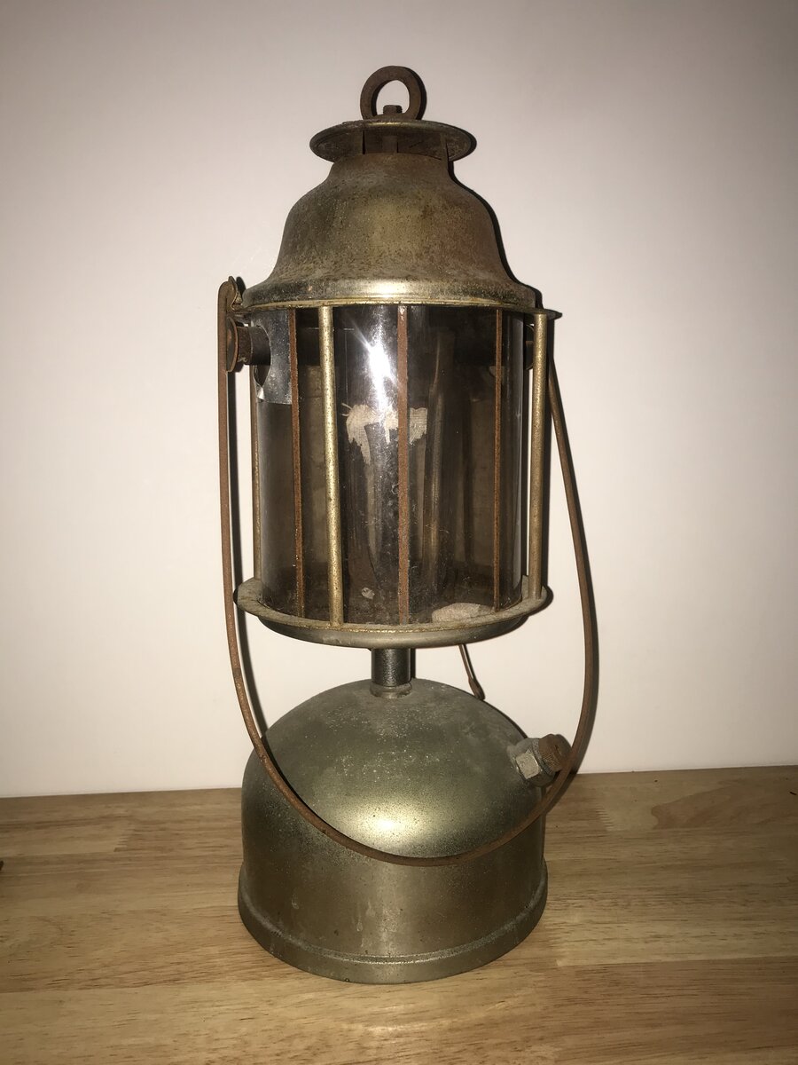

  15. Tony Press
    Next can off the rank... Not a Gloria, but pretty interesting, and it came out of the Gloria pile:
  16. Jean J
    3,003
    That’s an interesting one Tony, but what is it?
  17. Tony Press
    @Jean J
    It’s a pressure lantern...
    I must admit being coy. I’m hoping it’s a puzzle for some.
    All, of course, will be revealed.
  18. David Shouksmith
    It ain't a puzzle for either me or George! - or another well-known lampie who wandered around the field at Newark one year using one as his go-to source of illumination...
    But we'll let you keep a few others in the dark for now... ;) :lol:
  19. Tony Press
    @David Shouksmith
    Yes...I know you know.
    This was sold here in Oz. So not out of an imported collection.
  20. David Shouksmith
    Mine came from a well-known collector in Northampton - I've no idea how it got there... :-k
  21. Wim
    Wim Subscriber
    926
    Dendermonde, Belgium
    Looks like an early Kerosafe to me.
  22. Tony Press
    It seems to be raining Thomas Kerosafe lanterns at the moment with Conny and Duane entering the fray.
    Jean, as far as I can work out it’s a Thomas Kerosafe M-4001:
    Thomas Kerosafe M-1004 lantern
  23. David Shouksmith
  24. Tony Press
    Mmm... dyslexia?:-k
    Of course, M-1004.

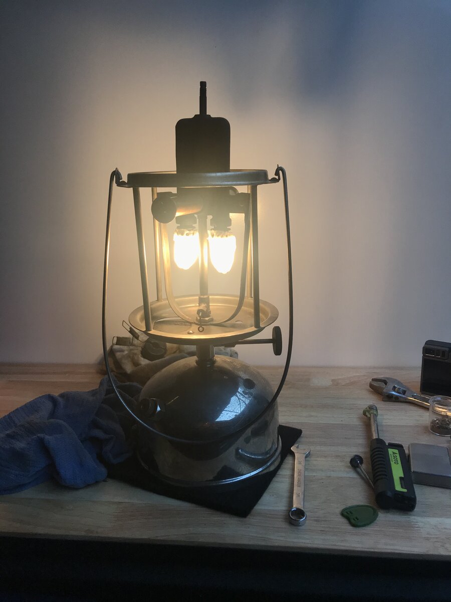

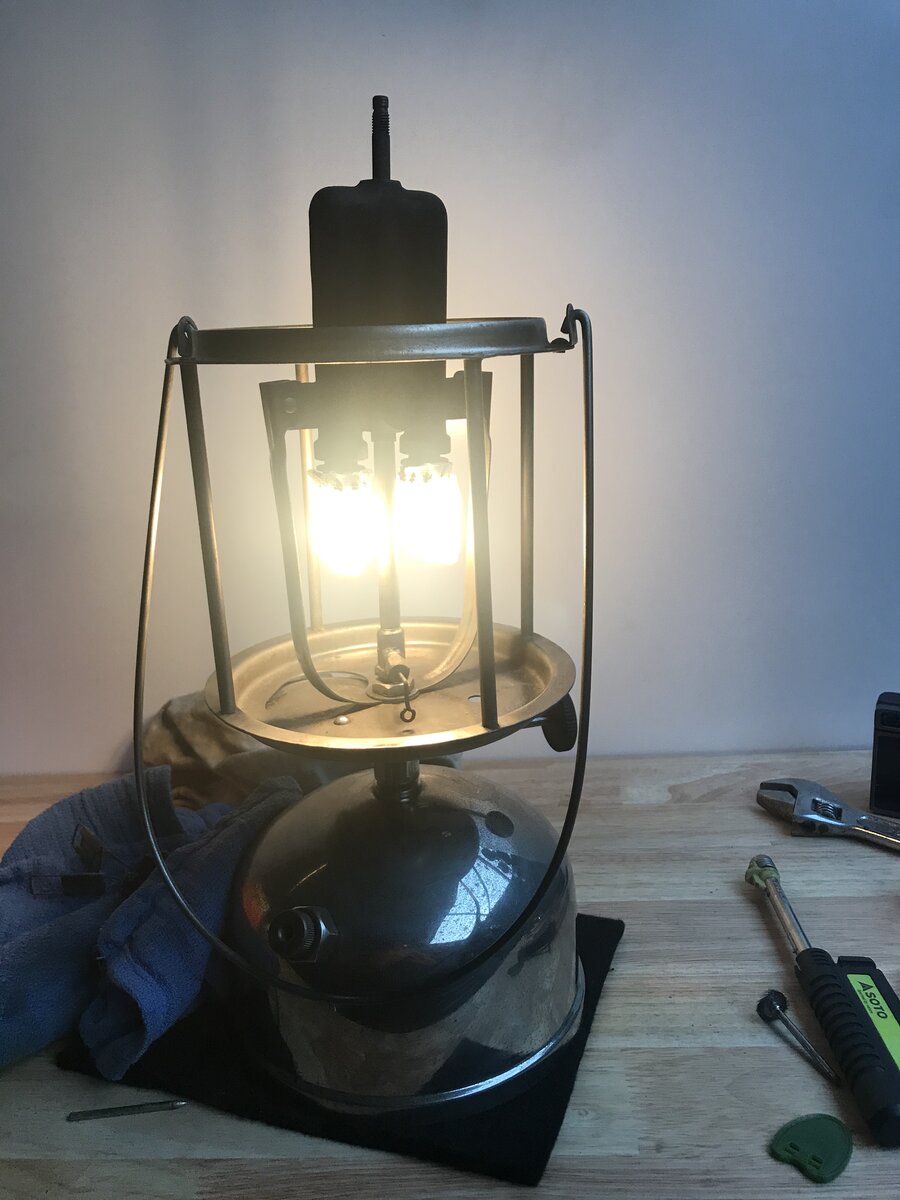

  25. Tony Press
    Getting there:
  26. Tony Press
    Not bad!
  27. ROBBO55
    4,428
    It's working nicely Tony. :thumbup:

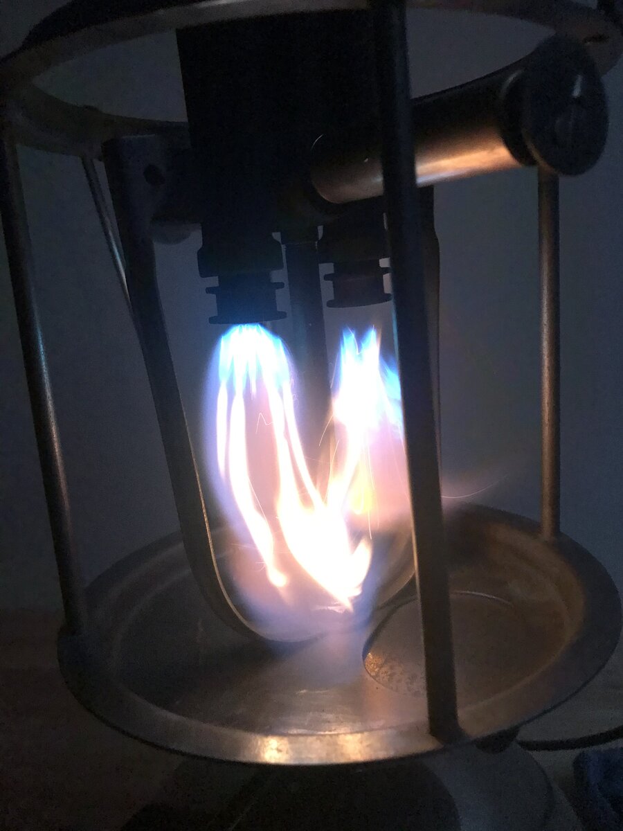

  28. podbros
    4,100
    Looking good !
    I can see the Tilley clip there, Tony...is that what you used?..If so, then was 1 preheat enough?
    Also was it similar to a Coleman in terms of pumping and how many pumps and so on??
    cheers :thumbup:
  29. Tony Press
    @podbros
    The generator on these lanterns does require a very good pre-heat. I found that the Tilley clip worked well but requires the mica to be off the lantern. I am making a special torch for this lantern from brass wire and carbon felt.
    I used 35 pumps from a (long) Coleman lamp pump.
  30. JEFF JOHNSON
    16,881
    Well saved!:thumbup::thumbup:
