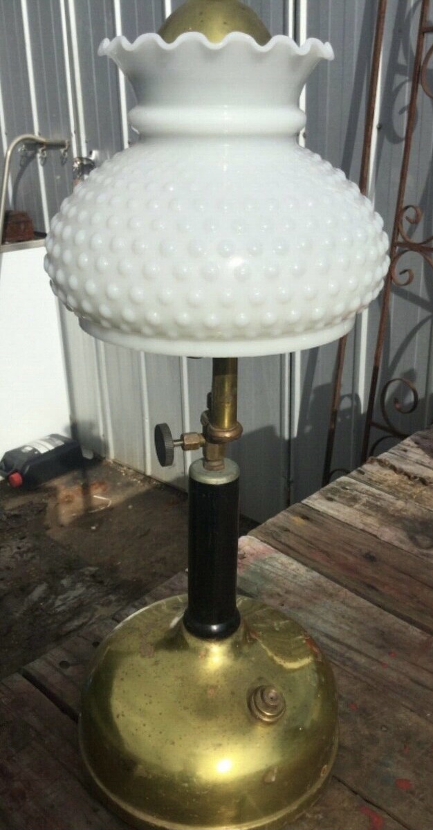

    A very homely light!:thumbup::thumbup:
    @Henry Plews

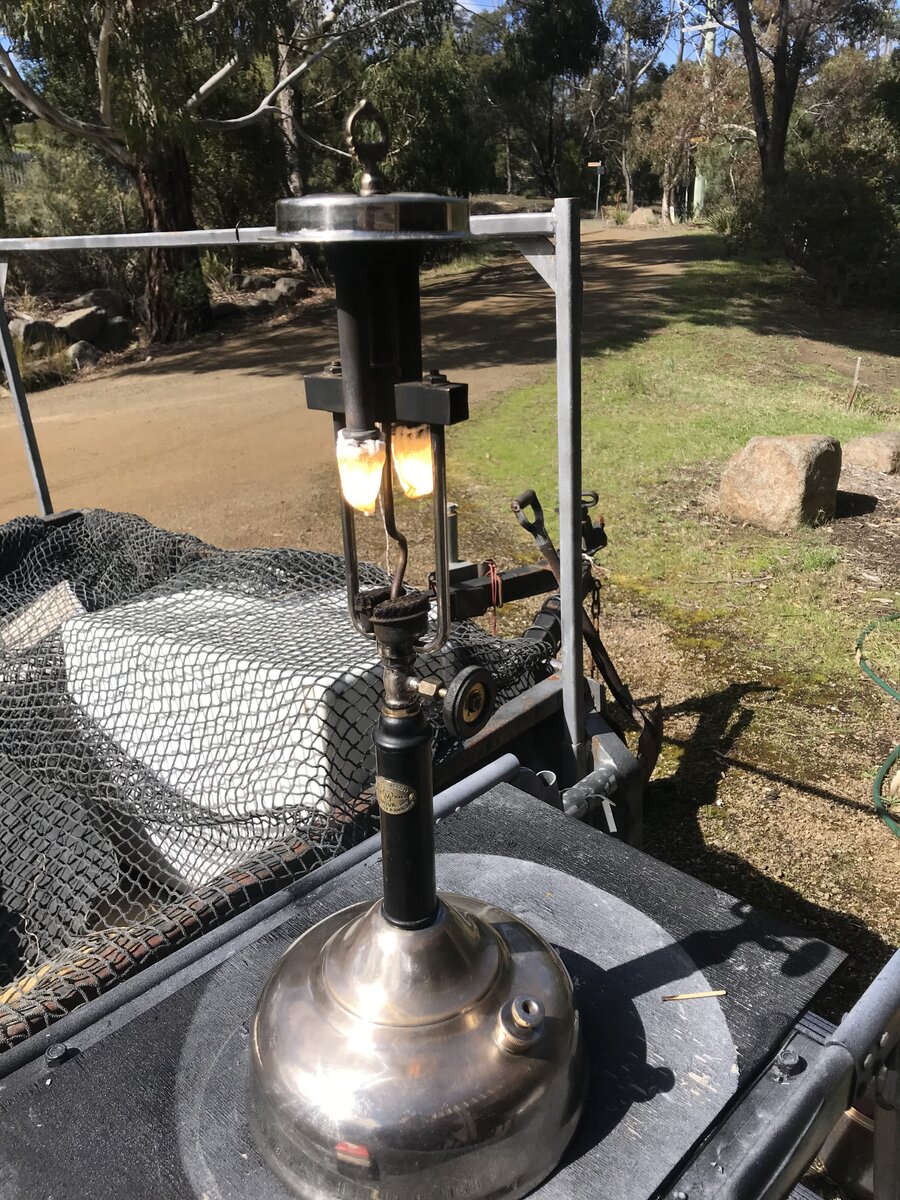

    I do not have a mica cuff for it (or the other one elsewhere in Tasmania). I’m working up the courage to make my own.
    Next one from the pile...
    I’ll get it in the Reference Gallery tomorrow.

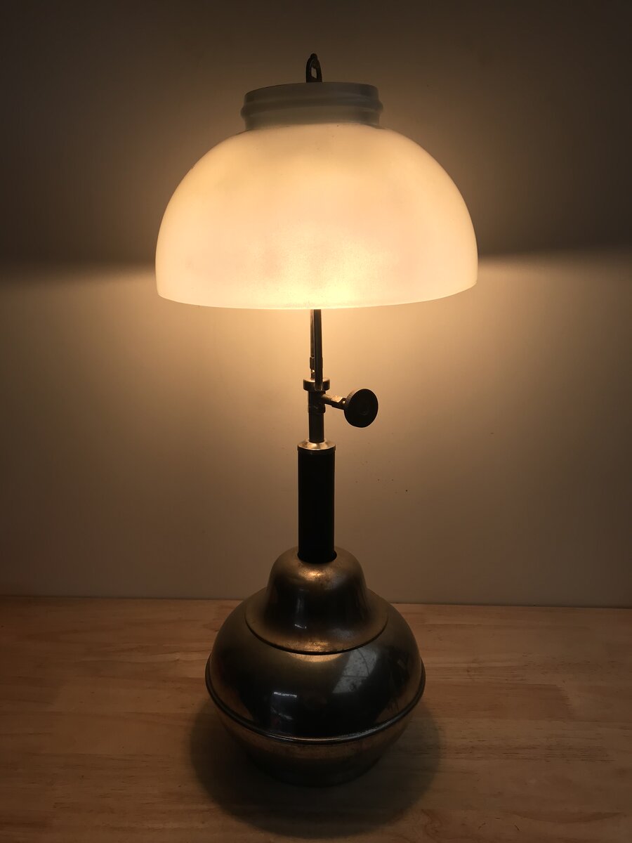

    A fine addition to your collection.:thumbup:

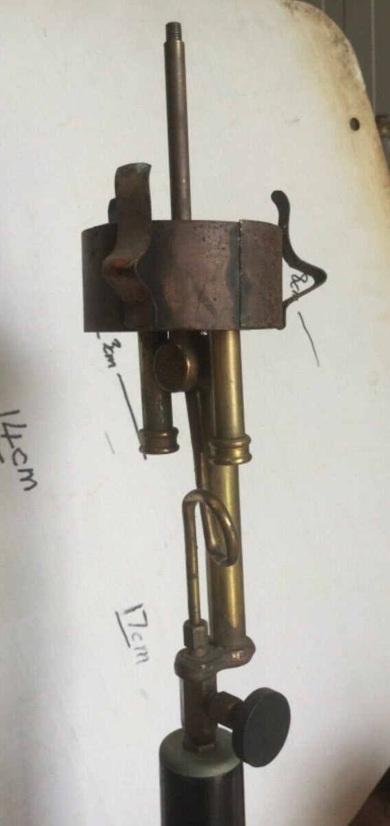

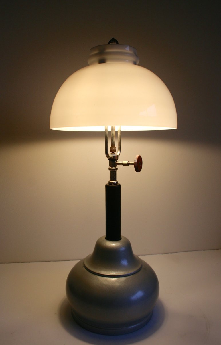

  6. Tony Press
    I’ve added this to the Gloria pile. I’m working on it now.
    Ignore the shade… this is the seller’s photo. The shade is destined for a wickie somewhere…
    An interesting lamp, not branded Gloria, though.

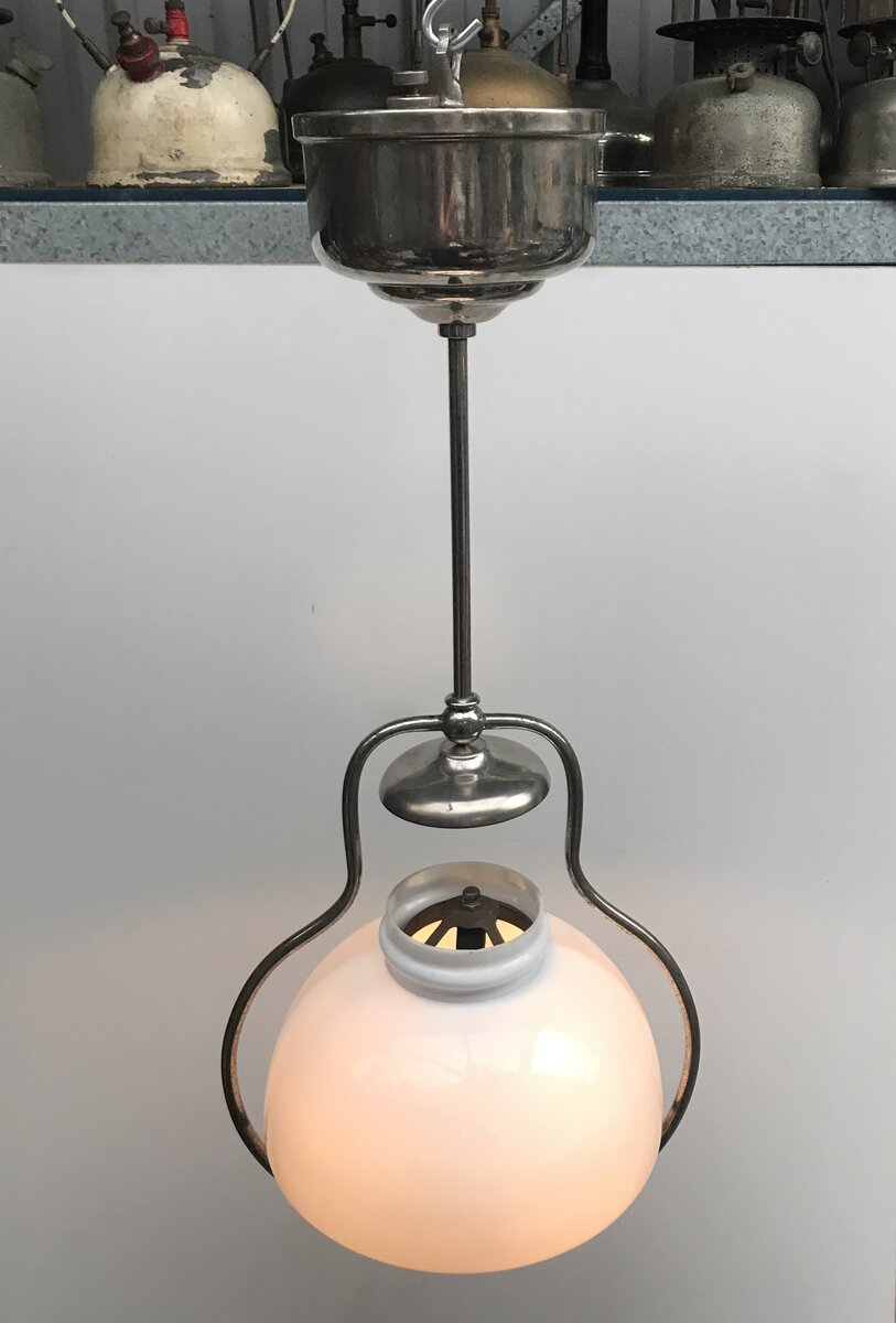

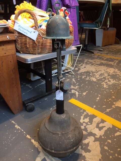

  7. Tony Press
    A new addition (not yet in my hands).
    The electric light “bell” has already found a home.

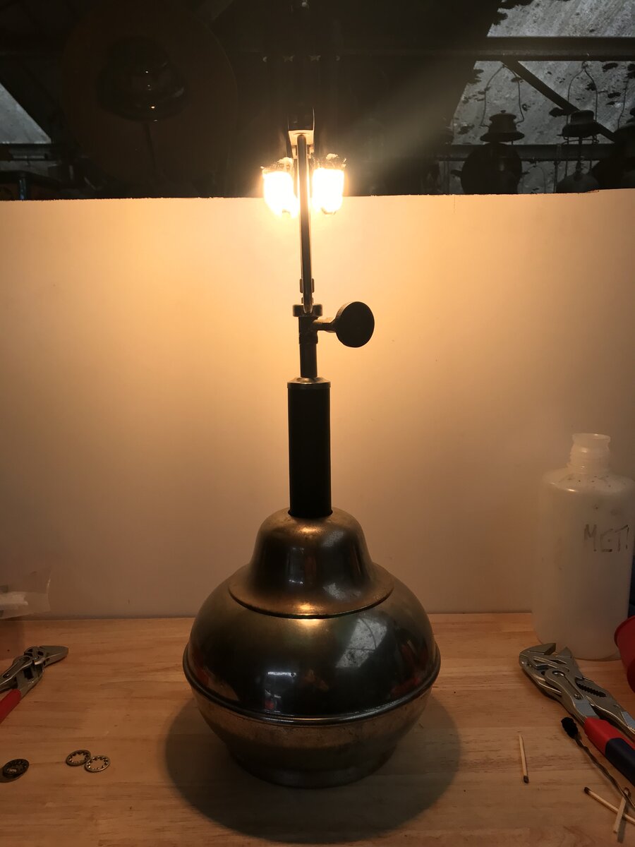

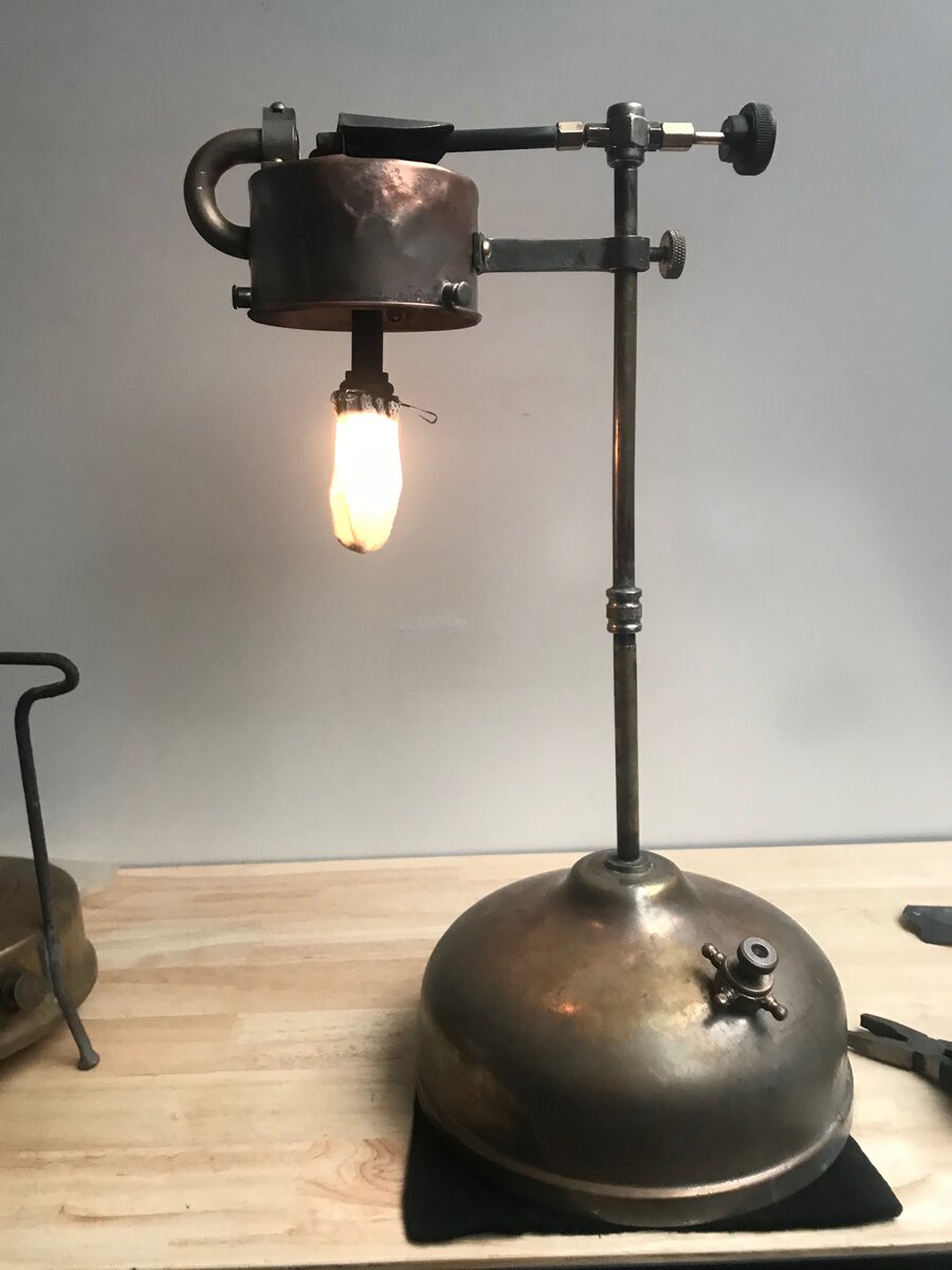

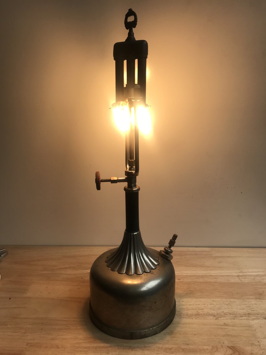

  11. Tony Press
    I’m happy with this.
  12. Tony Press
    Not bad for a lamp that’s probably over 100 years old.
  13. Tony Press
  14. Henry Plews
    3,066
    Whoa, that's looking bright!
  15. Tony Press
    Henry
    Very bright for a little lamp.
    I’ve had to do a fair bit of fiddling around with the fount because it had a couple of tiny holes in the rim. I think I’ve got it sorted now. I’ve run it on both kerosene and gasoline.

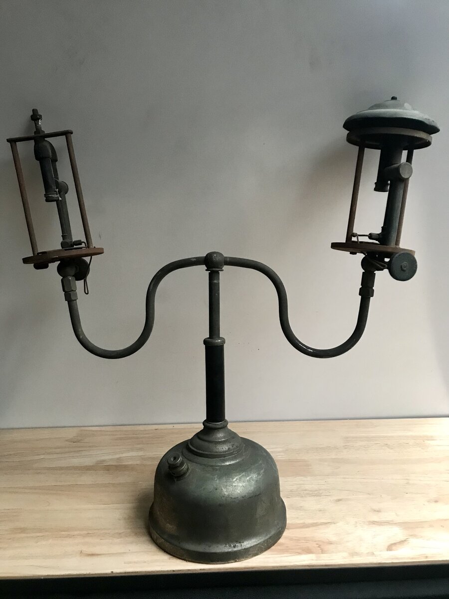

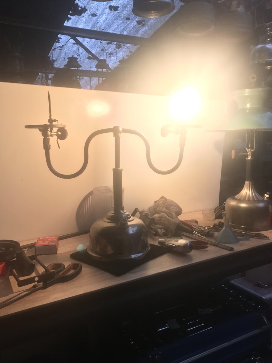

  16. Tony Press
    Next cab off the rank.
  17. Tony Press
    Slow and steady… I’m getting there on this one:

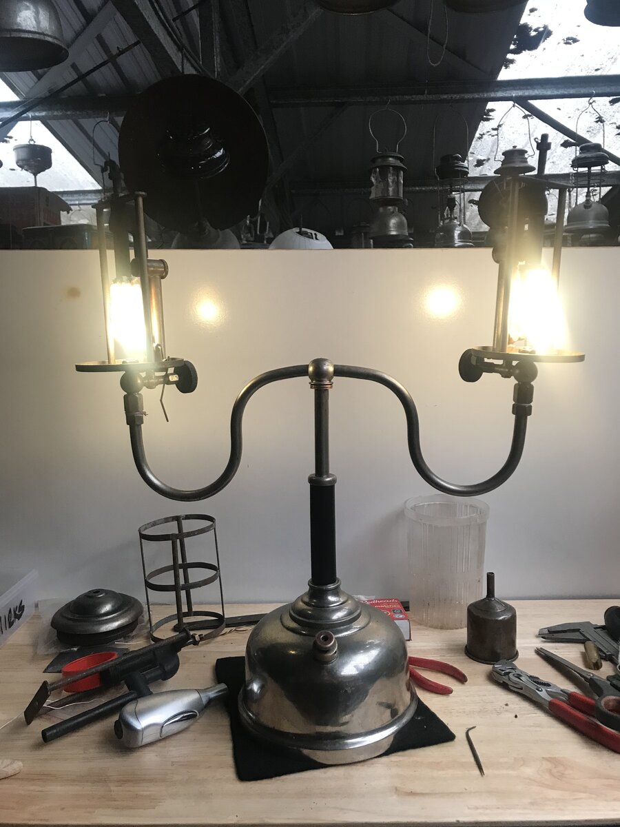

  20. Tony Press
    @Michel
    I did a little bit more work on it this afternoon. I’m very happy with it.
    I need to build some mica for it.

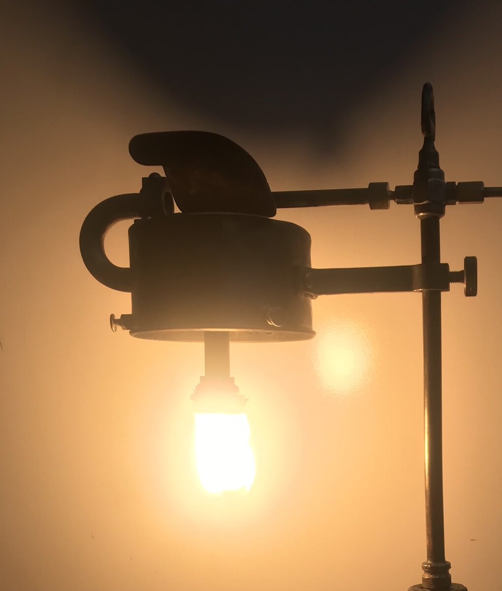

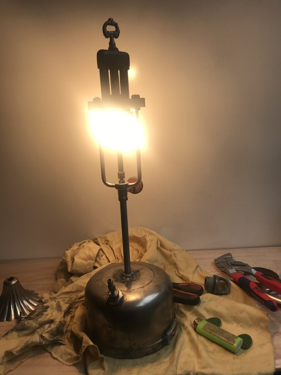

  23. Tony Press
  24. Tony Press

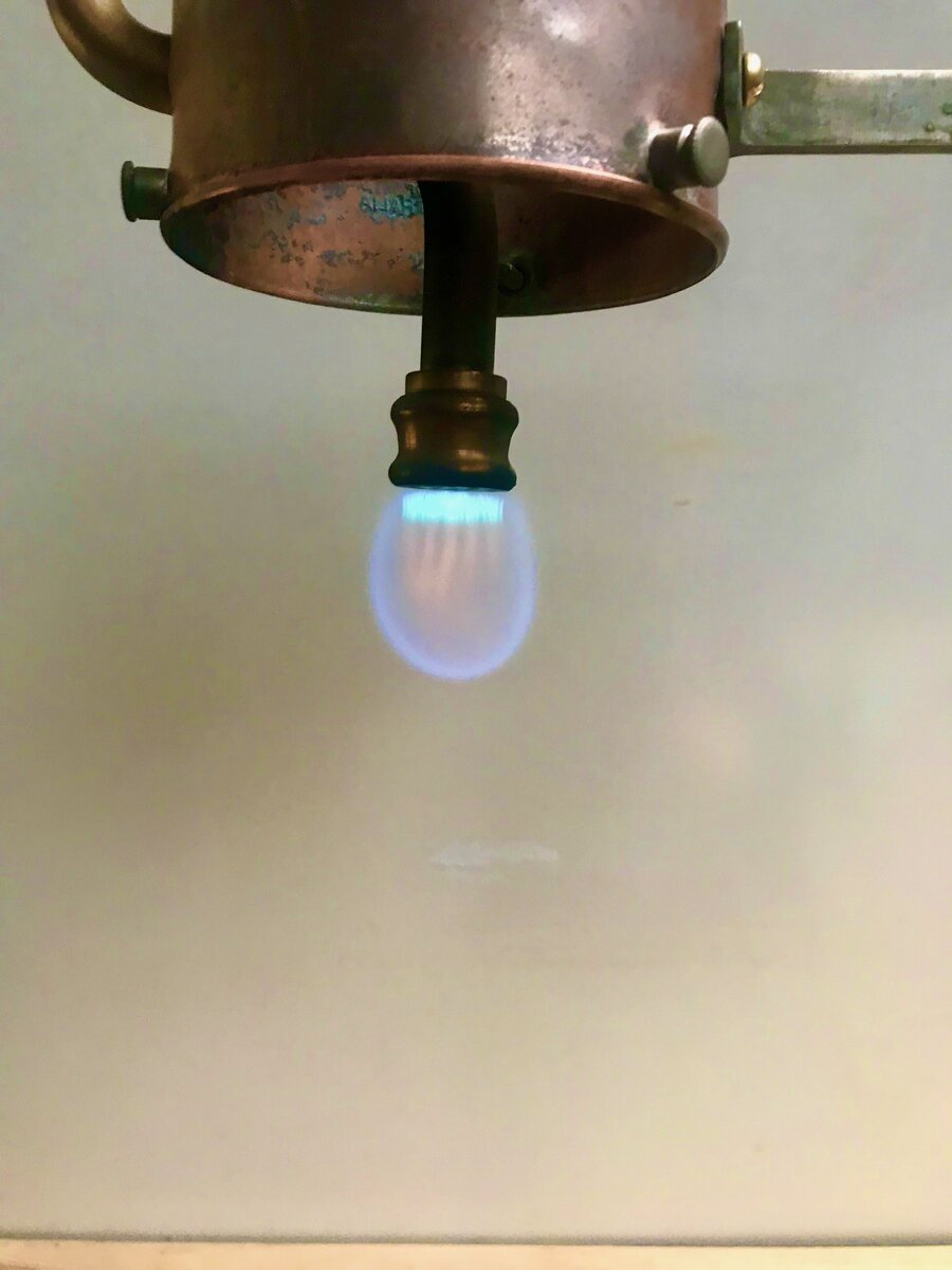

    It took me quite a while to get this lamp “tuned”. It burned a little bit rich, and minor adjustments did not make much of a difference.
    But… I finally stumbled on the problem. Over the years a layer of hard, lacquered carbon, about 2mm thick, had accumulated in the “S” bend of the burner tube, resulting in restricting air intake in the burner. This could not be seen but found with much poking and prodding.
