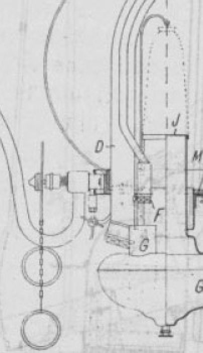

    Thanks Conny :D/ . This is the closest I have seen to the one I have :thumbup: .
    The lowest part of the burner is the same, and the burning-princip is the same.
    The biggest diffenrence I see is where the lowest part of the tube from the tank - goes in to the burner. I dont have the opportunity to shut of the fuel here as on the "Swet".
    The "Swet" carrys the same shape of tank and screws to attach the bottom plating as mine so these two lamps "know each other" in some way.
    I actually did find a old Sct. Petersborg map from late 1890 made by a englishman in my search for the adress: 5-ая Рождественская 44-12 but the map wasnt detailed enough and as Henrys picturesearch - only christmastrees appears :D .
    When I translate the "СВЬТОЧЬ" then sometimes the Swetoch, Svtoch or Svitoch appears - close to your discoverys name Swet.
    I actually did go in to the Polytechnische Journal - but didnt find anything ](*,) :oops:
    I wonder how old this "Saloswet" is? I dont doubt my lamp would be same age as details of materials, solutions and burner is almost identical.
    The best part of your discovery is that it strongly suggest how the globe/chimney arrangement is ment to be, despite of this annoying piece of metal I still have to figure out the purpose of :-k .

    Hi Claus, as for age - the article from which this Saloswet lamp drawing is retrieved, was written in 1910.
    /Conny

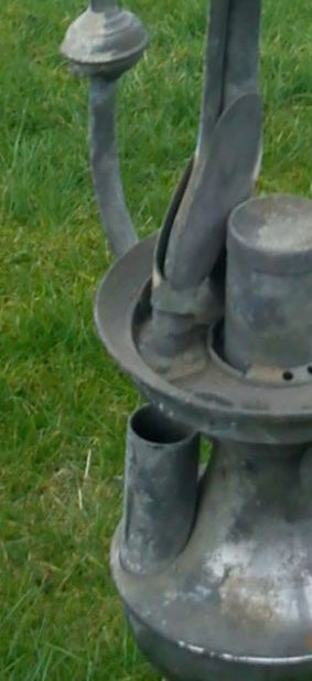

    This lamp had some seriuous stresscracks in the donut-tank, and today I deccided to leave this restoring for proff.'s.
    These proff's told me they had to drill a hole in the tank to pull out the bulges and afterwards fill it up with silver so it was possible to re-brightnickle the lot.
    The glass is to be made by a glass-blower ín the city of Århus, but to do that I was needed to deliver the template/form made of wood. Fortunatly I can make such a template/form my self, as I am a "woodworker".
    Next is to wait - but why :?:
    Well I have to wait while my russian contact, a mature nice lady, is contacting the Sct. Petersburg, local-historic museum, to see if they can tell how the chimney would look like.
    I might be so lucky that the Sct. Peterburg museum even might have a advert for this lamp, at least that is my hope, but time will tell.
    The company who started the production of this lamp was founded in the mid 1600. It sound old and impossible, but here back home we have Companys that dates back to the year of 1100 so why not :-k
    I will return when my contact, Tatiana, gets more information from Sct. Petersborg local museum.
