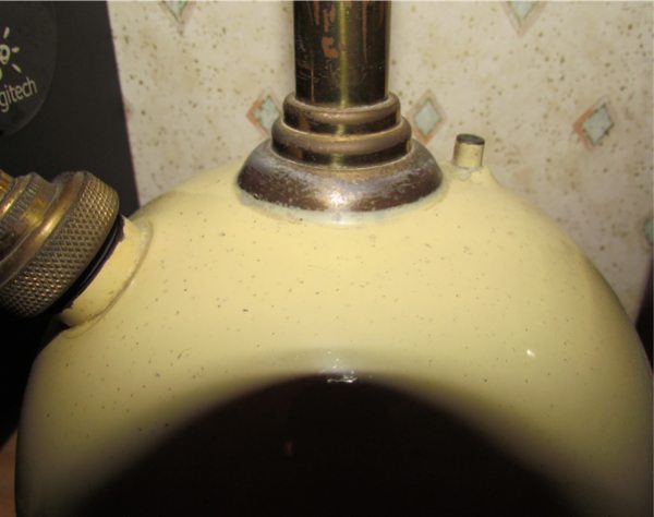

    Going back a few posts to Mathew's pictures, is that he original paintwork?
    I notice that the little pressure pip and the collar that the pump screws into both appear to be painted but not the "bump" on the top of the tank where the handle attaches...

    Gneiss, it is indeed to original paint job. Here is a better picture of where it painted to at the top. It does lap up that bump under the handle a bit but If you are masking yours off to paint I would have a crisp line around and not lap the paint on to it.

    Thanks, that's a great help when I come to painting mine... :thumbup:

    Looking closely at that area on mine I'm now wondering if that overlap is deliberate... On mine I have a series of what superficially look look stress cracks all the way round the bottom of that bump, looking through a jewellers' eyeglass you can quite clearly see that these are tool marks - so I wonder if they just extend the paint up the bump a bit to cover those up.
