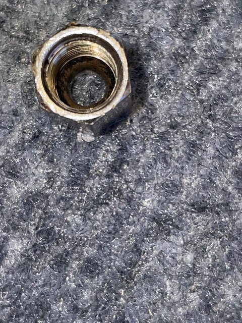

  12. Turbo_100 United States
    Jan 10, 2025
    27
    Sweden
    Hello all and thanks for inout.
    Nils, I bought the tool for replacing the pump valve and it was in the it so I replaced it. Will try to servce the old just for learing and saving after this project is done.
    Was able to remove the glas without break it by using socket wrench (as Matti suggested - thanks) and "thumb pressure", it took quite a bit.
    Outer packing was easilly removed after 1 min in simmering mild acid but I was not sure the glas could take that treat.
    I was fighting a bit with the gland nut assembly (spindle I think its called), there was basically no threads (i think) left and it did not go smooth to turn. I nocked the shaft out from the nutwith a plastic head hammer.
    There seemd to be some burrs on the shaft so the nut was not moved off easilly, also the sliding dual thread piece could not pass over the burrs.. I cannot feel them with my fingers so it's not much.
    After polishing the rod the graphite packing slides well and the threded asembly rotates nice but cannot be pulled out completely, but I dont thnk that matters, also there dont seem to be any gasket on the assembly of below towards the lamp, only the graphite, is this correct?
    [​IMG]
    For the nut I thik I got the praphite packing out, what is you opinion?
    [​IMG]

  14. MYN
    From the picture of the Optimus parts list, the 'spindle' is called the 'Excenter' part #105. This can be fully pulled out from the body or 'nipple for excenter', part #107 as is referred to in the list.
    The excenter rod or spindle of your lantern might be slightly bent or perhaps still partially stucked in the axial direction by hardened residues or some portions might still be having a burr or two. You do not necessarily need to pull it out but do check that it is straight enough to work properly.
    Old, used graphite or 'plumbago' packings usually wouldn't loosen out from the gland or sleeve nut, part #113 that easily. They are usually deformed and somewhat expanded within the nut, holding it in place. Since you have polished the excenter rod, you'd then need to check the clearance between the packing hole and the excenter rod while spinning it a bit. The amount of clearance should not be so great that light can be clearly seen through the gap. If the packing appears overly compressed by previous tightening of the sleeve nut, it may need replacement.
  15. Nils Stephenson
    3,405
    To start with, there isn't any washer or packing between the excenter assembly and the lower vapouriser. It is just a metal to metal seal.
    Now for your questions.
    1. I would use a light oil like a hobby oil or sowing machine oil. Soaking is fine but I usually drip oil into the upturned cup of the leather and let is soak for a while. You can see when the oil has penetrated the leather. It should be moist but not dripping.
    2. I would normally fit the lower vapouriser to the tank as one of the first things. That way none of the other fittings get in the way. You should aim to align the cleaning control over the Optimus logo on the tank.
    3. It is basically a case of 'feel'. The main thing is that you can only tighten a lead washer, never loosen it. If it tightens past the point where you want it positioned, there is no way back. This is why a lot of us make our own washers by punching out of lead sheeting.
    4. The best way to check for leaks is to pump up the tank with nothing in it and then put it in a bucket of water. Any bubbles will reveal leaks.
    5. There is a gap in the mounting ring for the level gauge so it can only be fitted one way.
    It's good that you are asking questions and adding photos. After this one you will be ready to try another one. :)

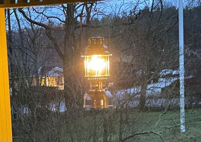

  19. Turbo_100 United States
    Jan 10, 2025
    27
    Sweden
    And this is the mantle, looked quite lage..
    [​IMG]
    You think I am OK to give this lantern away to my friend?
  20. Turbo_100 United States
    Jan 10, 2025
    27
    Sweden
    Another pic of the lantern i action
    [​IMG]
  21. Fireexit1 United Kingdom
    3,536
    It all looks fine to me - a good job done. :clap:

  24. Nils Stephenson
    3,405
    Great work and it all looks good. Well done.
    The alcohol cup should not be under the mantle, it is the vapouriser that needs to heated.

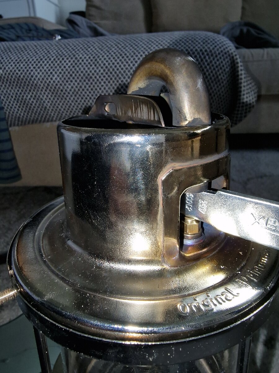

    It looks well done. A random flicker is nornal. The spirit preheater's position is such that the flames of burning alcohol would impinge more on the vaporizer rather than the burner or mantle. The vaporizer needs to get hot enough to work properly.

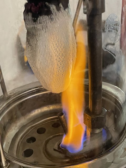

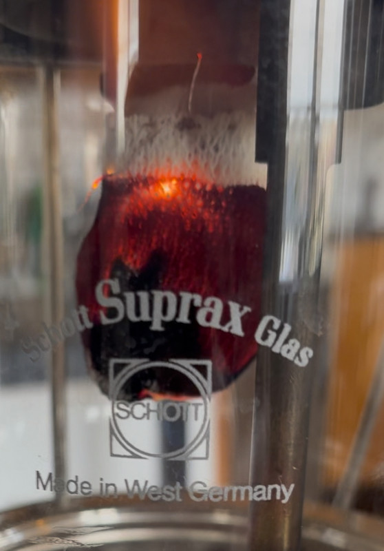

  27. Turbo_100 United States
    Jan 10, 2025
    27
    Sweden
    Hello again guys -
    I tried to renovate another lamp (1st one i did was for my son and ofcourse my daughter want one as well..)
    Now the issue - I changed all service parts and it seems to build and hold pressure.
    When lit it was not shining bright like my other lamps, but glowed a bit down below the "sock" and flames around it, after some 15 minutes the glow-net (sock) turned black.
    Still pressure but I turned it off.
    When lit it looked like this:
    [​IMG]
    After some 15 minutes it looked like this:
    [​IMG]
    Any ideas?
    The sound was like the other lamps, and as said no leaks detected.
    I have a feelng thar the net (sock) might have been faulty as I think I could see som minor flames coming out at below but that might also be my imagination..
    To note I also adjusted the cleaning needle to get a bit higher as I could not feel it with my finger top when revolving the cleaning-wheel, so now I can feel the tip like on my other lamps.
    Any advice is appreciated!
  28. Dashwood United States
    Aug 1, 2023
    275
    United States
    Ensure the nipple/jet is tight and snug with no leaks. Test for leaks by pumping it up a bit and cover the nipple, observe for fuel weeping past the threads. Leakage here will make the mantles over flame.
    Also adjust the air gap of your Jtube to around 14-15mm assuming the Jtube is identical to a petromax. Depending, certain tube clamps likes to work loose and drops, shortening the gap and making the mantles burn rich.
    If you have a petromax wrench, they are already pre measured to correct gap depending on the candlelight power rating of your lantern.
    Once set proper, reassemble and light as normal. You do not need to necessarily replace a darkened mantle as a proper burning lantern will slowly burn away the black back to brilliant white.
  29. Fireexit1 United Kingdom
    3,536
    I would try what Dashwood says first. The sock (mantle) is only defective if broken. It is a consumable really. But gaps allowing flames to shoot out will damage the globe (glass)
    Bad mixture, leaks and poor pre-heating tend to result in fireballs - your picture might suggest that there just is not enough getting out of the top. A lot of carbon inside the vaporiser (generator) can cause this as can the foot valve (the one at the end of the fuel pickup pipe) not opening fully. This might be due to the rod length being out of adjustment - or not engaged in the correct place on the bit behind the "valve" wheel. (the excentre) I have in the past managed put a Px type lantern back together with the little pip in the wrong place - so it failed to move the rod up and down correctly.
    You can try emptying the fuel, take the outer and inner hood off, pump it up and open the "valve" and should feel quite a good stream of air out of the nipple. Best done where there is no ceiling in case of fuel lurking. The lantern look to be in good condition !
  30. Turbo_100 United States
    Jan 10, 2025
    27
    Sweden
    Hello and thanks.
    The lantern was not so good before but elbow grease did the trick.
    I replaced all seals and stuff (the big servce kit including the pump valve and leather, lead gaskets, nozzle and jet).The pushrod works fine and I can feel the needle point comming up with my fingertip on top of the nozzle. - NOTE: I could not feel this after i changed the spares, so I adjusted the push-rod and extended it a few threads. Could this be the issue? Perhaps I should have tested it before adjusting but I read that the needle should pop out of the nozzle about 0.5 millimeters when rotated.
    I have now replace the mantle as I broke the other by accident and that did not improve wne I tried again.
    Still the mantle gets black and flames around it so I guess it is burning wet.
    I tried to keep my finger over the nozzle, pumped it up and no leakage around the nozzle threads, I removed my finger and a fine kerosene beam ejected from the nozzle so there where pressure.
    I am stuck and out of options so appreciate any hlp from you guys.
    Edit: It seems like the lantern is too rich on fuel and as I adjusted the neele to get higher up in the nozzle this might not seem to be the issue, lowering it would make the problem worse is my guess..
