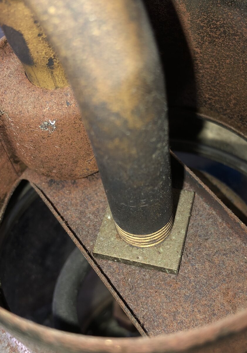

    I took a pic of a similar Optimus hoping it would bee the same for the 300

  4. Dashwood United States
    Aug 1, 2023
    275
    United States
    @Turbo_100 @podbros
    Excellent photo example, some are square nuts, others are hex but shouldn't matter.
    To increase the gap, loosen the burner nozzle several turns while pushing up the Jtube from beneath. This consequently raises the jtube and jamb nut up the more slack you give, in the turn this increases the air gap. Once desired gap, tighten down the jamb nut which will keep it at the proper height and gap.
    To reduce the gap, perform the inverse. Loosen jamb nut, let the tube drop to desired gap, then tighten the burner nozzle.

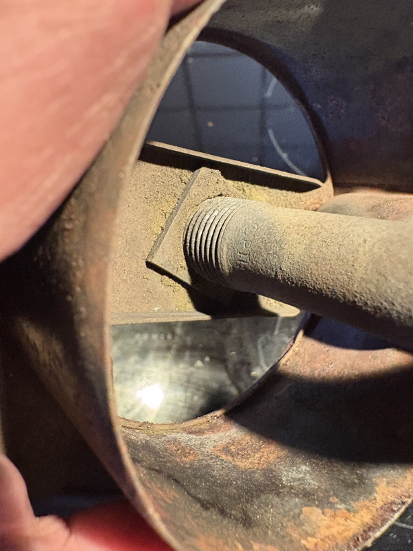

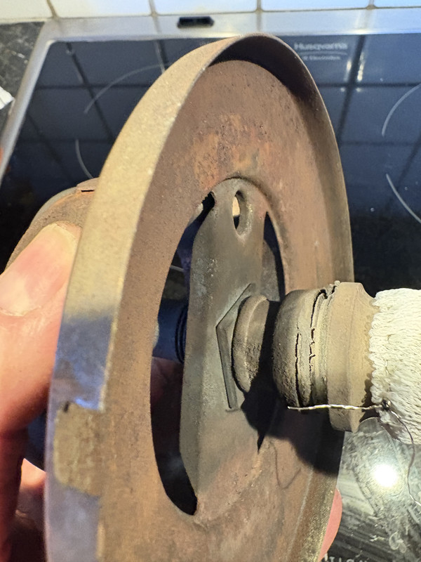

  6. Turbo_100 United States
    Jan 10, 2025
    27
    Sweden
    Hello, this is how it looks for me.
    All lamps are optimus to he best of my knowledge.
    [​IMG]
    [​IMG]
    Can I make sure it's not the needle that is badly adjusted?
    The air gap seems to be maximized already but please comment on this
    Thanks all for support

  8. Dashwood United States
    Aug 1, 2023
    275
    United States
    @Turbo_100
    Woah those photos shows that your mixing chamber (the component where your ceramic nozzles screws into) looks heavily degraded, I would try to find another more intact one, that is probably the most gnarly I've seen.
    The mixing chamber ensures air and fuel vapors are properly mixed, but yours looked very holed with threads exposed, leading to leaks and improper burn.
  9. Fireexit1 United Kingdom
    3,524
    That does look like a split on the mixing chamber - as well as part of it missing ? :(
