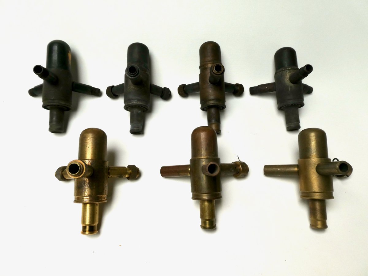

    I contacted the seller
    he offers to drill a smaller nozzle, which should go well with my "old burner" (!! ??)
    I am confused
    so I tried a new burner taken on a "modern X246" from 1975
    it works almost perfectly: no halo and acceptable light, even if the lamp smells a little kerosene
    I don't see a noticeable difference in the design of these two burners, I don't understand ?
    Does anyone have an explanation to this ?

    If it still smells a bit it must be running a bit rich.
    The "older" Tilley burners were longer, heavier, and had a longer mixing dome and injector than the 1970s Tilley burners. But I can't see the logic in what the seller is saying. The jet in the Tilley vaporiser did not changed in size.
    Old ones, top row:

    Yes Tony, I still not understand
    I checked the nozzle size with an acupuncture needle
    a 0.20 mm goes into the nozzle, 0.22 is too much
    so we are at 300 CP of power
    But the fact is, this X246 burner works better
