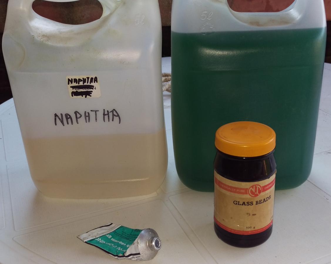

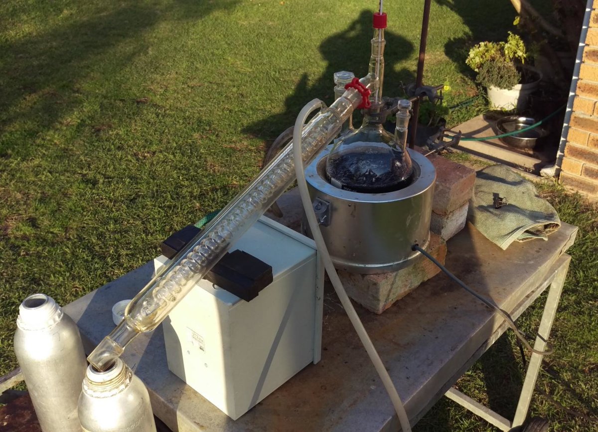

    Distilling petrol is no more dangerous than using the stuff in lamps if you observe the basic safety precautions.

    It is certainly easier to use Panel Wipe but, over here at least, it costs about twice as much as the distilled petrol (excluding the cost of the distillation equipment). I have a fair number of white gasoline stoves, lamps and lanterns that I would like to use regularly and this is the most affordable way I have found to do it. If your Panel Wipe is the same stuff as our Pre-clean, you may need to add 20% paraffin to it to get the "strength" right.
