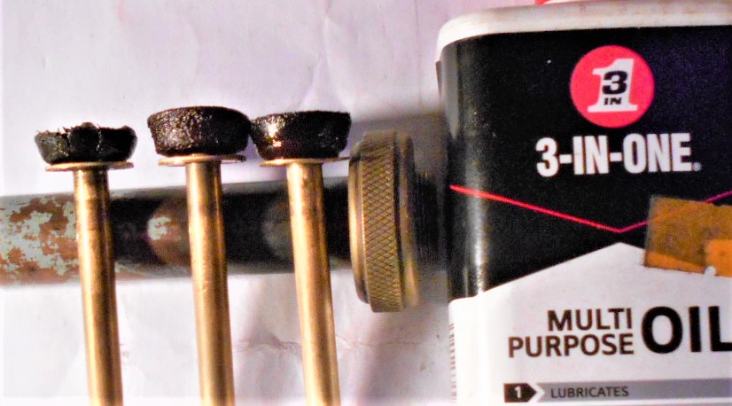

    Hello everyone and Happy New Year,
    I am down to just one chick out of 5..Bonny isn't a great mother..she let two chicks die in the freezing weather when I was at work.
    Anyway I emptied the fuel from my Tilley X246 lamp tonight,pumped a good bit with the control knob closed and immersed the lamp in water.
    I couldn't see any bubbles coming at all.
    I did this test with my Petromax lamps and I got bubbles under the pump.
    That is all I have done so far.
    I am making beeswax candles though too.
    I haven't done any more with my petromax or my christmas gift yet.
    Hugs,
    Fiona
  29. JEFF JOHNSON
    16,914
    Happy New year Fiona, fae Jeff in Shetland.
  30. Henry Plews
    3,068
    Happy New Year Fiona.
    That's a shame about the chicks. It must be a little disheartening after all the effort you've put in to improve / increase your flock.
    Going back to the problem you were having with your Tilley, well it sounds like your Tilley is airtight providing the pump is working effeciently. Here are three leather washers from Tilley pumps, admittedly the one on the left is a little worn but they are all nicely oiled and supple and should work well.

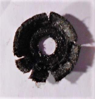

    But look again at the leather on the left. This one had splits in it which let the air go past it and back up the pump tube instead of down through the NRV (non return valve) and into the tank.
    Obviously, these splits became exaggerated when I opened the leather to photograph but you get the picture. No pun intended.
