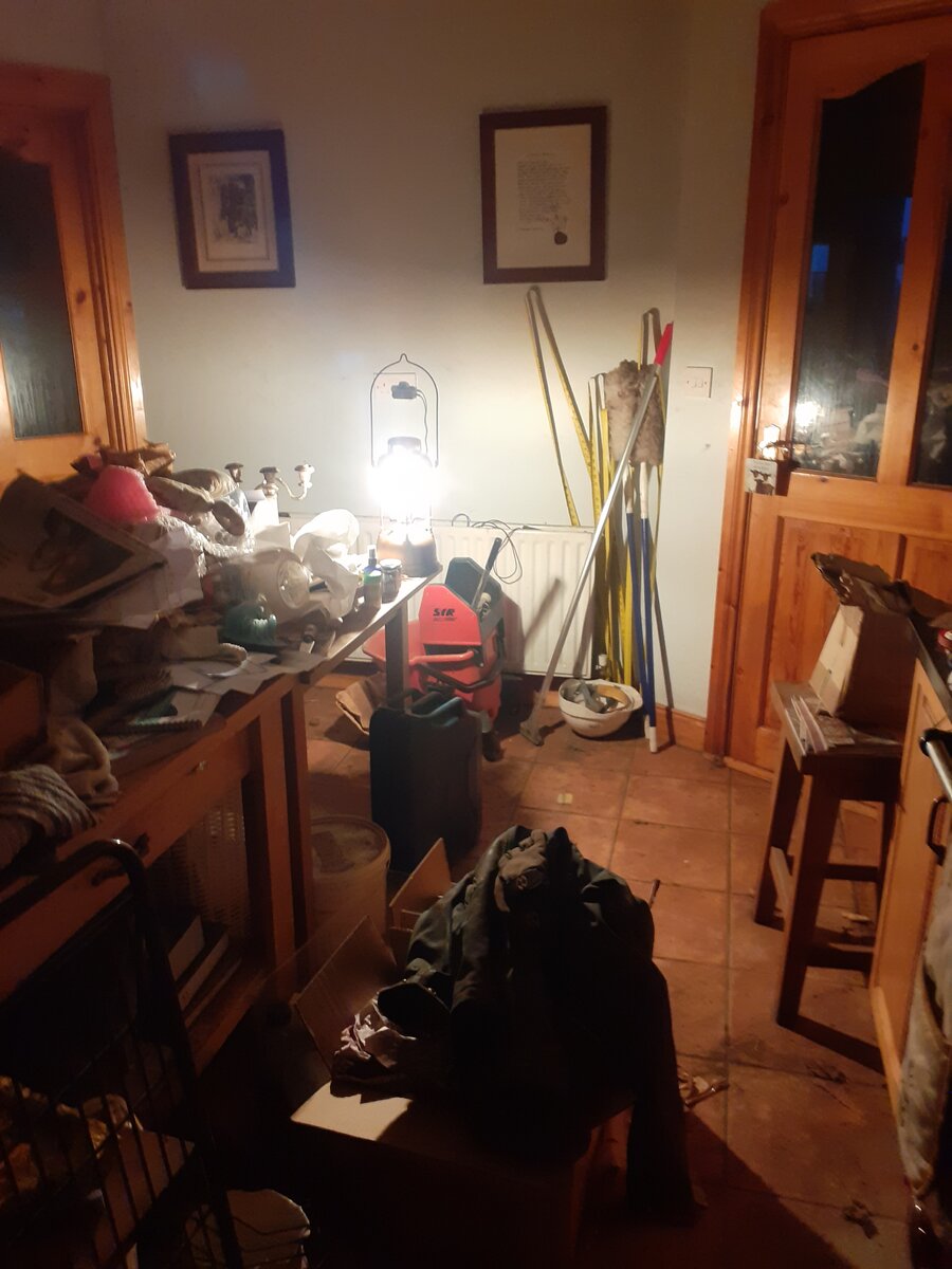

    I changed the leather cup in the pump and then tried it..it has been flying since.
    I am.getting neatsfoot oil tomorrow but put a little leather food and chainsaw oil on it and a little vegetable oil,I won't put any more vegetable oil on it.
    My Tilley is super..thanks so much everyone

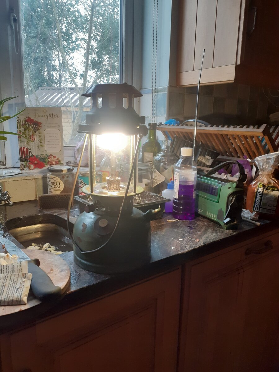

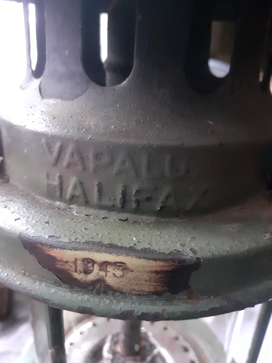

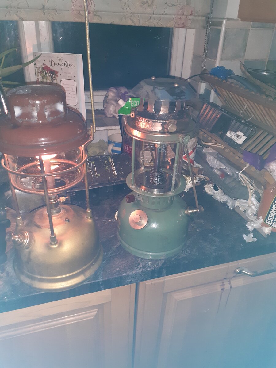

    I changed the pump clamp washer,the leather pump cup,pip and the 3 washers in the control cock and bottom of vapouriser and junctions.
    I tightened all by hand and then just last night I decided to move the little brass part behind the leather pump cup around the other way and that has much improved the pump efficiency.

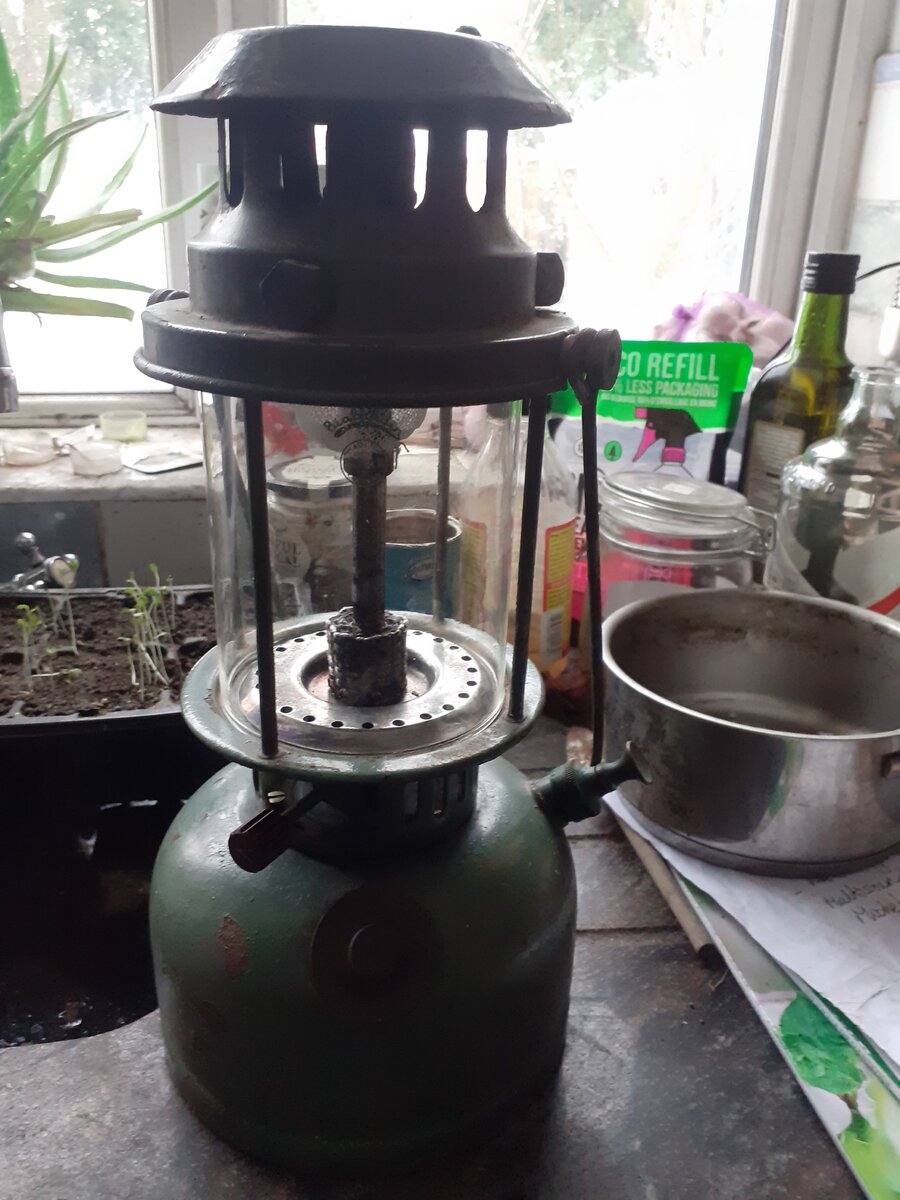

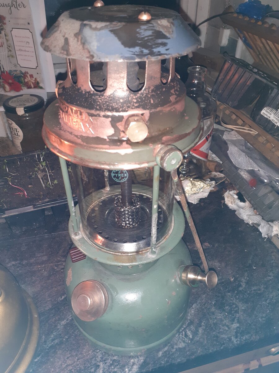

    I also bought two more lamps..a 1943 Vapalux 300X and a Tilley X246 lamp.
    I lit the Vapalux yesterday and it is working well but the light fades and gets bright again when I pump.
    I ordered a washer kit for this old Vapalux lamp.
    I haven't tried my Petromax lamps as I want to get s spirit dish(to go around the vapouriser) so I can soft start it.
    I need to try to put the Petromax HK500 new lamp back together(the needle and vapouriser)I wish I hadn't taken it out now.

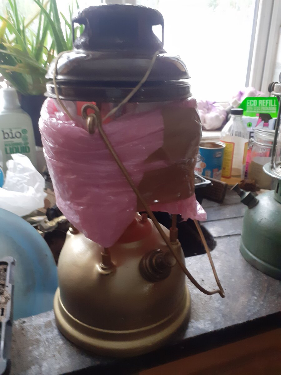

    Here are some photos.
    Thank you to everyone very very much.
    You are all so kind and helpful.
    Health and happiness and peace to you all.

  22. steerpike451
    Jun 29, 2016
    183
    Norfolk, UK.
    Sounds like your Vapalux is losing pressure, replacing the seals should fix it. They're a little bit more complicated to service than Tilleys ;you need a large flat screwdriver to get the valve out of the bottom of the pump tube. Looks like someone has painted the hood- I'd advise stripping it off, as it will burn off when the lamp is running.
    Those are two nice lanterns- the Tilley is from 1950 to 54, the Vapalux looks to me pretty much all original for 1943 apart from the glass and spirit dish which are maybe 5 to 10 years later.

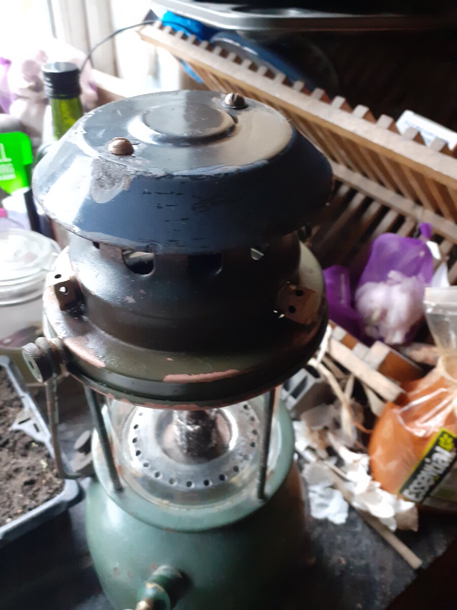

  23. Fiona Farrell
    Fiona Farrell Ireland Subscriber
    Oct 9, 2020
    103
    Ireland
    Thank you Steerpike,
    I ordered a vapalux 300X washer kit on the fettlebox last night.
    I have started to try and clean the hood with just a lemon so far..
    Thanks very much,

  26. Fiona Farrell
    Oct 9, 2020
    103
    Ireland
    Getting the paint off..
    Does anyone know if this is a Vapalux 300 or 300X please.
    Hopefully I ordered the right washer kit.
    The seller advertised it as a 300X.

  28. ColinG United Kingdom
    4,815
    It's a 300 I believe... can anyone confirm that? If you look in the Reference Gallery under Great Britain, Vapalux you'll see the 300 folder with other examples.
  29. george
    Yes, Vapalux 300, really like that one!
