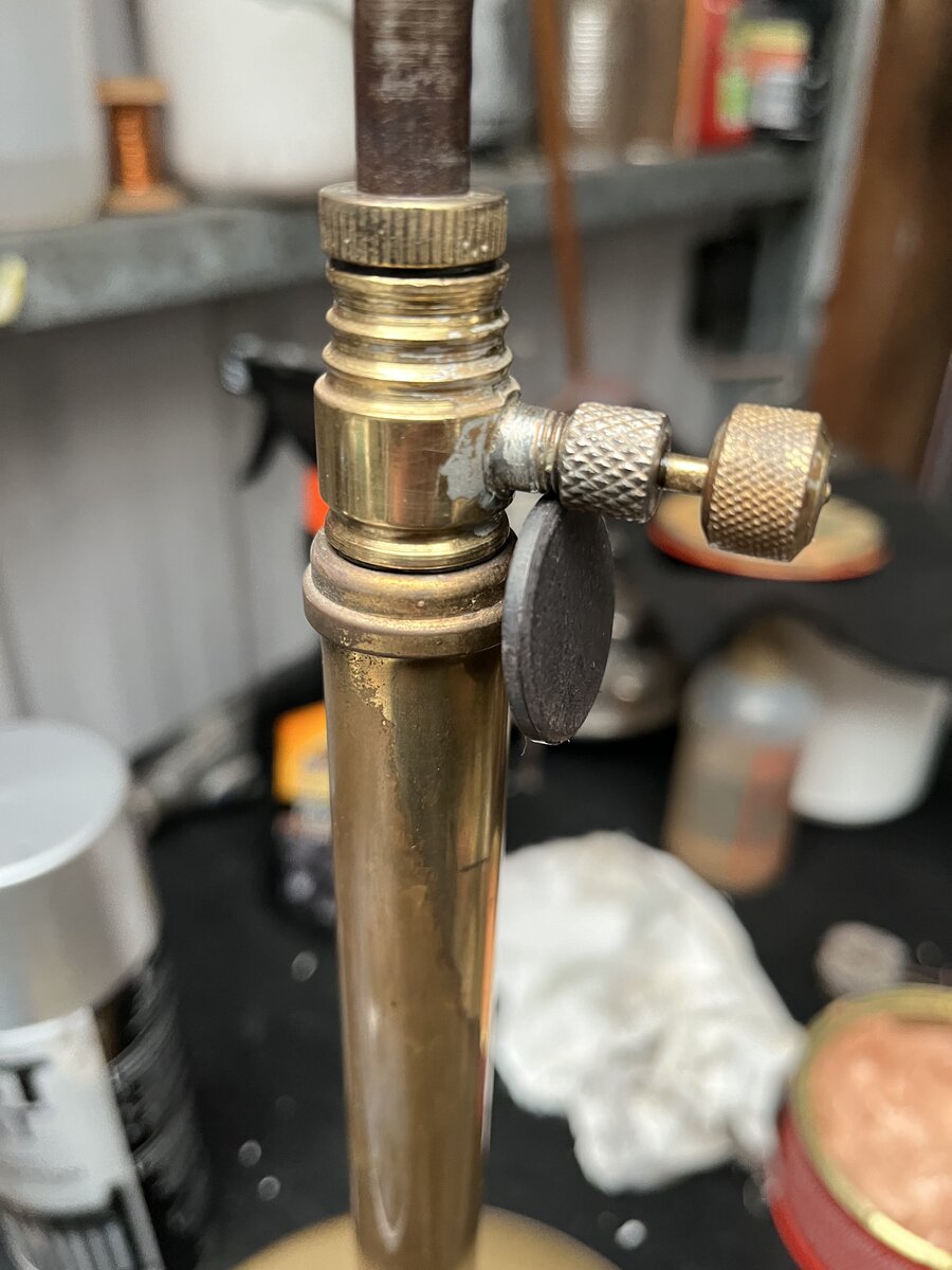

    Here is one of those WWII Tilley control cocks with the brass knob and steel thread. It is on a 1945-1949 Tilley 106 Table Lamp.
    Note the magnet.
    16,574
    Hello Tony, some of the original paint can still be seen on that one and in my experience they were all painted that colour, most of the ones which I have had turned up on WW2., PL 53 lanterns like the one which is shown via the link below, skol fae Jeff.

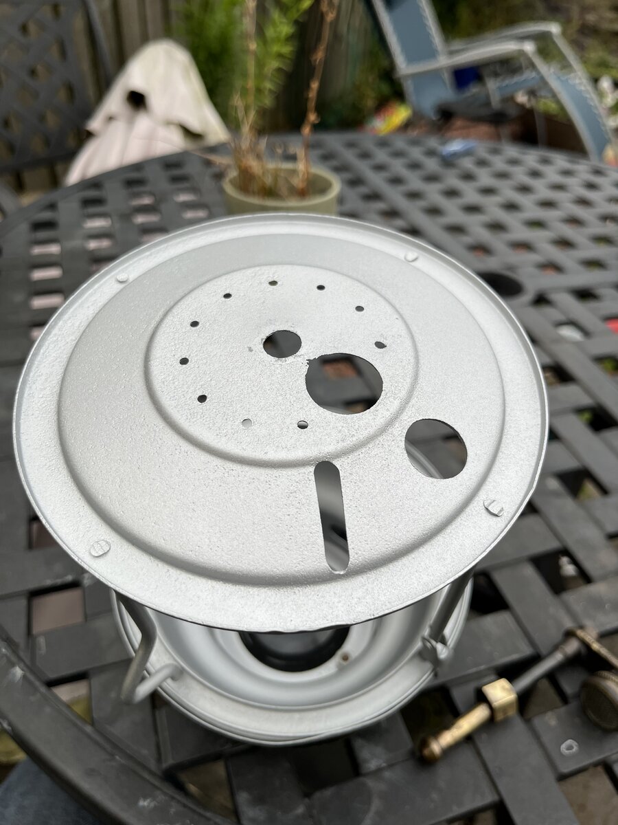

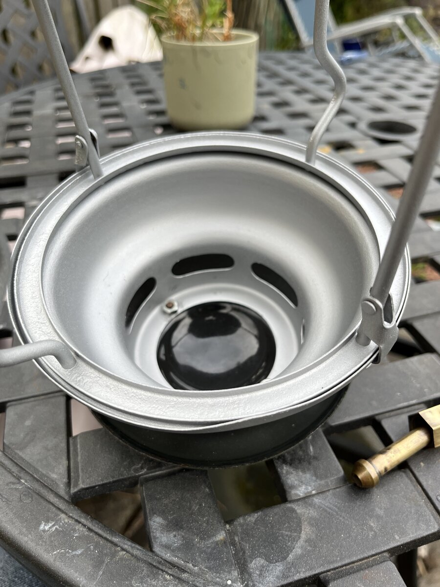

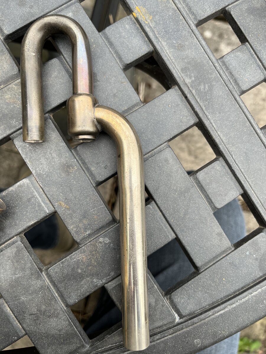

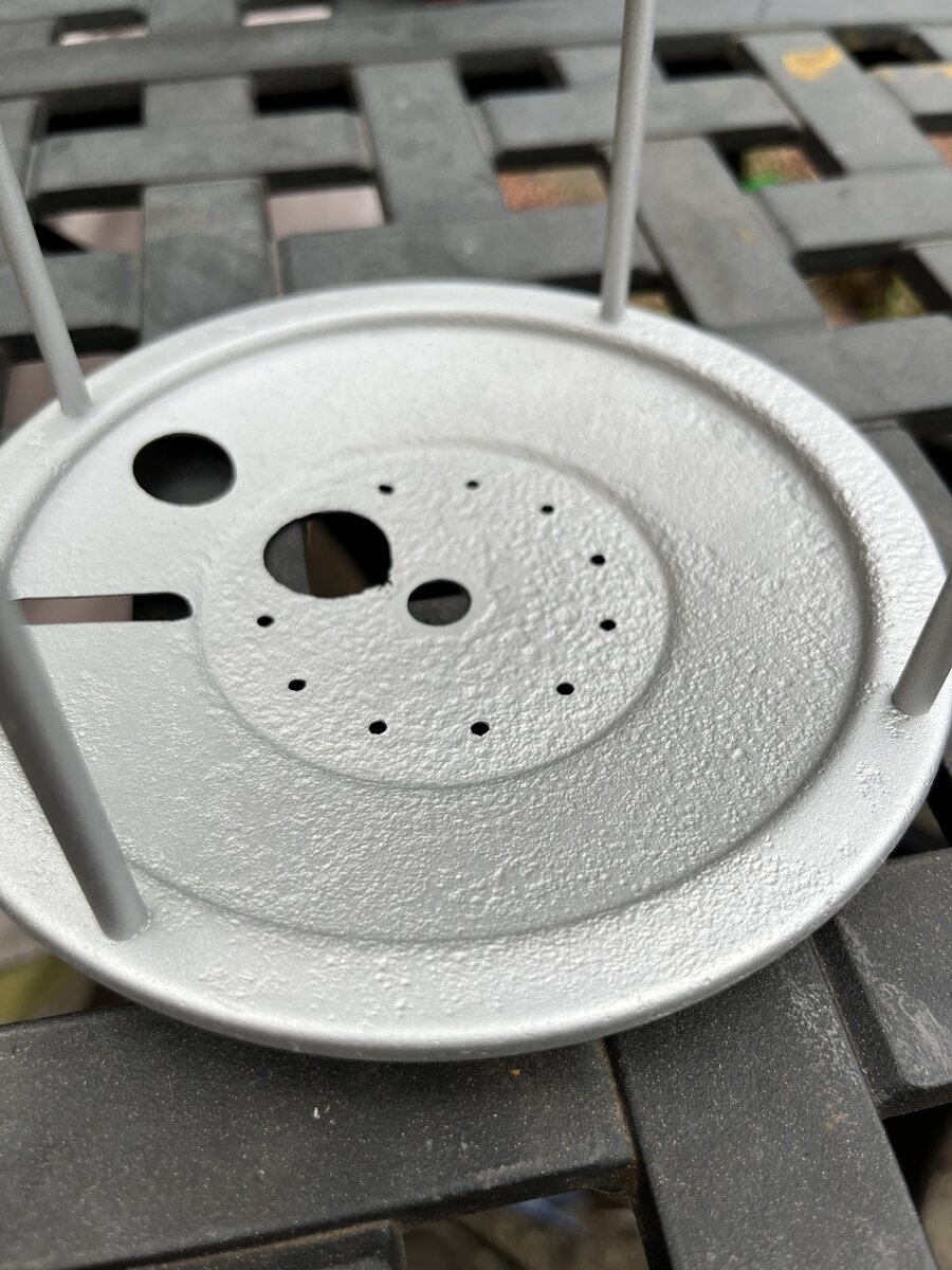

    Slight delay while I’ve been wandering up and down the country with work… anyway … some progress on the Veritas. Parts stripped and treated with high temperature aluminium paint - note how corroded the cage is. IMG_3624.jpeg IMG_3625.jpeg IMG_3626.jpeg IMG_3627.jpeg IMG_3628.jpeg IMG_3623.jpeg Vapouriser assembly and air piping also cleaned. Not fussed about getting them highly shined as will be very much a working lamp. But, suffice to say they look a LOT better than when they were coated in black and white gunk! Hood will be cleaned a bit more to remove the last stains. Brass screws are ex Bialaddin as originals were wrecked. Tank is now stripped back revealing steel base - all seems to be in good nick. Does anyone have a good car paint match for the Veritas green? British Racing Green maybe? Anyway… here you are

    Good progress and the condition is okay for a lantern that is over 70 years old.:thumbup::thumbup:

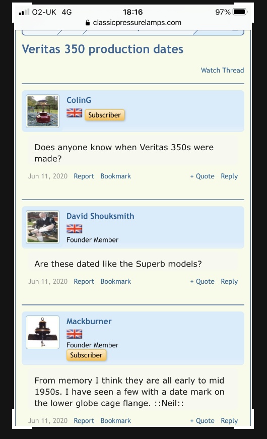

    Did a search for dates + found this thread..
    Regards,
  11. JEFF JOHNSON
    16,574
    Hello Chris, the Veritas Superb and the 350 were certainly around in the 1950's, but I'm not certain how long their production runs were.
    The links below show relevant information. Automedon

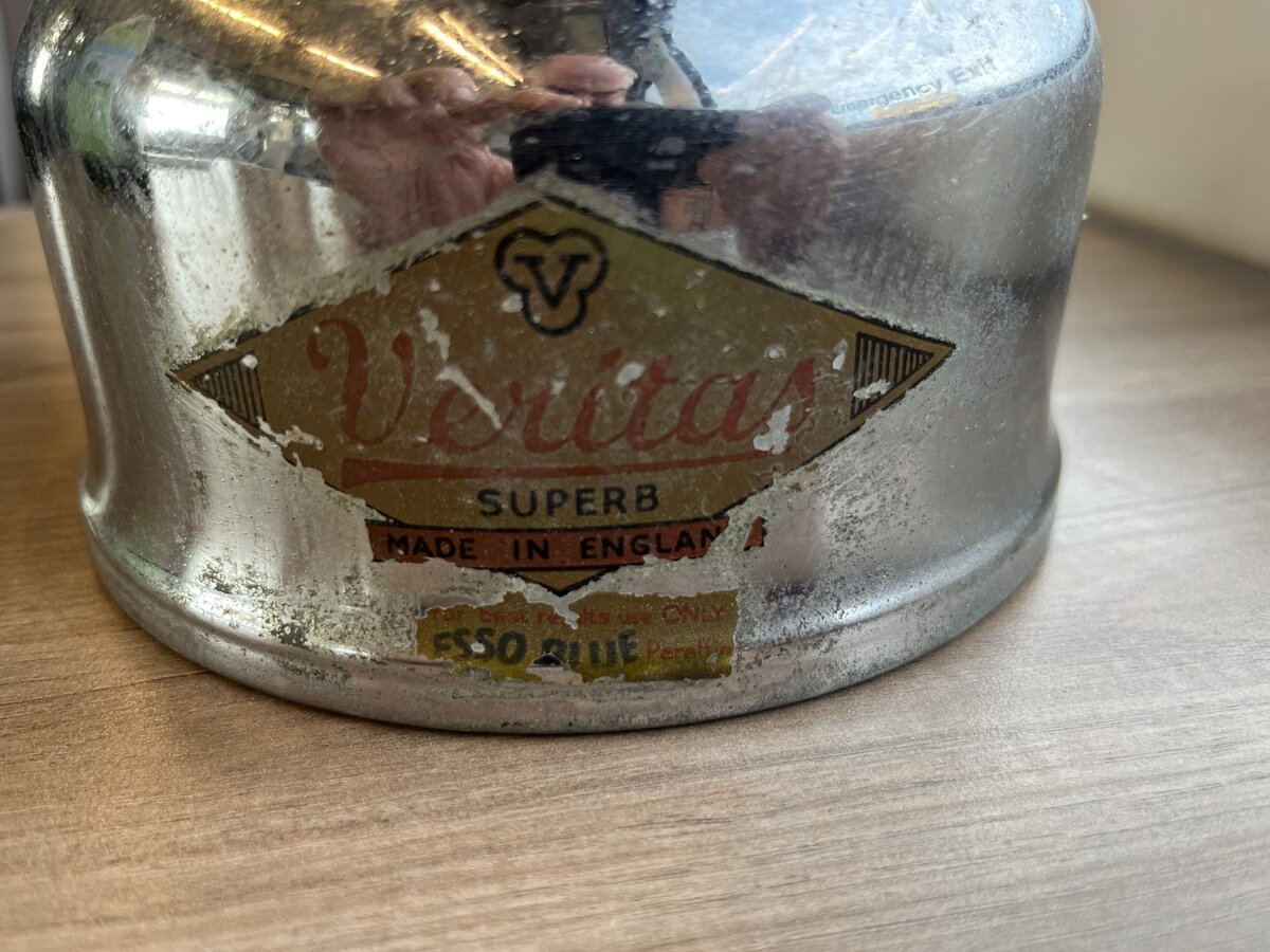

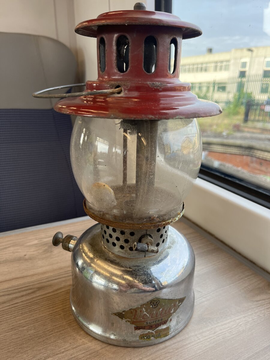

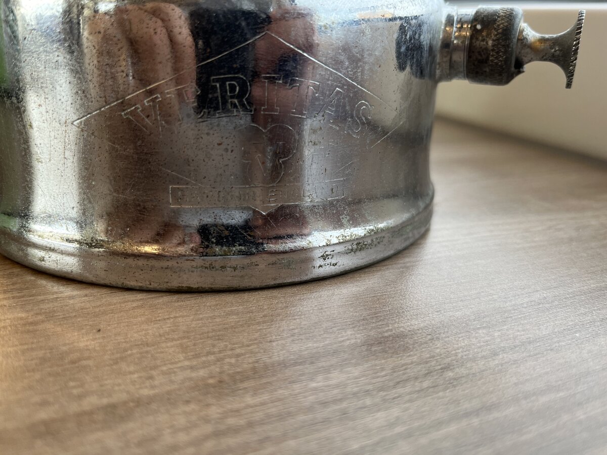

    Apparently these Veritas’s multiply given half a chance. Picked this up today for £10… it had been sat in a shed since 1959. Complete but fettling will be needed … here we go again. I’ll post better pics later…

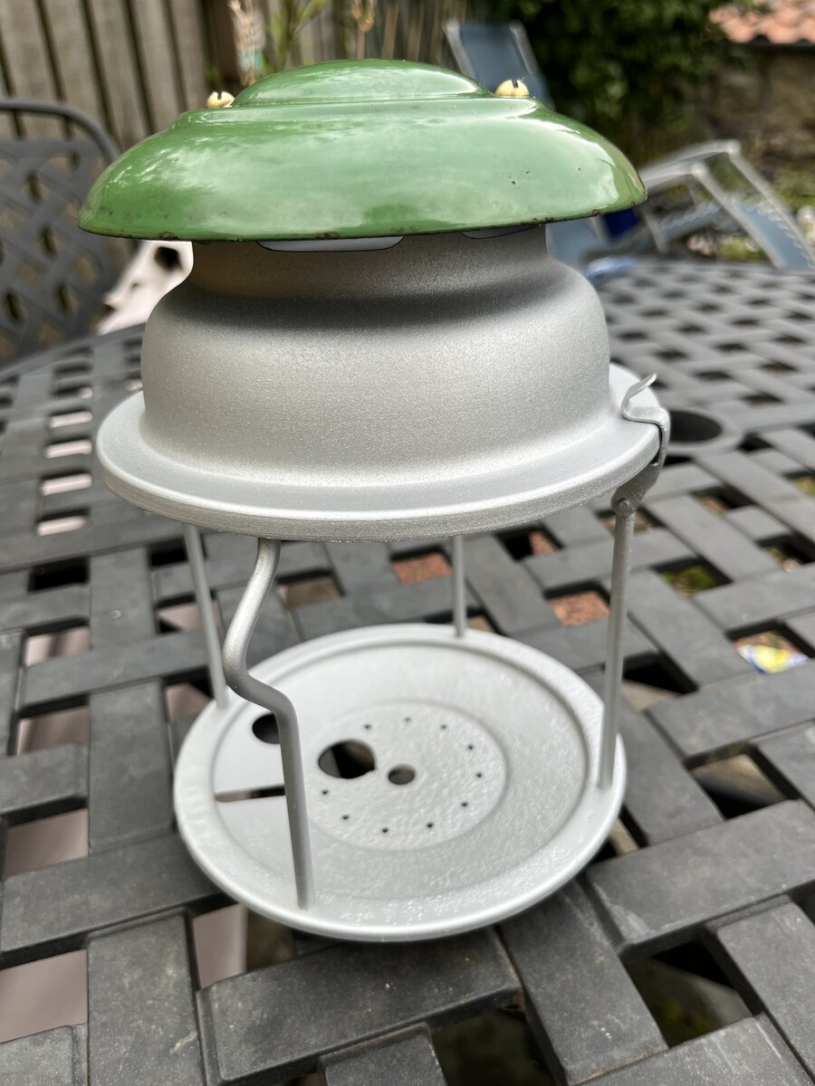

    Thank you, that’s interesting gen indeed. I’m pretty sure the green on this example was the original and not an aftermarket slap on like the rest of the paint encountered … I’ve found a very good match and will be priming and spraying at the weekend. After that it’s the seals and glass… I’m going to do a test fit with a 300X glass as that looks pretty good to my eyes

    The Superb looks to be in good condition and a bargain at a tenner.
    Look after that glass! A straight cylinder from a Veritas 350 will fit but as far as I know, there's no modern day bulge glass that is compatible.

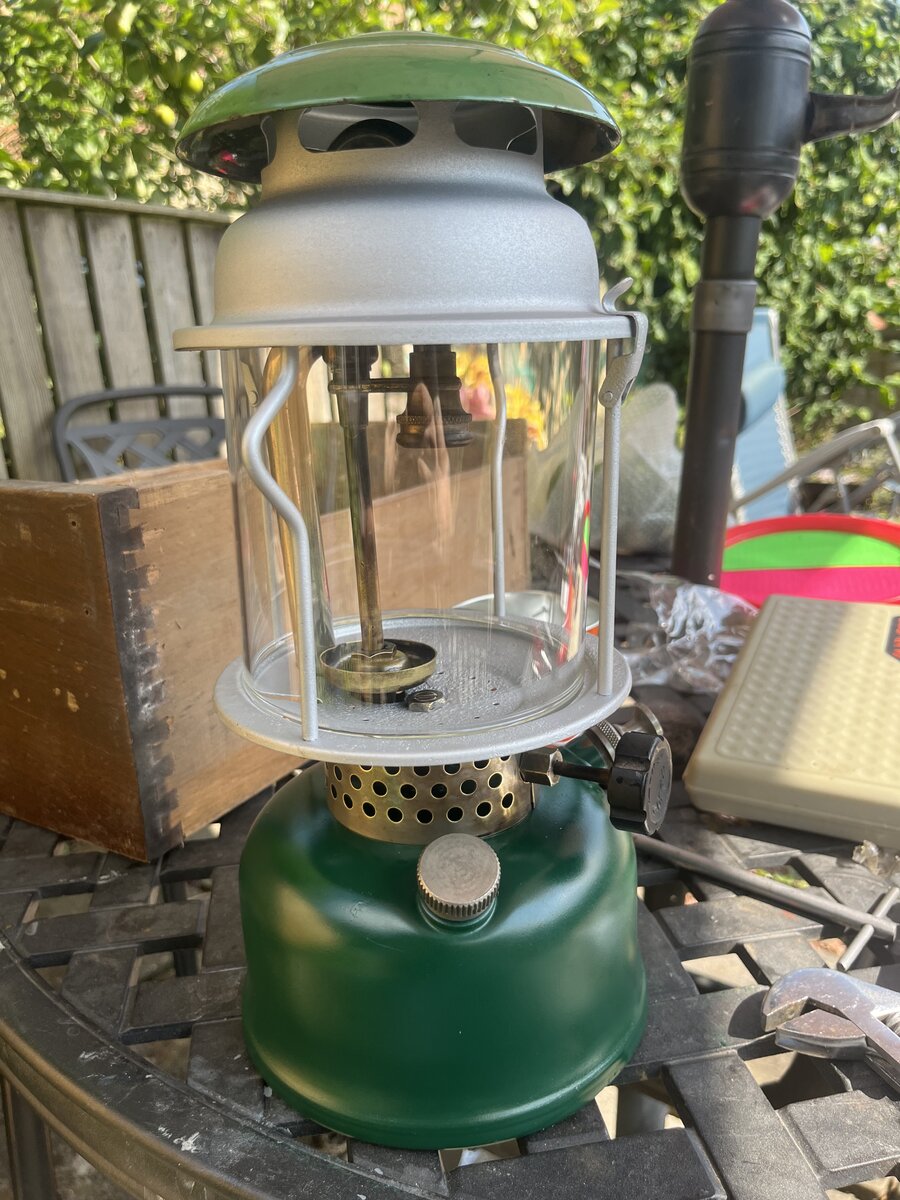

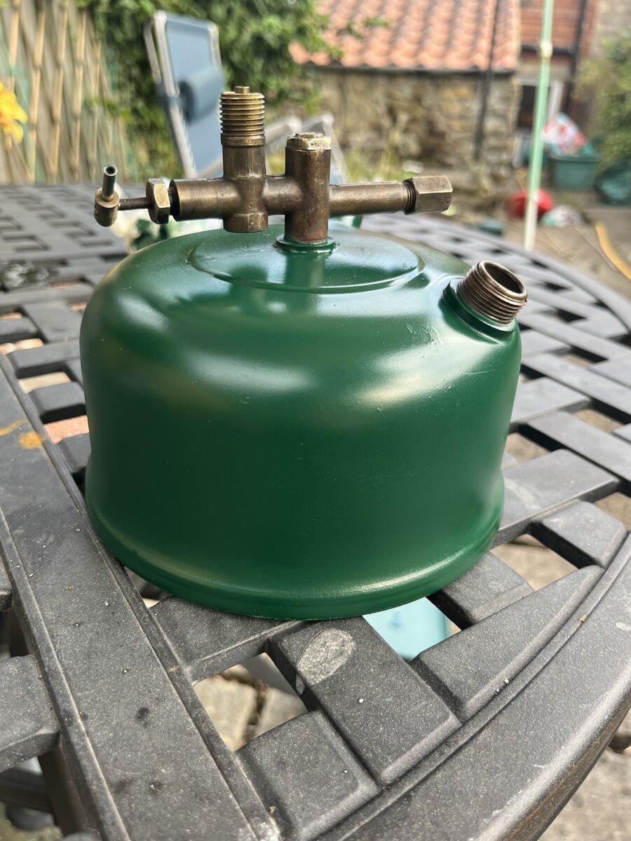

    Some progress … sprayed in what looks to my eyes a good match for the original green. Certainly transforms what was a wreck, and keeps its place as one of the (few) original green and not cream Veritas’s. Seals and glass coming tomorrow … I sense first light coming soon :D/

    Current state of play…
    There is a slight issue in that the pricker mechanism is tight after inserting the two o rings that came in the seals kit, and the needle isn’t as visible through the jet. The cam is working though, the needle is still attached to the pricker and the jet is unblocked… and all nuts etc are tight. Intriguing! May well go for a light tonight… wish me luck!
