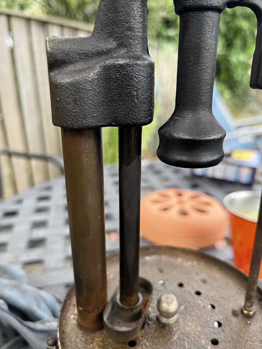

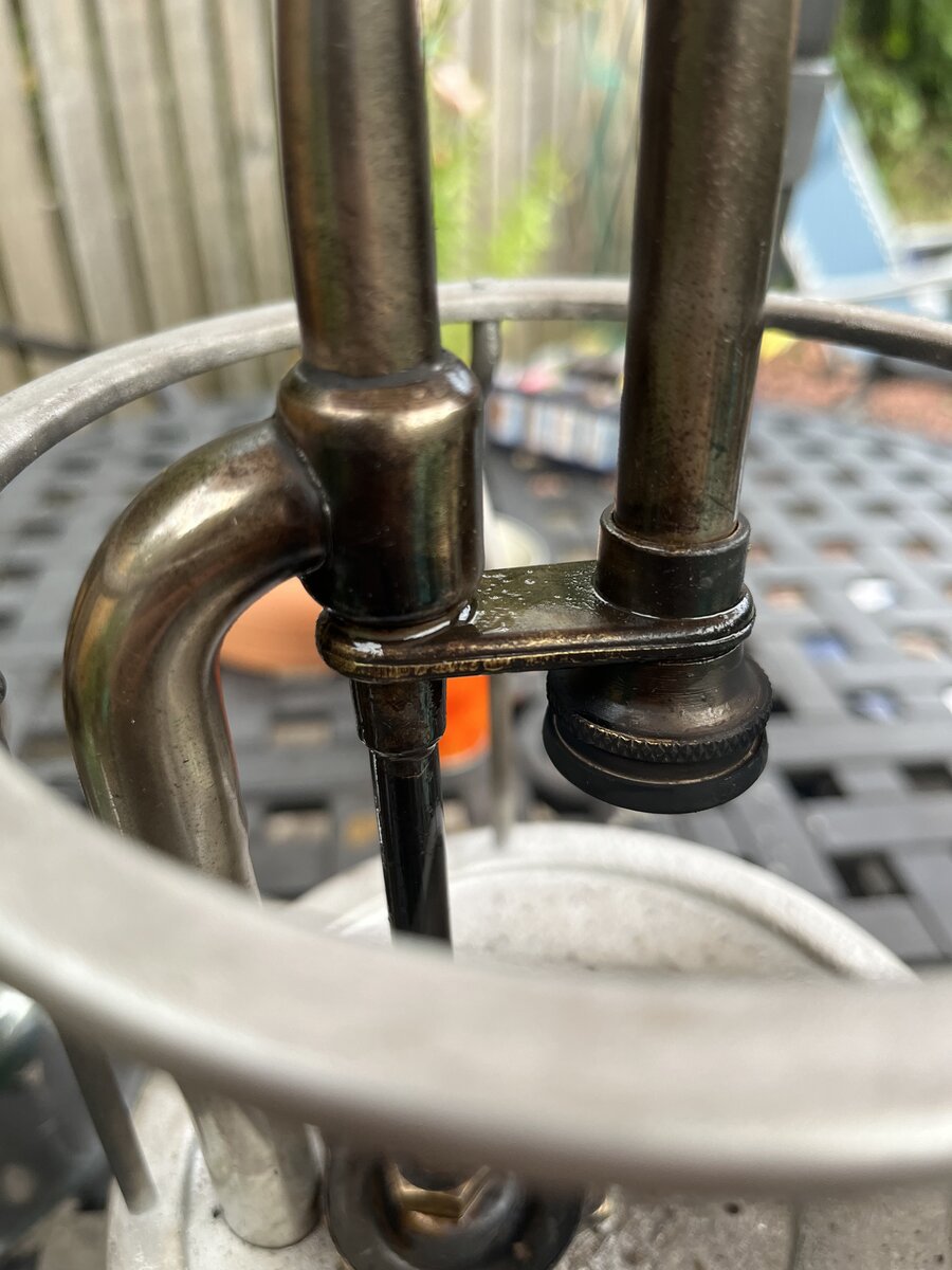

    I have indeed … I’m pumping 10 strokes beforehand as opposed to the 30 recommended in the instructions and using two pre-lights in the meths cup.
    In every case - with or without glass - windy or not the result is the same. Paraffin leaking from the joint where the vapouriser meets the burner tube and igniting, followed by either vapour or paraffin flowing back down the air tube and also igniting. This makes turning the pricker up interesting.
    I’m running out of patience here tbh as I’ve taken the things apart and replaced every seal and gasket - there’s no problem with jet size now and the tanks pressurise perfectly.
    You can see where the paraffin is leaking from in both cases - as it’s exactly the same on both the superb and 350. The tank filling with concrete is looking very tempting right now …

  2. ColinG United Kingdom
    4,808
    It might be that someone in the past has over tightened the jet and messed up the threads so they no longer provide a seal. If this is the case you'll need a new vaporiser tube which I might have.
    Resist the concrete option, these really are great lanterns but they're all getting old now (like a lot of us TBH) and some of them have led very hard lives! The more lamps you collect, the more you see some truly appalling 'repairs' inflicted by past owners and sometimes you simply have to admit defeat when the damage has gone too far!
    Good luck and PM me if you need any parts.

  4. MYN
    @Automedon
    I would suggest you remove the mixer U-tube to inspect, test and verify if there is really a leak at the jet threads at all.(without lighting it yet of course).
    The fuel flowing down from the interface between the vaporizer and mixer tube might not always be originating from a leaky jet.
  5. ROBBO55
    4,334
    I have the impression that it lights with a blue flame then starts to splutter and leak.
    How long does it run before the spluttering starts?
    Without a mantle there isn't enough heat to maintain vapourisation of the kerosene for very long. I have had this type of vapouriser setup to maintain a blue flame for only a minute or so before I had to apply more heat directly to the vapouriser.
    The nipple needs to be more than finger tight and copper grease can help.
  6. Automedon
    Automedon United Kingdom Subscriber
    Jan 28, 2024
    107
    Kirkbymoorside, God's Own Country
    Hi @ROBBO55
    Neither have run properly at all yet - the Superb did the little trick of a blue flame at the burner with the cock closed and pricker in. So far so good, but when the cock was cracked open, paraffin ran down the outside of the vaporiser tube and ignited. This is the only time it’s done this, every other time it’s been a bonfire.
    The 350 is consistently flarey for want of a better word. Only once did it produce a blue flame at the burner and that only lasted a short time - it was also mixed with long yellow flame ‘coughs’ before the whole tube assembly went up. The rest of the time it’s as above…
    Both fuel nipples were tight - I’ve put them on slightly slacker to see if it would make a difference but I’ll tighten up again and add grease. Neither set of burner tubes are cracked - the leak takes place under the tube - not from it if you see what I mean.
    In both cases vapour is produced at the burner but doesn’t light - the largest amount of vapour comes down the air pipe where it ignites - that or liquid paraffin. After everything is extinguished vapour comes out of the burner for a minute or so after but won’t light.
    I’ve been testing with no mantles or glass - partly because of the scarcity of the veritas glasses - Especially the superb.

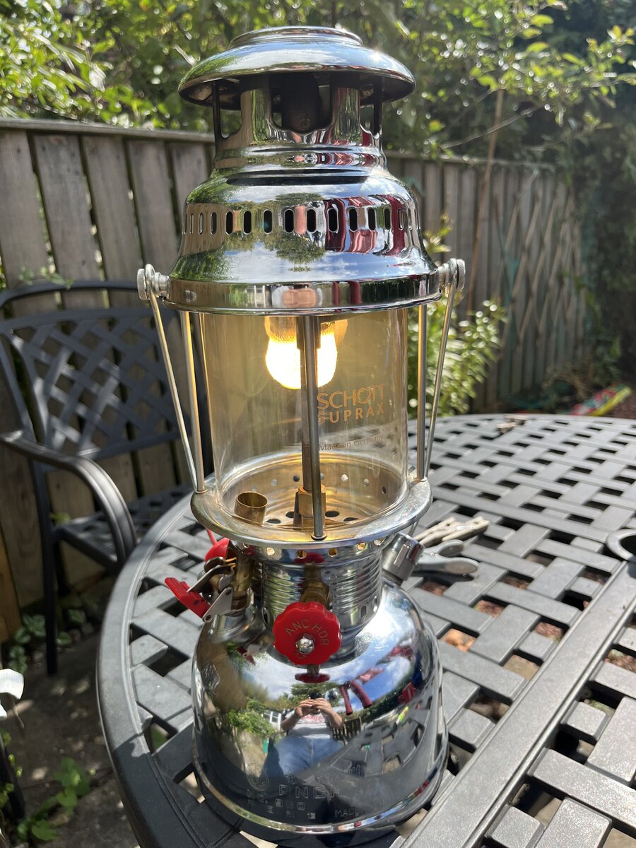

    It was exactly as you guys said - the lack of mantle was the issue. I’d been testing Tilley burners with no mantles initially and assumed it would be the same for the two Veritas. Now that they both work they’re incredibly easy to start and powerful … and very loud! Loving the roaring from the 350 at least… some more fettling, then onto the Anchor (gulp)

  17. Automedon
    Jan 28, 2024
    107
    Couldn’t resist… left the Anchor pressurised all night and nary a drop in pressure. Pliable seals and seems to be in fine fettle so… gave it a test light. No issues… I’m guessing it’s old but has been looked after? Makes one hell of a roar too… it’s in really excellent nick. C IMG_4250.jpeg IMG_4251.jpeg IMG_4252.jpeg
