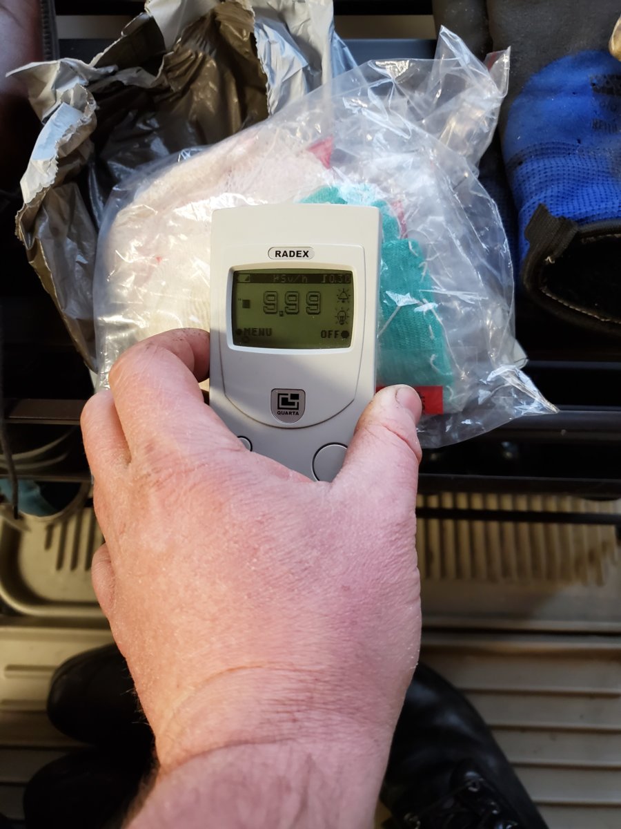

    Looks like he is measuring microSievert/hour, but Alpha, Beta or Gamma radiation ?

  6. MYN
    Its micro Sievert/hr as indicated on the scale. Multiplier selector to x1 to disregard any background radiation. As you see from the pictures, there's a Coleman #21 to indicate zero.
    I can't say if they're emitting alpha, beta or gamma rays but Radon-220 gas and Radium-224 are some of the radioactive daughters with its decay. Note that the radiation penetrated the plastic packaging.
    As long as you don't eat or inhale the dust from a broken mantle too frequently and you don't leave a big bunch of them for too long within an enclosed space such as your house, they shouldn't be too hazardous to live with.

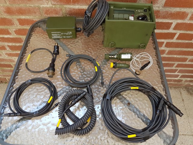

    I maybe wrong since I am still learning about radiation. Having written this: radiation doesn't ventilate out.
    Inside the house or outside doesn't change the radiation level. And if you enter the storage you get the same amount of dose.
    What can happen is that your storage box gets radioactive.
    However the levels and intensity are to low (I think).
    I will do some measurements with my set. That is measuring uGy/h or CPS.
    The Counts Per Second gives the known beep beep beep.
    In the kitchen it now counts 0,10-0,15cps background nosie. I think or hope or something is releasing electrons or neutrons.
    Biggest issue is calibrating your set.
    I haven't searched but my guess is that calibrating a set is expensive.
    So I can measure relative but not absolute.
    My set: FAG Kugelfischer PDR 7001 from the Dutch military.

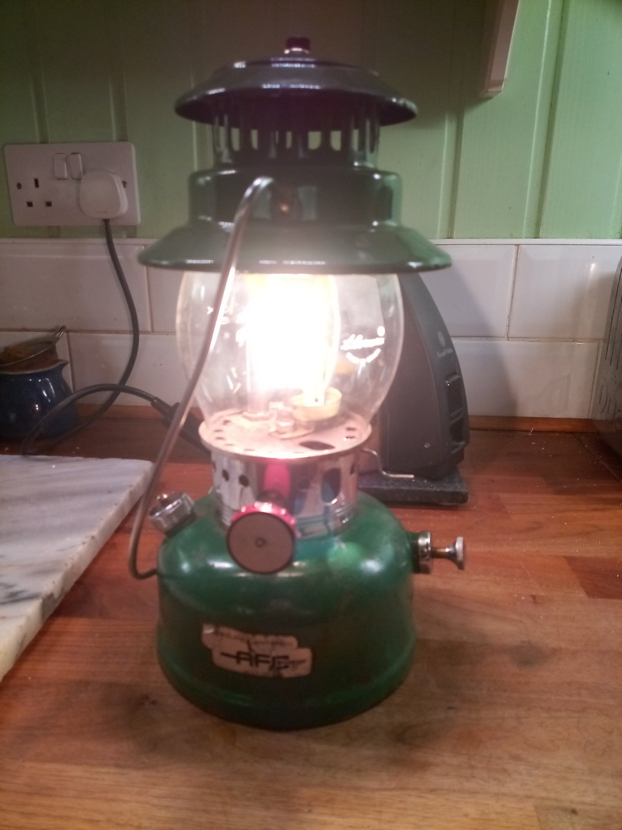

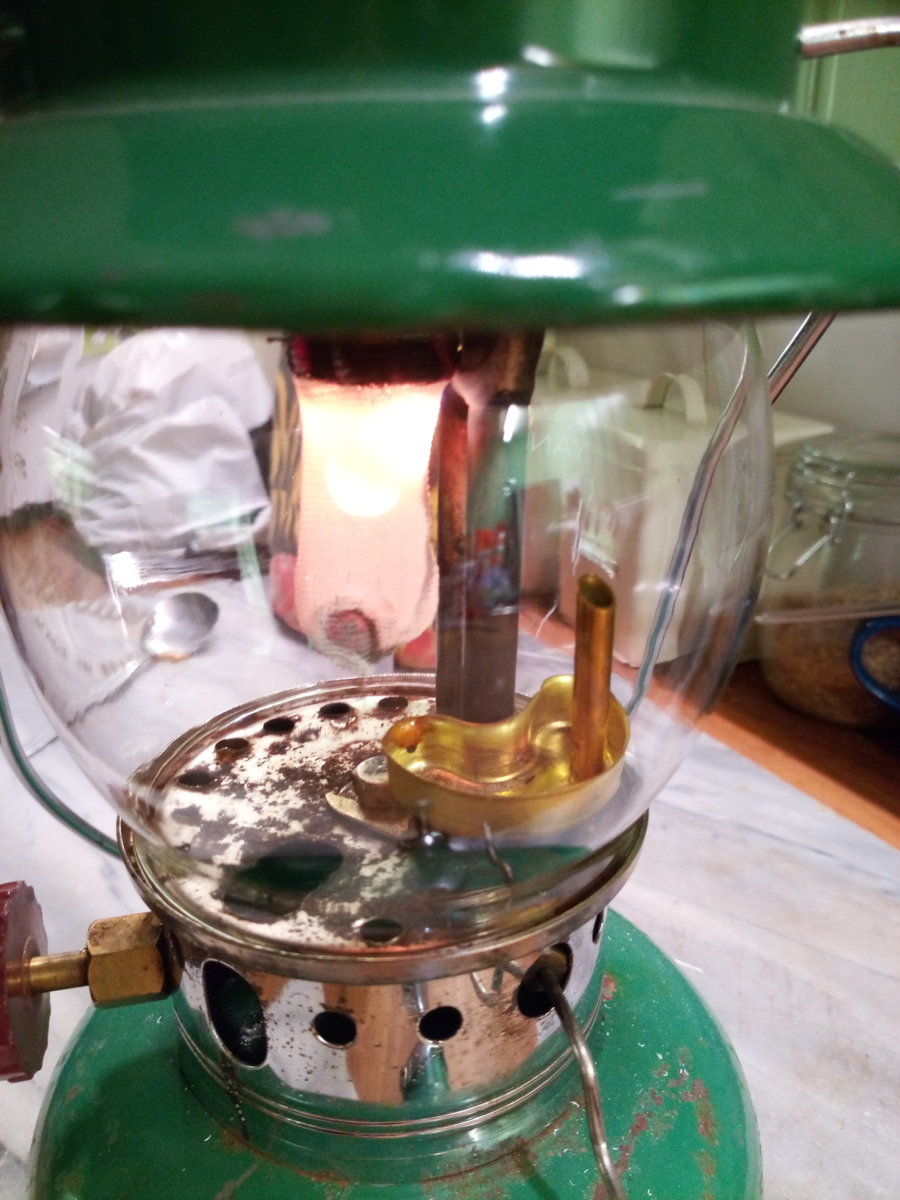

    For this test I chose the only single mantle naptha lantern that hasn't been converted to kero - my AshFlash.
    The new pink tops seem to be weaker than the green tops as this one blew a hole just like the first one did. This directed a plume of hot gas directly at the globe so I switched it off immediately. The globe is original and I didn't want to destroy it!
    While it was working it was very bright just like the 335/9.
    You can just about see the hole in the mantle... it's at the bottom.

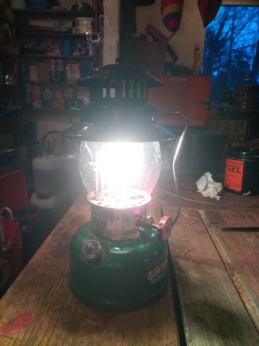

  19. ColinG United Kingdom
    4,816
    In be gone back to using one of the green tops on my AshFlash.

    As a rough estimate, its stated somewhere that the dangerous dose of radiation is about 100milliSieverts being accumulated in the human body over a period of one year. 100milliSv=100,000microSv.
    Assuming a year has 8760hrs, then its about 100,000microSv/8760hrs = 11.42microSv/hr.
    That would be roughly equivalent to strapping a piece of radioactive mantle permanently on our bodies for a year. I don't think anyone here wears a piece of mantle necklace 24hrs a day.
    So I'd say, its still quite safe to be using these mantles, so long as we are aware and take necessary precautions in their handling, storage and disposal.

    Well I get my geigercounter without any problems over the first warning: 20uGy/h (Gamma+Beta sensor used), on a package of mantles.
    Now I haven't found a conversion between Sievert and Gauss.

    I found a conversion site: convert-me.com
    What confuses me is that uS and uGy would be the same unit. But one is absorbed radiation dose (Gray) and the other
    Dose equivalent radiation (Sievert).
    If I am correct I see @MYN measuring 2-5uS/h and @Thomas 10uS/h ?
