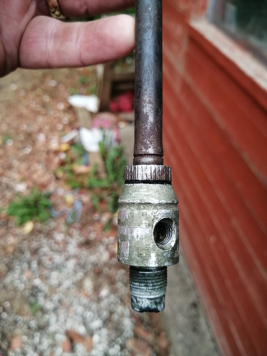

    NRV in the control cock? sorry you've lost me what is it and what does it do?
  3. george
    I know what he means, it looks just the NRV in the pump but fits in the bottom of the control cock. In fact, I think the part number is the same.

    @Steve Broughton The NRV (non return valve) in the control cock shuts off the fuel flow to the vapouriser. Have a look at this drawing courtesy of base-camp.co.uk
    X246b Stormlight

    Right I'm stumped completely unable to separate these two, any info before they go in the bin? :)

    Aha! remembered I had one of those mini rechargeable gas soldering torches from Aldi, heated it up and unscrewed it.
  9. Steve Broughton United Kingdom
    Jun 3, 2020
    54
    Benington
    Right 2 steps forwards one back etc. The cock is completely knackered, where the housing attaches into it for the rod of the control knob the threads have gone and you can't tighten it back up, the valve is missing as is the spring, also how much of the pricker protrudes out the end when you push it in? I've pushed it down on the bench and you can barely feel anything on the top just about scratches my fingertip, that's not right is it? :(

    The seals may look like metal but that's just a reflection. They're actually black Viton rubber which is the best you can get. Other types of artificial rubber are inferior and won't last anywhere near as long.
    You've knackered the Tilley control cock - the bit with the knob attached isn't meant to come out because there's nothing serviceable in there. Maybe you can screw the gland/knob back in and re-solder it - fingers crossed. The vapouriser - the bit you're holding - simply unscrews from the control cock. It should be no more than hand-tight, hence the knurling. In fact, there's little on a Tilley that requires tools to do up or loosen.

    The control cock was off when I got it? ok so it looks like I'm looking for a whole new control cock then? cheers I'll have a look on fleabay first.

    And i would just get another control cock as well, they are not great quality to begin with and are widely available and not too much money : )
