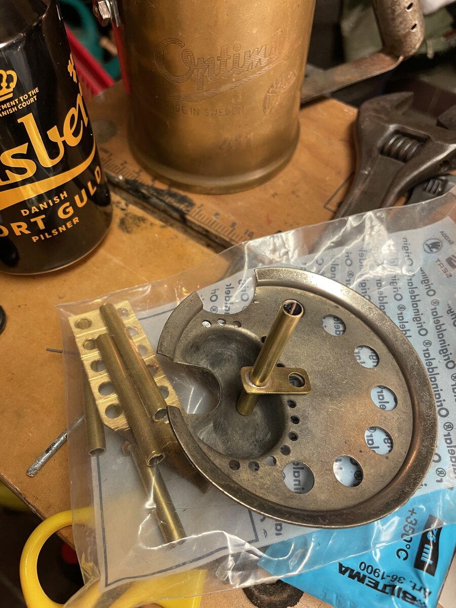

    I have made my own tubes that makes pre-heat work better.
    Keep collecting

    Matti, those tube setups look just like they would have been part of the original design! Very nice work indeed. How long are the tubes?

  7. Nils Stephenson
    3,361
    I believe the intention with the tube is to have a flame near the mantle when it is time to either turn on the fuel or start pumping. When the flame gets low in the spirit cup, there should still be a flame at the top of the tube.
