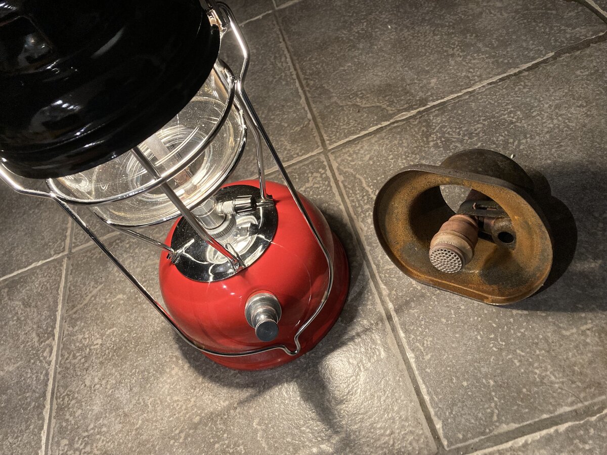

    Here are some shots of the inner case in its current condition.
    I guess the question really is, What is to be gained by dismantling the various components of the inner case if it’s all structurally sound and in proper adjustment? The rust looks worse than it is, it’s really just flash rust that developed after a nice long bath. I could give it a light sanding or soda blast the whole thing, taking care to cover the clay burner, if it would potentially improve the lifespan of the lantern.

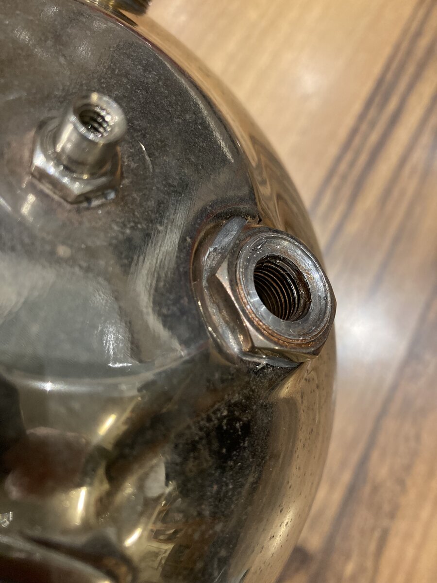

    My service parts have finally arrived for the 1550. I’m in the final stages of reassembly and am hesitating just as I did with my previous 350 to attempt to remove the lead washers on the top of the tank. For some reason this just makes me nervous. What, really, is the best and safest way to remove these without damaging anything? Digging with a pick from the bottom edge, prying with a blade from the outside ridge inwards, tapping on a slotted screwdriver with a hammer to spin the washers loose, etc.? For me it’s very hard to tell for certain where the actual edges of the washers are after they’ve been deformed. Luckily the lead washer for the NRV came out with the NRV.

    Well, no worries. They’ve finally popped out after an hour-long struggle. The first 58 minutes were wasted using a sharp right angle pick on the rapid starter washer. After that I decided to switch to a very small slotted screwdriver and just jam it into the meat of the washer and pry it out. That seems to be the way to go. I then found that there were two washers under the lower vapouriser, one really thick and the other very thin :?. This remains my least favorite part of working on Petromax-style lanterns.
    I have one lead washer and one Viton for this job. Would it make the most sense to use the lead washer for the rapid starter (since there doesn’t seem to be any reason to ever remove this—unless I’m missing something) and the Viton washer for the lower vapouriser (since it may be necessary to service the valve at the bottom at some point)? Sorry if this seems senseless. I’m trying my best to communicate through a 39 degree Celsius fever :oops:.

    he he - yes just "digging" is the only way... I cannot advise on the washer choice as I have only ever used lead. The thickness is important as it determines where things end up. I think lead gives a little more wiggle room as it will compress. but it does not uncompress. So use the viton one first in case it will not work in well in whichever one you try first.

    I would use two of the same washers if I had them, but for whatever reason I only received a total of one washer of this size in the kit I ordered from Base Camp (which was specifically for the 1550). I am fortunate to have a leftover Viton washer from a previous Petromax order.
    As you can see in the pictures, the nickel plating on the tank is weirdly thin and weak. I wanted to assemble the lantern tonight but after a quick blast of the insides with compressed air to clear out any debris, a massive sheet of the nickel plating peeled right off. Wasn’t expecting that one [-X.
    Not the end of the world. I’ll have to prep and paint it, but I think it’ll look OK. In theory/practice, would soaking the whole tank in citric acid solution for a long time or even boiling it in it be the most effective way of getting down to the bare brass? I haven’t tried going at it with the air hose for this purpose, but I doubt it would remove all the plating.
