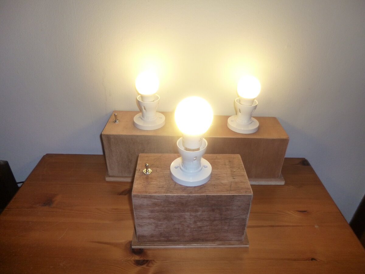

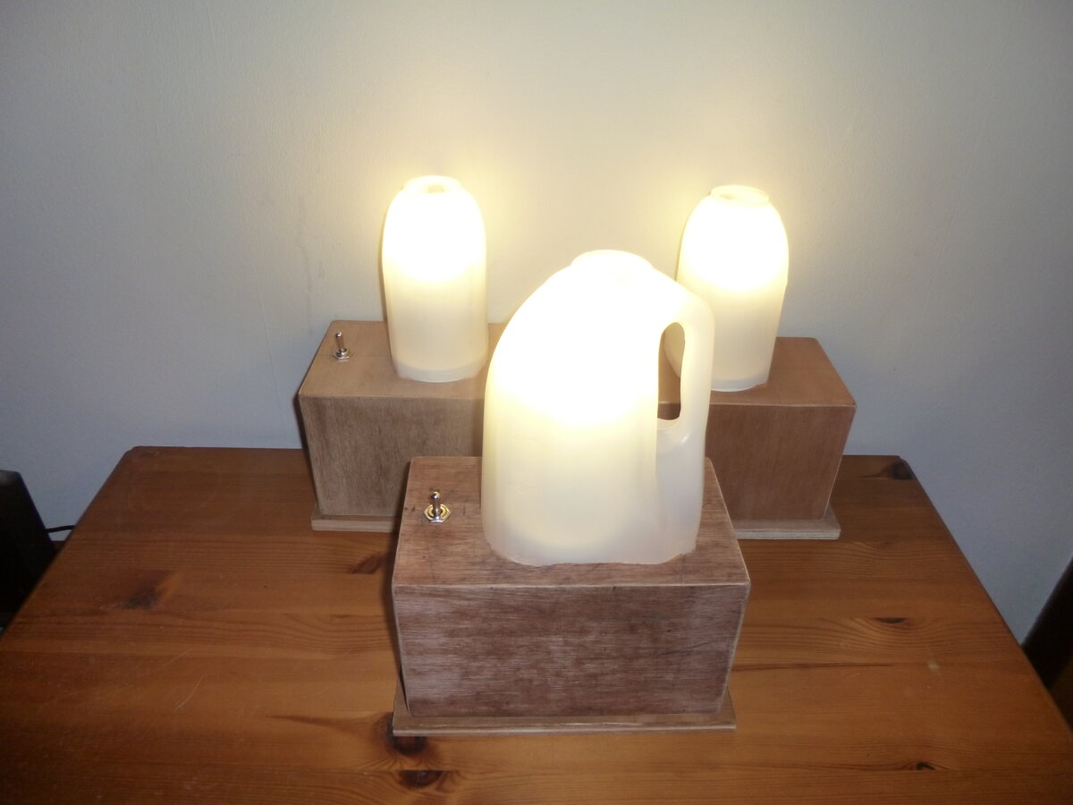

    Resurrecting an old post, I made these a couple of years ago as a back up light source
    Using a duff car battery (but should be a leisure battery) in large box and using a 12v Yuasa Yucel Y7-12 battery and 12v warm white LED bulbs in small boxes. 3watt bulb for the small battery and 5watts for the car battery
    with milk bottle diffusers.
