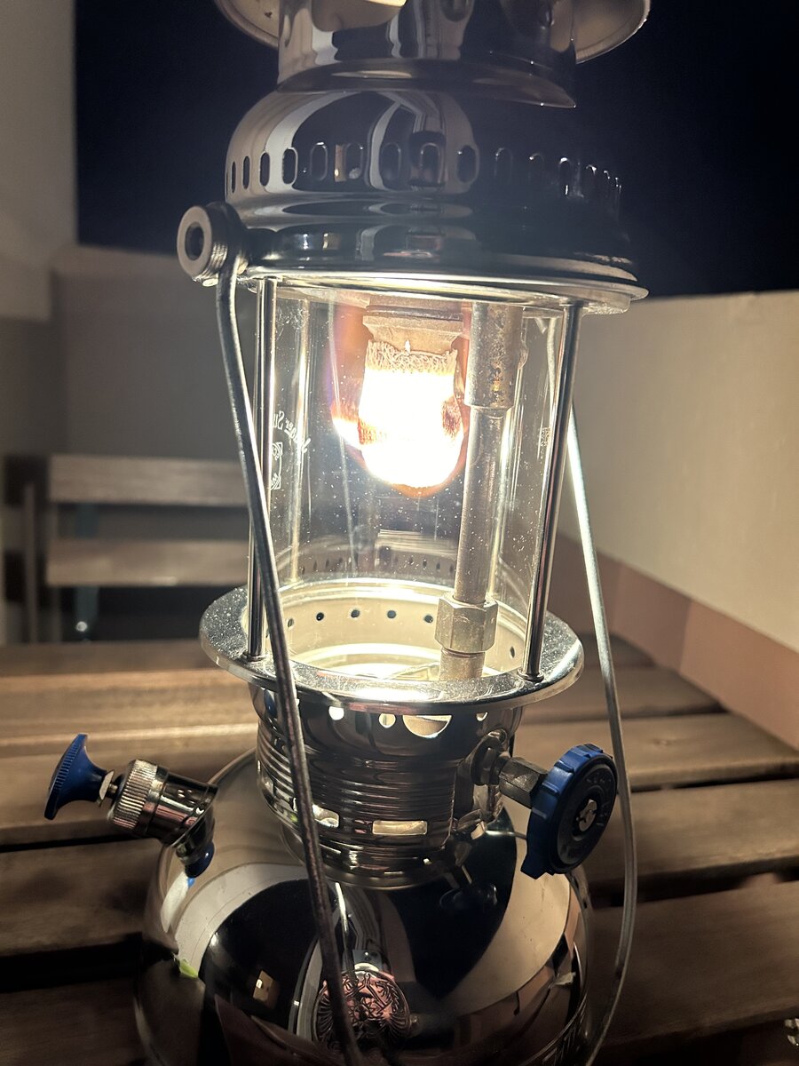

    Thanks to all your help I did it!!
    The lamp works . there is a flame on the mantle ( I guess it is normal), and I cannot open the valve full down since it burns ‍♂️. But with a little open it works. I did a very long preheating as you told me and start very slow. Maybe now it is about adjustment.
    thank you all! I am very happy

    Hi @Akihiko
    looks like you are making progress at last!
    Mantles can flare for a bit when they are new but usually settle down after a while
    I think the wheel should be able to rotate freely? Best to have the cleaning needle as far down as possible.. as you say perhaps some more adjustments…
  6. Fireexit1 United Kingdom
    3,538
    Excellent ! - that wheel should be all the way down. - Remember there is no valve behind the wheel - only two rods, one pushing the needle up and down, the other pushing open a flat rubber seal against a spring at the bottom of the tank. it is an on/off type of seal really. By running the lantern with the wheel at 90 degrees you are holding the needle up too high and it will get damaged.

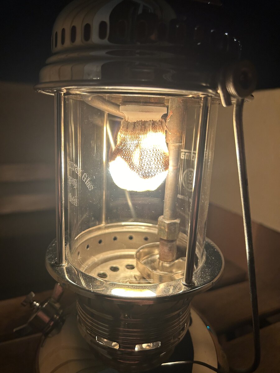

    Dear friends. My lamp still not wirking well. I bought new yet, new needle, new burner… new mantle, all from petromax web.
    I did a slow start and worked perfect for about 2 minutes. After huge flames came up, and like that every 15” or 30”. I found it very dangerous. The mantle became black. I don’t understand what is the problem. I send photos from the beginning working ok and after the flames.
    thank you!
  13. WimVe
    3,546
    You should use the needle !
    Then tell us what fuel you use, how you maintain the pressure etc.
    Some people think that you don't have to pump air once lit but that isn't the case.
    The smaller the tank or the fuel/pressured air ratio you must pump. A full tank has less pressurised air and needs pumping often. also you may have dirt in the tank/fuel.
    Or needle height is wrong and not enough gas = heat is available.
