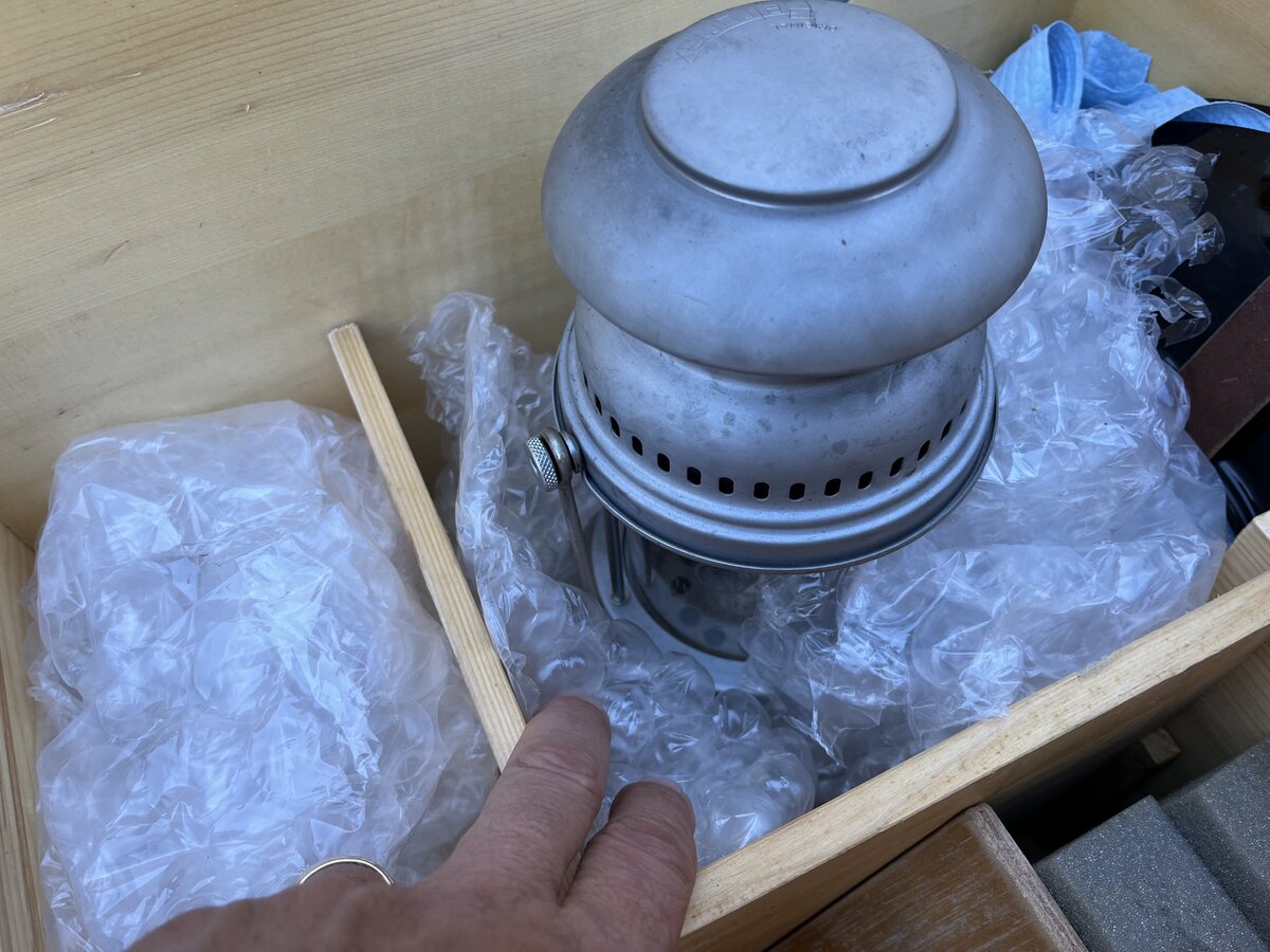

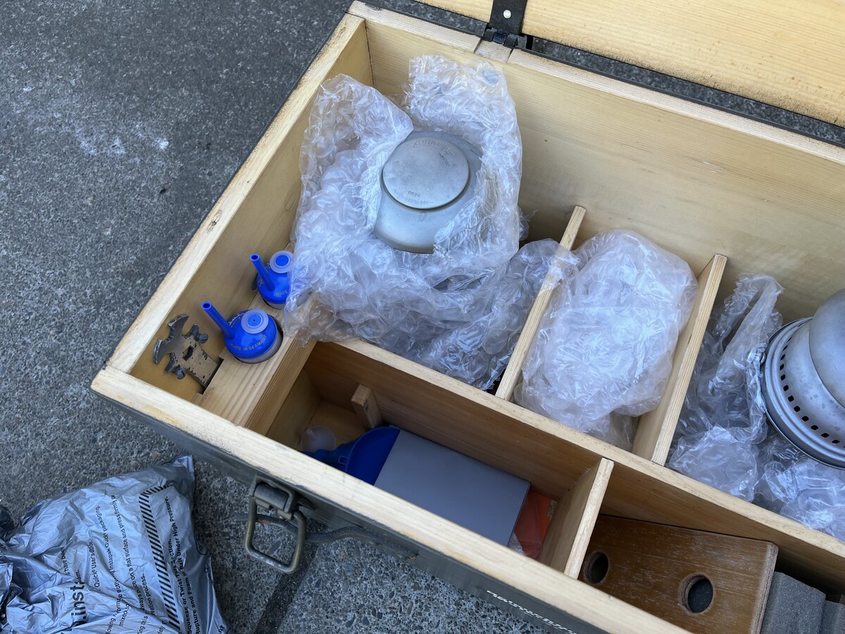

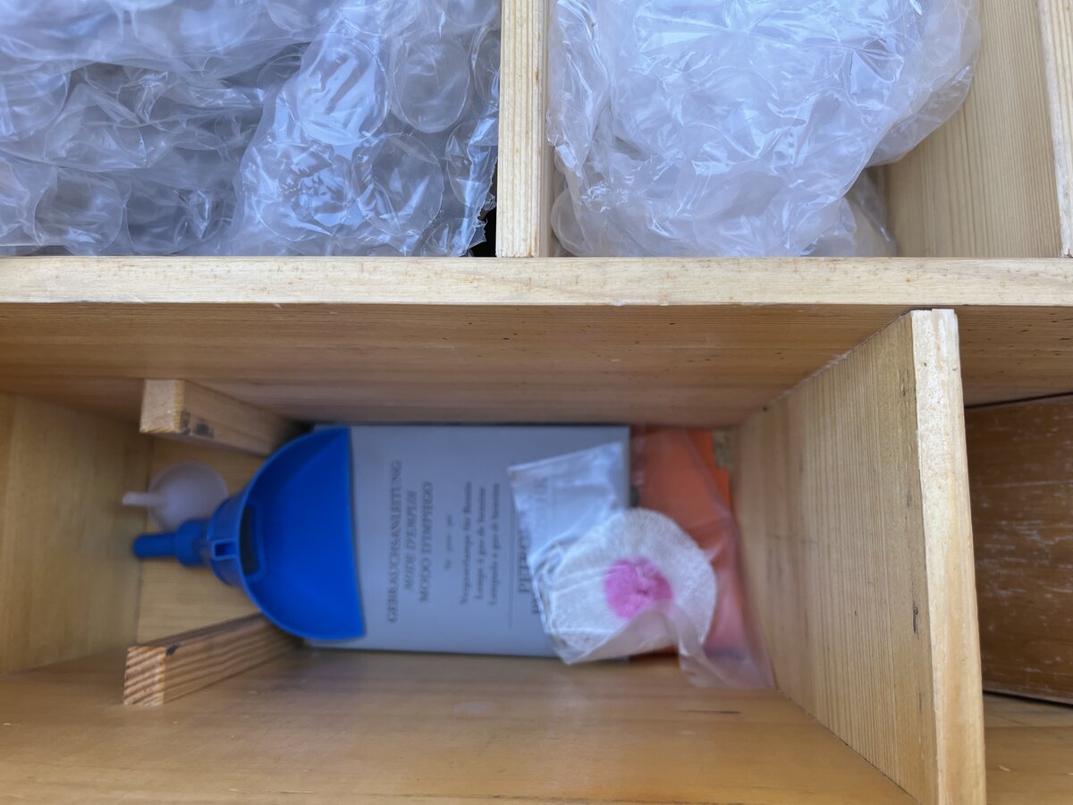

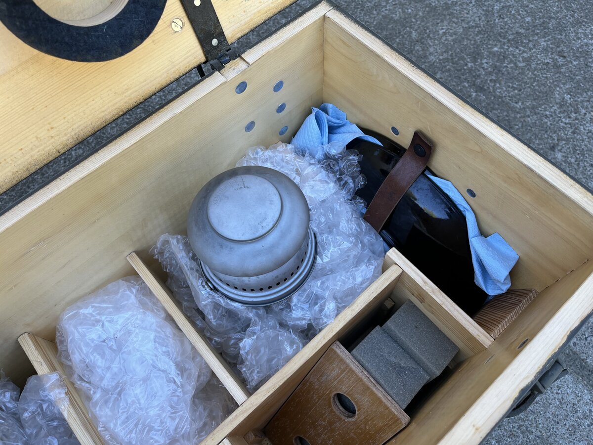

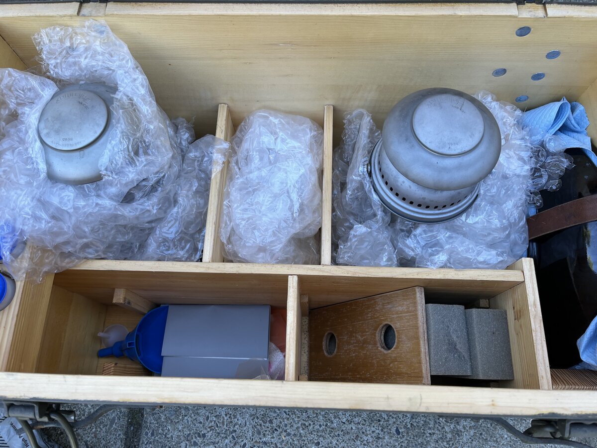

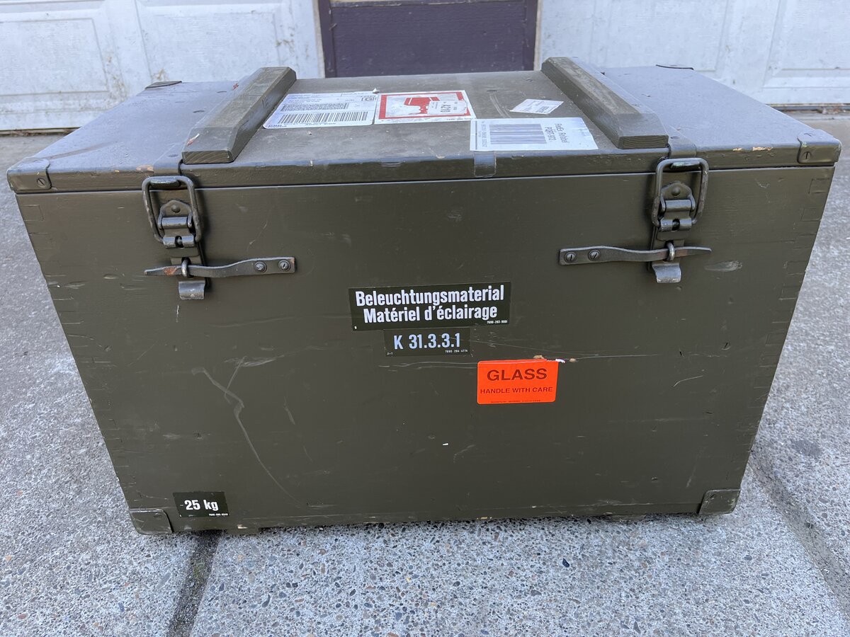

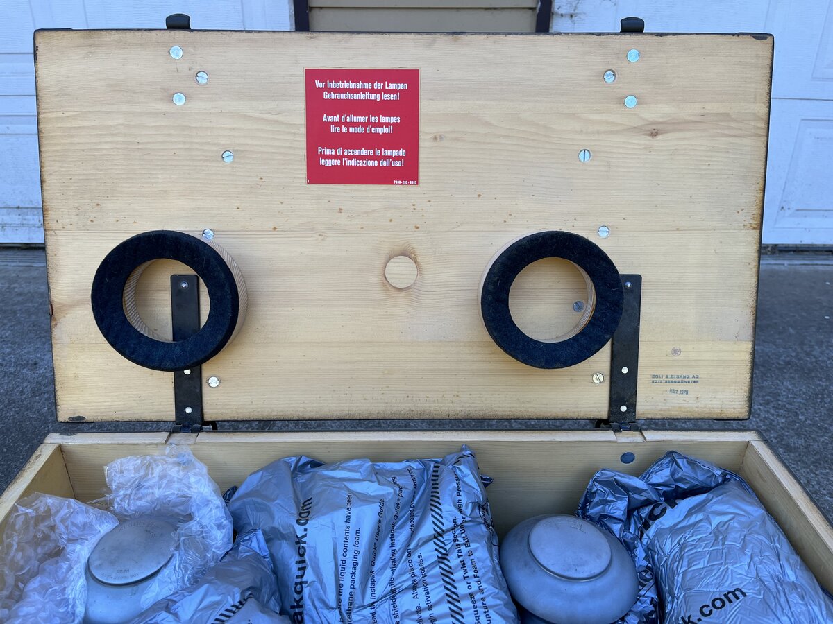

    Box and contents:
    IMG_5332.jpeg IMG_5333.jpeg IMG_5334.jpeg IMG_5335.jpeg IMG_5336.jpeg IMG_5337.jpeg IMG_5338.jpeg IMG_5339.jpeg IMG_5341.jpeg IMG_5342.jpeg IMG_5343.jpeg IMG_5345.jpeg

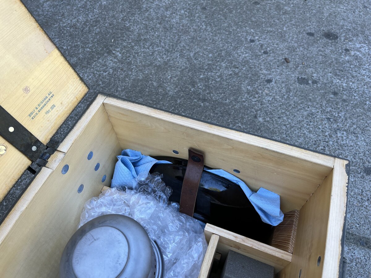

    Date on inside of box lid is
    March 1970.
    I can take pictures of the lamps themselves if you don’t mind telling what to capture in the photos.
    Thanks for your help!
  3. WimVe
    3,544
    Well nice box.
    Just to inform you: you know you are missing two foldable candle holders?

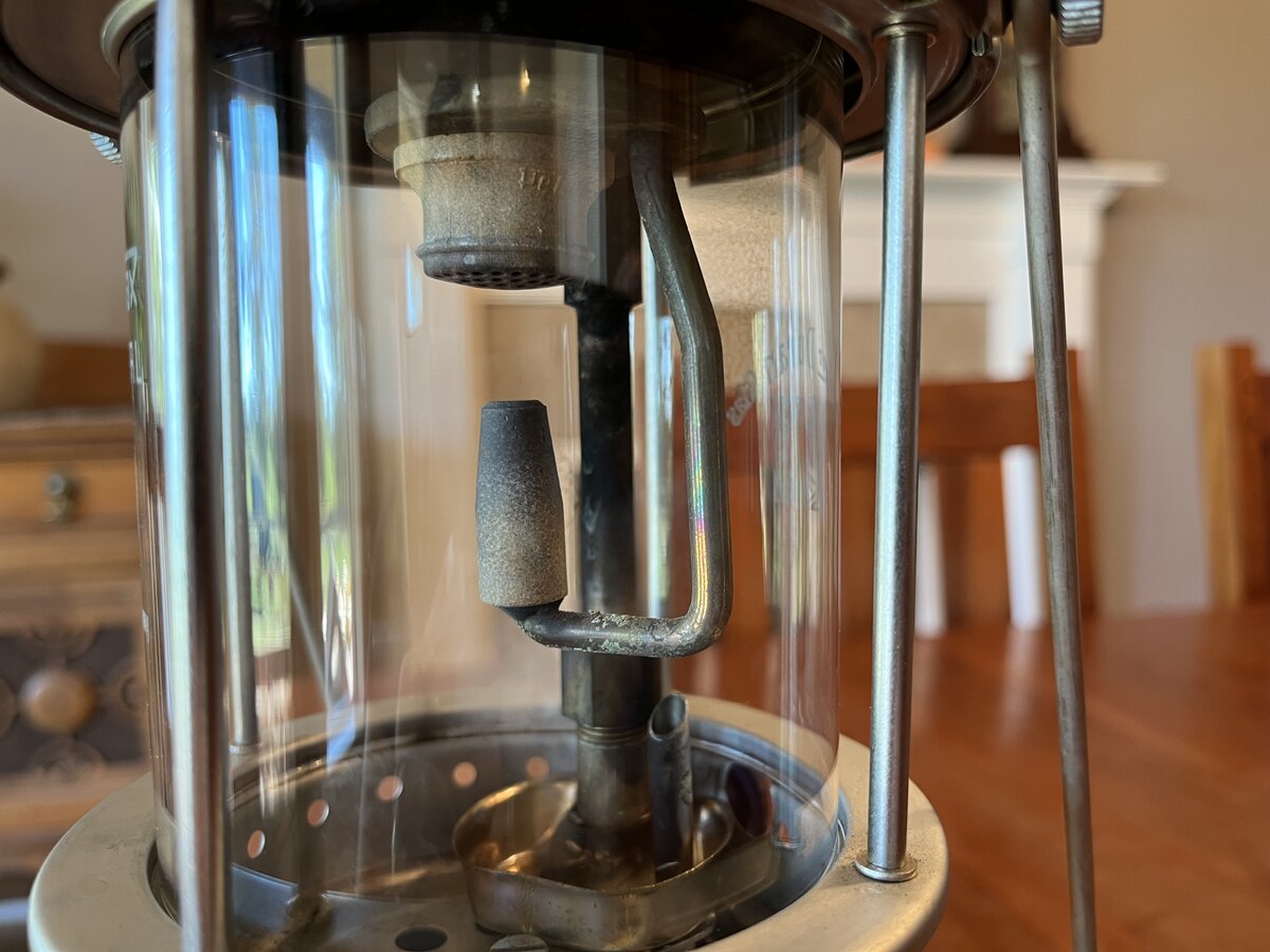

    As for the fuel: pictures of the lanterns without hoods please. This will tell us what version you have.
    Just curious did you buy it in the states or is it shipped from Swiss?

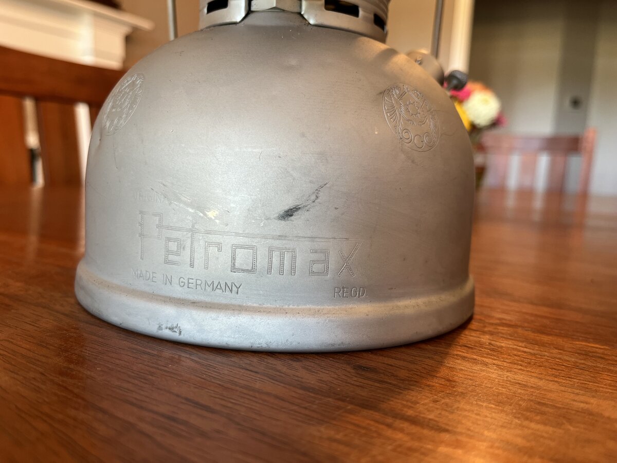

    I guess these are Geniol lanterns?

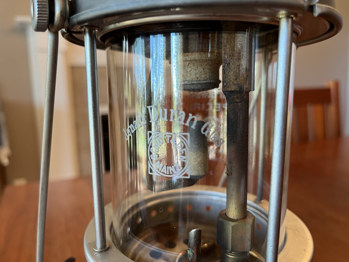

    I'll go get photos now.
    I think I'm also missing the boxes of wooden Swiss matches. No surprise, I guess.

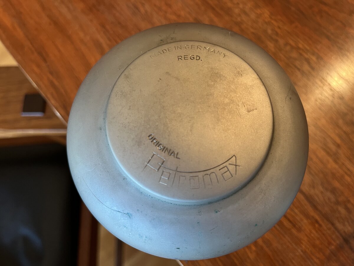

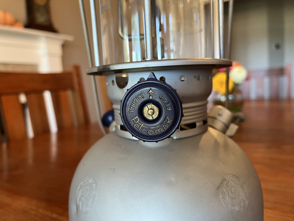

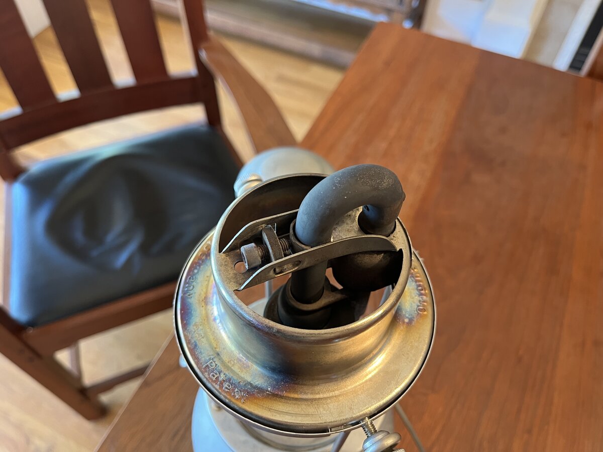

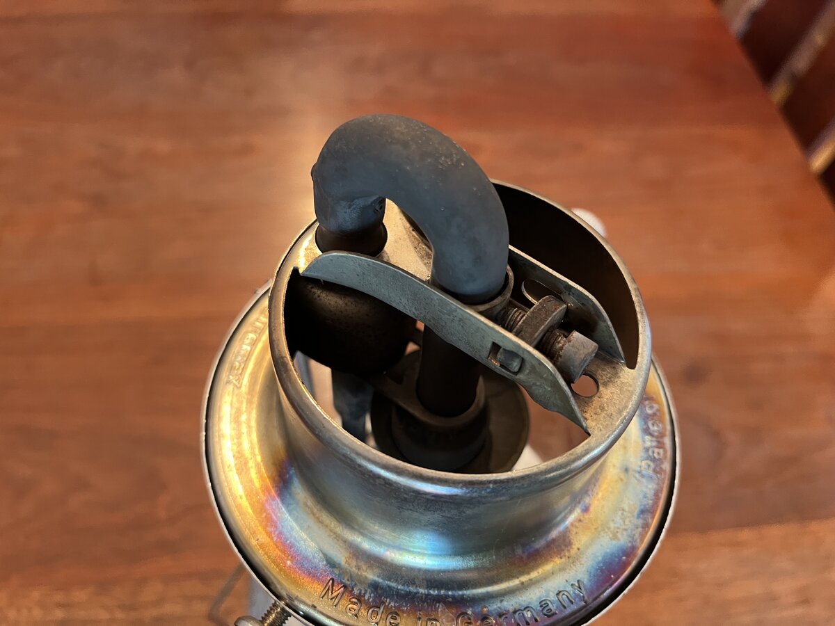

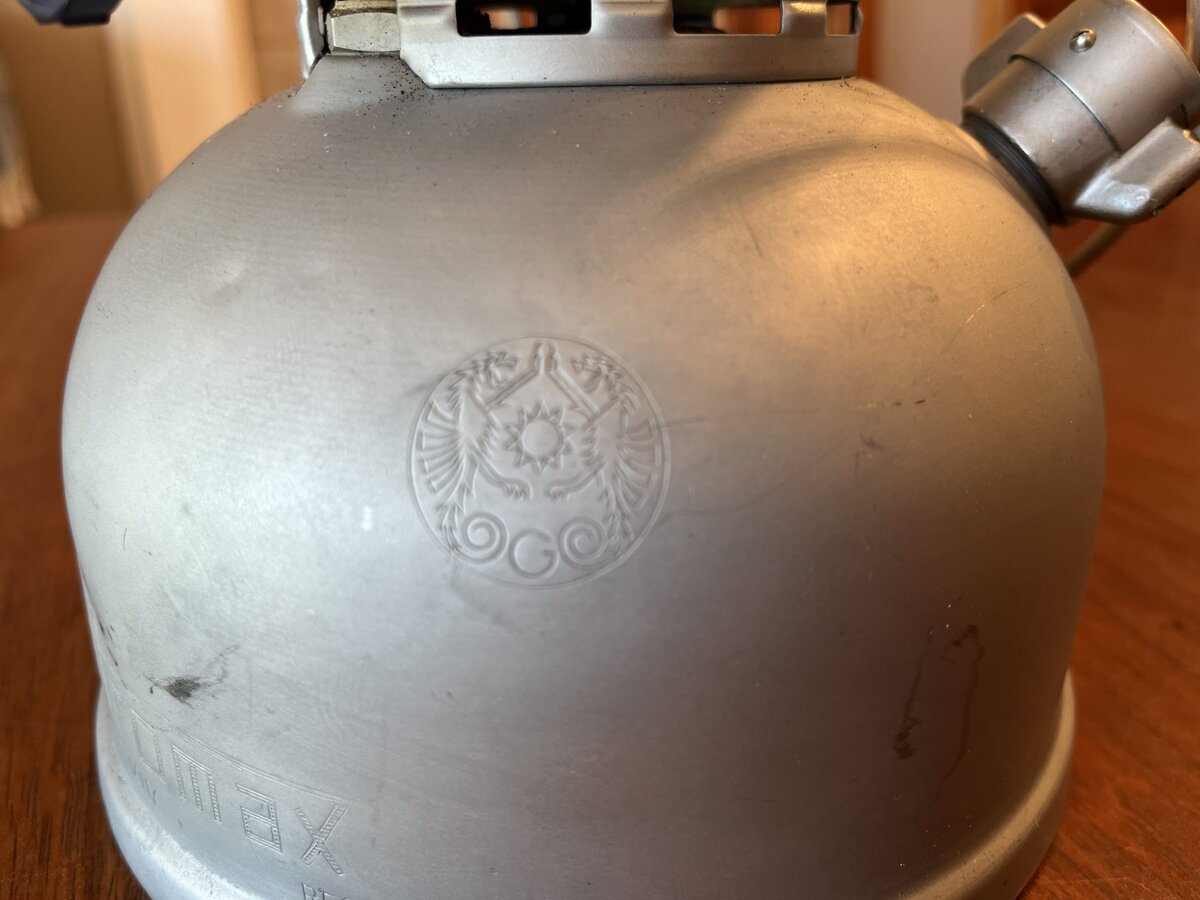

    Looks like Petromax Germany.

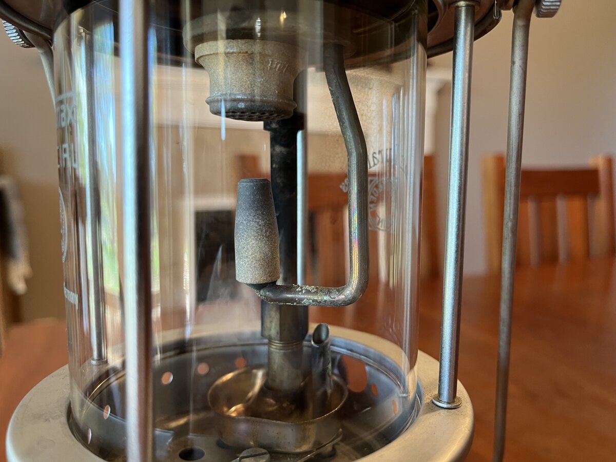

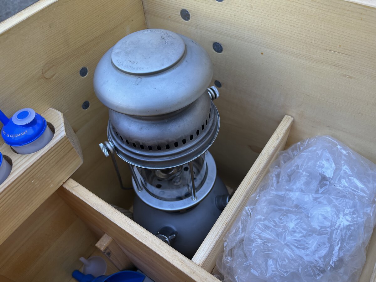

    IMG_5349.jpeg IMG_5350.jpeg IMG_5352.jpeg IMG_5353.jpeg IMG_5355.jpeg IMG_5354.jpeg IMG_5351.jpeg IMG_5356.jpeg IMG_5357.jpeg IMG_5358.jpeg
  6. Henry Plews
    3,068
    Two nice looking lanterns.
    They have the straight vapouriser for gasoline but as I said before, they will burn kero.
    As well as a boxed set, I have a single lantern which although now fitted with a Preston loop vapouriser, worked well enough with straight kero providing there were no strong gusts of wind. Performance was much improved by adding 15% / 20% gasoline to the kero* and further improved by increasing the air gap.
    There is no need to change the gas tip !
    * I actually use heating oil, you may get away with a different mix, try a few different mixtures and see which works best for you.

  8. Henry Plews
    3,068
    @brunop the air gap is the distance between the top of the gas tip (a.k.a. jet or nipple) and the bottom of the mixing tube (like an upside down letter J).
    Although this document is for a 500c.p. lantern, the principle is the same for your 250c.p. example. Check out chapter 9 and all will be revealed - the only difference is the distance ! Use the end of the wrench to set the distance.

  10. MYN
    So I see its an 821E lantern, not an 812 table lamp. In general, it is already a kerosene-lantern based on the default original Petromax 821 design.
    In my opinion, the conversion to or usage of benzin/gasoline (both by the German and Swiss Armies) on the basic lantern isn't such a great idea. It lacks some very crucial features to allow safe operation with benzin, light naphtha or gasoline. You are way better off using kerosene on this lantern design.
    That's a very nice box of goodies.
    No Preston loop? Looks like a straight vaporizer for 'benzin'/gasoline in the picture.
    It should be easy enough to 're-convert' to kero. A Petromax Preston loop type generator with a 250hk jet would get you the intended objectives.
    Happy fettling:thumbup:

  12. Reinhard
    Reinhard Germany Subscriber
    Oct 15, 2018
    1,138
    The lantern pictured is a Swiss Army Petromax 523/821.This lantern has never been converted.It was ordered by the Swiss Army exactly as shown.It was only available with the straight carburettor and,as far as I know,it ran exclusively with petrol /gazoline.
    You can read the age of these Swiss Army lamps on the bottom of the tank.Vintages I have seen are 1961,66,67,69,70.
    The almost identical successor model was called Geniol 523/821 and was manufactured in Portugal.(Hipolito).Vintages I have seen are 1984,86,87,88,89.
    For me are these Petromax 523/821 and Geniol 523/821 extremely reliable and safe.I don't know of any accident.
    The Petromax 821E is a kerosene lamp with a J-tube fixation on the side from 1953 and has nothing to do with these two Swiss Army lamps.Even before WW2 there was already a Petromax E series.
