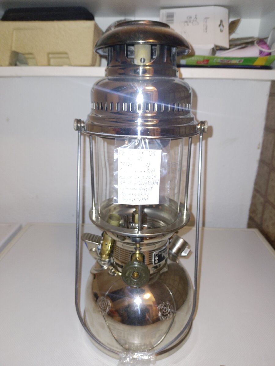

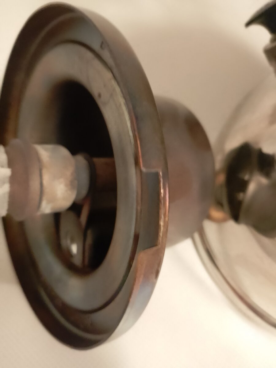

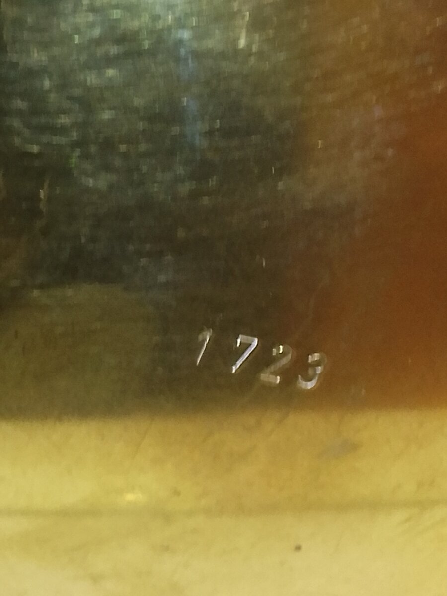

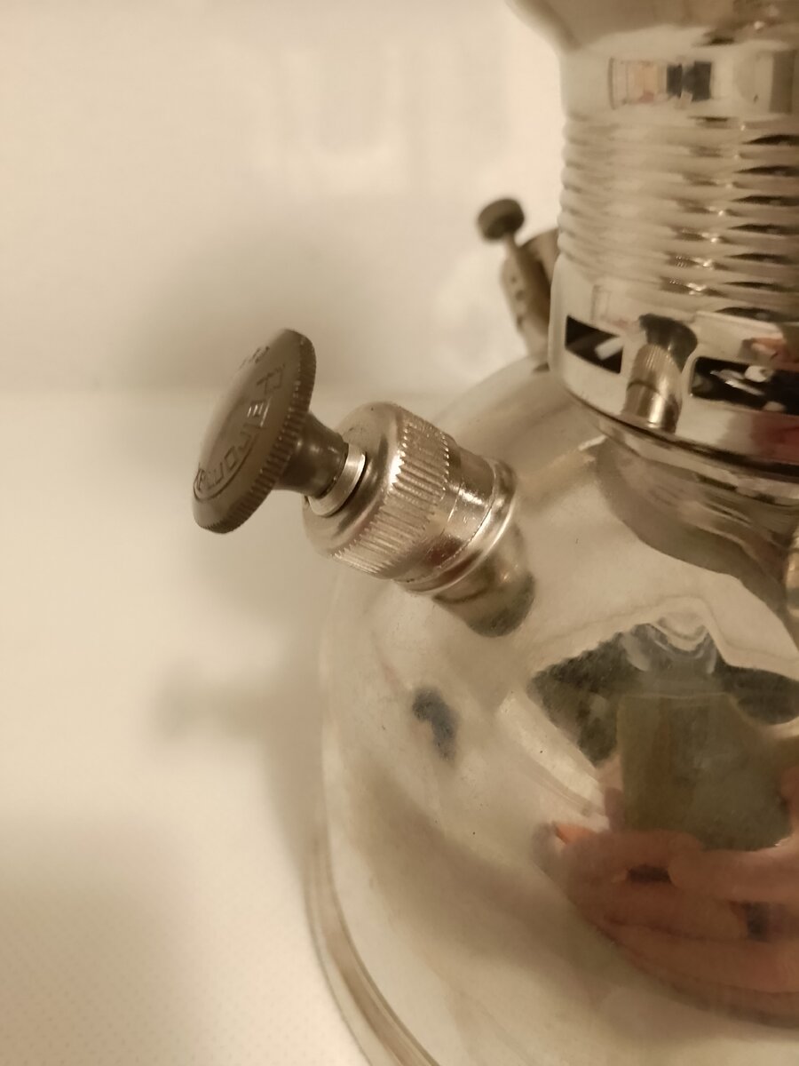

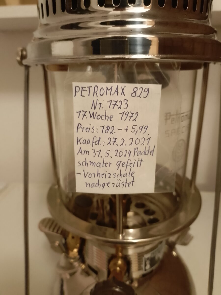

  28. Reinhard
    Reinhard Germany Subscriber
    Oct 15, 2018
    1,135
    @bausd (Jürgen)
    Thanks for showing the document.That was well-intentioned but it doesn't really get us anywhere.
    The document proves that the code was already known on February 1,1962.And it proves that all listed models were manufactured in Altena at this time.No surprise for me.So far ok .
    But if you only have the number,without the date,and you can't see the lamp with its contemporary components,then you don't know whether it was manufactured in 1962 or 1972.

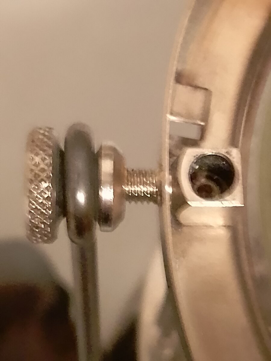

    Remember that pressure lamps were still being manufactured in Altena in the 15th week of 1972,as you can see from the example shown from 1972 with the number corresponding 1723.
    IMG_20241205_221603.jpg IMG_20241205_222127.jpg IMG_20241205_221635.jpg IMG_20241205_221620.jpg IMG_20241205_221712.jpg IMG_20241205_221823.jpg IMG_20241205_221847.jpg

  30. MYN
    Without observing further feature details like what shown by Reinhard, the 1723 code might be confused as the date for Week 17, Year 1962 and 3rd day of the week.
