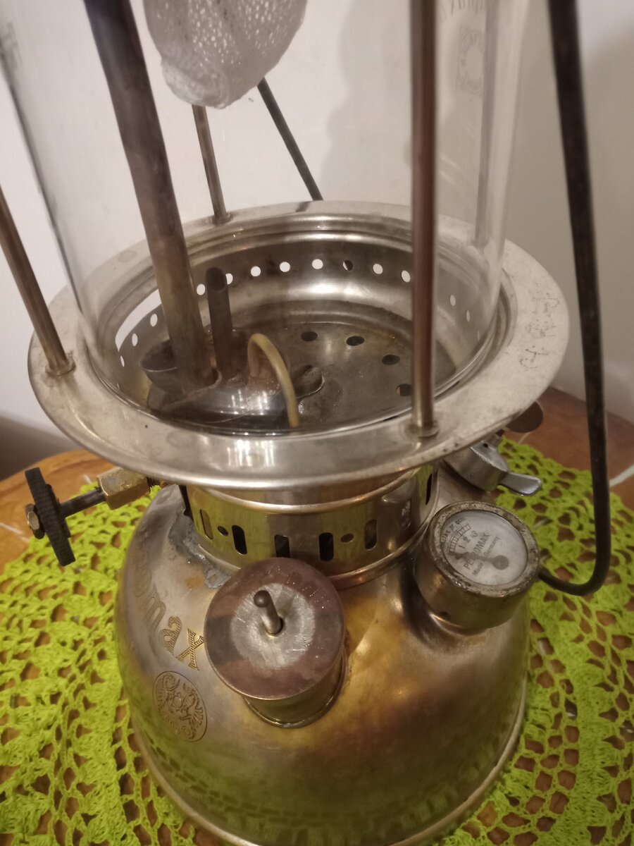

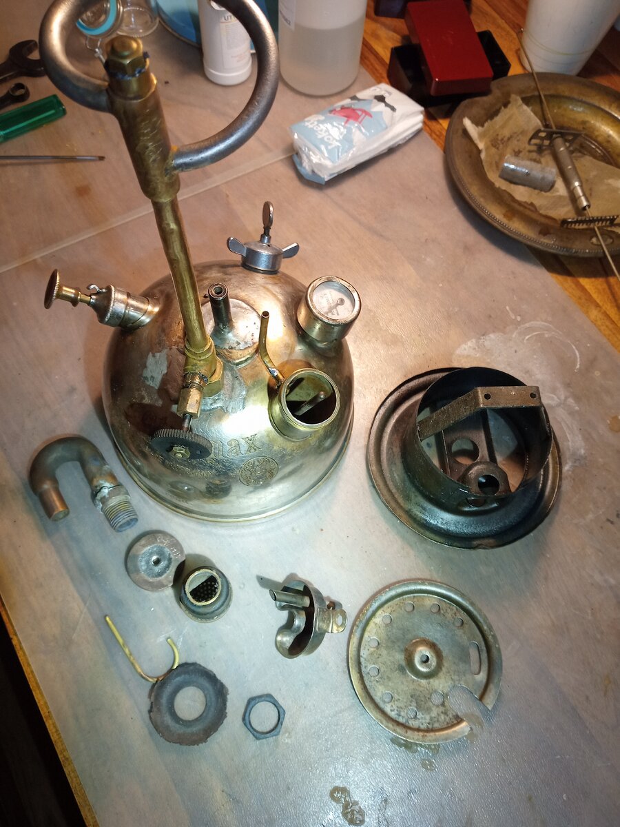

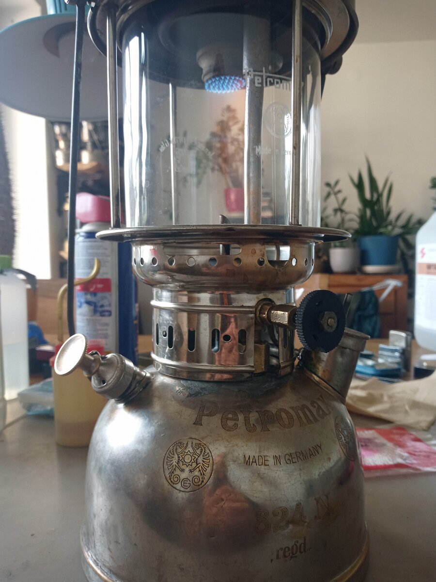

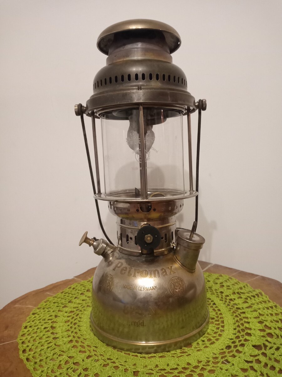

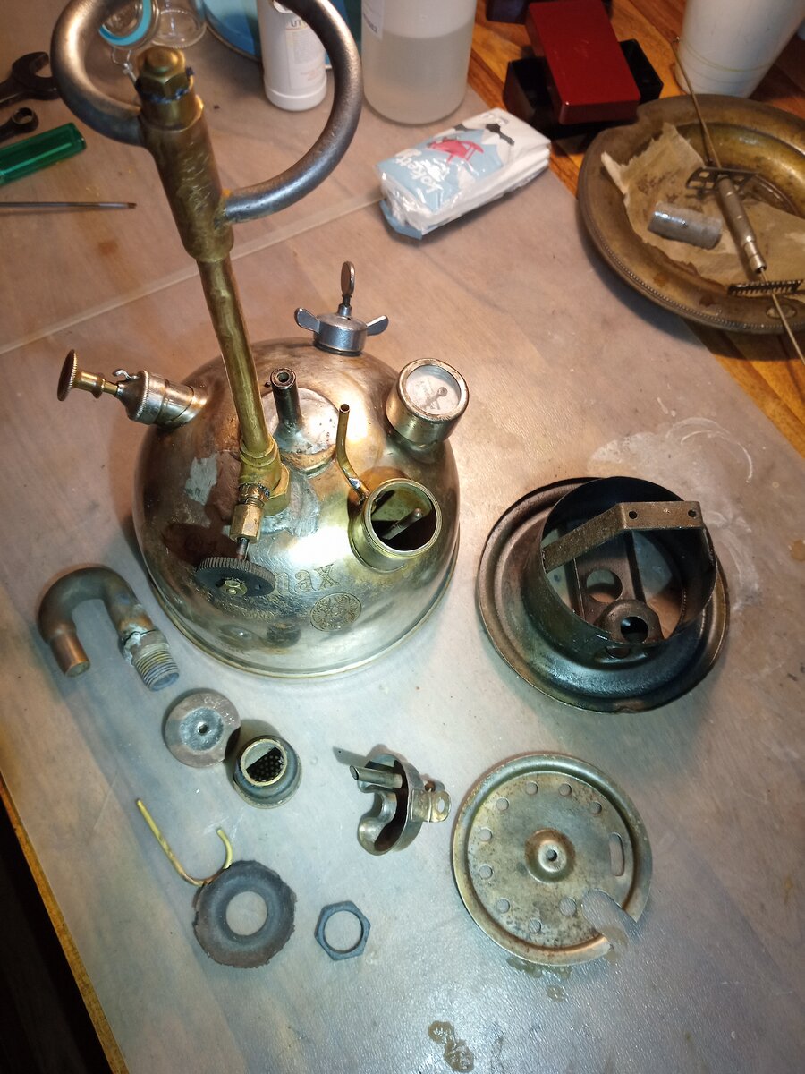

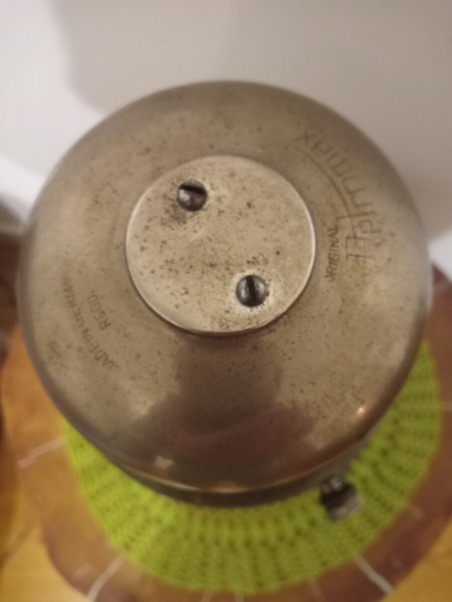

    Dears,
    Please find below Petromax 824N.
    Manufacturing date was considered here – most likely march 1927:
    Petromax 824 N advice kind request | Classic Pressure Lamps & Heaters
    Lamp was repaired before, but I had to:
    - seal the leaking tank
    - silver solder preheating cup
    - silver solder J-tube (tube was assembled somehow by somebody by squeezing two pieces together and connecting them by some graphite packing, or something similar gunky stuff)
    - shorted the conducing rod (it was hand made by somebody, but too long – just like in the regular Px lamps)
    - make these small, curved brass pipes running from preheating pump
    - general cleaning and seals replacement etc.
    - glass is replacement
    Lamp has interesting signs/signatures made by somebody on vaporizer, preheating pump lid and cage – just to punch this stuff had to take somebody some time, but obviously he/she was proud of the repair done. Personally, I enjoy such personalization’s which make things unique.
    Anyway, at the end it is what it is – rare, old lamp working again :)
    Enjoy,
    All the best
    Piotrek
