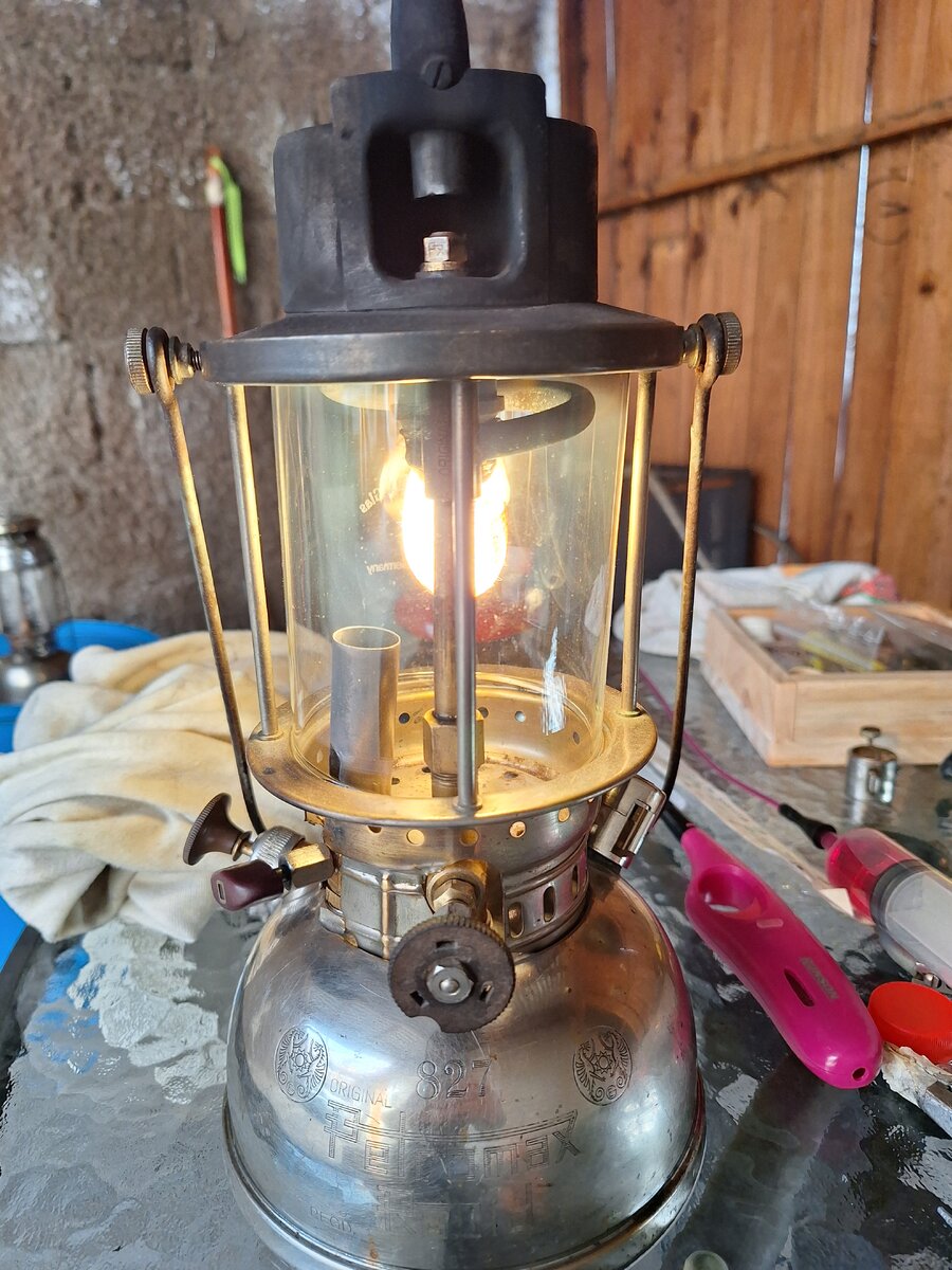

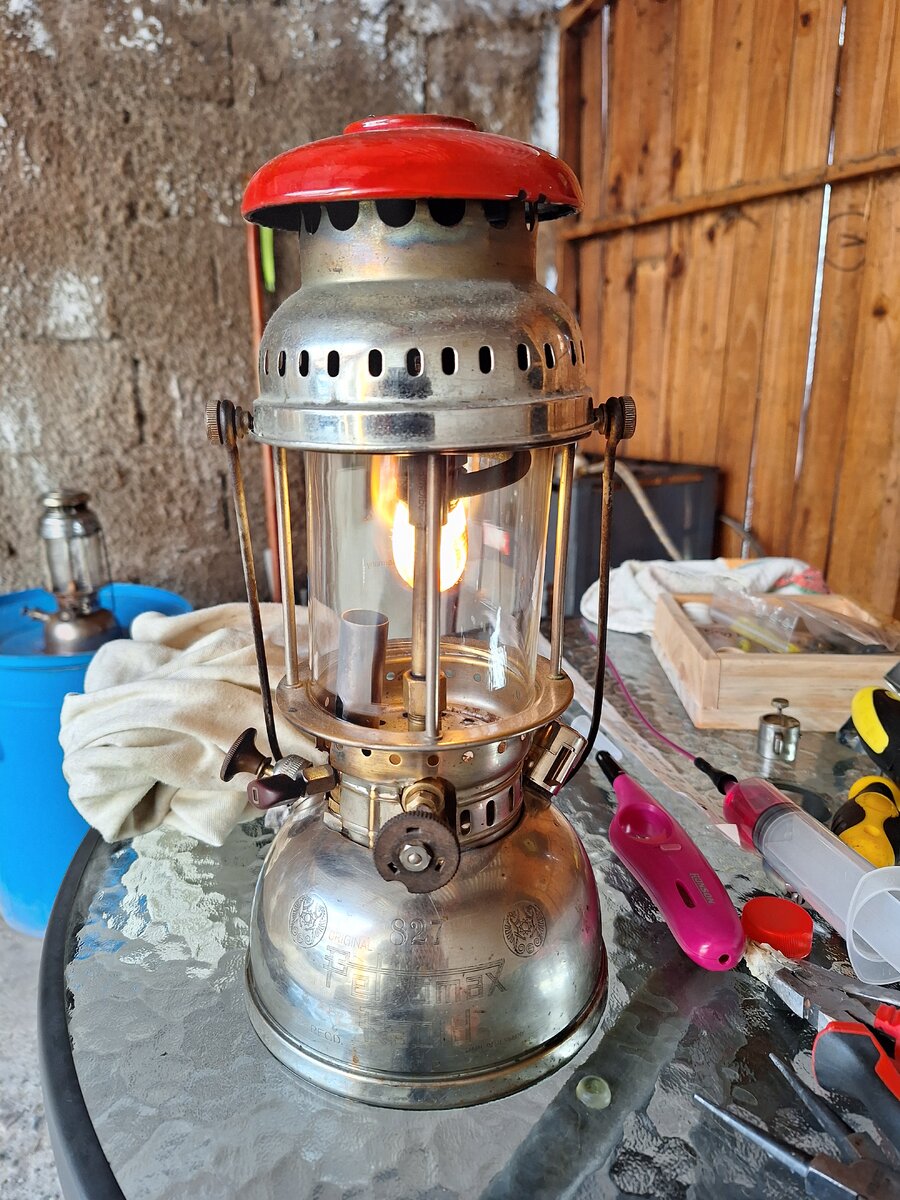

    Hello,
    Thank you everyone. I really appreciate Reinhard spare parts from Germany and
    I think I will have to make some adjustments.
    I couldn't upload a video (too large). The lantern sounded as it were breathing (I think thant may be a pressure issue.

    The air gap between jet and mixing tube looks a bit small to me. The flame in the picture with the hood mounted could indicate a rich burn accordingly.

    I'll make sure if that gap is the right one. Thanks for your tip Martin K.!
