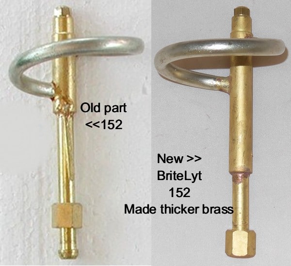

    I found this. I don't know if thicker brass will be better or worse, but it's a little cheaper than the whole carburetor/valve assembly.

    Well I love Viton - most of the time it is superior but on occasion it can be a littler harder so might not seal when being pressed closed by a weak spring. But if you already have the other kit use those.
    The thicker brass might take a little more heat to get going but is probably better and maybe even more stable than the original. Thread compatibility as well as the angles on the mating surfaces is important. Brytlit may be able to advise if it is a "drop in" or not.
