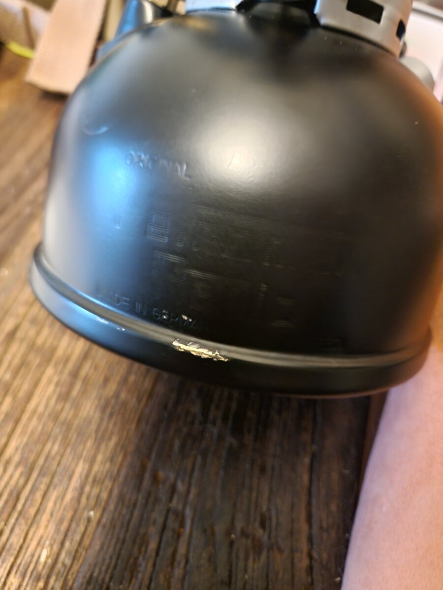

    The 829B came in today. I'll post some pictures later. The correct markings are on the fount, though there are a couple of dents that were not disclosed in the description.

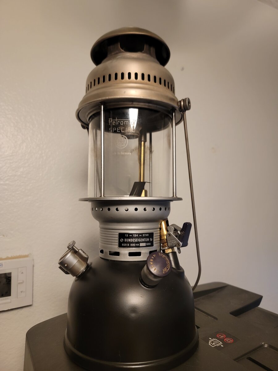

    Are the Luxor mantles collectible? The ones that came with the lantern look like they're in great shape. 20240612_053348.jpg 20240612_053210.jpg 20240612_053236.jpg

    btw: You should remove the black paint from that lantern.

    - yes I agree it does it no favours !

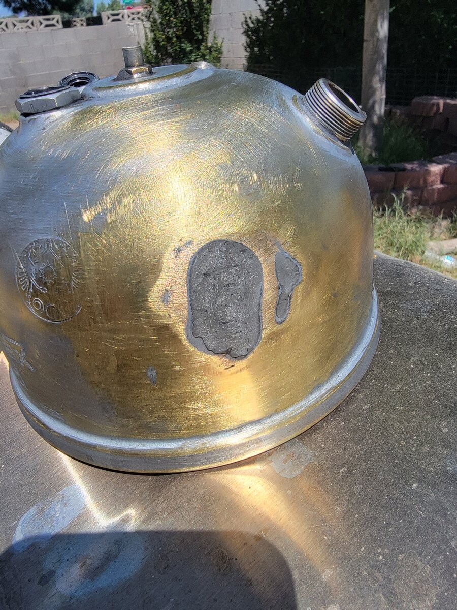

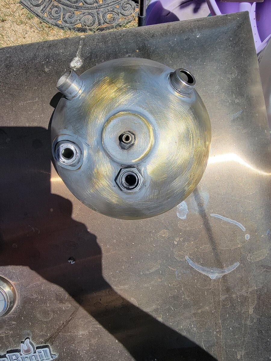

    I was afraid I might find something bad under the paint.
    20240615_111005.jpg 20240615_111011.jpg 20240615_111020.jpg 20240615_111035.jpg
  12. Gilbert United States
    May 21, 2024
    156
    Nevada, USA
    I'm not sure what's going on with that patch. It doesn't leak water from it.

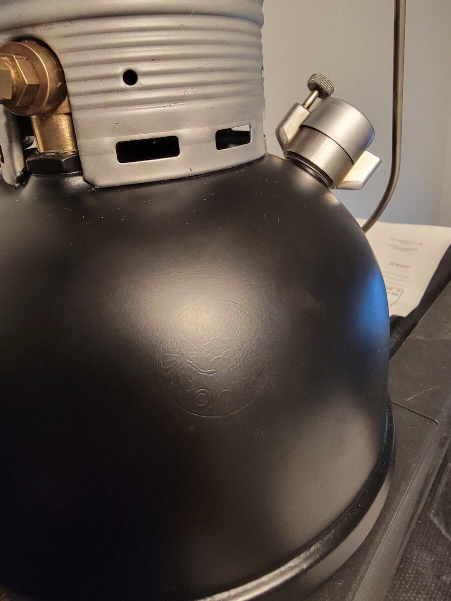

    Thank you. I'm thinking of repainting the fount. Whatever the previous owner used to fill the dents has come off. I can refill with jb weld or something similar and paint over it. It looks terrible as is.
  19. Dashwood United States
    Aug 1, 2023
    275
    United States
    For a moment I thought it was a solder job at a glance to patch a leak, either way, should do a leak test pressurized in a water bath, check for bubbles.

    I'll do that. The patches fell off and revealed dents. I'll probably paint it black again, unless there's a shade of gray that will look decent.
  21. MYN
    That's about the only thing that is bad about this lantern. Well, it is unfortunate but it happens to anyone.
    If it is mine, I'd remove the bad patch and fix that with soft solder. I personally prefer all-metal for repair work on such items. I'd only use epoxies like JB-Weld, etc if the all-metal repair route isn't an option.

    I've never soft soldered anything before or I would try it. JB weld seems to be the easiest, and it should sand down readily since it's soft.
  23. MYN
    No issues anyway. Use whatever you're handy with.
    JB-Weld is fuel resistant.

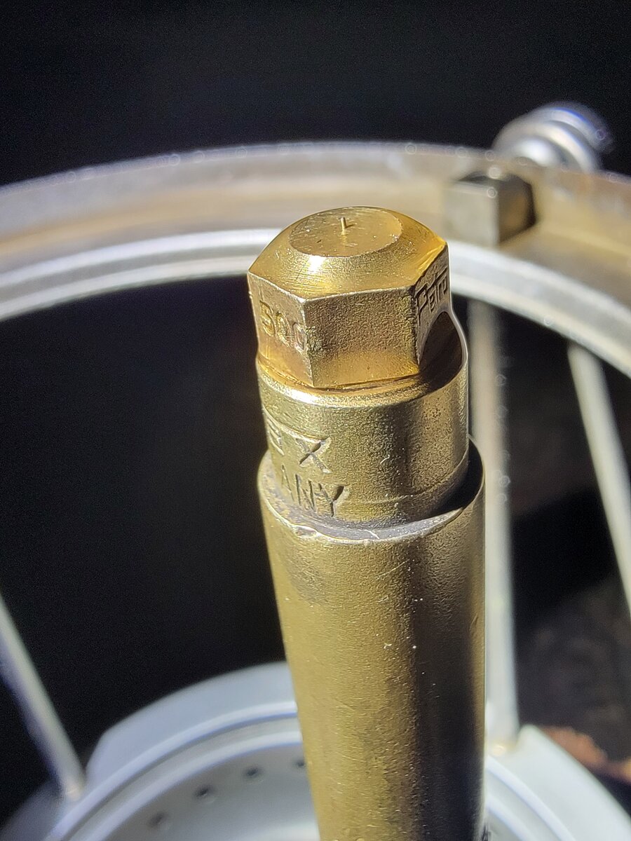

    I got the lantern back together with all new parts. When I pressurize the fount, it leaks through the top of the generator where the needle sticks out.
    It leaks fuel when the needle is sticking out in the "closed" position. What could be the cause?

    Here's a picture.

    Your foot valve needs a new replacement rubber sealing pip.

    I replaced the sealing pip earlier. I remembered I re used the hex nut the top of the generator.
    I replaced the nut and the leaking stopped. Now I have another problem, the rapid pre heater sputters but will not stay lit. Just a quick flame that goes out. I've pumped the fount up to 2 bars.
