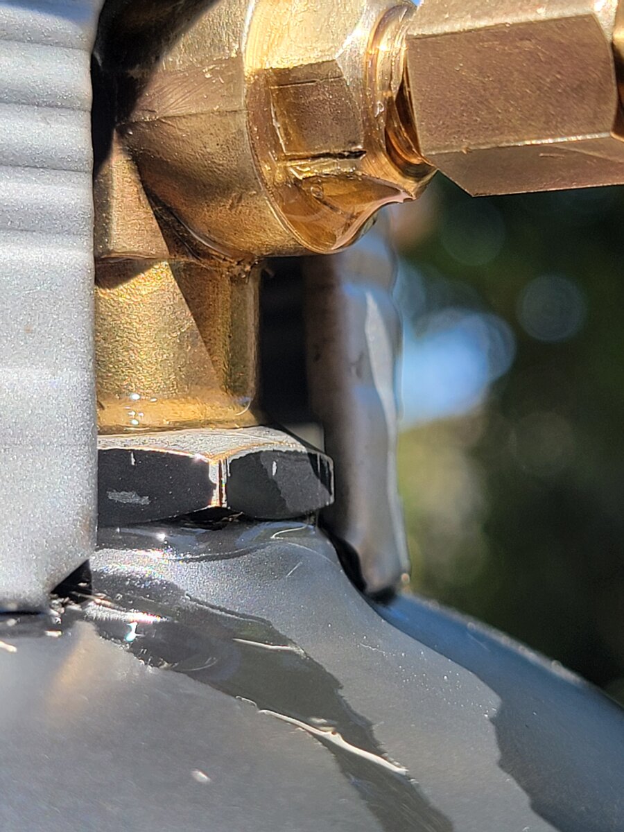

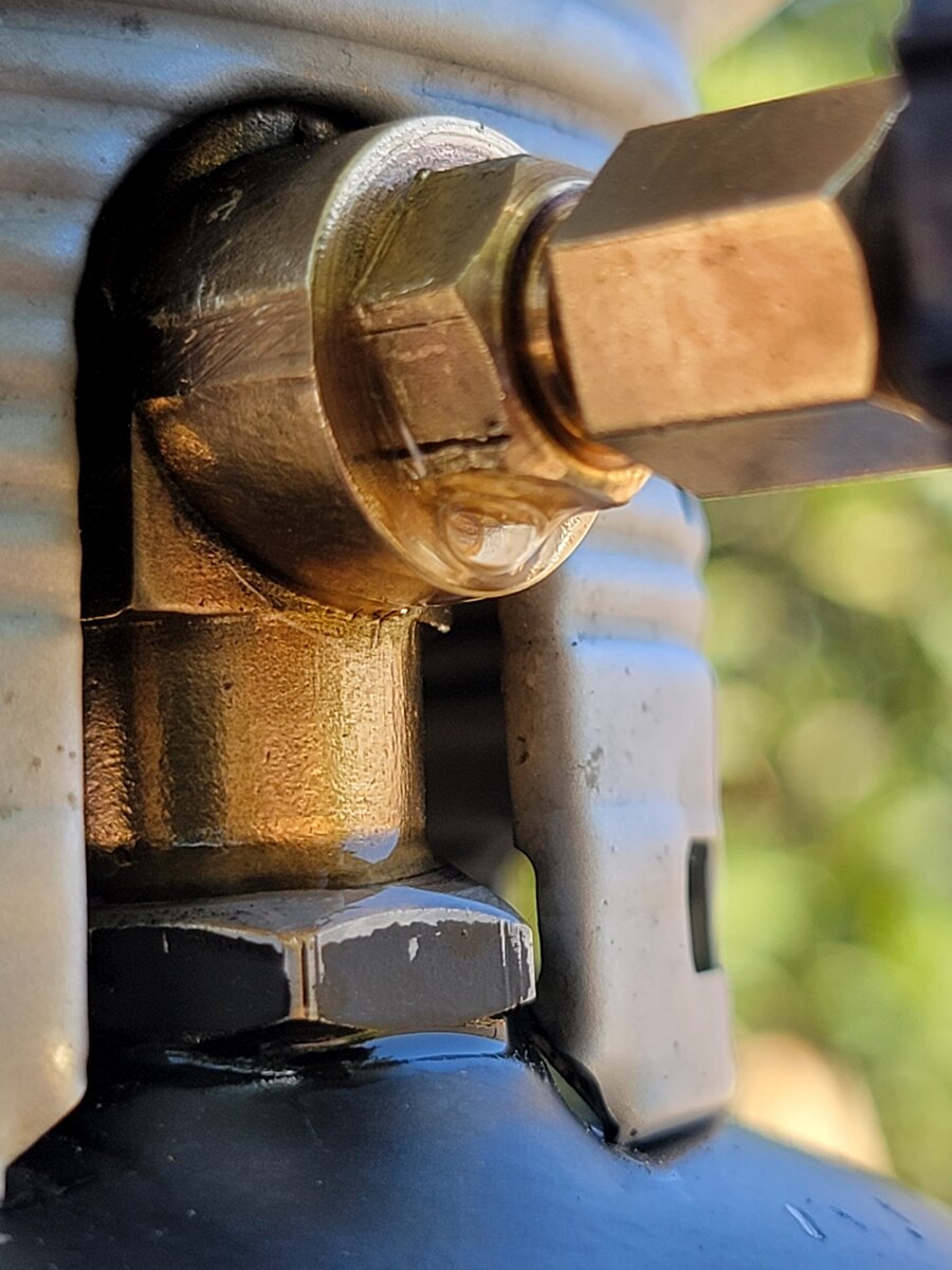

    It's still leaking from somewhere in the valve/carburetor. It looks like it's coming from this nut. Does it need a washer? I put thread sealer on the threads, but it hasn't stopped the leak.

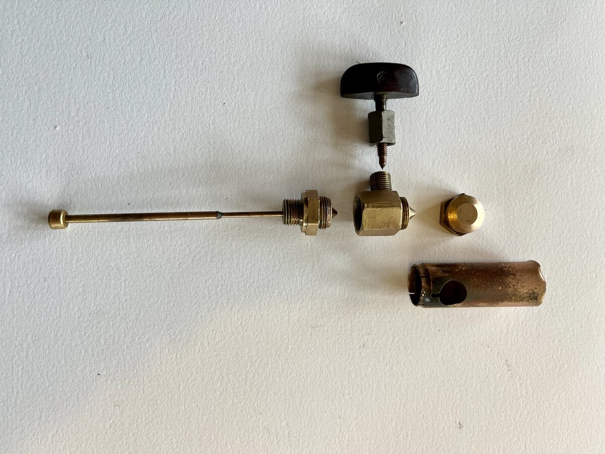

    It's possible I installed the foot valve incorrectly. I'll post pictures of it once I have it apart again. I'm still waiting for it to cool.

    I found the leak. It's coming from the valve stem nut. It looks like it's cracked and when I open the valve, fuel seeps out from the bottom of the nut.

    The nut is installed the wrong way around.The rounded part must press against the carburettor otherwise it cannot seal.
    The part #107 eccentric fitting has changed over the years.Some are rounded on both sides and some are not.
    If only one side is rounded then it should look like this. IMG_20240622_205600.jpg

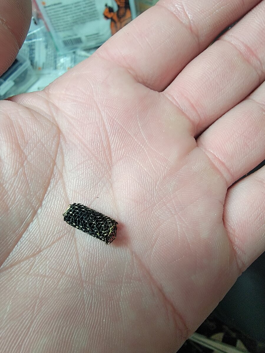

    Does this filter need to remain in the B carburetor?

    That brass mesh looks like someone added to keep the lantern from surging and pulsing (flickering). It slows the flow of fuel down so it can absorb more heat instead of acting like butter skittering across a hot skillet.
    Considering it's the "gasoline" variant and assumed it had burned gasoline in the past, that added mesh is no surprise.
