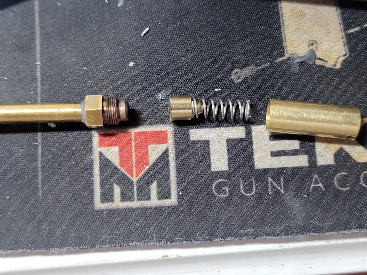

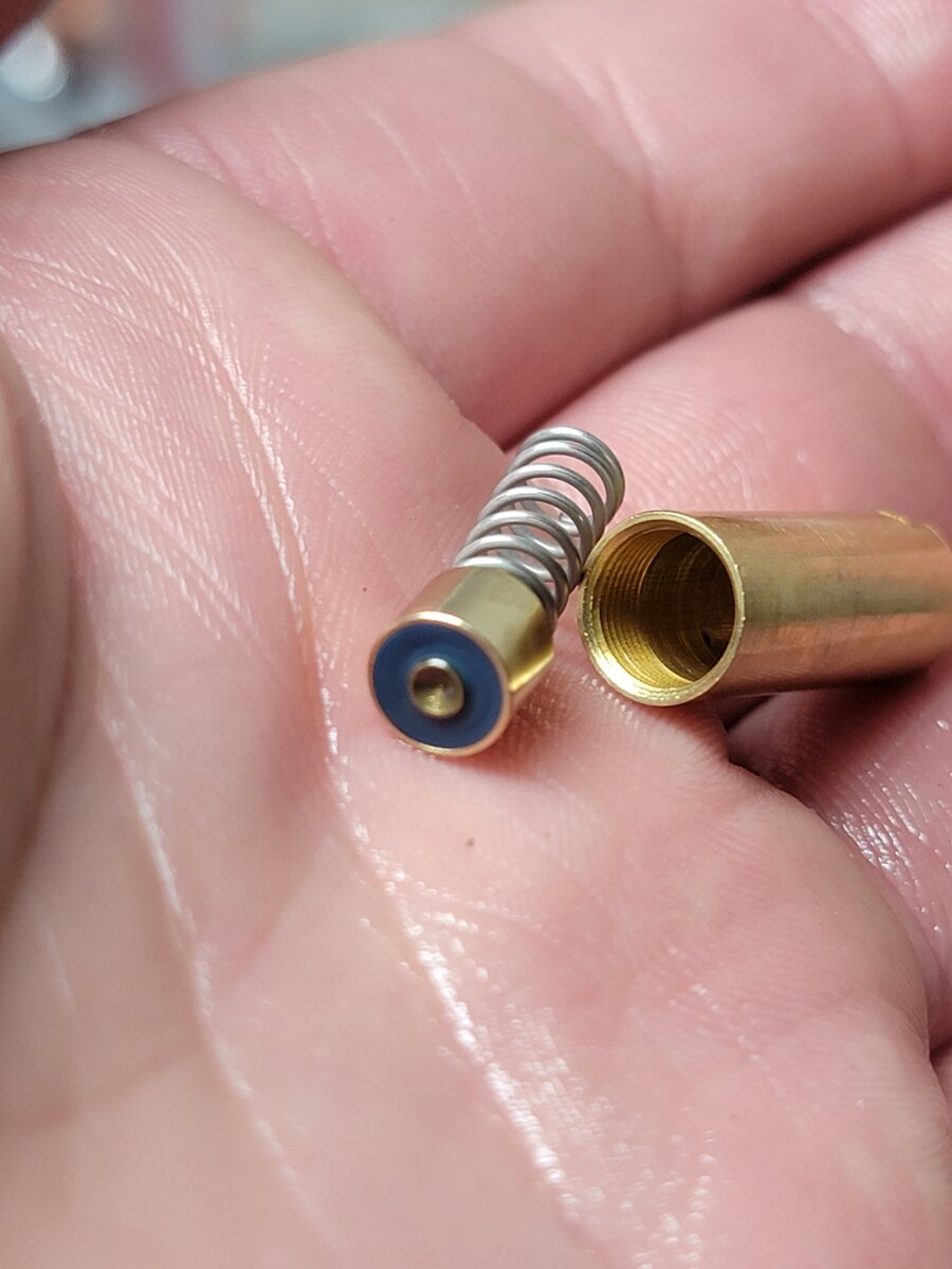

    Here is the foot valve I installed earlier. This is the order it was installed as well. Does anyone see any problems?

  7. WimVe
    3,544
    The foot valve looks ok to me. But does it operate 100% ?
    So without pre heating and on pressure where does the lantern leak?
    Because you have several point found and solved now.
    And when you open the valve (outside) do you get a fine spay line of fuel out of the jet ?
    Without pre heating you should only get fuel, with proper pre heating you only get gas, no liquid fuel.
    In all cases there should no fuel leak from underneath the jet.
  8. Gilbert United States
    May 21, 2024
    156
    Nevada, USA
    Okay I'm putting it back together now. I've got the needle set right at 1mm.
    I couldn't get the mesh filter back in the generator.
    I have it all back together. No more leaks, just a fire ball.

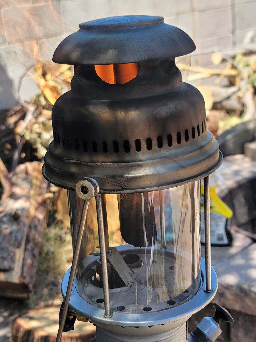

    Here is what I have after changing the needle and nipple again.
    No more flames. Could the dim mantle be because mine is blackened and full of spot?

  16. Dashwood United States
    Aug 1, 2023
    275
    United States
    A proper burn will slowly burn away the spots on the mantle. If not, careful use of a butane/propane torch around the mantle should have the same effect.

    I'll focus on getting a Preston loop carburetor.
    This is what it looks like now. It sputters and when it sputters, the mantle is momentarily engulfed in flames.
    I think I'll wait until I get the Preston loop before I try anything else. The mantle is starting to turn white again.

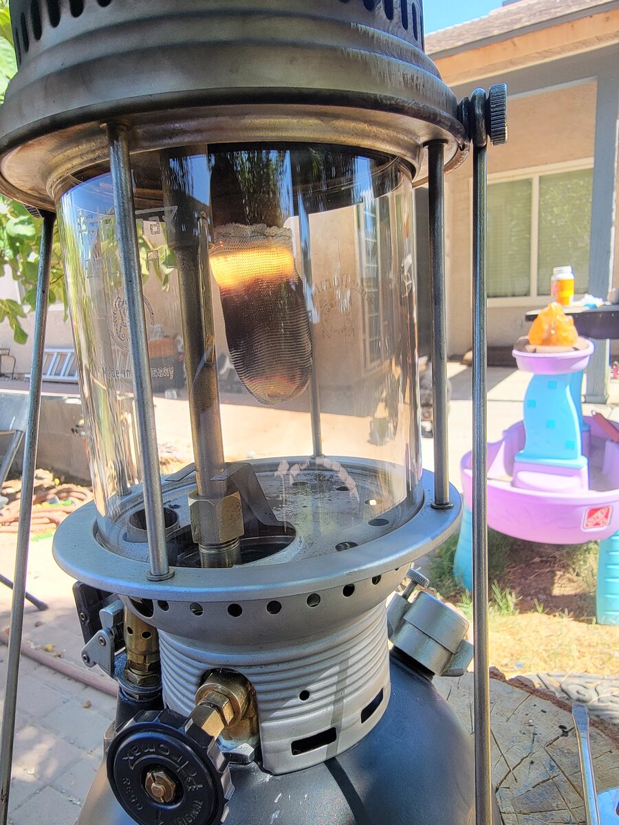

    Hi all, I adjusted the air gap to its proper dimension. My mantle burns dimly, but at least I don't have any leaks.
    Everything is adjusted properly as far as I know. I'm going to order the Preston loop carburetor and see if that helps.

  26. Dashwood United States
    Aug 1, 2023
    275
    United States
    Let it run for a bit, the mantle should clear up.

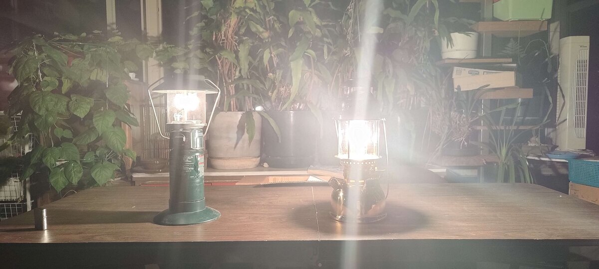

    Are the petromax 829s dimmer than the the coleman 220s?
  29. Dashwood United States
    Aug 1, 2023
    275
    United States
    @Gilbert
    A properly tuned 829s would make a 220 look like a nightlight you plug into the wall.
    I have here a propane dual mantle which should be identical to a 220 in brightness next to a Chinese production Petromax 829 pictured below. You be the judge.
  30. Gilbert United States
    May 21, 2024
    156
    Nevada, USA
    Wow that is impressive. I can't wait to get mind running properly.
