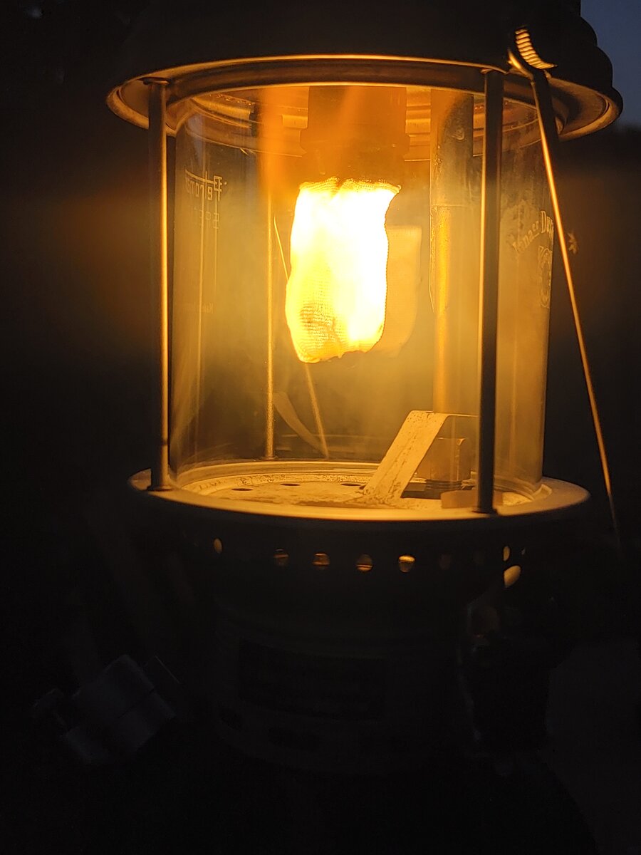

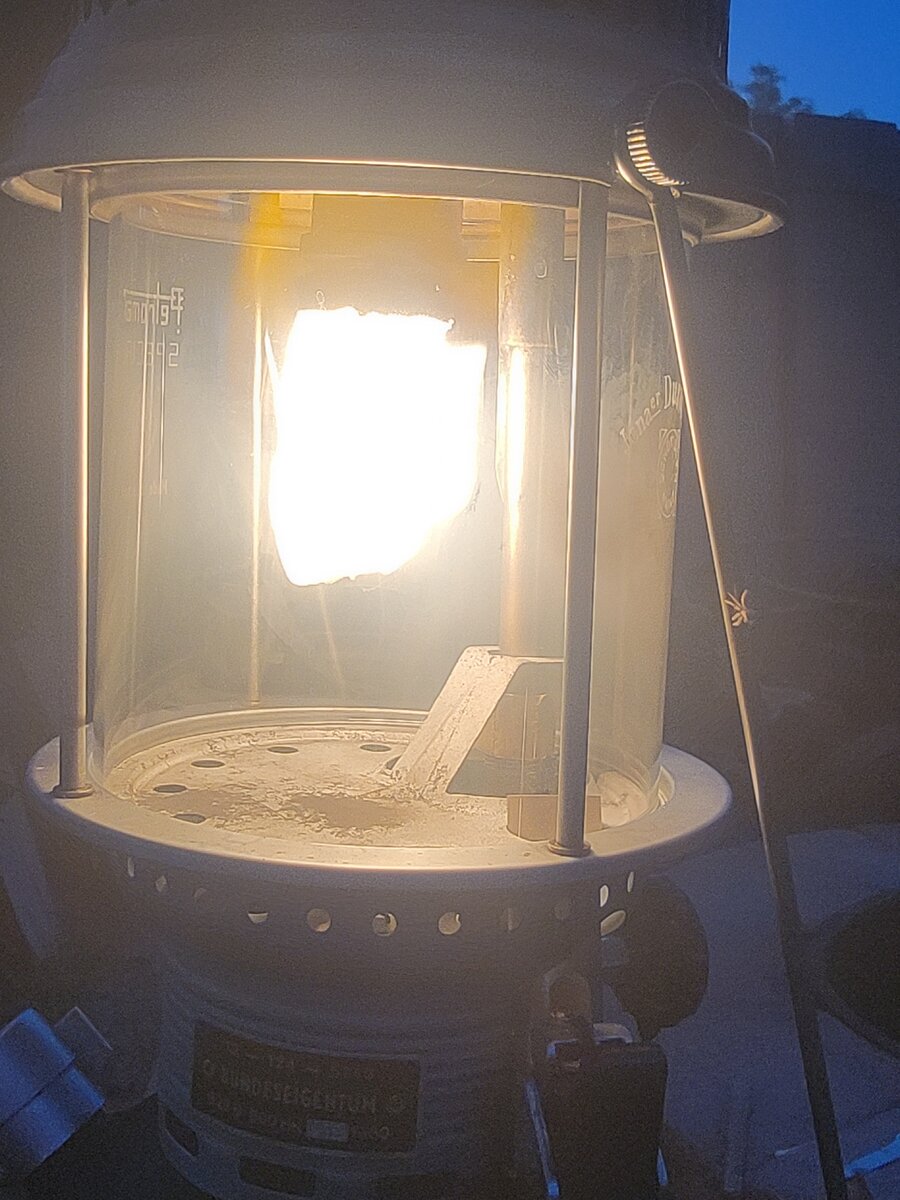

    @Dashwood I'm using Crown K1 kerosene.
    The new jet I was using ended up being a bad one. I switched back to one of the original jets. The new production jet was not spraying fuel straight up in a fine stream.
    New mantle burns bright but is still surrounded by fire. Never mind the color of the mantle in the pictures, I think it's just the white balance of the camera.

    The air gap is still 16mm. Is it still burning too rich with fuel? Is they why the mantle is enveloped in flames? I have white gas I could mix with the kerosene... Otherwise I'm out of ideas until I get the new parts.

    Are you pumping enough pressure, gauge should be at around 2.5 bar and no less than the red line during normal operation.
  26. MYN
    Is it still running?
    So, what mantle do you have on the lantern at the moment?
    Is there a paddle on the J-tube of this lantern?

    Had it pumped up to 2 bar. I can try 2.5 bar.
    @MYN
    No longer running, there is a paddle and I have it adjusted so the screw is vertical "I",) I'm using a petromax 500cp mangle.
  28. MYN
    @Gilbert
    Once you have the lantern running again at whatever its attainable brightness or burn, you can try turning the J-tube paddle to any position including a full horizontal.
    That's just to assess its influence when then lantern is operating. Don't do it while the lantern's at rest.
    Just for info, I do have a couple of lanterns that attain maximum brightness or 'whiteness' in their glow at the horizontal instead of vertical 'I'. Those had been a complete contradiction to the usual practice.:content::mrgreen:
