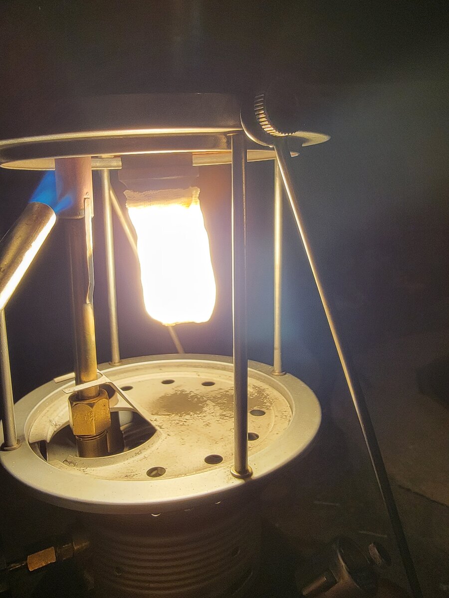

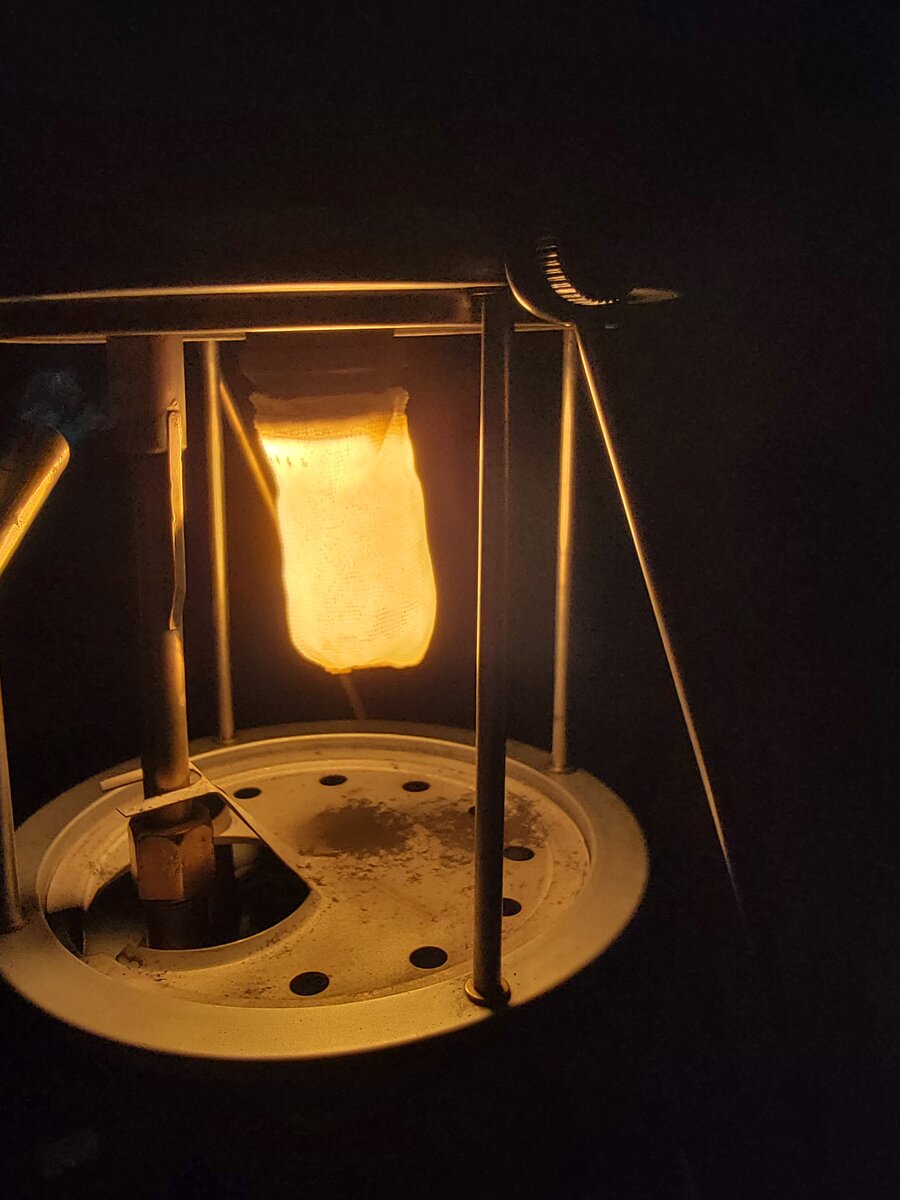

    I think it's the vaporizer. Using a torch to heat the B vaporizer caused a blinding white light and nearly eliminated all the halo. It was a windy when I tested it just now. Here are a couple pictures with different white balance.

  13. Dashwood United States
    Aug 1, 2023
    275
    United States
    Question, have you been doing all your test lights with the hood off? If so, put it back on, it helps the slow the escape of heat needed for your anemic B vaporizer. Also run the rapid torch for longer, like a minute and a half, maybe 2. Of course also have the globe on, too.

    Great findings. So...it is inadequate vaporization indeed.
    A Petromax 500cp should be 'blinding'...at all costs, whatever it takes.:lol:
    It looks like you really need that Preston loop vaporizer.

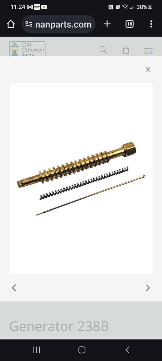

    The vaporizer / generator on those colemans have ribs on them. Maybe they help with heating?

    Also that generator is unique to one line of lanterns Coleman made, I'm talking about other ones like the 639 and 237, all use straight unribbed vaporizers, most of which contain two coil springs inside.

    The Coleman 237 and 249 do not need the vaporizer to be ribbed to work with kero...
