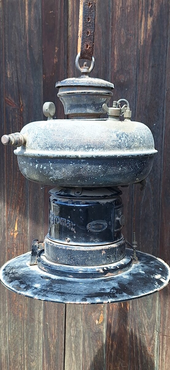

    Hello everyone,
    The day has come and it took me a while to get it...it's come directly from the crypt . I wonder if I can join or become one of those 12 knights. I'll be the southest I think!
    I'll add better pics then.
  6. Reinhard
    Reinhard Germany Subscriber
    Oct 15, 2018
    1,110
    @Adolfo
    Great find :thumbup:
    You are welcome,but you must fulfill three promises.
    1. You have to make the Petromax 868a light up perfectly.
    2. You pledge to help any Petromax lamp in need.
    3.You swear allegiance in perpetuity :lol:
  7. Adolfo
    Adolfo Chile Subscriber
    Apr 3, 2023
    200
    Chile
    Reinhard,
    I will. I'm cleaning the appliance at the moment. I just found some details in fact!
    I"ll let anybody know here so that I get proper advice.
    Thanks

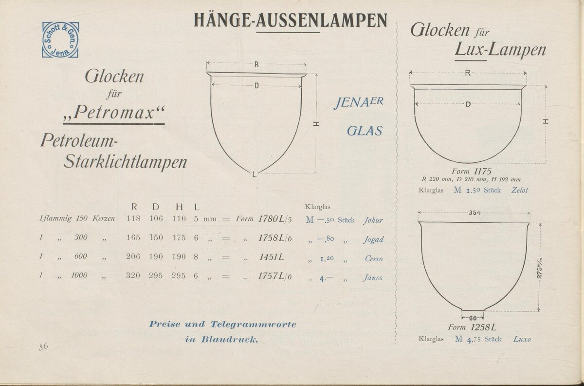

    Hello,
    Today I got a positive reply from a handblown glass workshop overseas. This person says they can make borosil glass for this model. Is there any reference here where I can get those specific 868a "technical drawing" with all measurements (length, diameter, width, small hole diameter, etc)?, or could any here provide his?. They are required for the maker indeed. Prices and timeline will be sent after they get that technical information. I've seen 2 models of glass globes in different sites.
    I won't upload any commercial link on this forum, but I think the more glass globes we order, the better for anyone who needs them . If someone is interested, please send me a P.M. I have no commercial link with this person, I insist.
    The only reason for doing this is to try to find an alternative for a sold out item.
    I'm looking forward to seeing your drawings!
  13. Jörg Wekenmann
    Jul 11, 2021
    250
    Hello Adolpho,
    I don't know whether the measurements in this overview from 1911 are still valid for the 1920s or 1930s. If not, then you can use them as a template.
    Best regards,
    Jörg

    Hello Jorg,
    Thanks for your attached paper. It's great to see that even today you keep written records like this one in your country. As you say, I'll keep it like a templete as other member can provide further info as well or measure a real "glasglocke"
    On the left page, I read figures such as: 150 300, 600 and 1000. Are those hk? I assume 800 hk's measurements should be closer to 1000? Am I right?

  17. Jörg Wekenmann
    Jul 11, 2021
    250
    Hi Adolfo,
    on the left you can read = 150 Kerzen = candle
    Kind regards
    Jörg

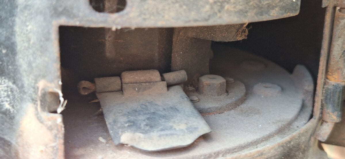

    Hello,
    How do you normally remove these three screws? I took Reinhard's picture. In my lantern they are extremely stuck and a bit rusty. I don't want to destroy the screw's head with an ordinary screwdriver. Can I use a torch and add some water then? I hope you understand. Screenshot_20251227_151815_Chrome.jpg
  20. Marc W.
    Marc W. Germany Subscriber
    May 11, 2024
    45
    Hey Adolfo,
    these screws on my two 868 were not that tight, so normally you should be able to remove it. In your case I would try WD40 first. If it doesn‘t work after letting it go through the thread (1-2days), I would try it with a torch as you already mentioned. Heat up the cast iron base plate and then try to turn the screws carefully.
    Later
    Marc

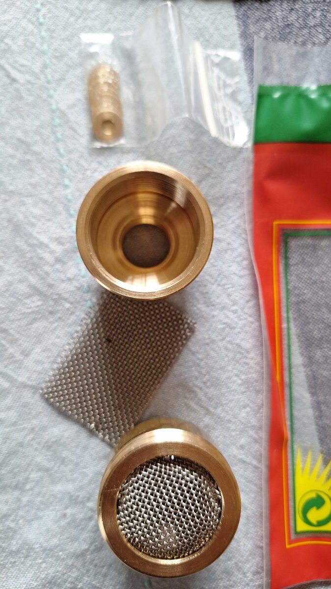

  22. Adolfo
    Apr 3, 2023
    200
    Chile
    Hello,
    After a while, I found someone who gave me a hand with some spare parts for this model.
    If you ever need some help, please P.M
    I'm looking forward to paying it forward!
    Thanks
  23. Marc W.
    May 11, 2024
    45
    Looks good @Adolfo ! Hope you get your lamp running soon!
