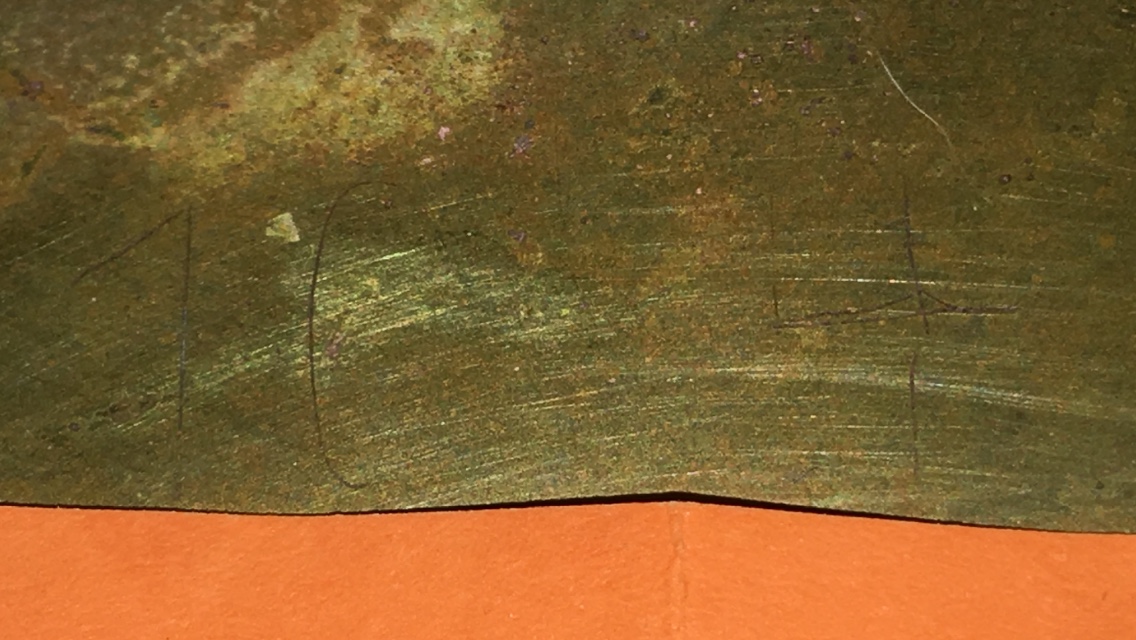

    CB71F327-DC18-4571-AEFA-60FE128D0D40.jpeg I have a Petromax 826 with a 10 and a 4 scratched on the base.

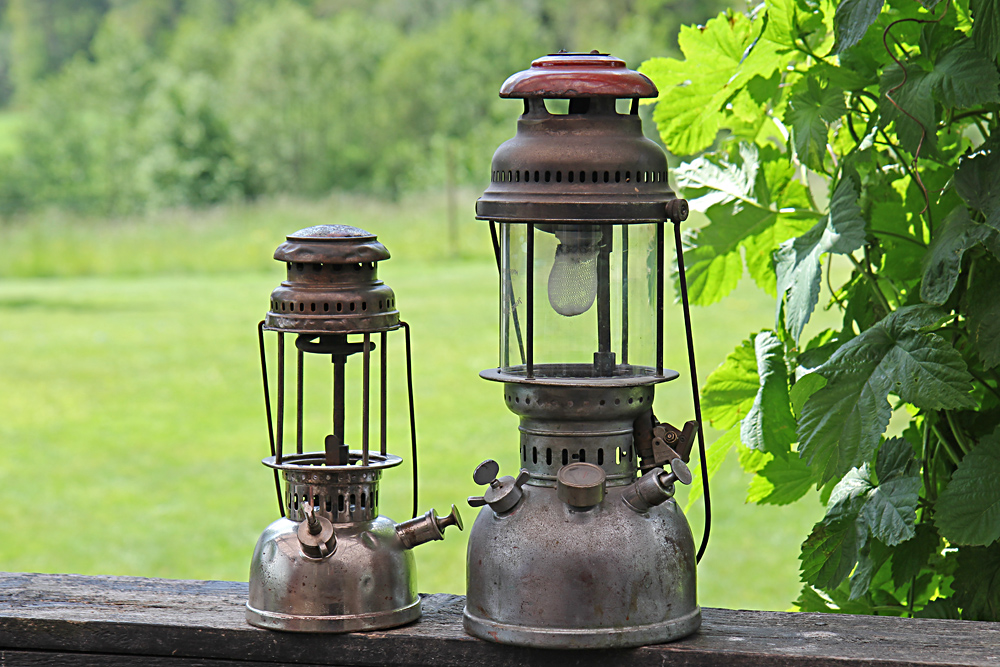

    I checked a couple of Petromaxes, and it turned out that both had some scratching at the tank bottom.
    A 900 little baby and an 828.
    I knew that the little baby had the number scratchings before, but I was certain that the 828 lacked them.
    But a more thorough look actually revealed some very light scrawl at the bottom of that one too!
    So the 900 appears to have 540 and the harder to read 828 seems to have 141.
    Does that make any logic considering the look of the lanterns? May 1940 and January 1941, perhaps? Anyone who can shed a light?

    @Andrew T
    10 4 is October 1934
    Thank you for sharing.

    @Carlsson
    Absolutely correct
    You understood the Petromax code of the 40s.

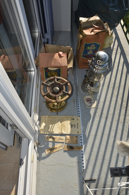

    In august 2015 i bought a Petromax 829 in the carton and a No 5 Petromax stove in the carton.
    The saleman emptied the barn from a friend's parents and he told him the grandfater bought the lamp and stove for camping at the end of 50s at the same time.
    Hand engraving for the lamp is 3/8
    Machine engraving for the stove 68
    I think March 1958 for the lamp.
    I think June 1958 for the stove.
    The paper from the stove is dated March 1958.
    The Petromax catalog of july 1957 presents on the first page a lamp with a smooth collar , then all the model in the catalog have a striped collar.
    All the same a certain coherence.
    Regards,
    Titoo.

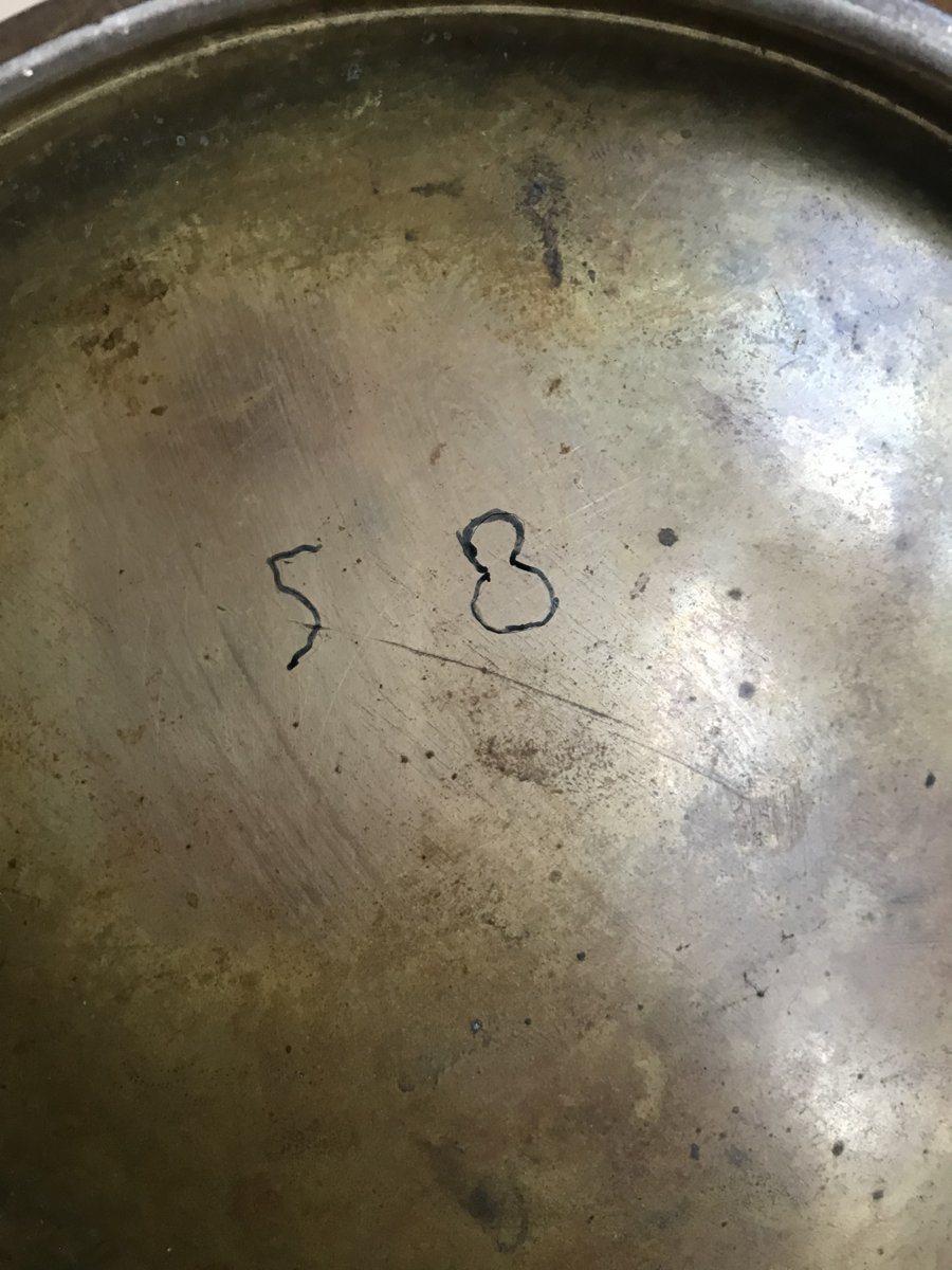

    Here a Petromax 882 with what looks like “5 8”:

    1 2 =January 1932
