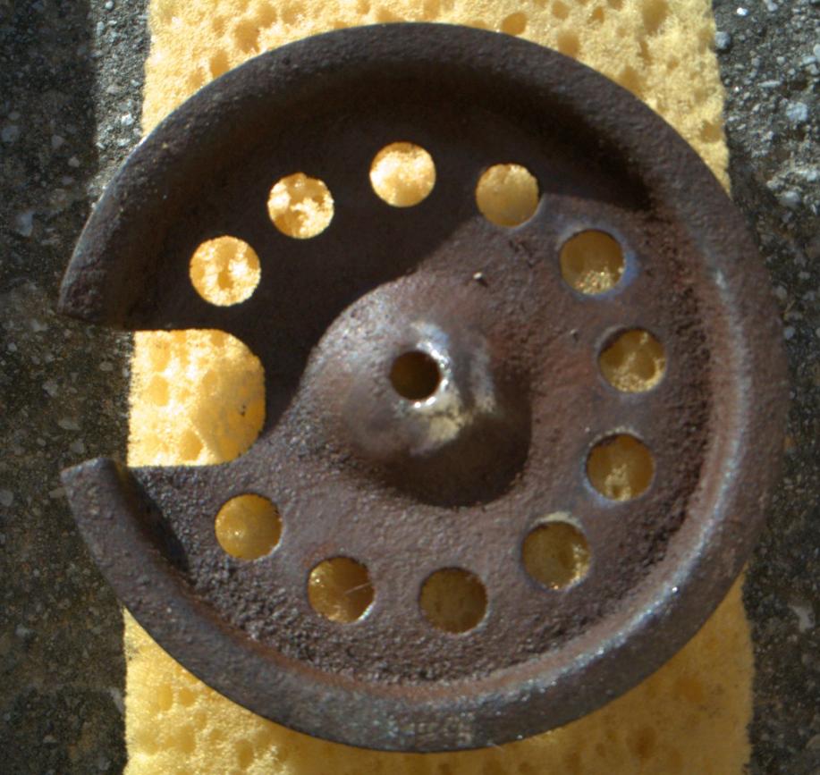

    Correct, thanks. Part 122 the centering bottom gets magnetized and it is very rusty as you can see below.
    I tried using sand paper (as you can see at the center of it) but is hopeless. Too much work. Can I use a chemical like desoxidante? It is a rust remover. I just wonder if I risk anything. Since it is magnetized it is not brass. What is this made of? Under the rust it looks silvery.
  13. podbros
    3,996
    Citric acid or vinegar will get you going??
    yes, rust removers are available but can be costly and don’t really justify the expense on this occasion?
    if it was enamelled or similar then maybe?
    electrolysis would also work?

    OK, let me ask something else. The plate I picture above (#122) needed several attempts to remove rust. It was too rusty. Now this is magnetized so it is not brass. It looks like something like steel (maybe stainless?). Now that I removed the rust, is there a way to help it preserve its current state, mainly when it is in storage? I still have to replace all kind of gaskets (I have ordered them and wait to receive them), but after I test it and is in working state, it will be put in storage/display. How can I avoid it getting rusty again? Because this was the most damaged part so far. The rest of the lantern is nickel plated brass, but not this one.
    Another metallurgical question: What will happen if a piece like this, if it gets rusty again, be painted with tannic acid? This converts the rust to metal again and bonds to the surface. Of course it will become black, but does this withstand the heat of the lantern? I guess this piece does not get too much hot as air passes through its holes to provide oxygen to the flame. Hot, but not extremely hot.
  20. podbros
    3,996
    The cage base plate you showed is almost certainly mild steel not stainless.. stainless can rust, despite its name but it needs to come in contact with rusty steel first which contaminates it.
    there are high temperature silver coloured spray paints which have been used successfully by members?
    also members have done their own nickel plating for pieces like this using the old school battery chargers and making their own electrolyte
    you can use a rust converter but the object needs to be painted or protected as soon as possible as exposure to air will start the rust again
    there are cheaper rust converters and you pay for what you get, in my opinion, so i would pay more for a better quality type?

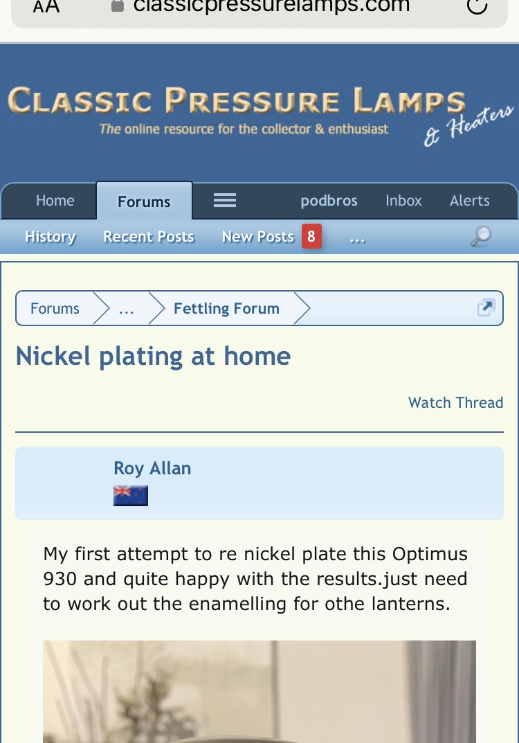

    This thread called ‘Nickel plating at home’ is encouraging ?
    i found it by using the search bar
    they recommend looking on youtube as well

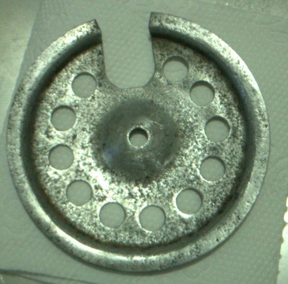

    I tried to remove rust with citric. I applied many times until it was possible to remove the last rust with sand paper. After sanding (by hand) the above part turned out like this:
    So rust is gone. But the metal has black stains. I though this would be burnt oils, so I applied "WD40-Multi purpose degreaser", but did not do anything. It stayed the same. So either the black stains are not burnt oil or the Multi purpose degreaser I used is not capable of cleaning it. I guess I can not attempt a nickel plating procedure if the metal is not completely clean. Or can I? If I can plate it while being in such a state, I will order some nickel to try and learn the home electrolysis procedure.
