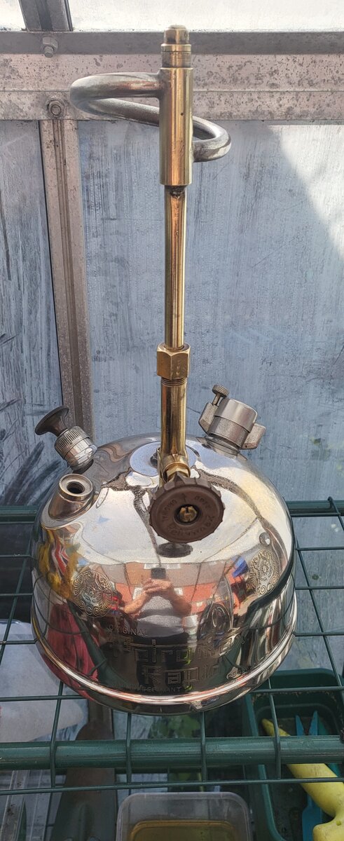

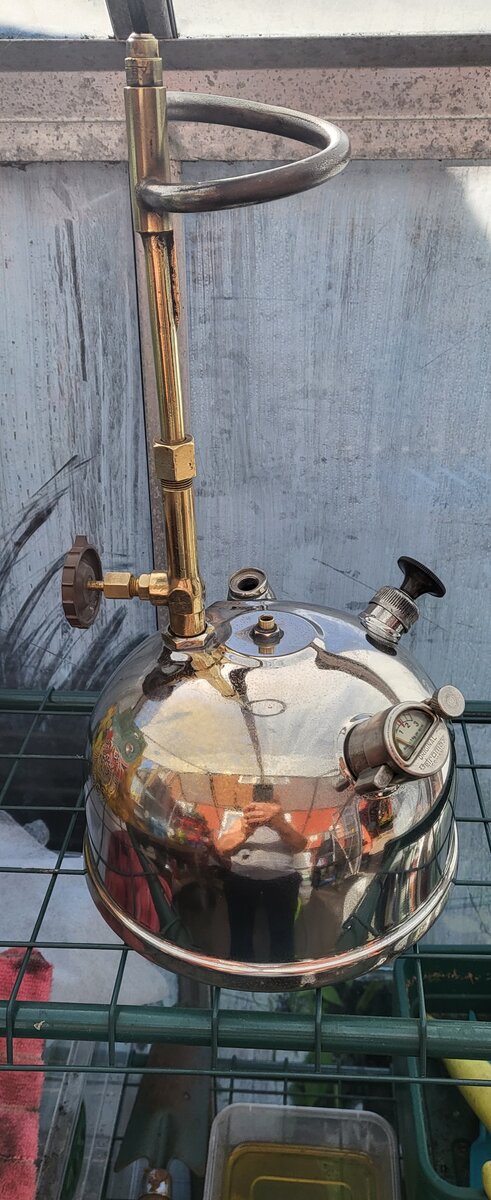

    Ok guys this is the state of play the buyer turned up and didn't want to know so its down to me to get it up and running.
    I've placed the parts into a citric acid bath then into a soapy water bath then a fresh water one ,dried off then onto the buffing wheel for a polish I'm determined to get it running right . 20211003_112133.jpg

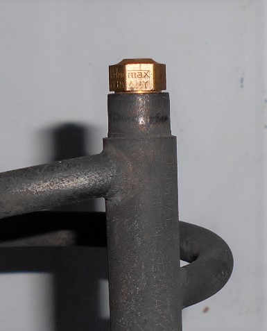

    There's a bit that puzzles me though, normally I'd expect the top of the vapouriser to look like this

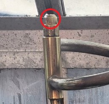

    yet when I look at your example, I see this. Is it attached to the lamp or is it part of the building?
    Happy fettling and don't forget to include a new jet when you put in your order.

    @Henry Plews
    That's part of the greenhouse Henry it looks like yours .
    There's less than one millimeter of needle showing at the moment but obviously I'll make sure it looks the same when the service kit is fitted .
    The new jet is top of the list .
    Thanks for your comments :thumbup:

  17. Henry Plews
    3,073
    Ah, I thought it might be but the brassy appearance (to my eyes at least) cast a shadow of doubt.
    Optimum height for the needle is between 0.5 and 1.0mm so as long as it's within that range with the new jet fitted, it's good to go. :thumbup:
