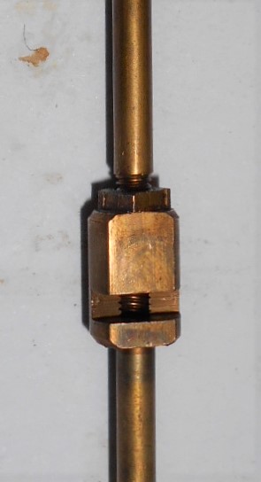

  7. MYN
    Yes it does light up nicely now but I'm pretty sure you'd still want to sort out that 'nuisance' catch on the pricker control.:D
    Since you've already arrived at this stage of fettle, I'd reckon it won't be too difficult to dis-assemble the generator/pricker control/footvalve. Only need to be gentle to avoid using brute-force and damaging anything.
    Remove the upper generator/Preston loop first and turn the pricker control wheel. Test if it still catches.
    If it does, then then remove the entire lower generator-fuel pick up assembly and check through everything inside, including the footvalve.
    Check that the eccentric block has been assembled exactly like that shown in Henry's photo and not upside down:-
    I've seen at least one that had been wrongly assembled(upside down) and the result was that the pricker wheel can't be turned 360° in any direction.
    On other instances, I found that the lower pricker rod was bent and there were some carbonized material and other stuffs partially restricting the rod's movement.
    Whatever it is, you'd need to dis-assemble the lower generator to find out. At the same time, you'd get first hand experience on the footvalve as well.

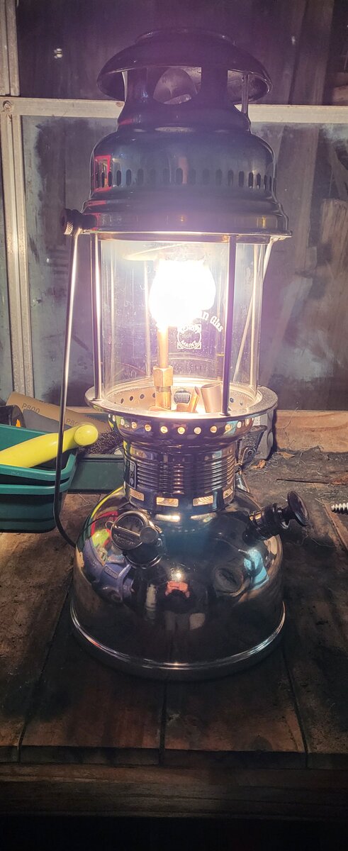

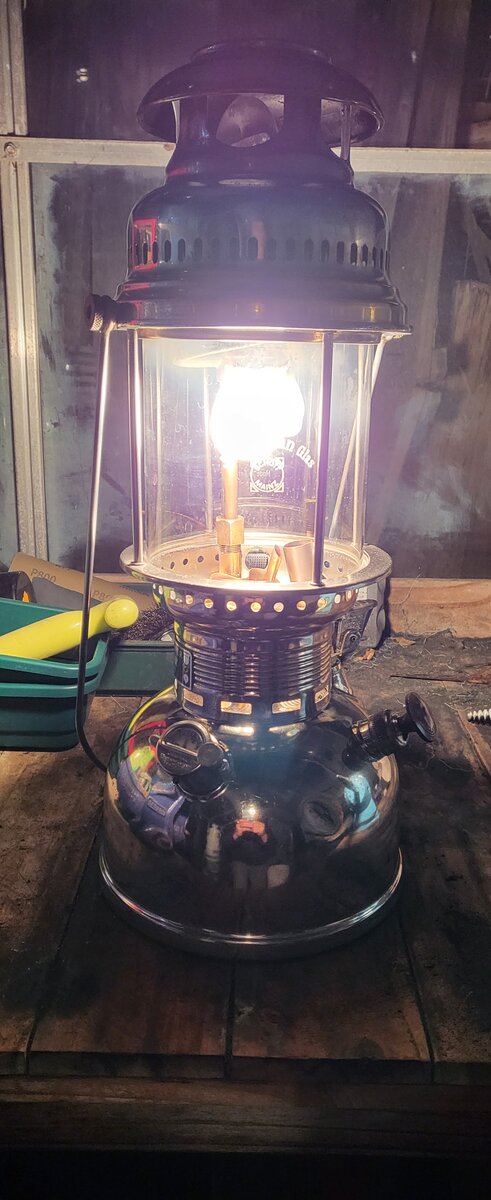

  15. Peter Perry
    Jul 11, 2021
    128
    West Midlands
    20211010_190827.jpg I must be doing something right guys four hour burn and not missed a beat.
    Good Times
  16. WimVe
    3,530
    As long as the tank has pressure it will run for about 8 hours.
    If you even don't have to "needle', use the cleaning needle, you have done a good job.
