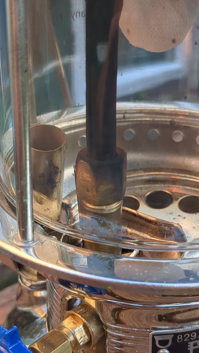

    Don't forget to tighten up that jet/nipple/nozzle you can see where gas has been escaping up the side of it. If it still leaks after tightening they try using some copper or nickel based grease on the threads. Veel Sucess !

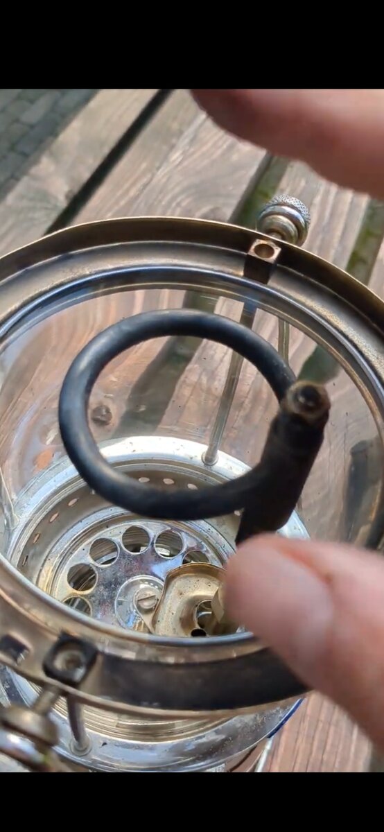

    Even more flames... And now it's leaking fuel between the upper and lower carburator because I tried to turn the upper part more to the center. I think something is wrong with this specific piece of lamo although it worked a few days ago. I think I damaged something while repairing and replacing things. I'm almost giving up hope. For tonight. Tomorrow there will be energy to pick this up.

    As you say you probably loosened it while trying to rotate the vapouriser, or is was a little loose to begin with. You could just try and tighten it a little - or you could take it off and make sure there is no grit/dirt on the mating surfaces. There is no gasket or seal on that joint, it relies on the conical profile of the vapoursier to seal against the nut.

    If you twist the vaporiser while it was fixed (dus wartel niet losgedraaid) then you may damage the thread and/or loosing the joint.
    The innerhood should fit normal without any aplied pressure/force. Check first why it doesn't fit.
    Like I said earlier: do you get a straight fiuel spray out of the jet when under pressure and without inner hood and heating?
    So a cold "shower" test. If for some reason the jet doesn't fit right on the vaporiser or is damaged the spray of fuel/gas will not enter the J-tube correctly.
    This all besides the already mentioned leaks.

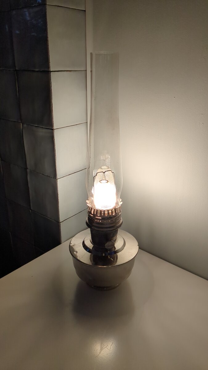

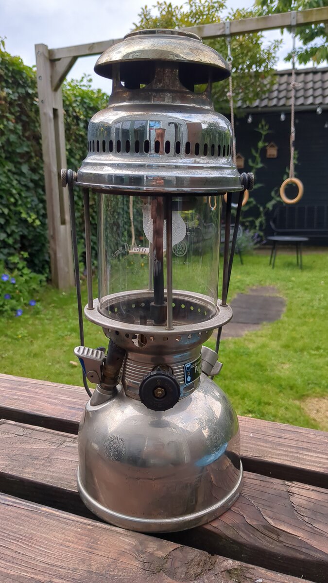

    Update: I also bought a Petromax 828/350 CP. I paid 30 euro. It looks quite old and is German made and has the 10 stars logo.
    The difference between the problem Petromax from the previous posts is that everything fits neat and perfectly with this lamp. I cleaned it and reassembled the lamp and it worked instantly. Wow! Cool!
    The problem with the other lamp is certainly in the carburator and the nozzle. The petroleum is not coming in a straight line into the J-tube. I think I'll have to buy a new needle and will try later. But so happy with my old other lamp!

    Chances are, you probably need to get a new carb/vaporizer along with a new jet/nipple. On some chinese made model, I've had new jets still weep kerosene no matter how tight I can get on the carb without stripping the threads and I had to find a replacement carb.
    On the same note, please make sure your nipple is tight before every firing, it's tedious I know but they have a propensity of working loose over time. You can typically tell if the tip is starting to work loose by observing the "heat" lines of the invisible flame dancing around the mixing chamber and that usually means to me it's time to tighten the nipple on the next firing.

    I will try soon... This victory moment with this 828 gave me more courage to go on! The Chinese lamp burned for a few hours so it can work, but I unscrewed every part and possibly made a mistake somewhere. On the other hand it seems that the lamp is crooked by a fall so maybe things are really broken and have to be replaced, for example the carburator. Quite expensive to get a new one. First I am enjoying this 828 for outside and while camping this summer. I have also bought an old Aladdin 21 for the interior. That lamp is also burning very nice.
