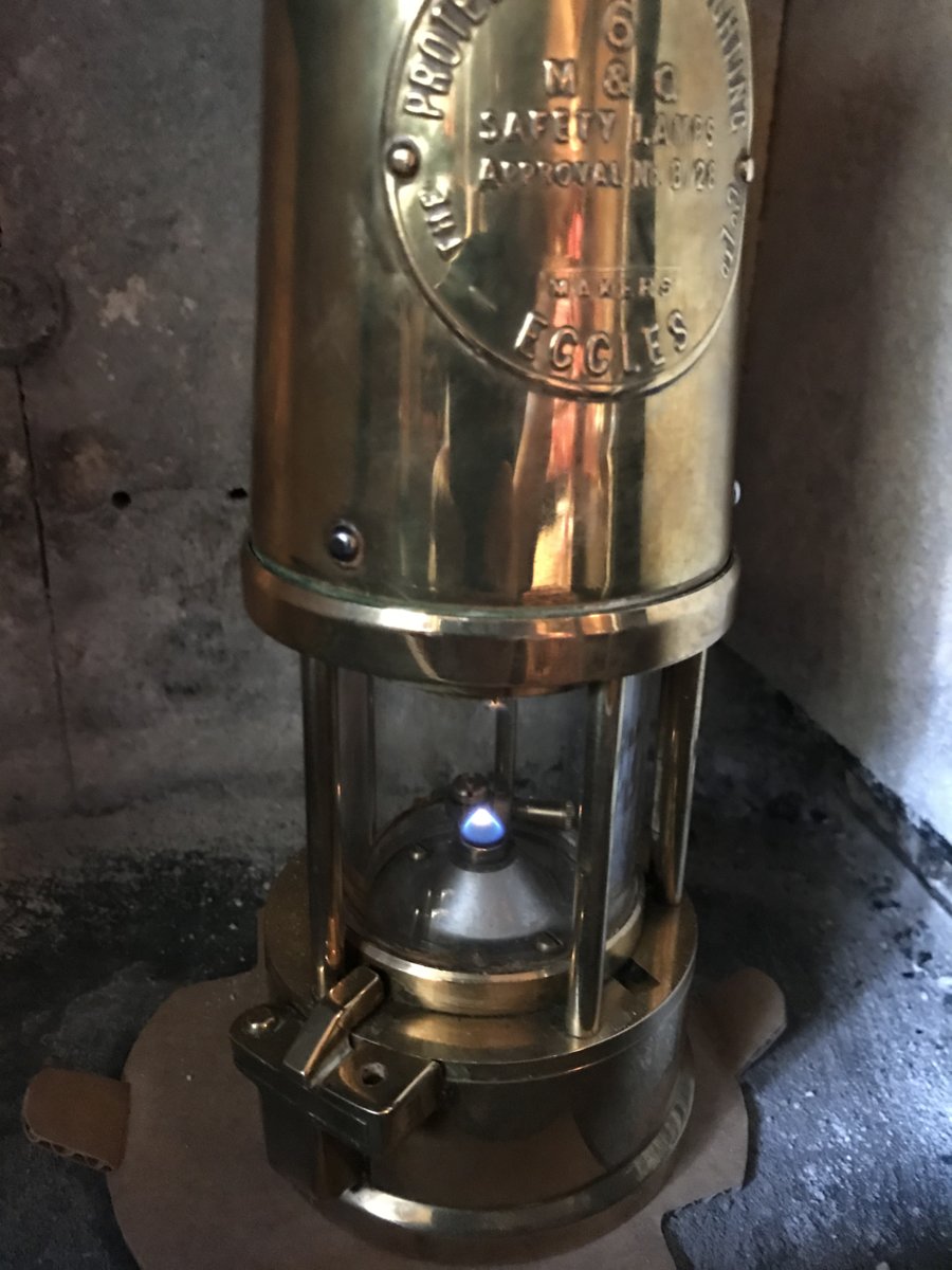

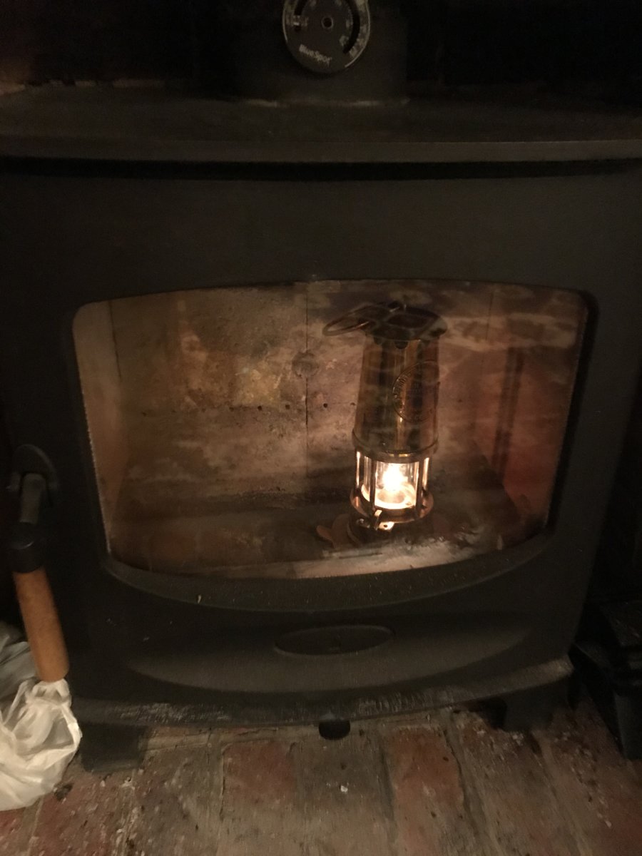

The Eccles protector has been fettled too today... The Flint striking mechanism was caked up and the original flint crumbled away. Now all loose and working. After doing some reading online I found that Coleman fuel is the nearest thing to Colzaline and lights promptly from the striker too. Tonight Im doing a burning duration test on a full tank (around 70 ml). I’m expecting 20 hours + with a small flame... I put the lamp in the wood stove for safety.
@Alex74 Nice looking lamp and congratulations on a fettle well done. I’ve always liked the look of these. It’ll be interesting to see how many miles per gallon she runs for on a full tank of juice. Cheers Pete
Hi Pete. I’ll let you all know tomorrow evening. We’re now one and half hour into the burn and looks steady as a rock. These are the lamps they use to carry the Olympic flame and sacred fire on planes and they have been chosen for a reason. I know I shouldn’t post wick lamps on here, but I thought you guys might be interested to know how standard Coleman fuel (£6/L on Amazon) performs in one of these iconic lamps.

23 hours on and she’s still alight, just. A small blue cap flame hovering over the wick. I’m about to put it out of its misery... but that’s not bad for 75 ml fuel is it? Pretty impressive.
That’s amazing @Alex74 I wouldn’t have thought that. Thanks for the insight to this lamp. Cheers Pete
