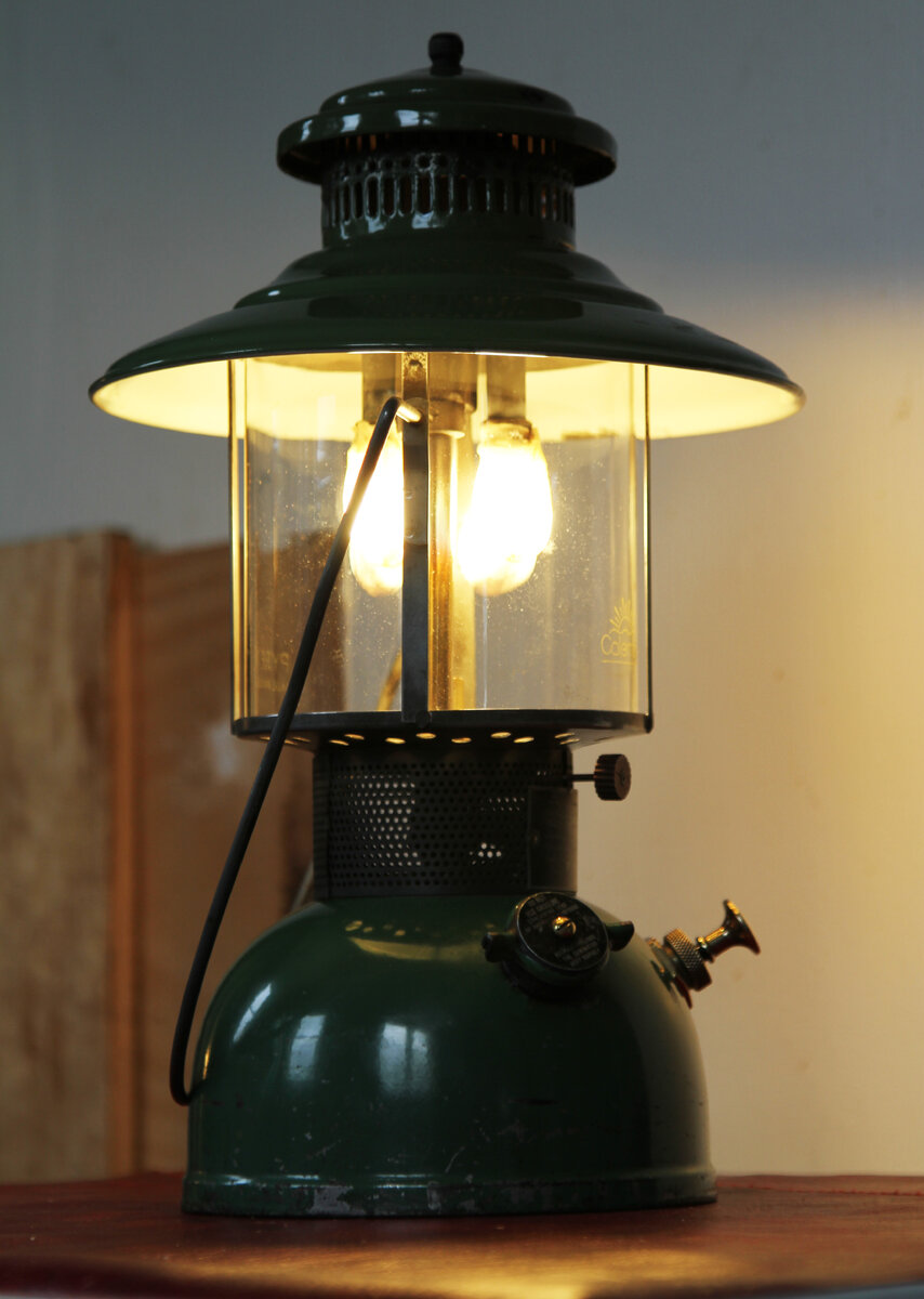

    This is my Prentiss Wabers L13. Just finished this one and it runs OK but not as well as I would like. I think the genny needs some work as it appears to be delivering insufficient gas. These are very well made lanterns with a really solid heavy burner and a base plate made out of a heavier gauge of plate than the usual fare. A pleasure to fettle with no nasty surprises
    I don't know whether the version without the separate filler cap preceded these versions with the dedicated filler cap? Anyway very biddable and runs quietly, just not very bright at the moment. These seem to have been made in the mid 30's.

    The build quality is excellent.:thumbup:
    The fuel feed pipe may be partially blocked and some American lanterns have a gauze filter on the end of the fuel feed pipe and it gets mucky and the link below shows the restoration of a sibling of your lantern.

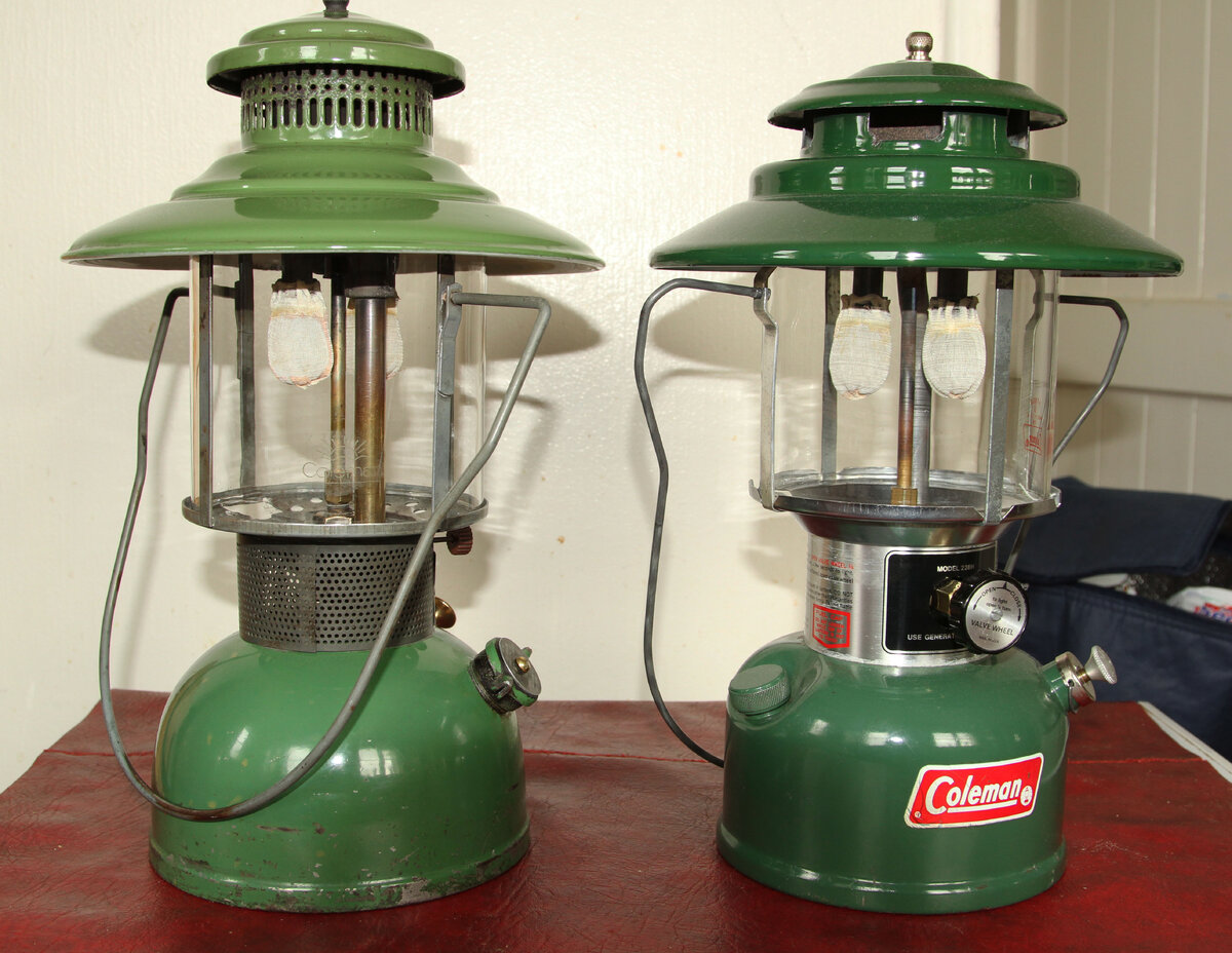

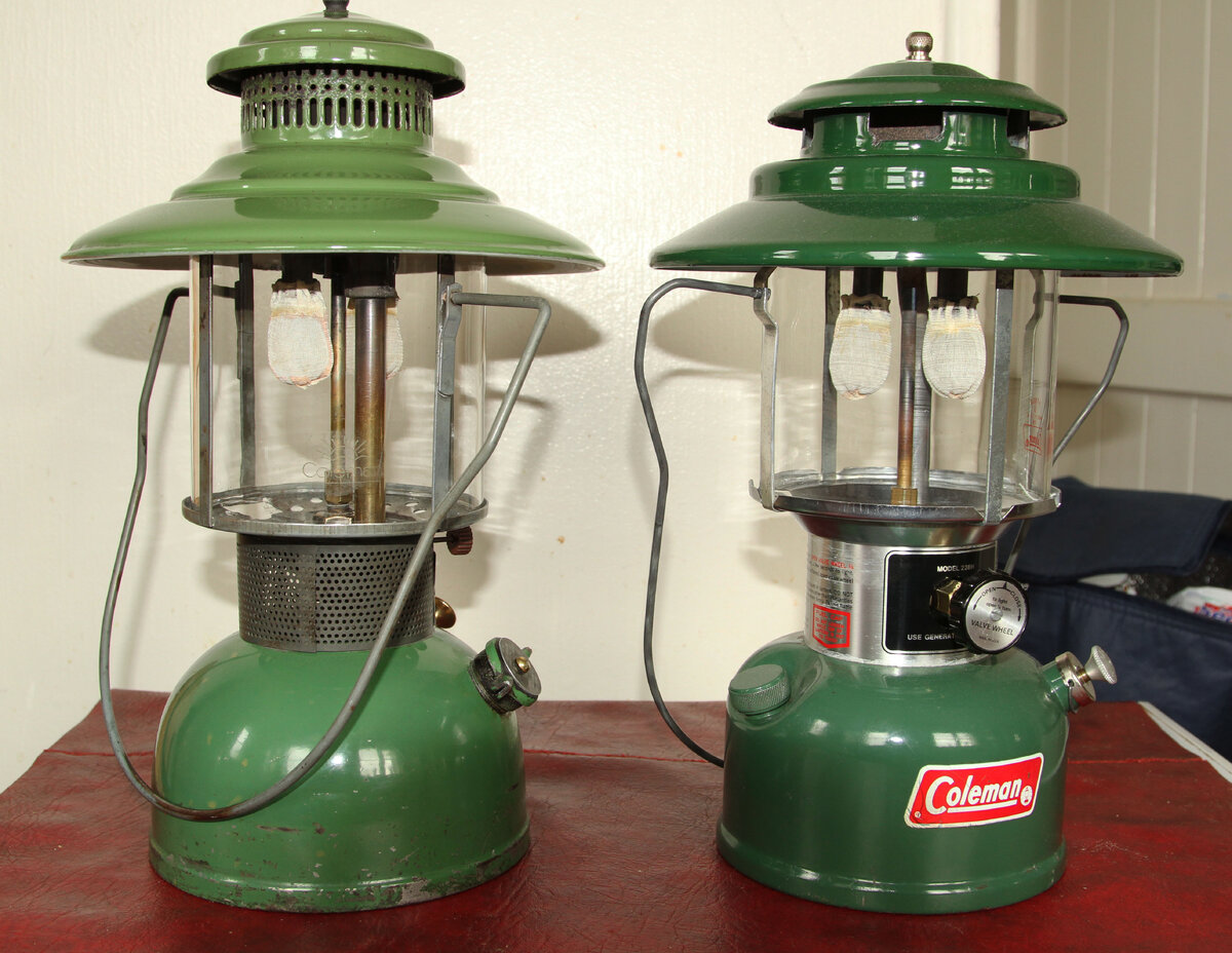

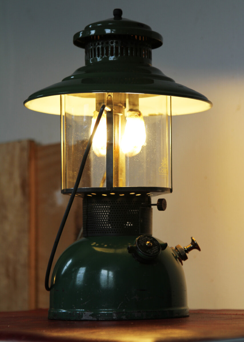

    I may have to lower my expectations of just how bright this lantern might normally burn. Trouble is I preceded this fettle with a Coleman 228H and was expecting the old lantern to be similar in output. Probably not realistic. Also for the size of the tank the pump tube diameter is quite small, so more pumping required than I had been giving it. Seems to kick off after 100 strokes.
