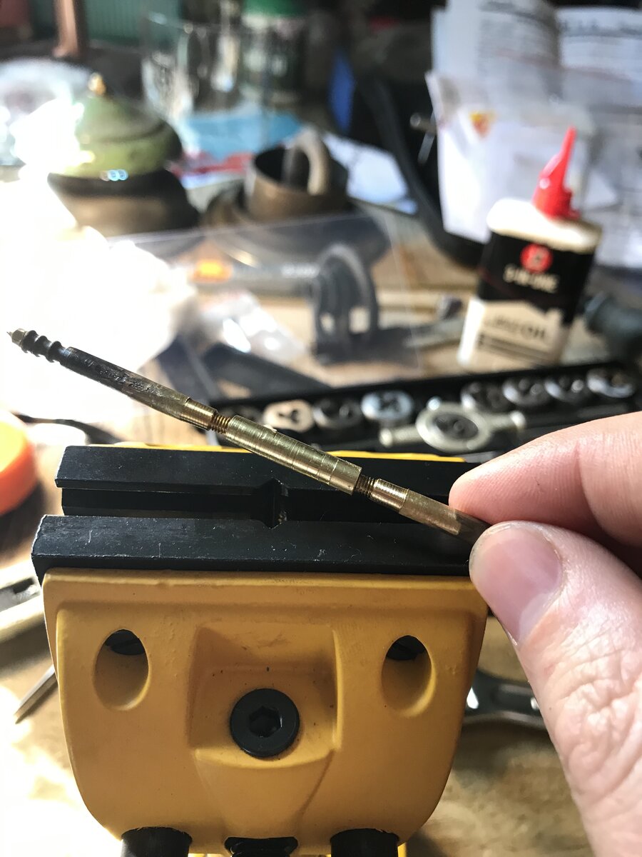

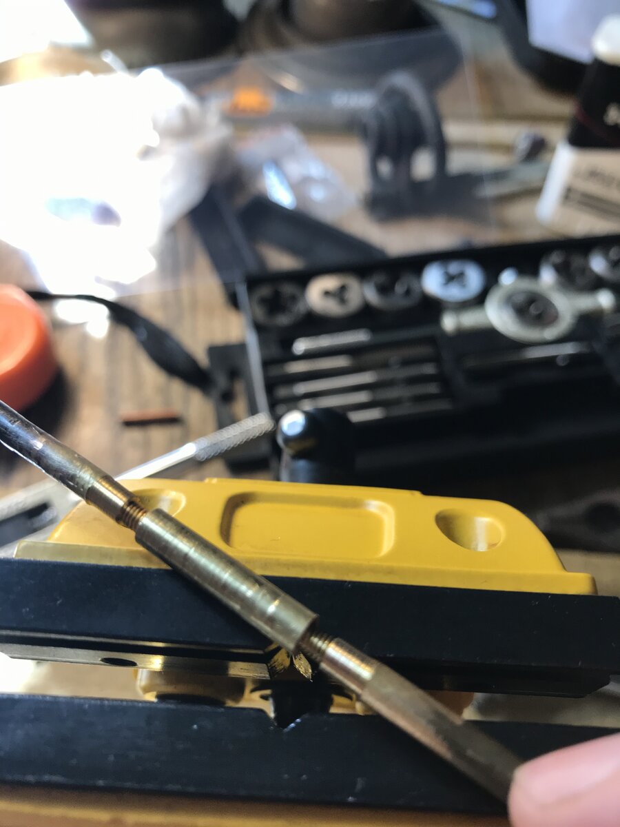

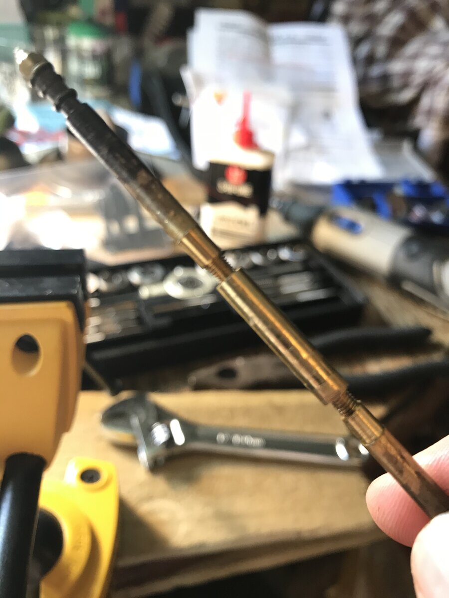

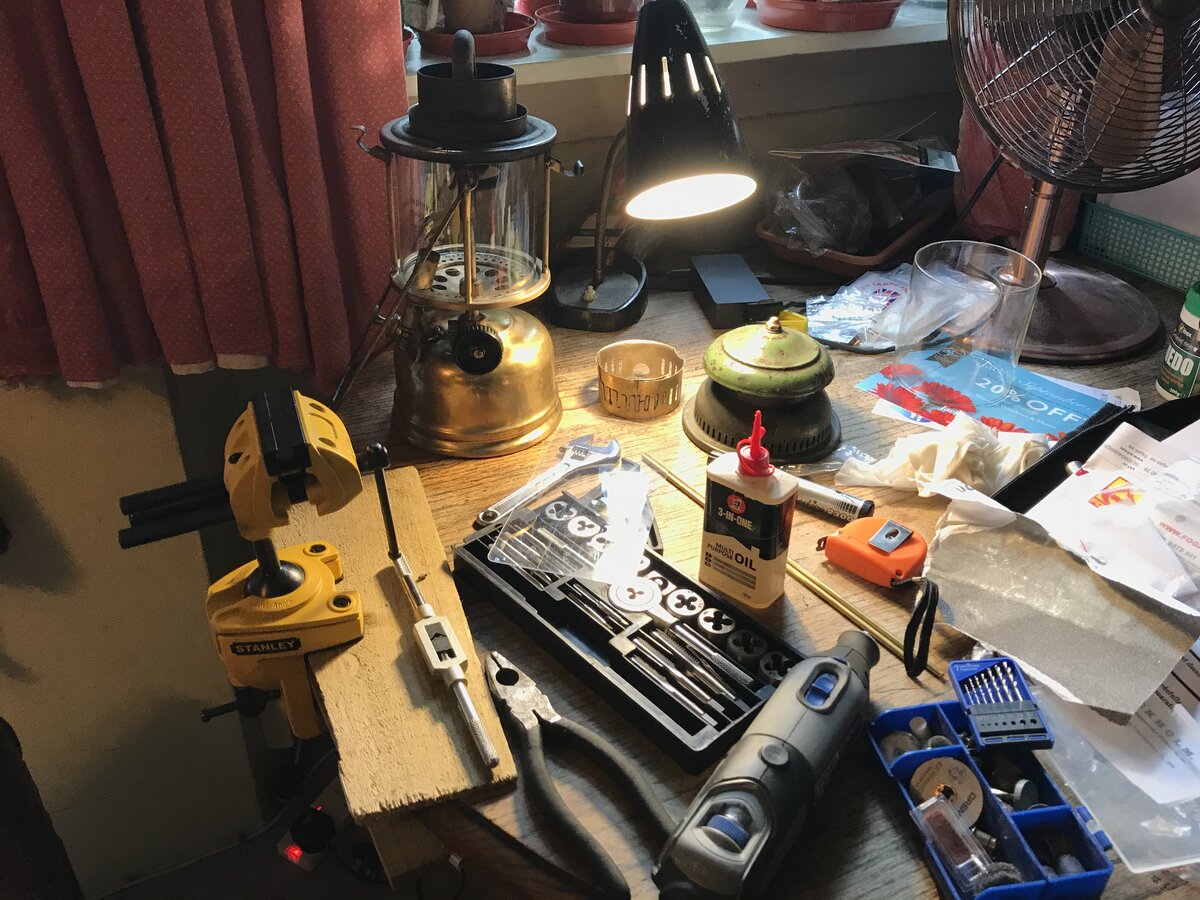

    Back to the fettling table and I just did what you have suggested. Sliding a new needle up the jet by hand, there is a ‘step’ or little obstruction in the new jet but not the old jet. I can’t quite shine a light inside them to take a closer look. I have also made a more robust ( less Heath Robinson) threaded coupler which enabled me to adjust the overall rob length to 154.7 mm, hence 0.3 mm less than previously. It seems a better fit with less pressure felt on the control wheel (see photos) In full closed position. I have reassembled everything with the old jet in the burner, and the needle just glides in and out every time the wheel is turned to the left. I just fear the old jet has a slightly larger hole than the new one, meaning it may be worn. If so I’ll get too much fuel out. But I’ll try lighting tonight.

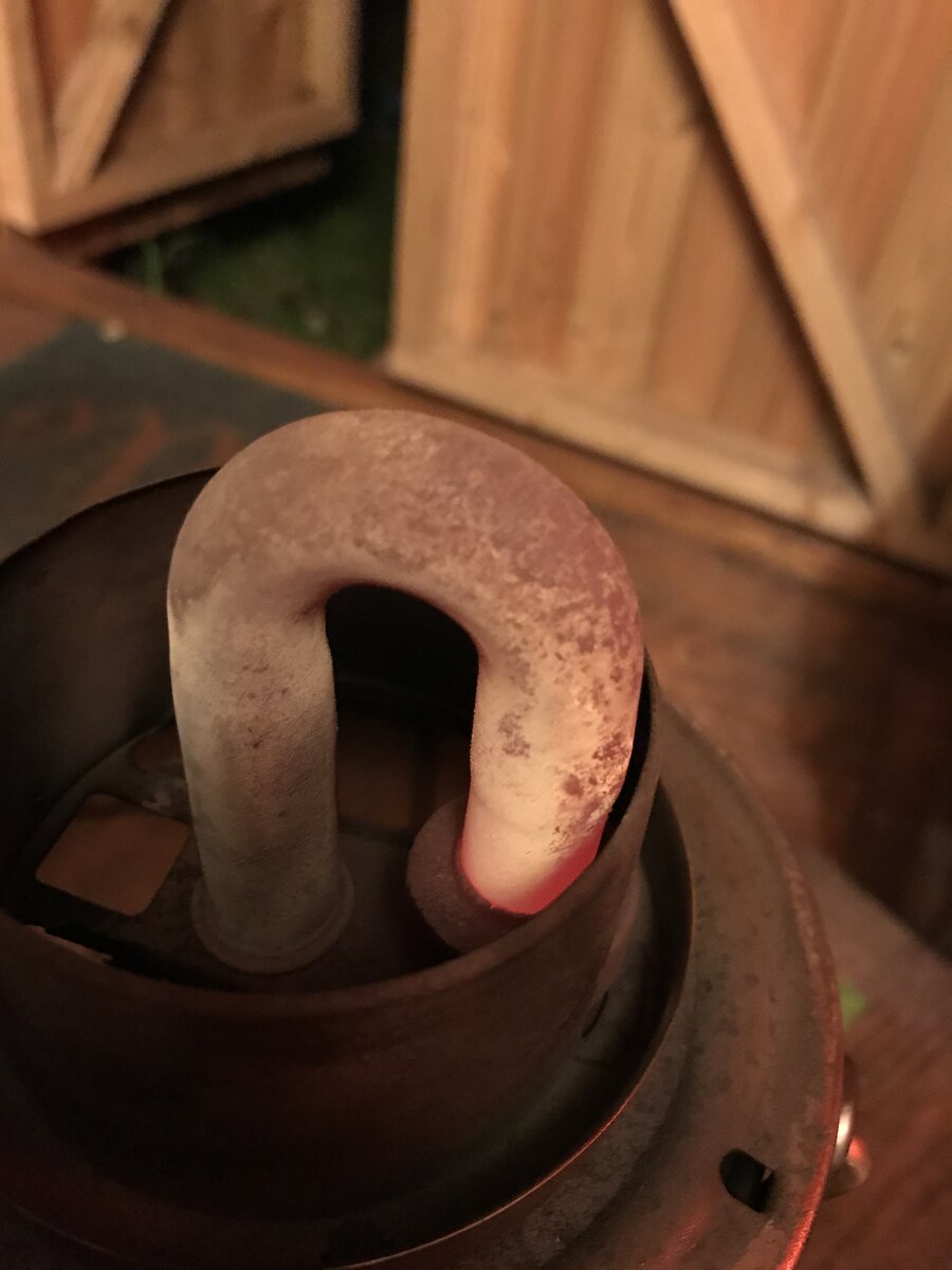

    the other issue was the top inverted brass U mixer incandescing after 5 min of operation, which it shouldn’t I believe. So I believe my collar repair was slightly higher on one side, causing the frame to misalign with the lower top cap (the one holding the mixer tube). That might have caused the wrong stoichiometry in the mixer tube, allowing too much air through and leading to ignition inside the tube itself (hence the red glow). I will file the collar down and test the theory tonight....
    this lamp must have been my most expensive fettle to date, in terms of time, effort and money. It really has been ‘ primus madness’, but I’m truly enjoying the learning process here! 8]

  4. MYN
    @Alex74
    If you look at the cross-sectional drawing of the jet again, there is an internal 4mm cylindrical guide leading to a step just before the tiny conical near the orifice.
    Your jet has a chamfered square body that's supposed to glide nicely through the 4mm cylindrical guide with its chamfered sides bearing on the cylindrical wall, while its 4 flat sides are cleared off the wall, leaving the necessary gaps as the fuel path. If the chamfered sides of the jet is unevenly worn, chances are, the needle wouldn't be centered into the orifice.
  5. MYN
    ***'chamfered square could either be angled cut-offs or rounded at the four edges of the square-sided jet here.

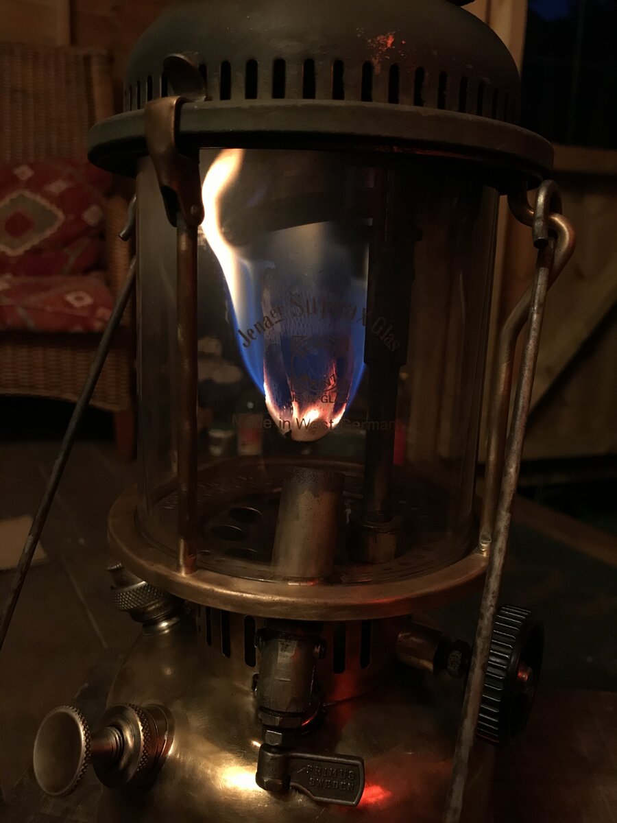

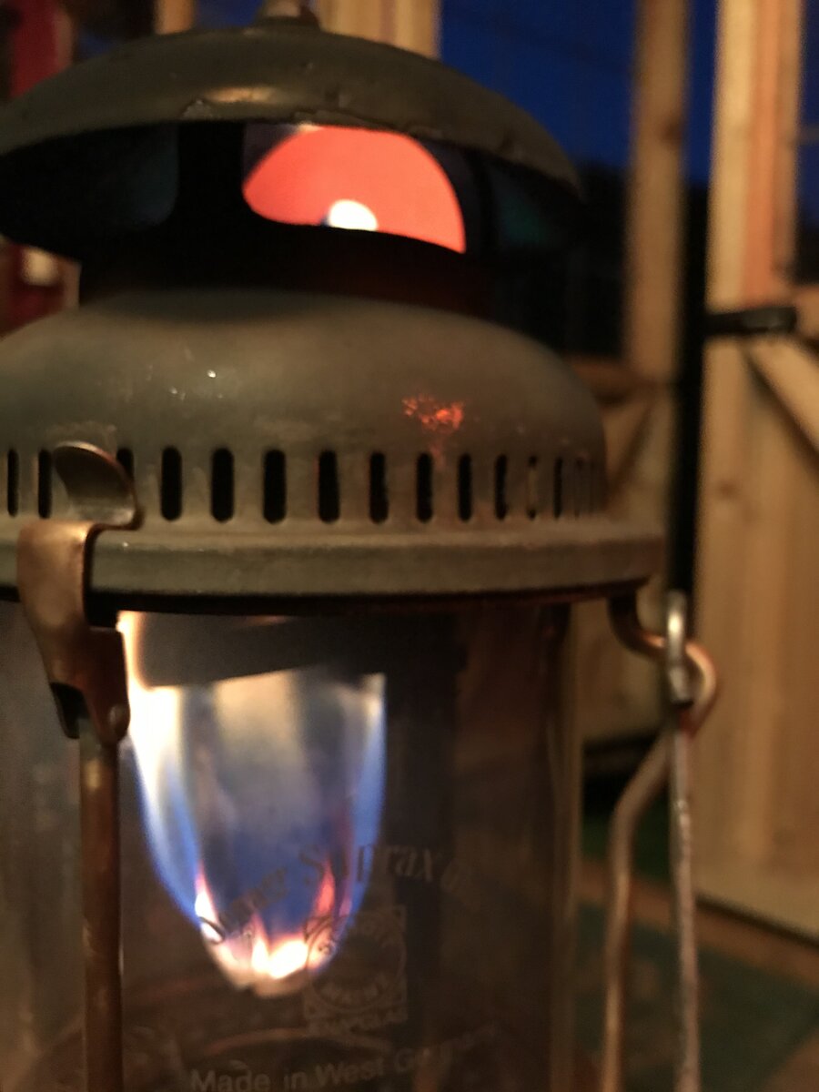

    yes, I can see the chamfered sides on the needle. It seems to behave itself now. Nice blue flame without a mantle and then you get this with a mantle... And the new jet (so, not worn). what’s going on now? Any ideas? Please note the glowing U mixer under the hood...? Mind you, it’s going to be toasty in winter!!

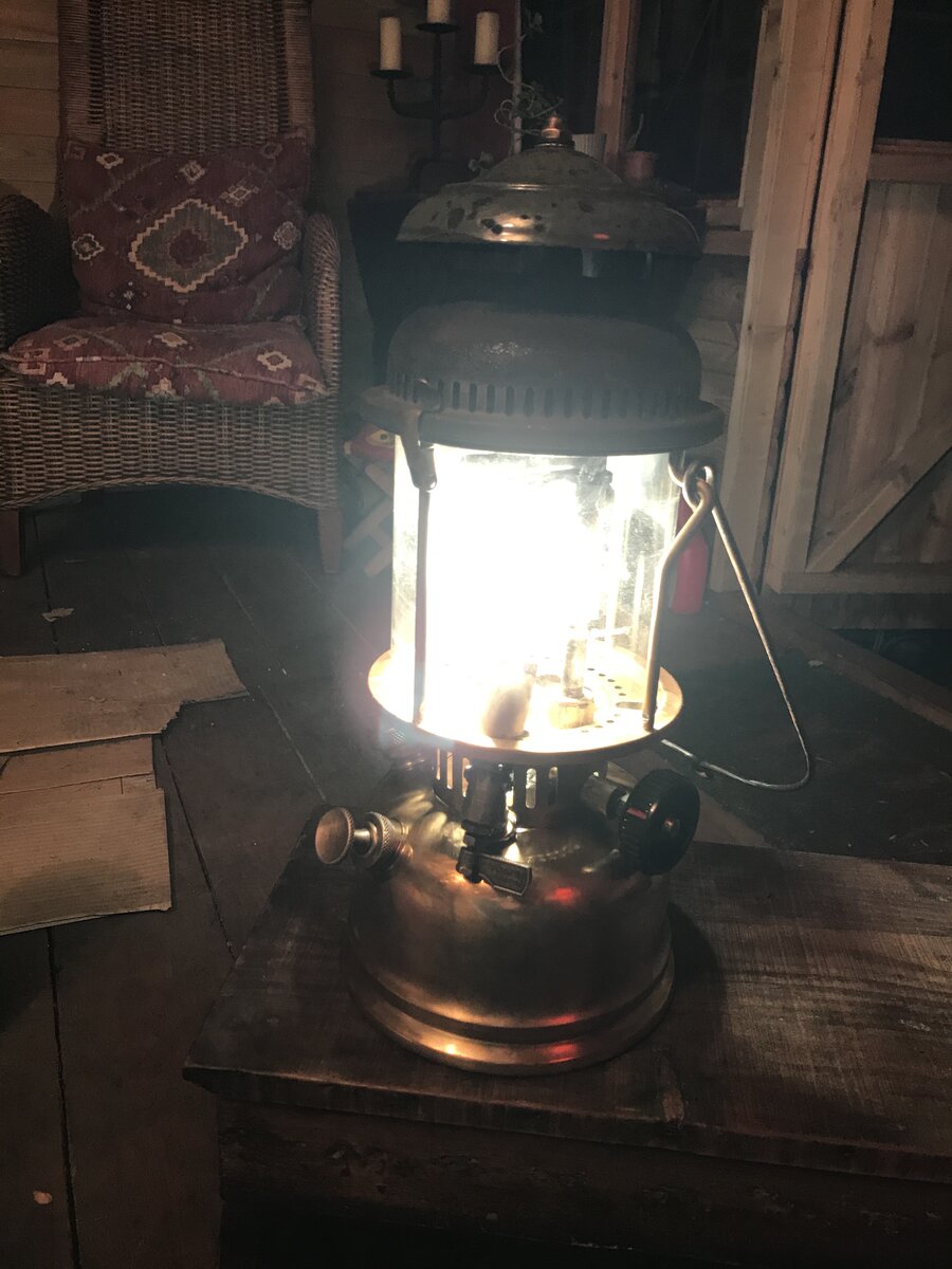

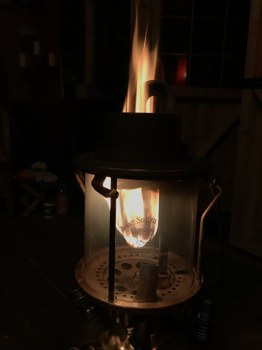

    More photos with pressure up to 1.5 on the gauge and without the hood on top...

  9. Tony Press
    Wo! That red glow of the j-tube does not look good. The fuel/air mix must be igniting before exiting the flame spreader (nozzle).

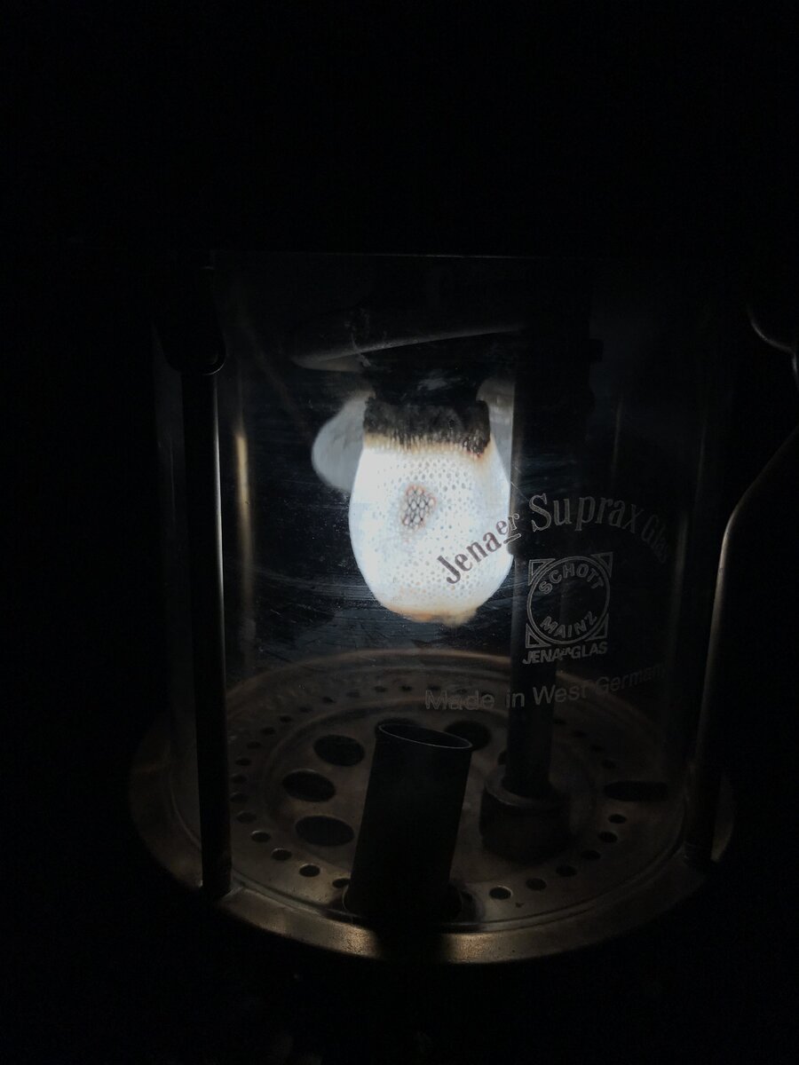

    Sorted.... I tightened the jet slightly with a spanner (it was just hand-tight before and was probably leaking extra fuel from the sides) and all seems to work well now. The lamp has been lit for over an hour with no apparent pressure loss and no more glowing parts! So silent and brighter than a Tilley. Insane.
