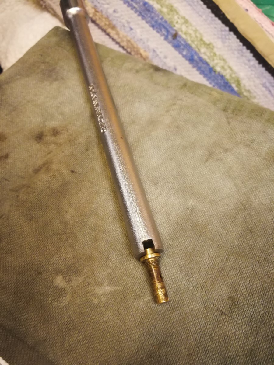

    Thanks Phil, i'm hoping the tool will do the job once it arrives, fingers crossed unless it is so seized that it snaps it or something worse!

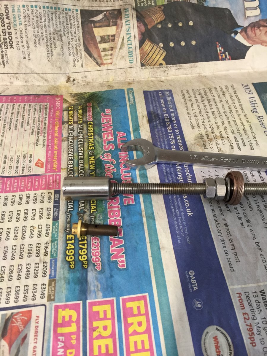

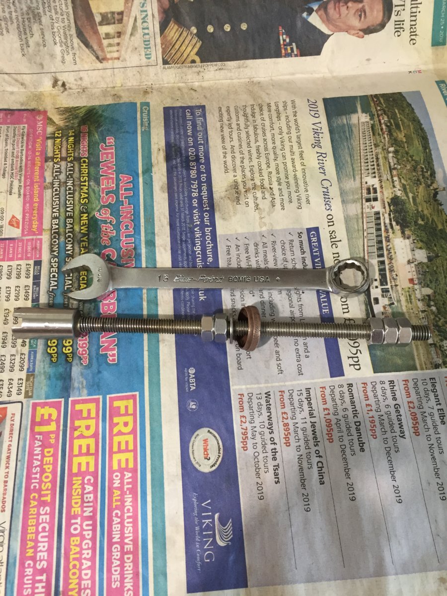

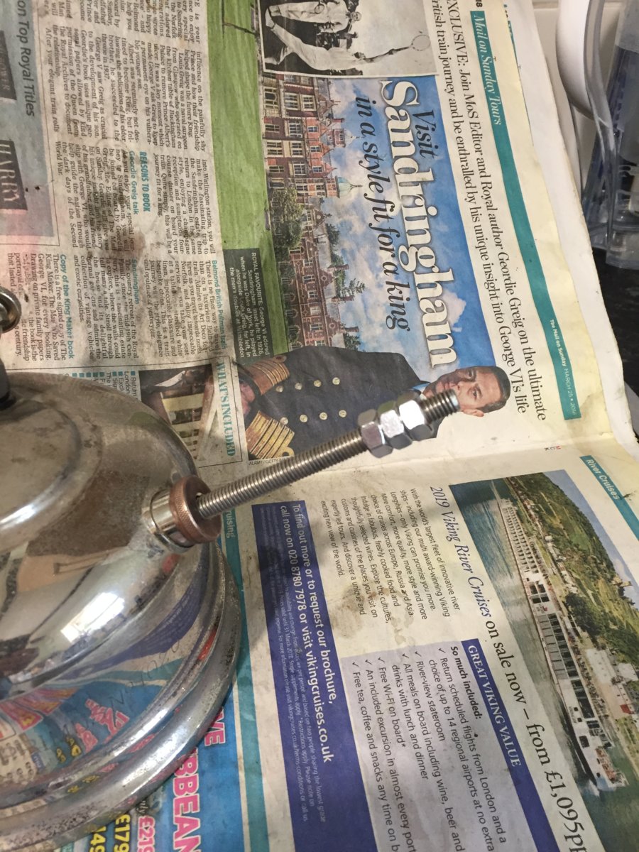

    Oh yeah!! :D/8] :D

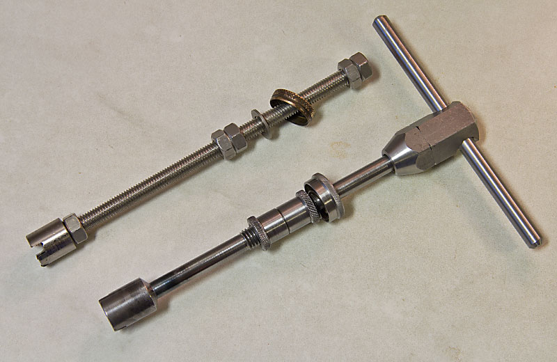

    I notice that you didn't use a locking nut to secure the tool head as I did with my simple prototype (below).
    Did you weld or braze it to the bolt, or perhaps just used some good thread lock? That may be sufficient.

    Thanks, it certainly did the job, i could off possibly lowered the nuts along the rod so that it produced less twist but it worked so i am happy,
    it did damage the tool head slightly but it will live on to undo another day! :lol:
    My friend made it for me and silver soldered the joint which seems plenty strong enough,
