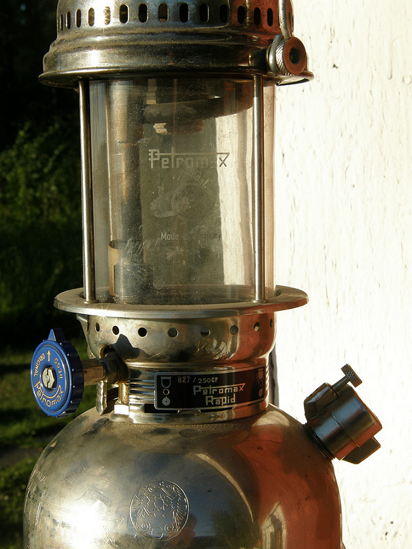

    Is there any way to get information about this 827's manufacturing date? I have heard that Petromax production in Germany ended in 1975 and quality dropped?
  2. Mackburner
    Mostly we need pictures to be able to date a Petromax. Some do have a date code marked in teh base but a great number do not and images of parts id the only way. ::Neil::
  3. Pertsa
    May 22, 2013
    61
    Ok, i decided to take that Petromax because it is complete and probably easier to get spareparts than Optimus. I post pictures later, i think this Petromax is quite new, maybe from 1970's.

    There is a three digit serial number in my petromax
    379
    Is this non Germany made latern?
  9. John
    John United States Subscriber
    Jan 8, 2011
    770
    Dallas, Texas; United States
    From the looks of your lantern I would think it's a little young to be German built, but possibly built in Portugal. It's early enough that the quality should match the Hipolito you just finished; I've got the same model lantern and you've got no quality issues to worry about.
    There is usually residue left in them after they are emptied and stored. That will wash out pretty easy and you'll be good to go.
    As far as the glass, it looks original to the lantern and the Petromax name on a globe is hard to find, at least it is in the US; so if you will run it a lot you might want to run a "user" globe. Just to insure the history of the old piece of glass.

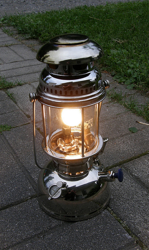

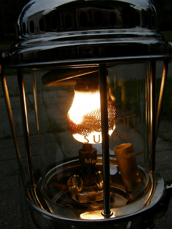

    That was problem:
    Now it works how it should... light is unbelieveble :shock:

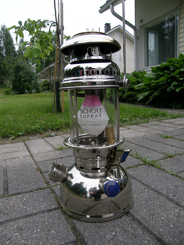

  19. Pertsa
    May 22, 2013
    61
    First time in real use:
