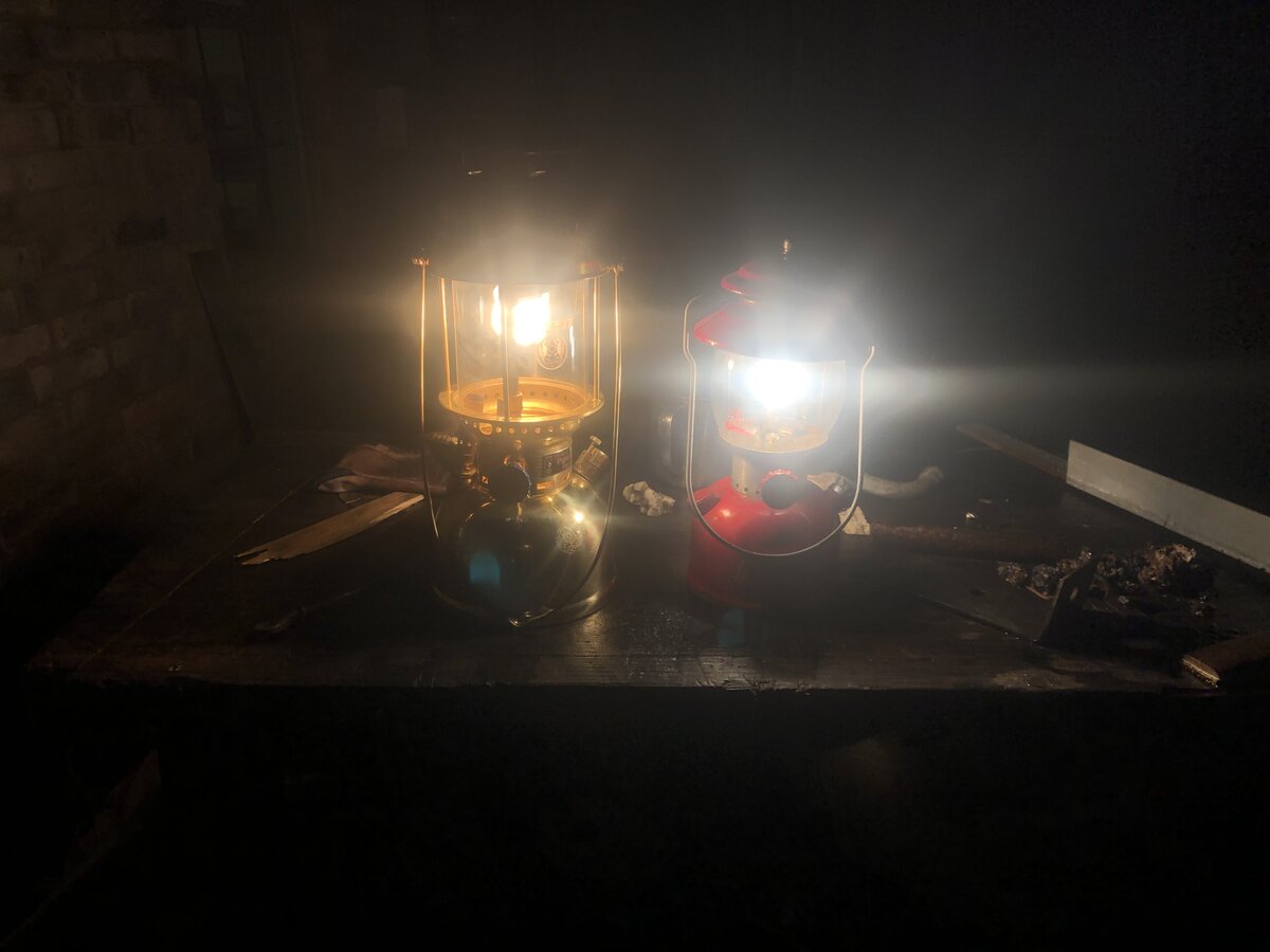

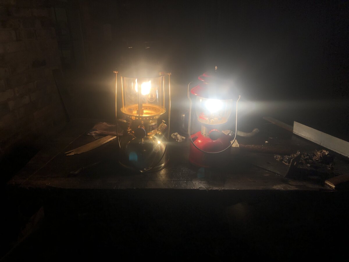

  2. Joshua Williams
    Feb 18, 2022
    35
    Texas
    Here is it next to a 200a now. The picture makes the little one seem brighter but I assure you it is not, it is just because the mantle is white and the camera seems to not like that too much.
  3. MYN
    Congratulations.
    The burner ceramic cap and holder can glow red during operation. So long as you're not getting the red glow on the J-tube mixer, everything's fine.
    Thoria-based(radioactive) mantles are usually, but not necessarily always, appear whiter than yttria-based ones.
