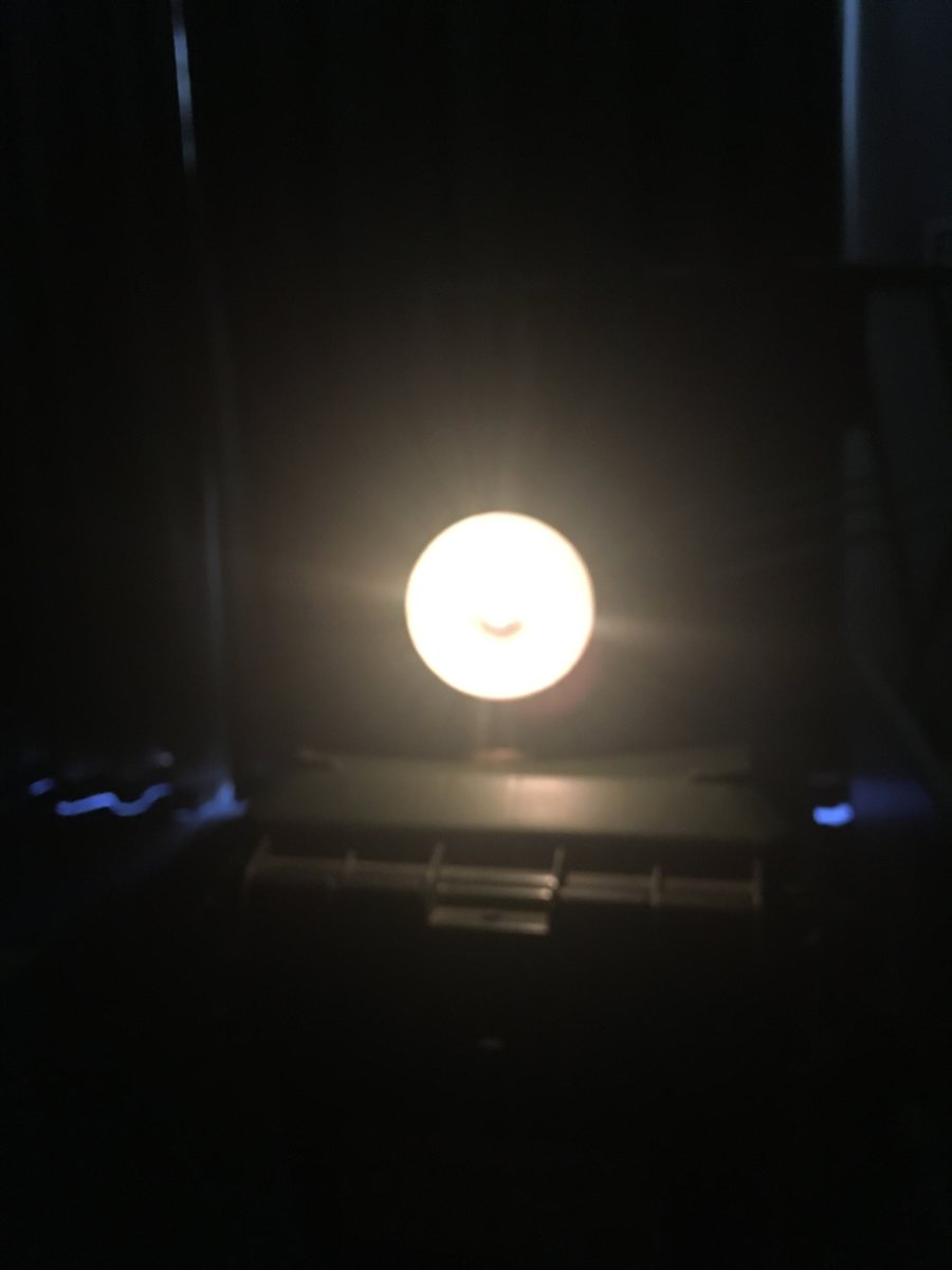

  14. phaedrus42
    phaedrus42 Subscriber
    2,056
    Full marks for perseverence, George! It paid off in the end.:clap::clap::D/
    Any chance of a "money shot" ?

  16. george
    Phil
    I have a picture but as usual, I don't know my ass from my elbow when it comes to posting pictures.:-k

  22. Henry Plews
    3,068
    Well done George, your lantern is burning brightly.
    Henry.
  23. george
    Thanks, Henry
    I made sure it was not leaking. I lit it last night and let it burn for about and hour and a half and it burned steady all the time. These are a great lantern and this is one of my favorites. Now that I have some vague idea how to post pictures, I'll try to post other pictures of some the lanterns I have.:D/

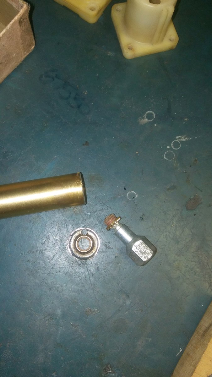

  27. george
    Just thought I would share (for one last time) what the damage looked like on the 1020 when I slipped with the drill
  28. StephanE
    StephanE Subscriber
    Jul 17, 2011
    646
    How did you fill the hole? Simply solder?
  29. george
    Yes, my son soldered the hole shut and then he placed the pump barrel back in the tank. Not a lot of heat down at that end so no danger of un-soldering the plug.
