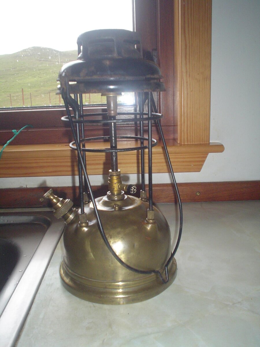

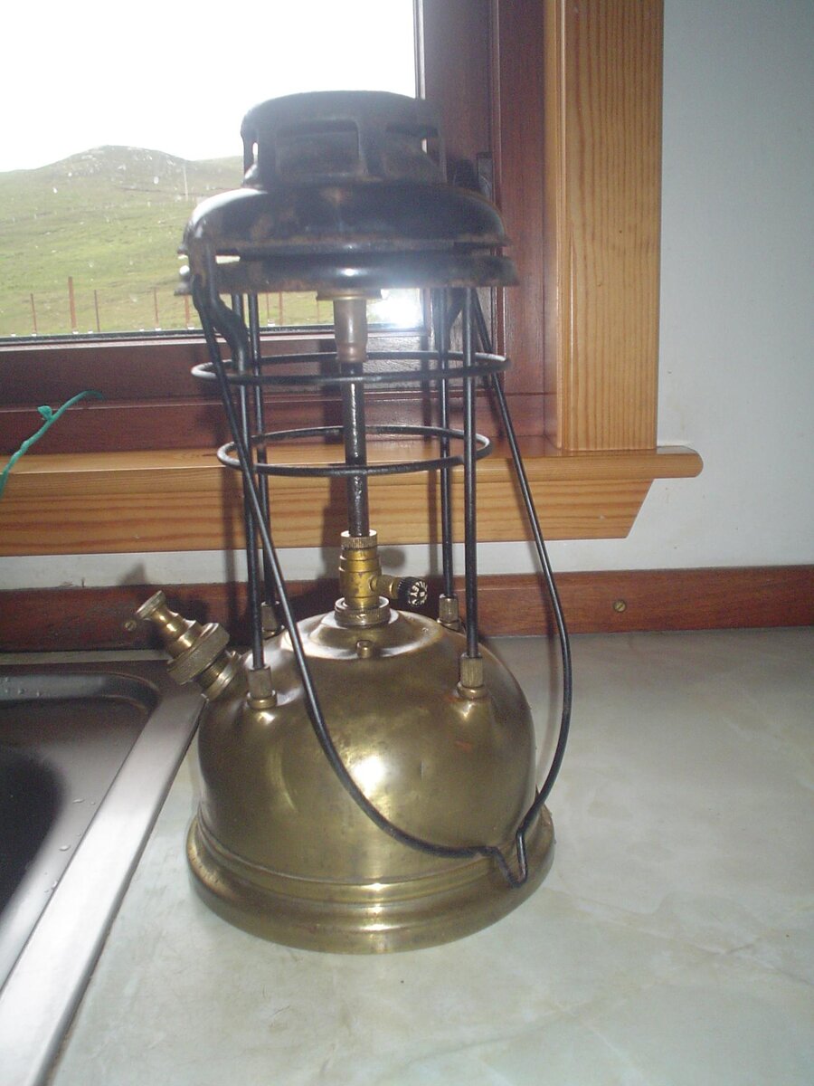

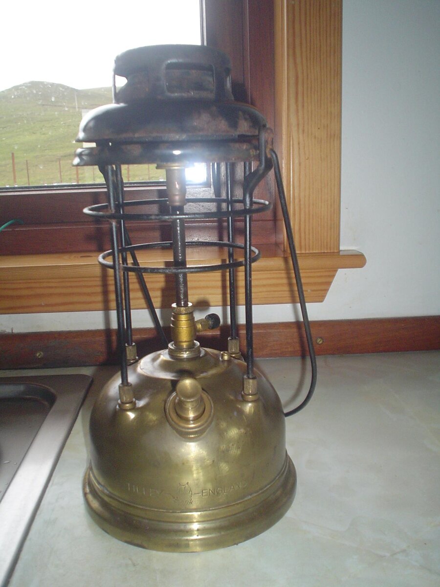

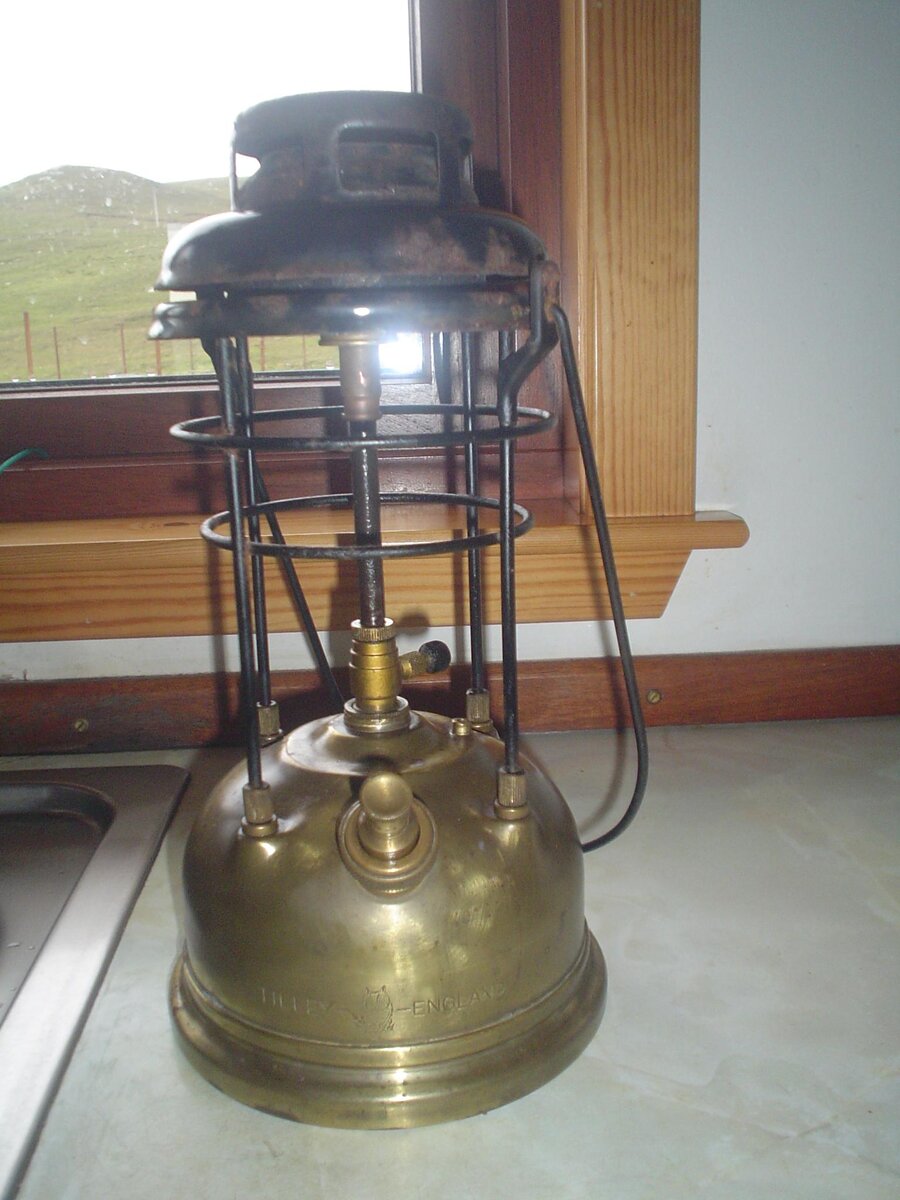

    It's still very quiet on the lamp front here, so I put together this Tilley Guardsman lantern, it's built from parts which I had, hence the black hood which is a bit rough but it's still solid.
  18. Buggerlugs
    Nice one mate. How does she run? Looks fine to me with the black hood.
    We don't see many brown hoods down here, so it looks normal to me, and if it was brown and rough like that I would be happy, as they are like finding hens teeth which are rare.
  19. JEFF JOHNSON
    16,826
    I have not fired it up yet because it's light here most of the time, it's the opposite during the winter though, but the tank holds pressure and I have tested the vapouriser.
    That hood is from a very rough X-246-B lantern, I also used the burner from it and after a strip down and a good soak in vinegar and a thorough cleaning, I then installed some proper brass air pipes, the old style which have threaded ends and nuts, the burner had modern steel pipes fitted, all going well, I shall fire the lantern up later in the year.

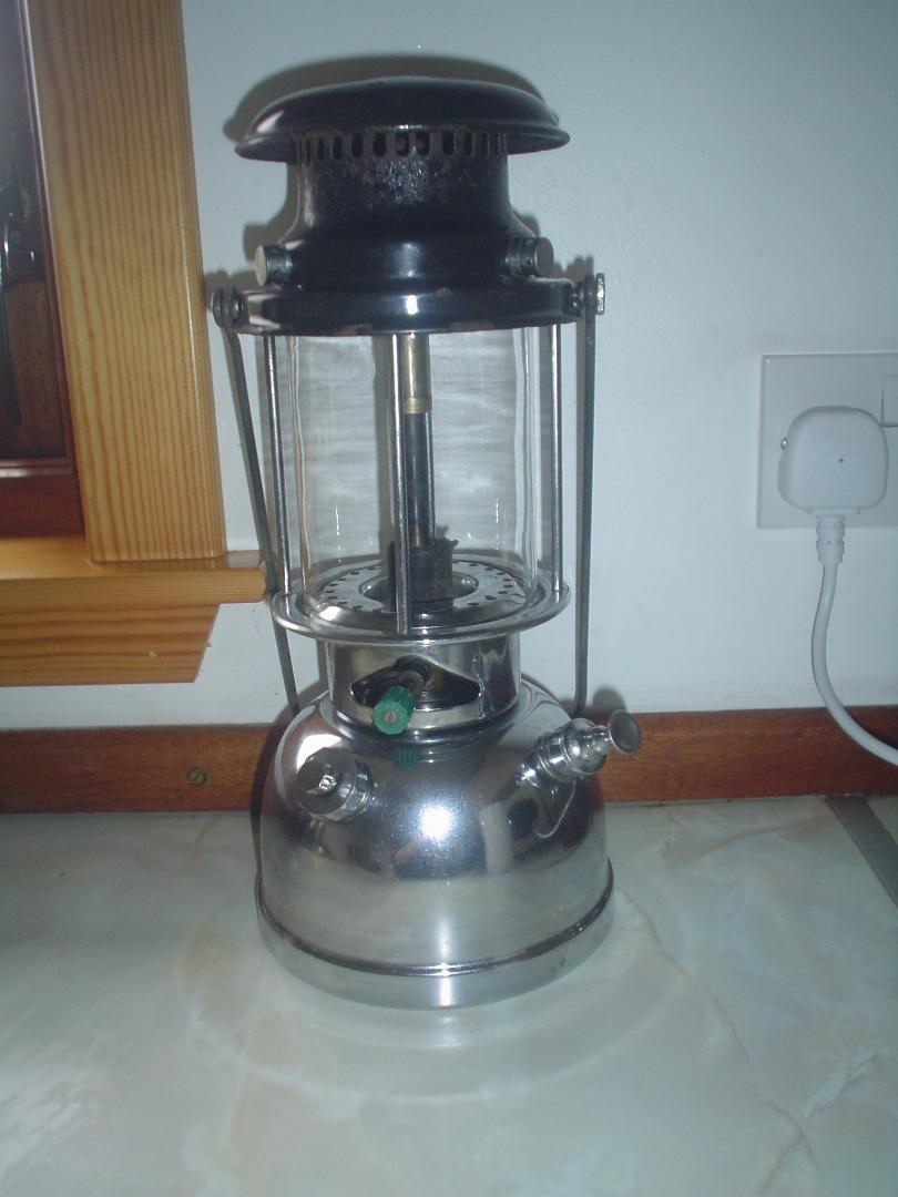

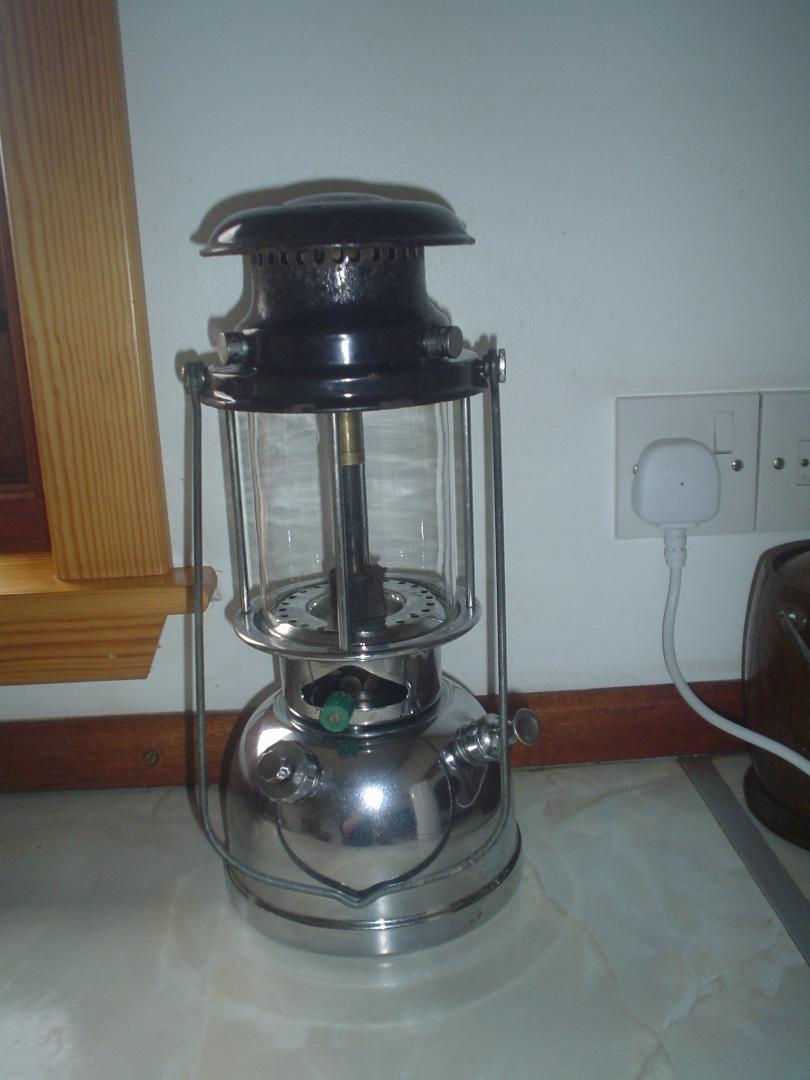

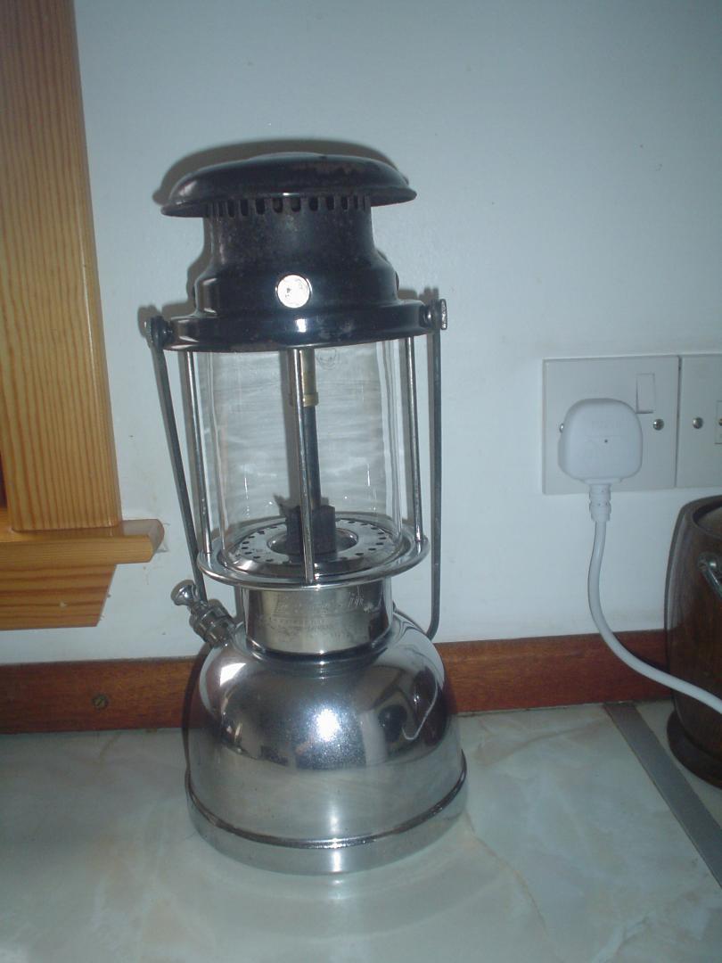

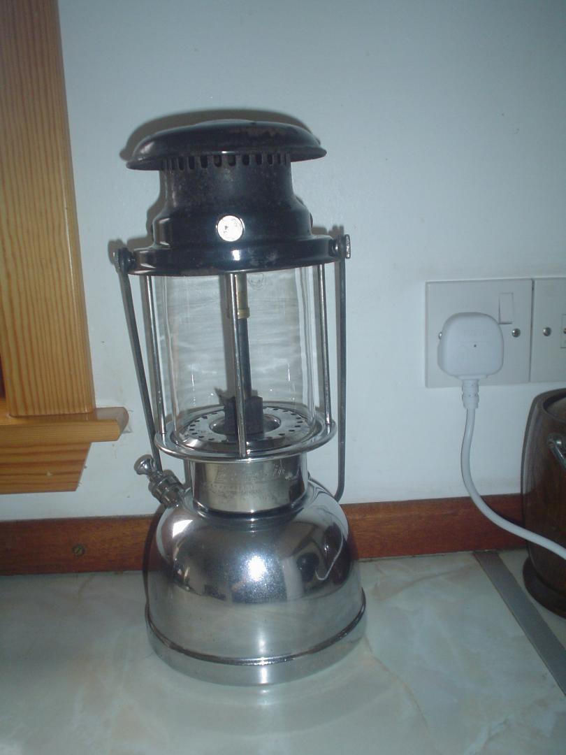

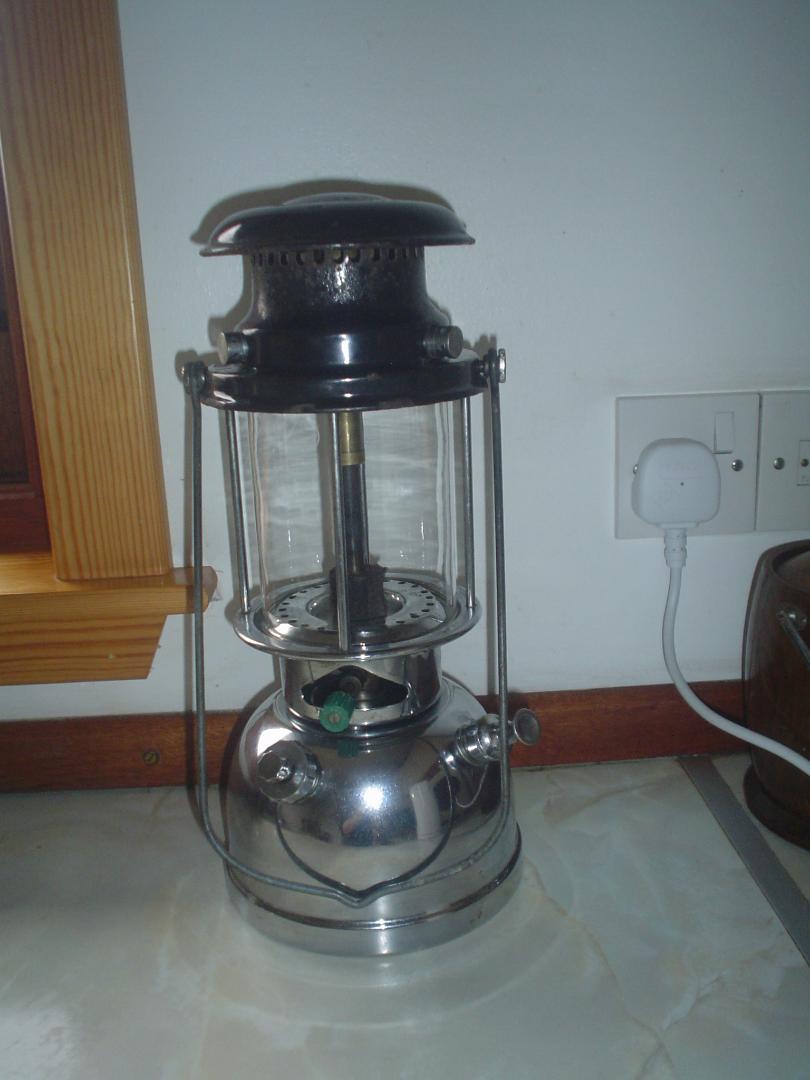

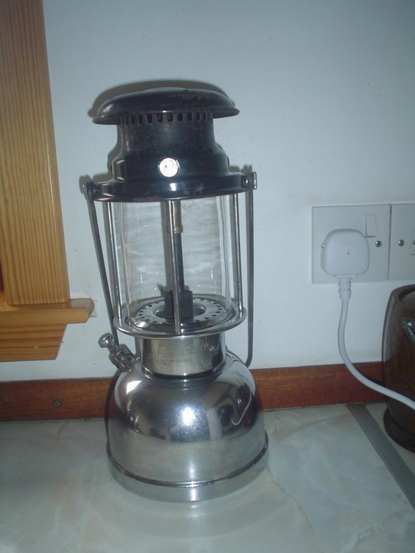

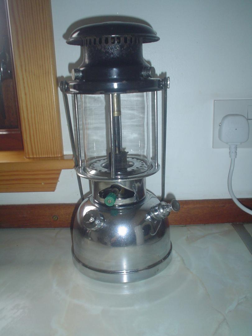

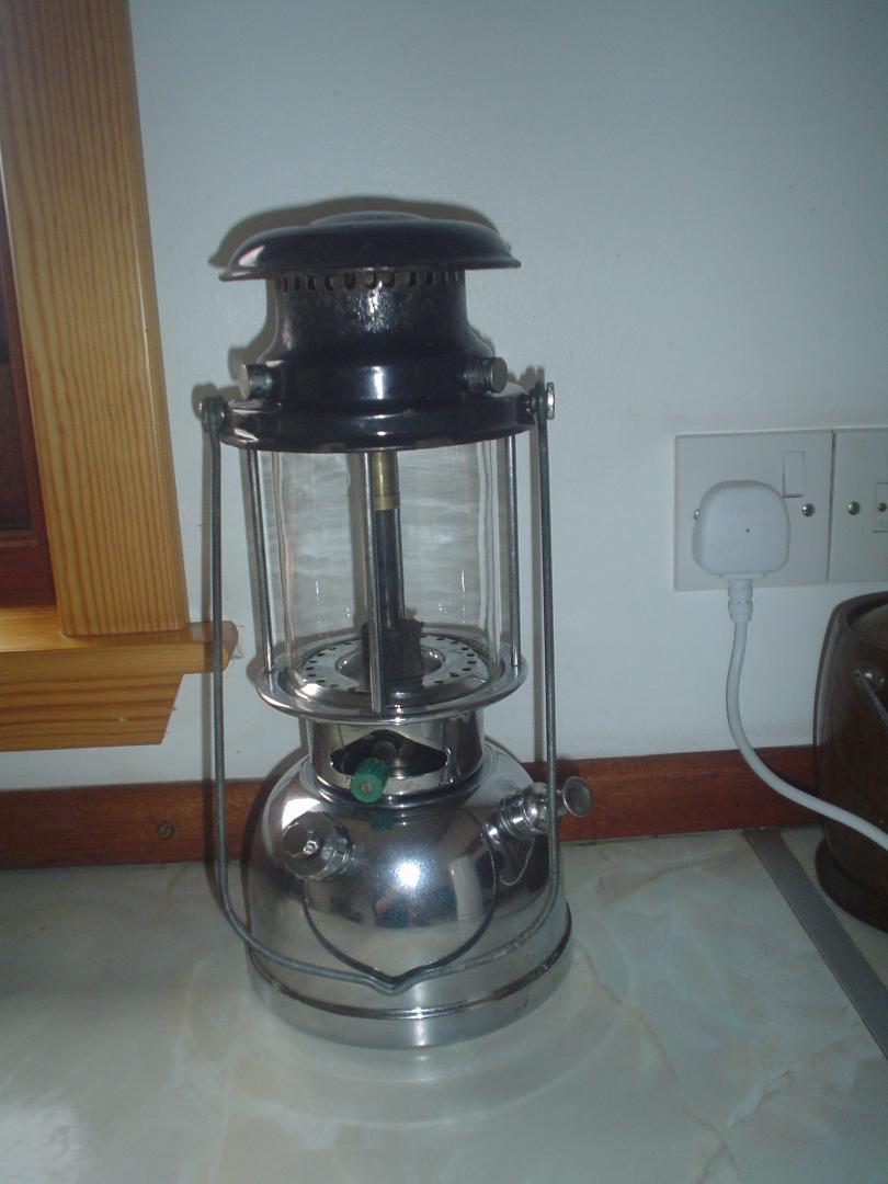

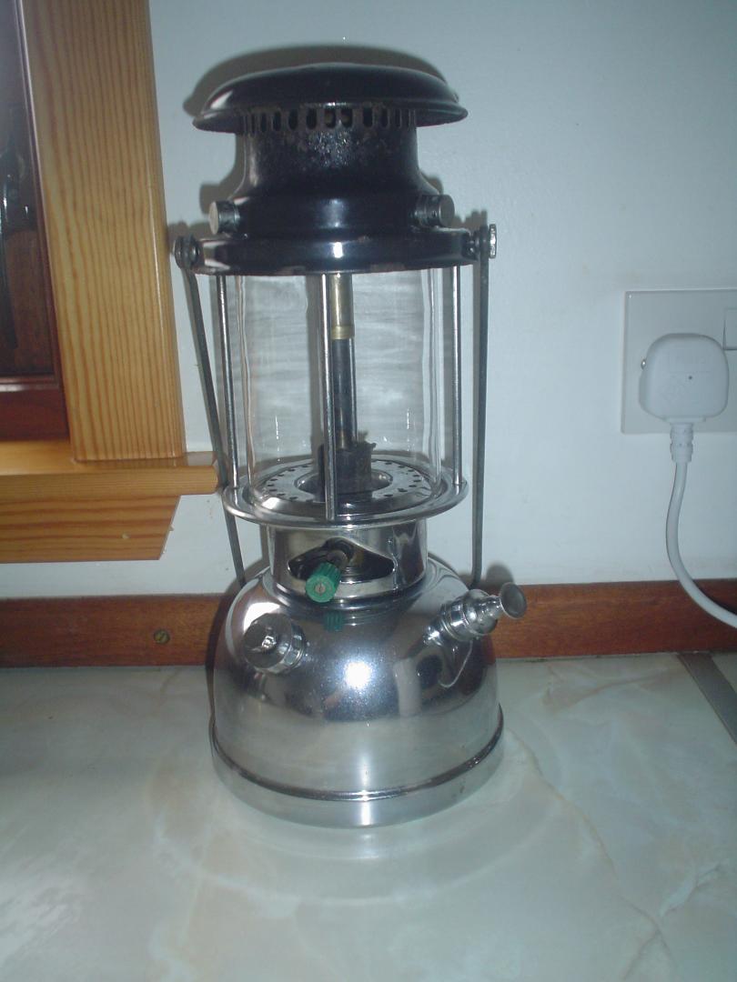

    Hello fellow lampers, I finally have another pressure lantern, it's a 1950's chromed Bialaddin 305, the before and after images are shown below.
    I had the hood and burner and glass in storage.

    I found the lantern on Ebay UK., and the buy it now price and the postage were reasonable.
    I spent about 3 hours yesterday afternoon restoring the lantern, first of all I dismantled it and then drained the dregs of the very old and stinking paraffin, then the dunk test and then the first clean up with white spirit and a soft cloth.
    Then the second clean with washing up liquid and water and a rough sponge, I repeated that process as often as required and I gave the tank a good rinse or three, but it was surprisingly clean.
    I had a control cock which was already fettled so I fitted it and that was also the case with the vapouriser, the chromed burner air buttons had been in storage for many years, perhaps over twenty years, it's difficult to recall precisely, but they have now been used.
    I'm pleased with the result of my efforts, however, I did not use the chrome polish which I have in the shed, perhaps that will improve the shine.

    The filler cap and the air release screw were filthy with dried paraffin (which sticks like varnish) and muck, so those parts needed a good soak in vinegar and after that they cleaned up well enough.

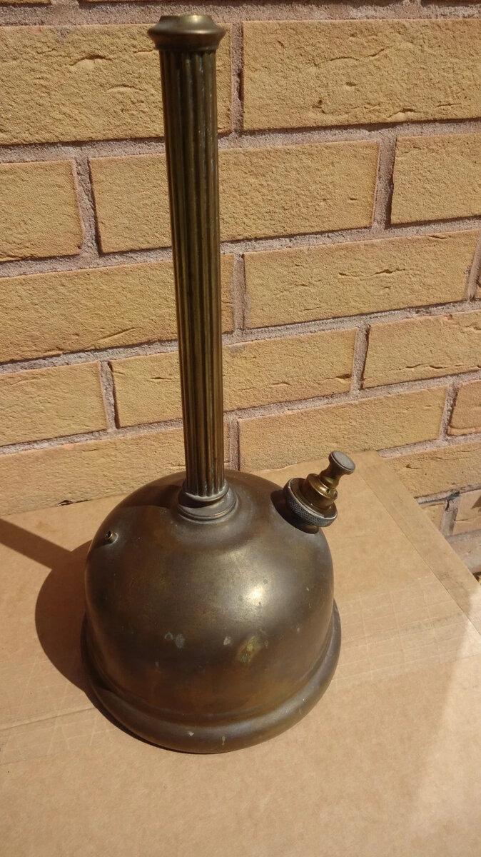

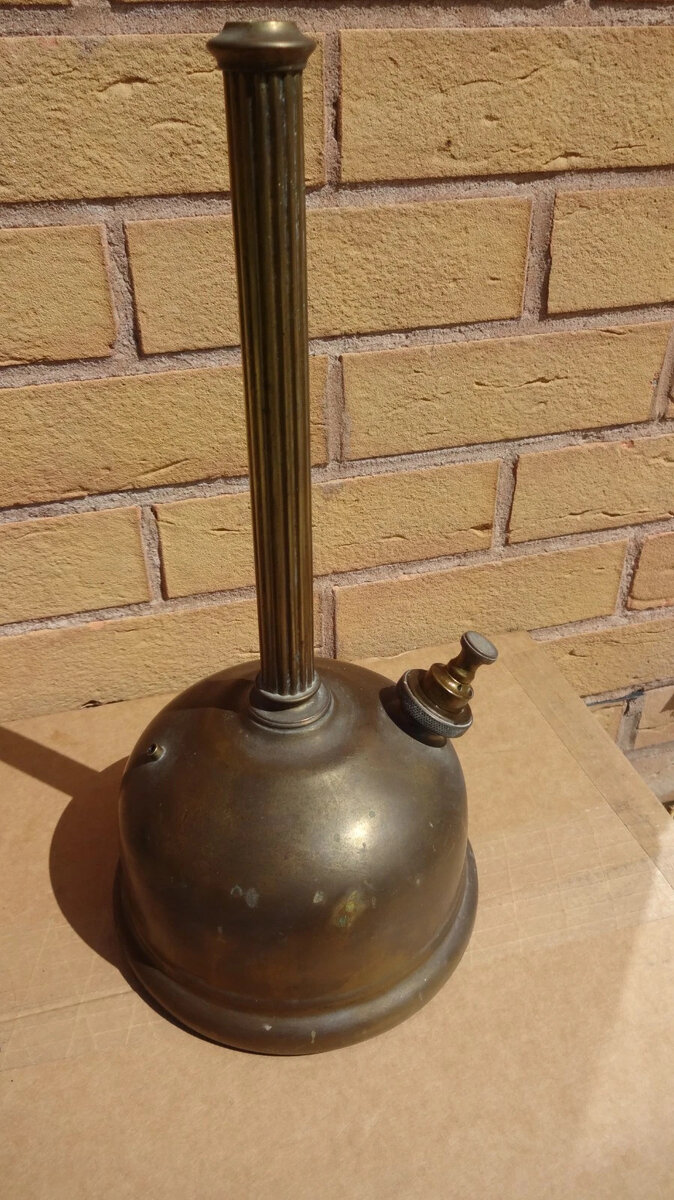

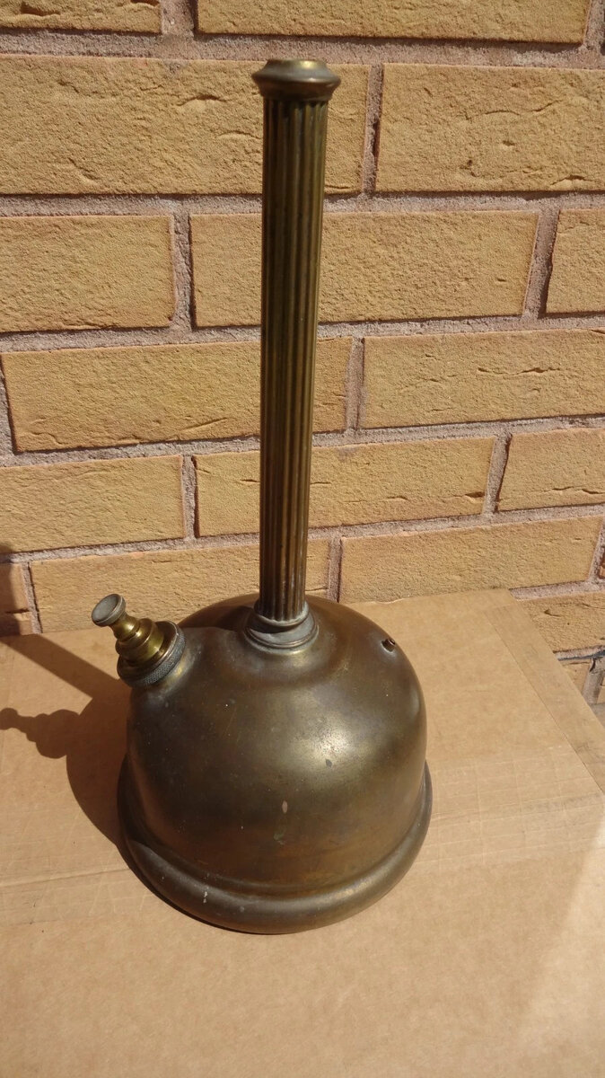

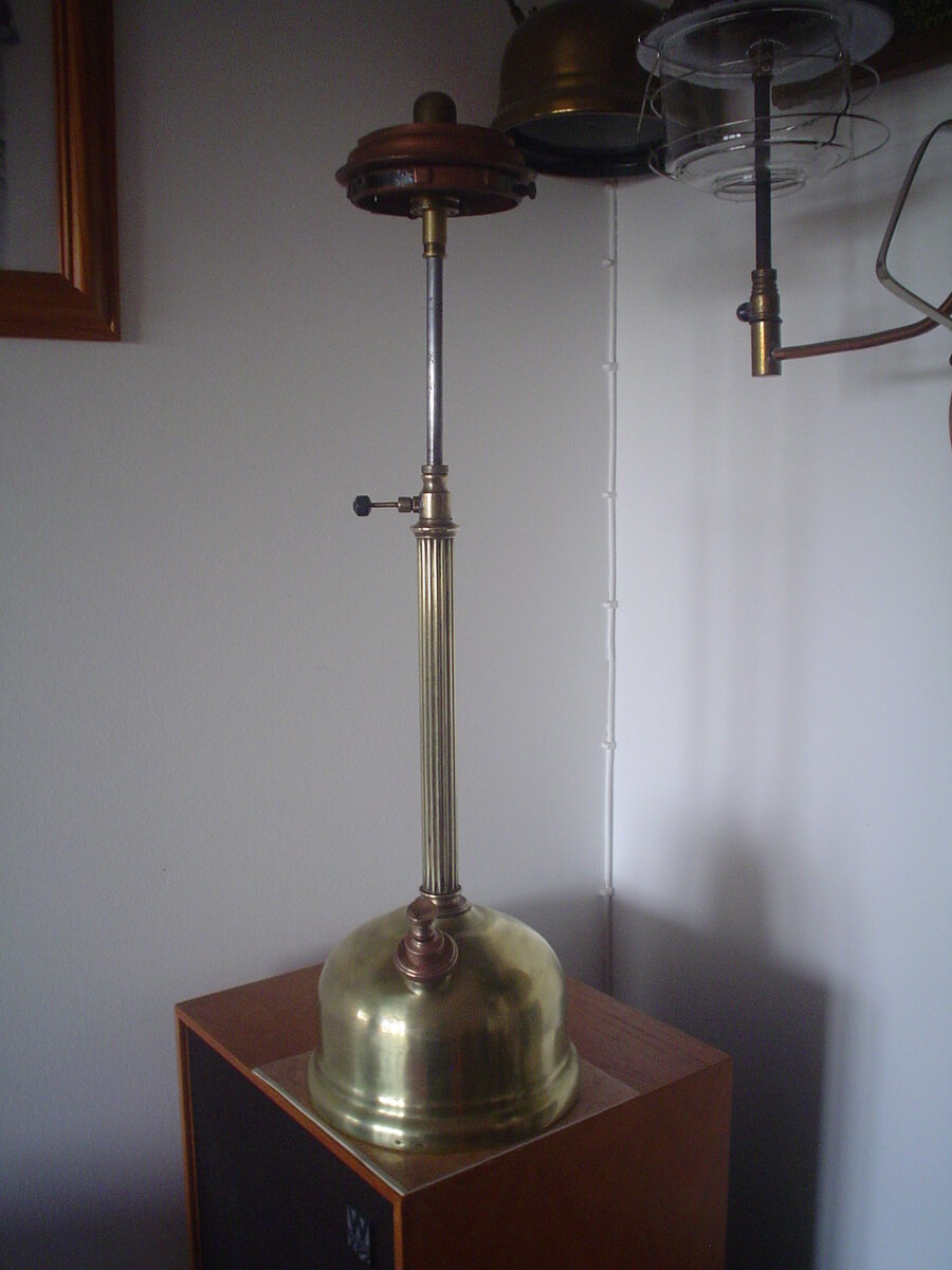

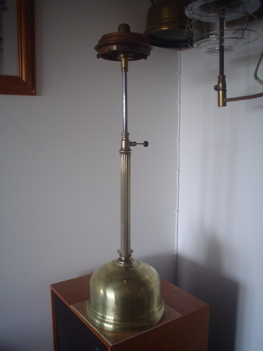

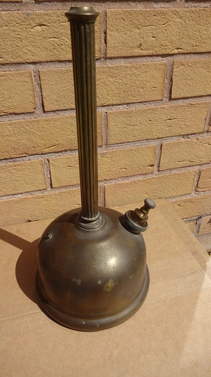

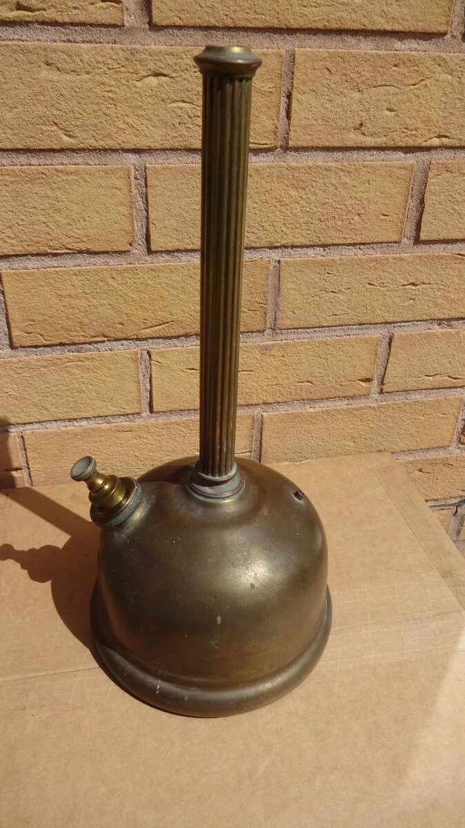

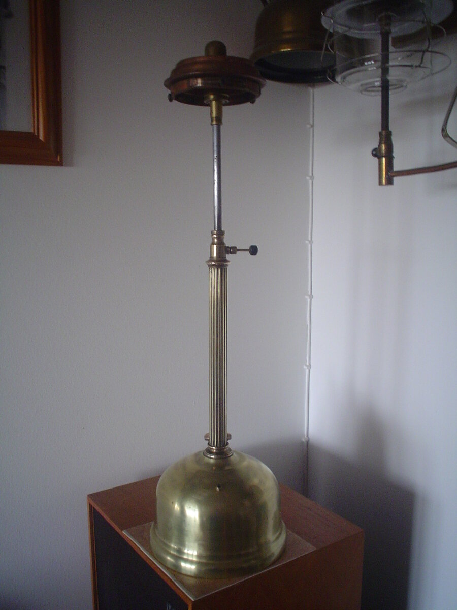

    Here is my most recent restoration, the two before images are from the Ebay listing.
    Tilley made the TL-10 for about 20 years, but in my opinion, this example dates from around 1930.
    The gallery is a later one and I had to fit a modern burner because that is all that I had.
    The lamp cleaned up well and I'm pleased with the result, in my opinion, the TL-10 is a grand looking lamp.

    Thanks Brian and a white opal shade completes the grand look.
