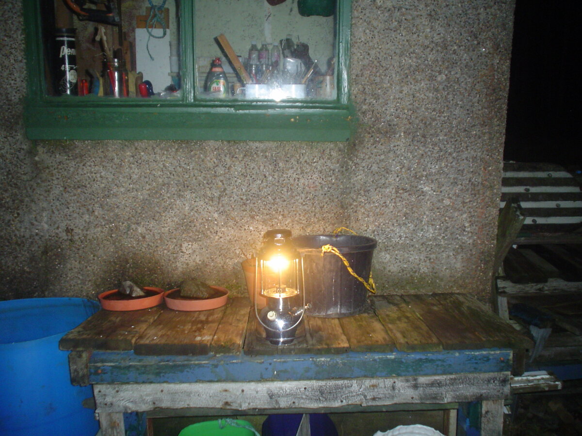

    Once again it's been quiet on the lamp front here.
    So I fettled some common lanterns with parts which I had in storage, they are a bit rough but they should do the job.
    The Tilley Guardsman lantern does work and the Willis & Bates lanterns are ready for testing.

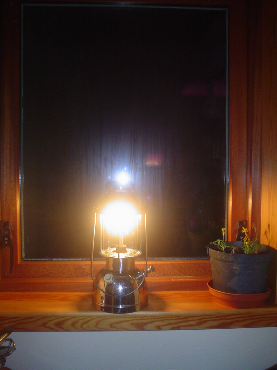

  7. JEFF JOHNSON
    16,893

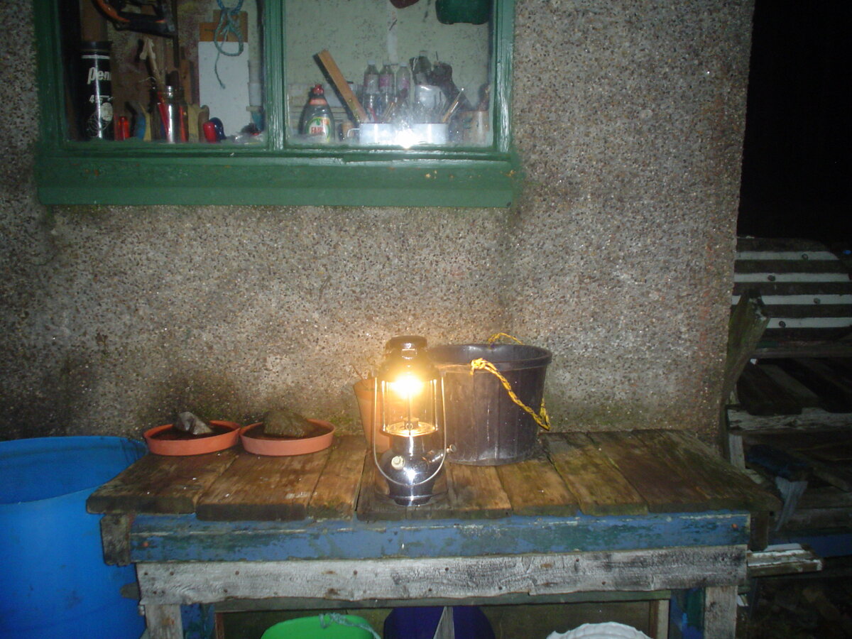

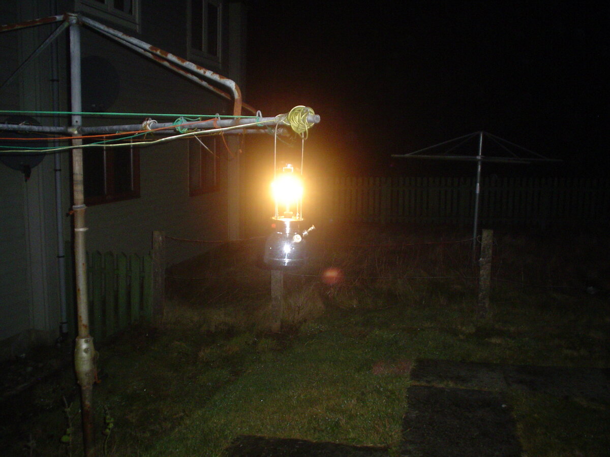

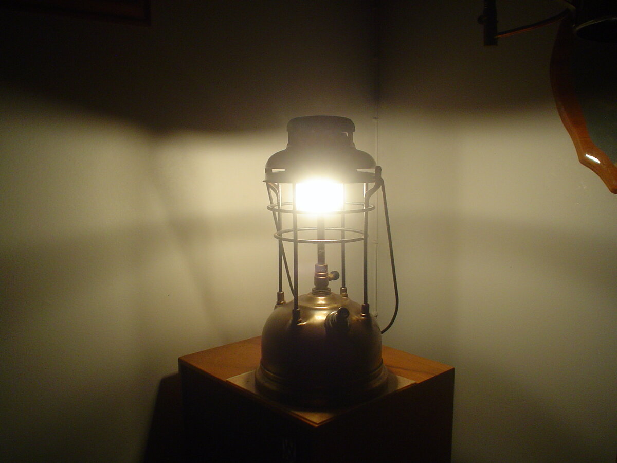

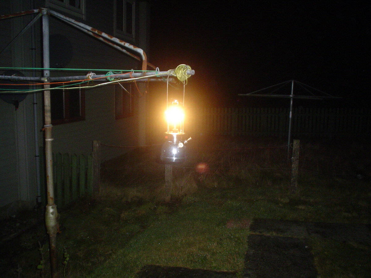

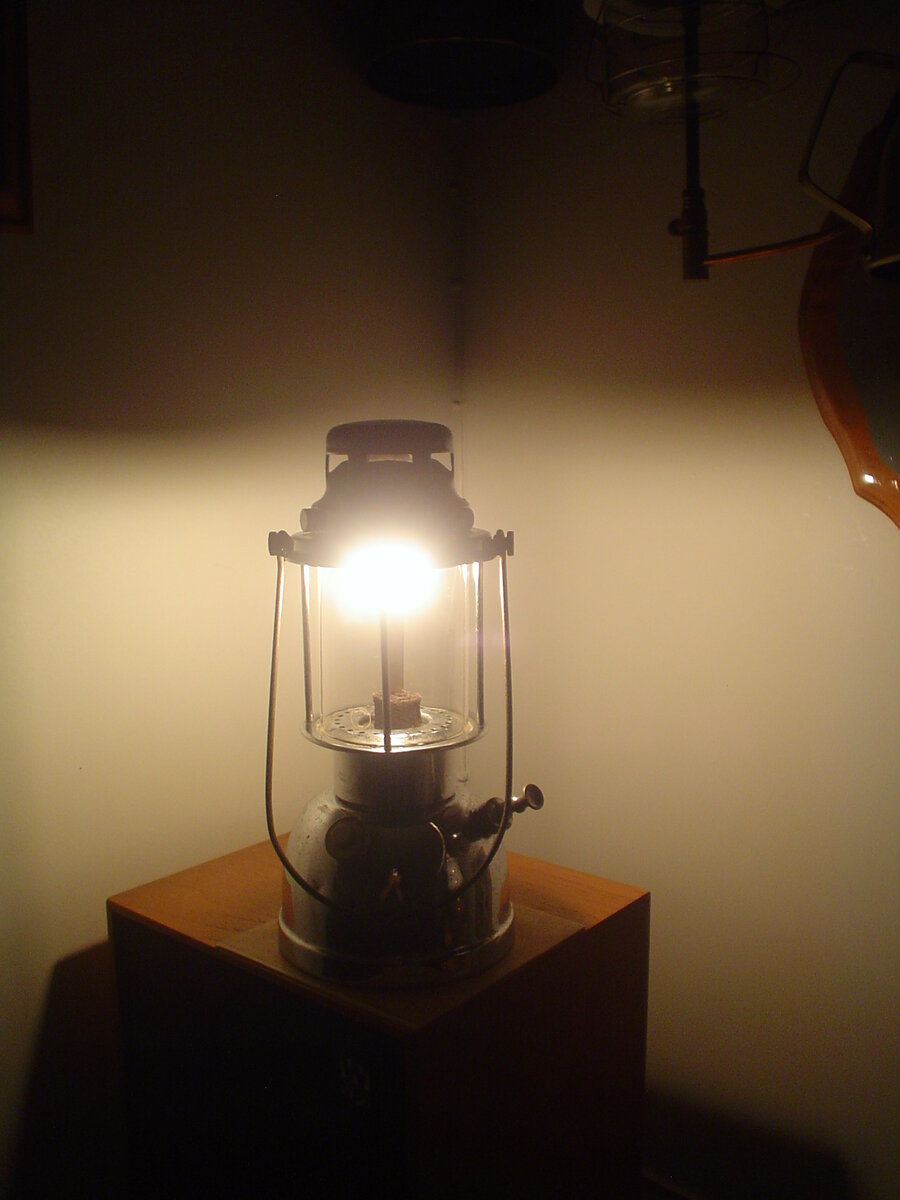

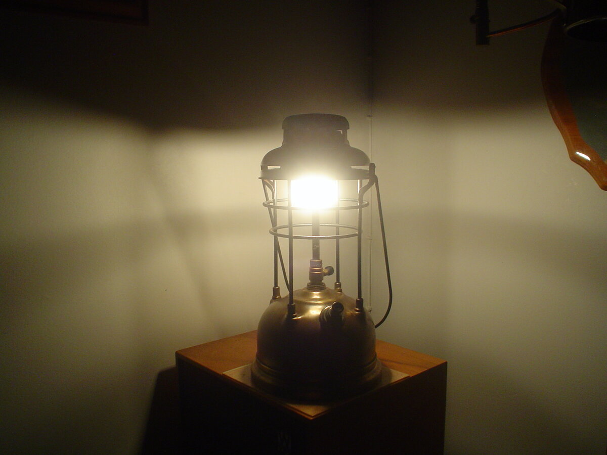

    Here is the first of the Rough Brigade lit.
    The first vapouriser which I tried had an enlarged jet, however the second one is currently okay.

  10. JEFF JOHNSON
    16,893
    Hello fellow lampers, thanks for the positive comments.:thumbup::thumbup:
    The mantle which I fitted to that lantern was a genuine Vapalux mantle which I removed from the sealed packet, but the mantle had been poorly made, the weave was loose and the bottom hole was a bit wide and a hole developed in the mantle after the lantern had been lit for an hour or so, some other Vapalux mantles have narrow holes and will not fit onto Vapalux burners, but they are okay for Tilley burners.
    Those Vapalux mantles were fairly modern ones and perhaps I obtained a bad batch, has anyone else had a bad batch?
  11. JEFF JOHNSON
    16,893
    I tried another one of those Vapalux mantles and it looked better made and it fitted and formed properly, but a hole appeared in it as soon as it was burned off.

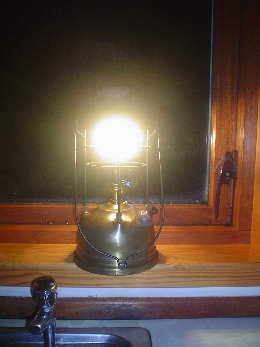

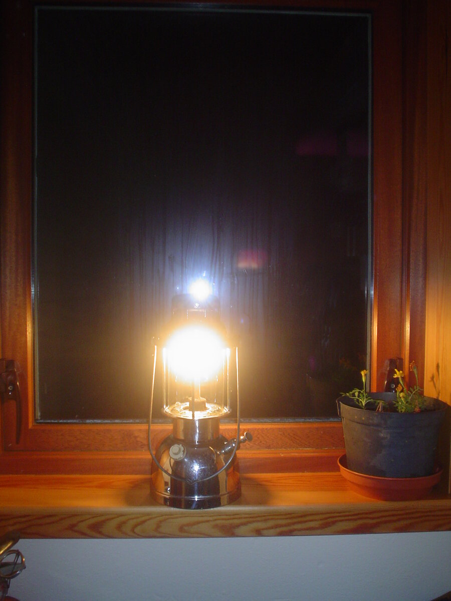

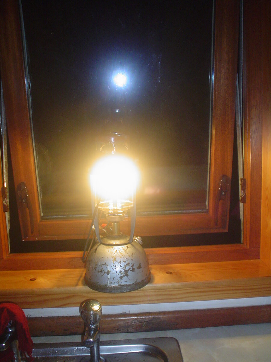

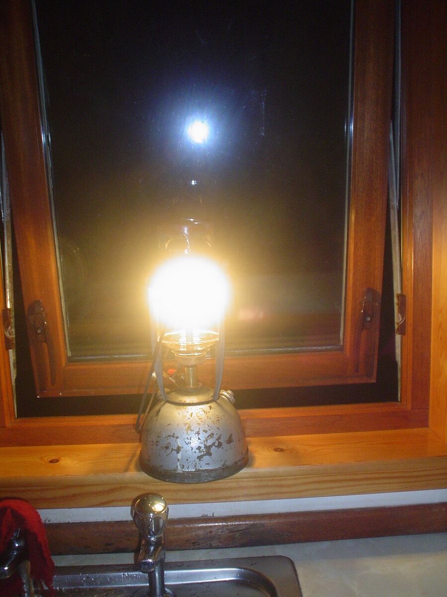

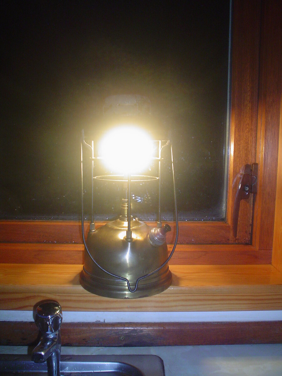

  12. JEFF JOHNSON
    16,893

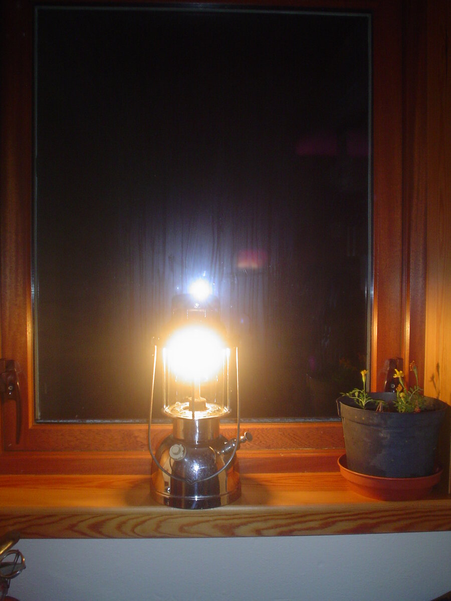

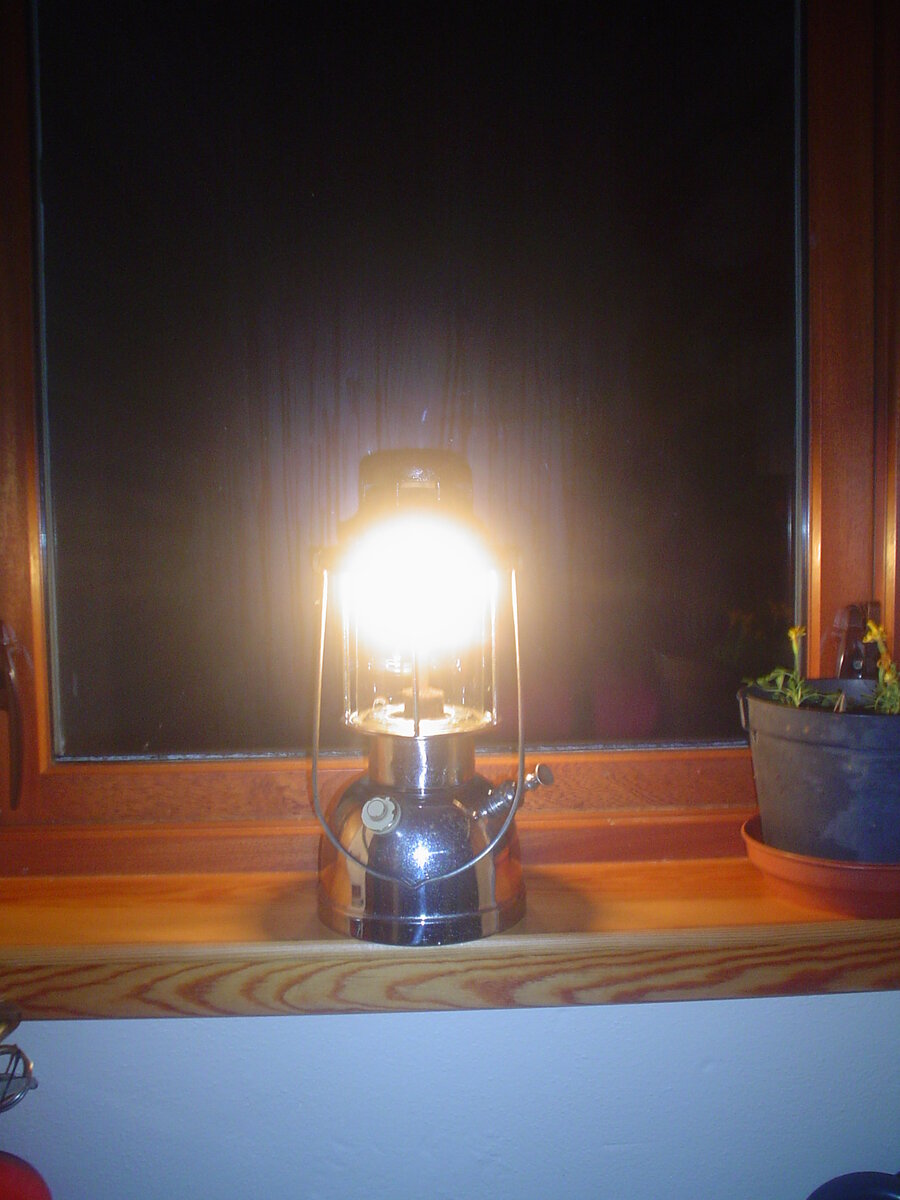

    Here is the second of the Rough Brigade lit
    I used an old Veritas branded Vapalux mantle this time and so far it has not developed any holes.

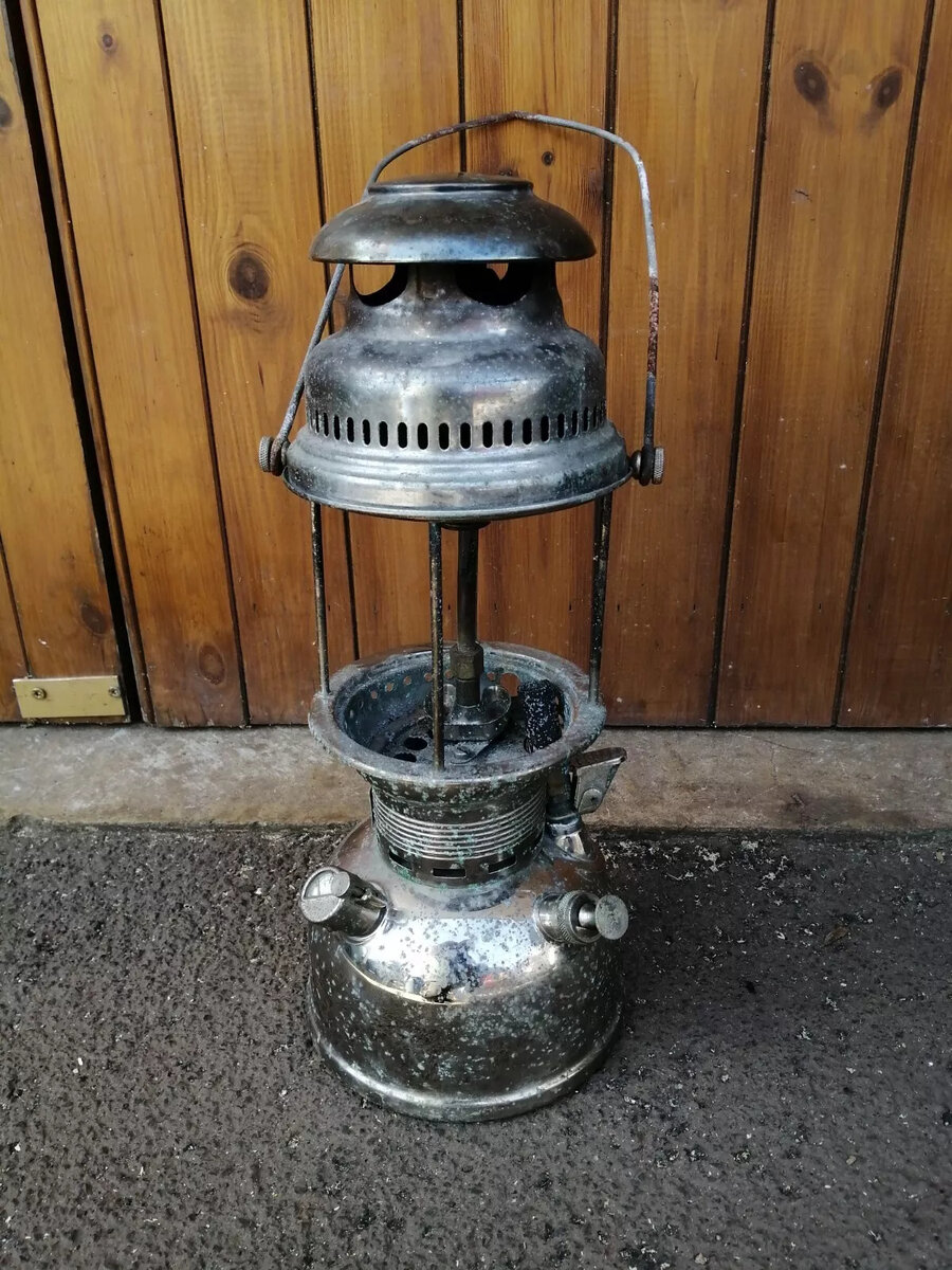

  15. JEFF JOHNSON
    16,893
    I recently obtained a Hipolito lantern, but it has been sitting in a shed for many years and is therefor in need of a good overhaul and a glass and a pricker.
    The photo which is shown below is from the Ebay listing.

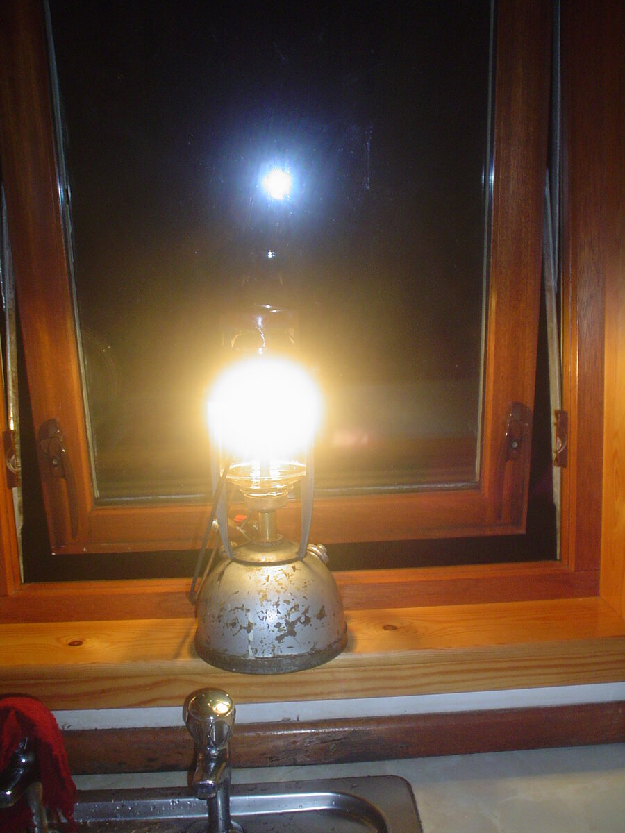

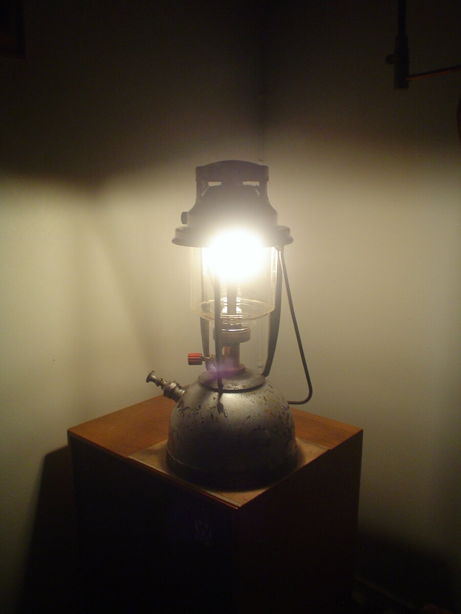

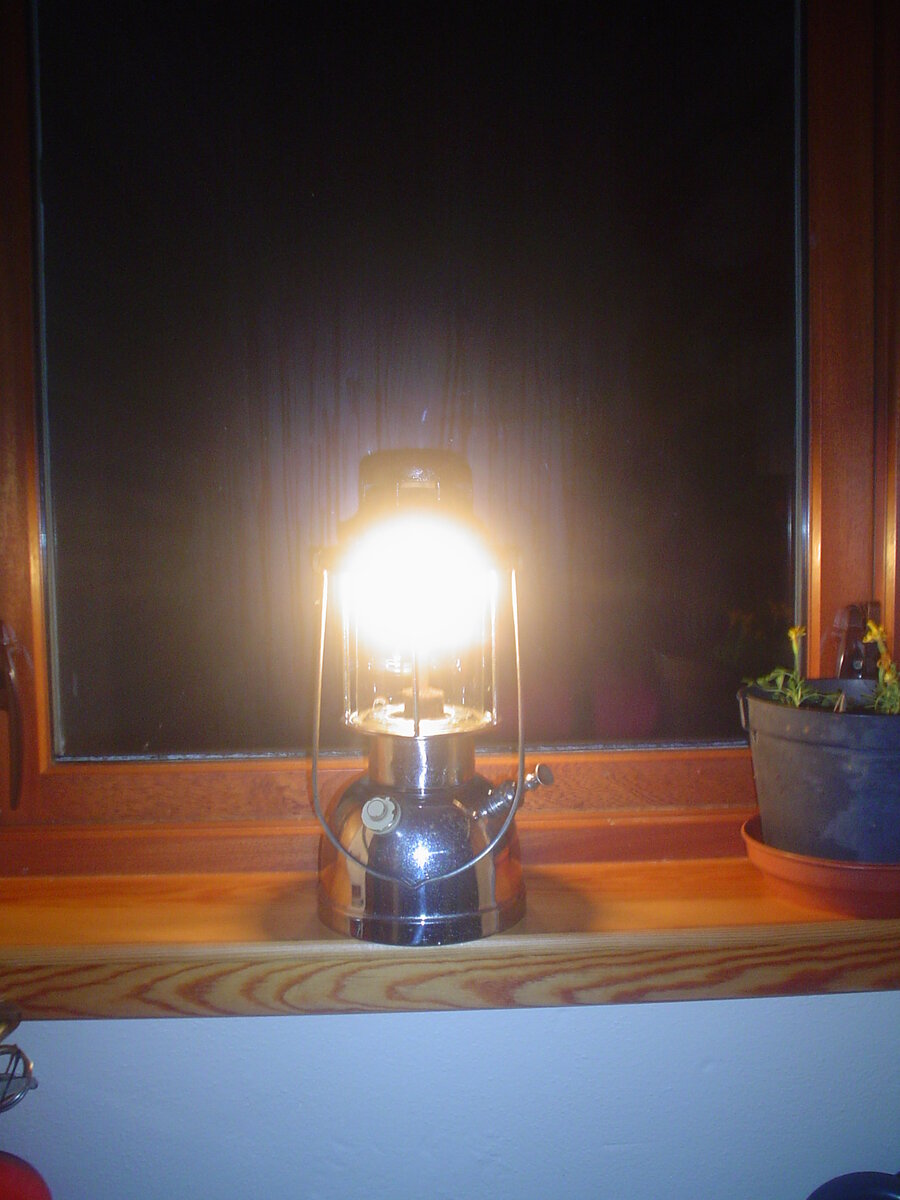

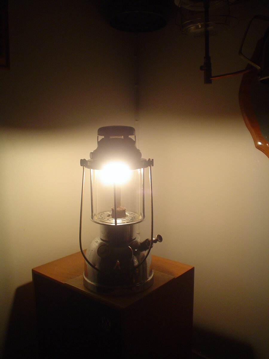

  18. JEFF JOHNSON
    16,893

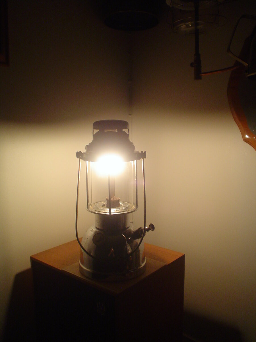

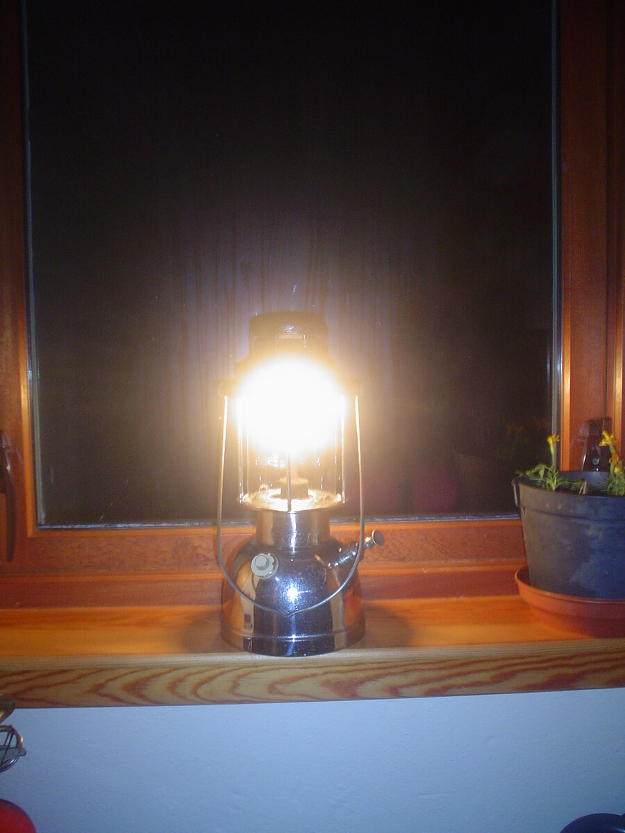

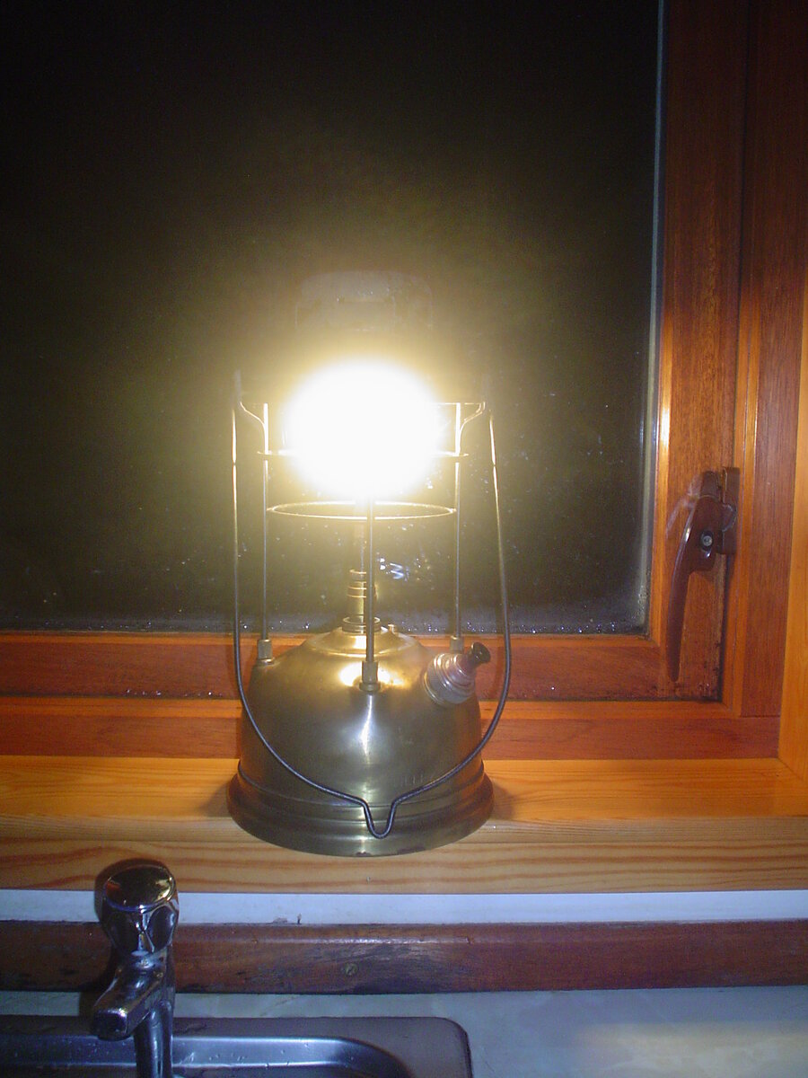

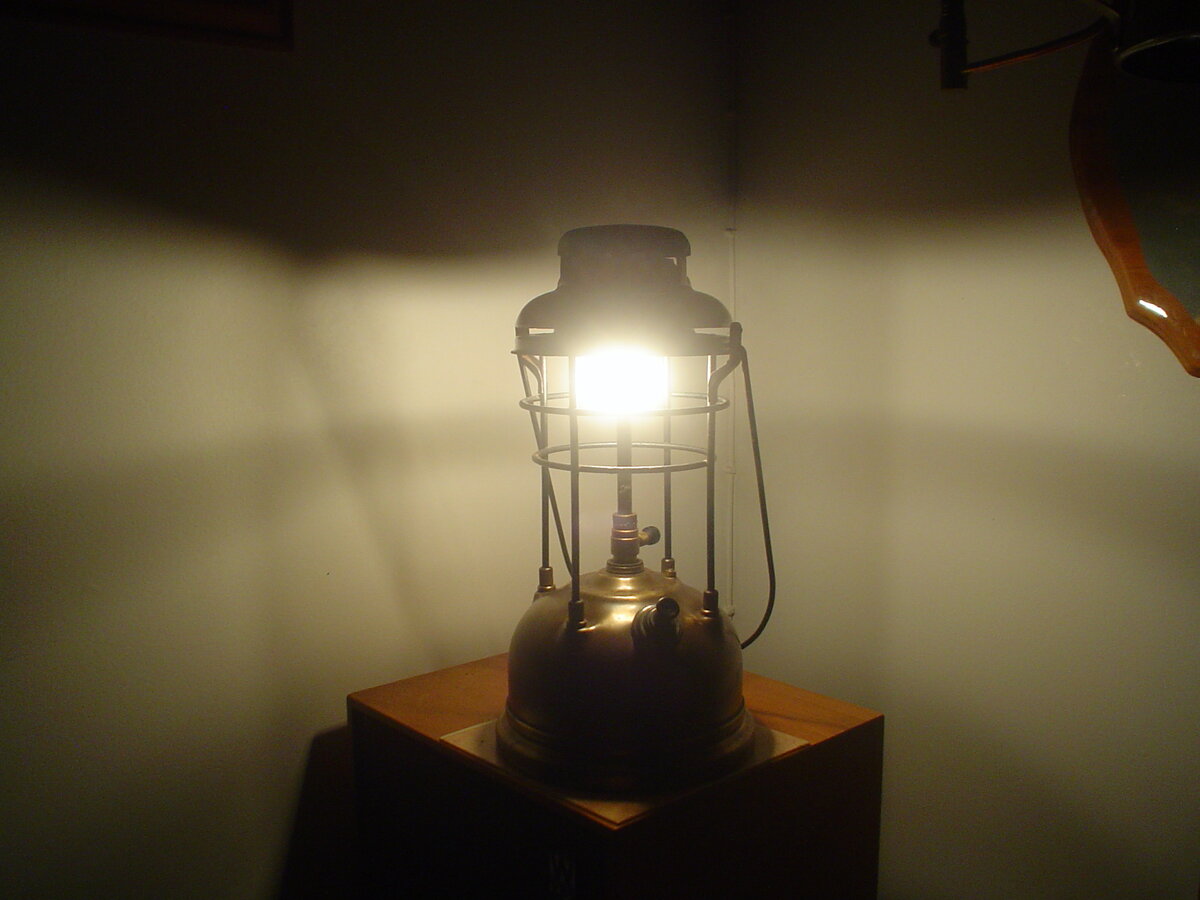

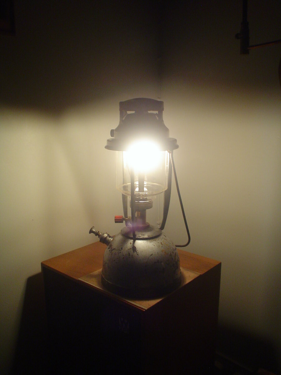

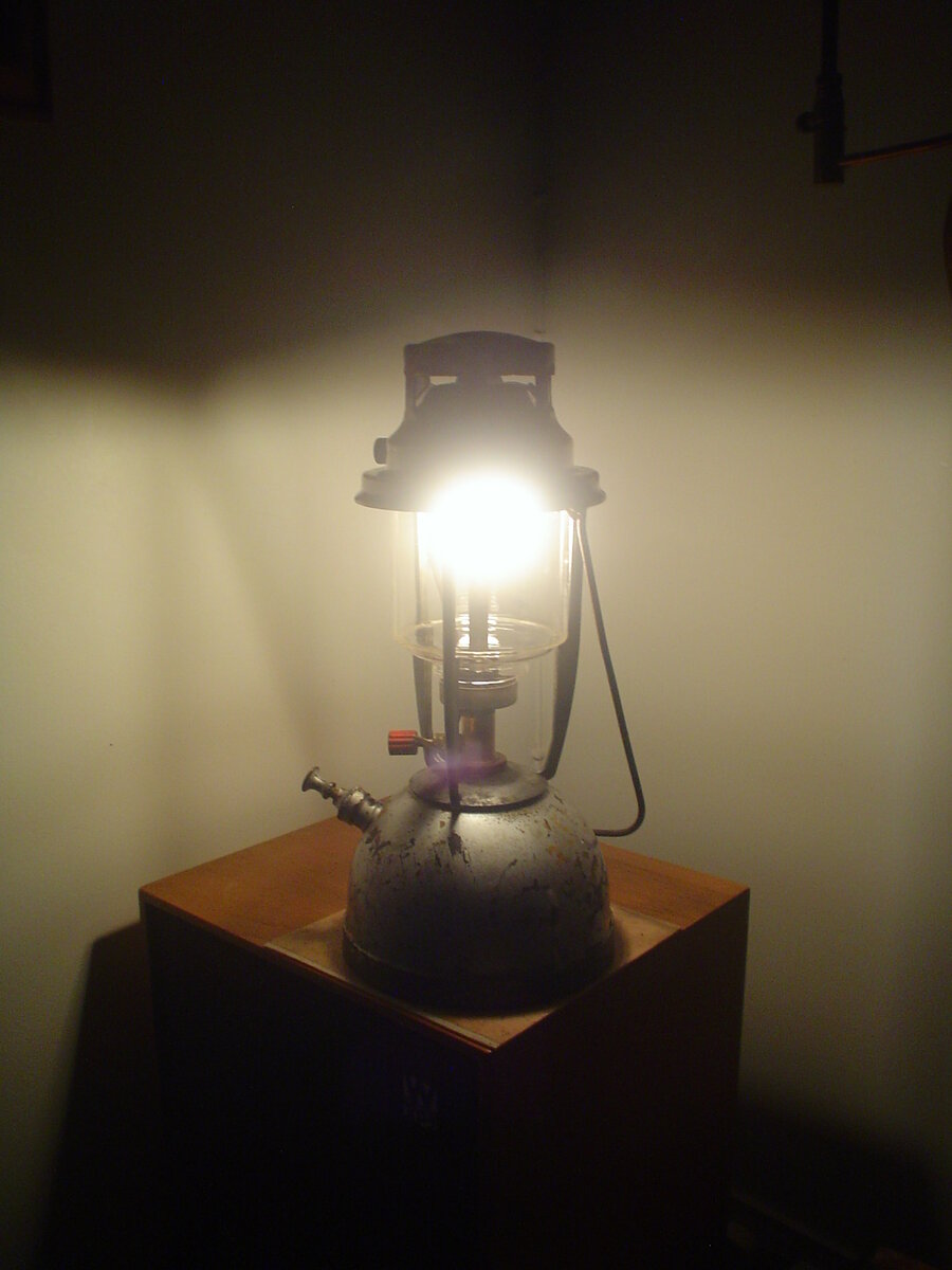

    Here is the first of the two Guardsman lanterns lit, I tested it without a glass fitted because the mantle has a small hole in it and those holes create a hot spot on the glass which causes the glass to break.

  20. JEFF JOHNSON
    16,893
    Hello Brian, I'm glad that this topic is of interest to you and the main reason for lighting that lantern was to test the burner, it appears to be a 1950's burner which has not been used much and those are becoming scarce, it was in such fine condition that I was able to completely dismantle it, there was very little muck on it but I cleaned it thoroughly anyway.
    It will be quite a while before I post photos of the second Guardsman lantern, it's from the early 1950's and it has a plated tank, but it requires a lot of TLC., and it's to cold to be in the shed for long just now and it's the same for the Hipolito lantern.

    Shame about the mantle but everything else looks ok Jeff? :thumbup:
  24. JEFF JOHNSON
    16,893
    The mantle is an old Veritas branded Tilley mantle and it was crumpled up in the packet which did not do it any good, but apart from the small hole it worked well and as I mentioned previously the main reason for lighting that lantern was to test the burner and it worked well.:thumbup:

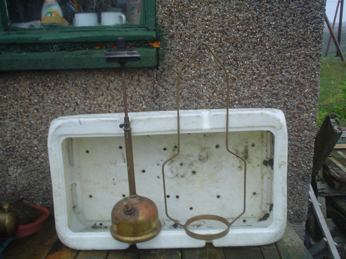

  25. JEFF JOHNSON
    16,893

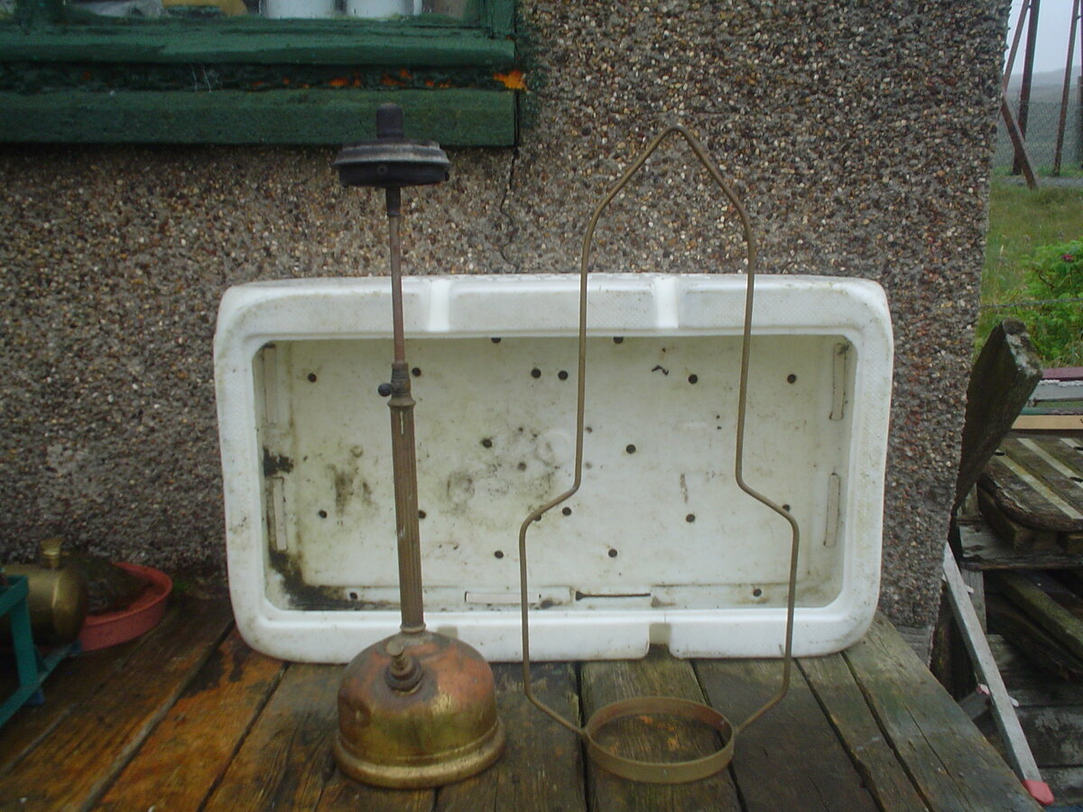

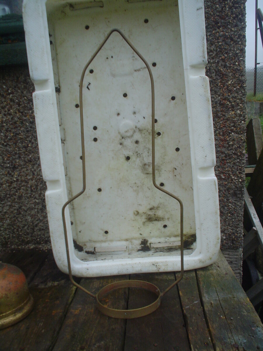

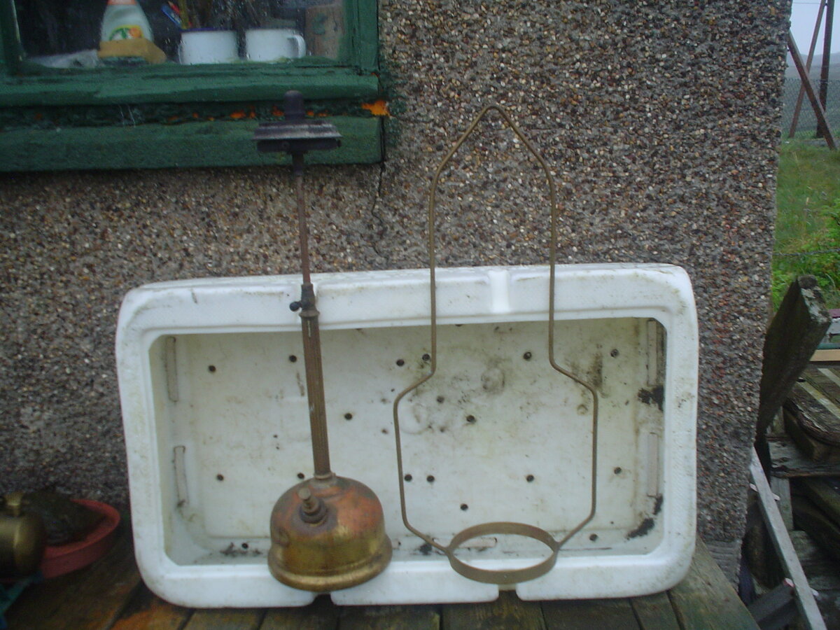

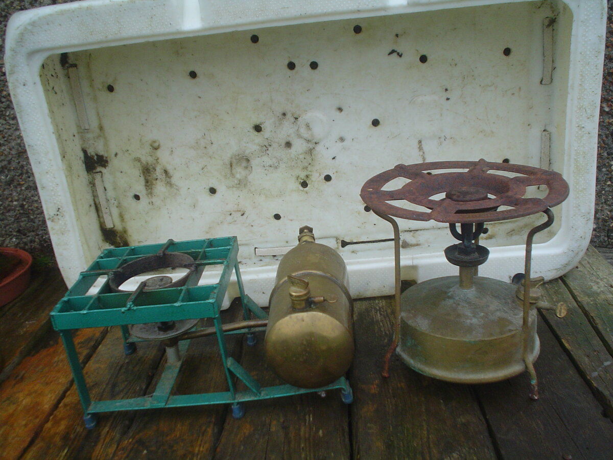

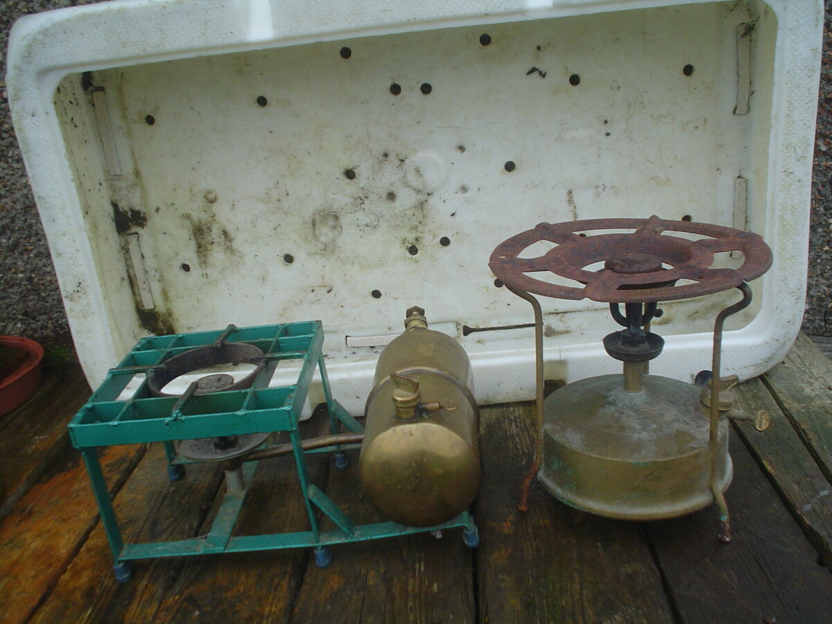

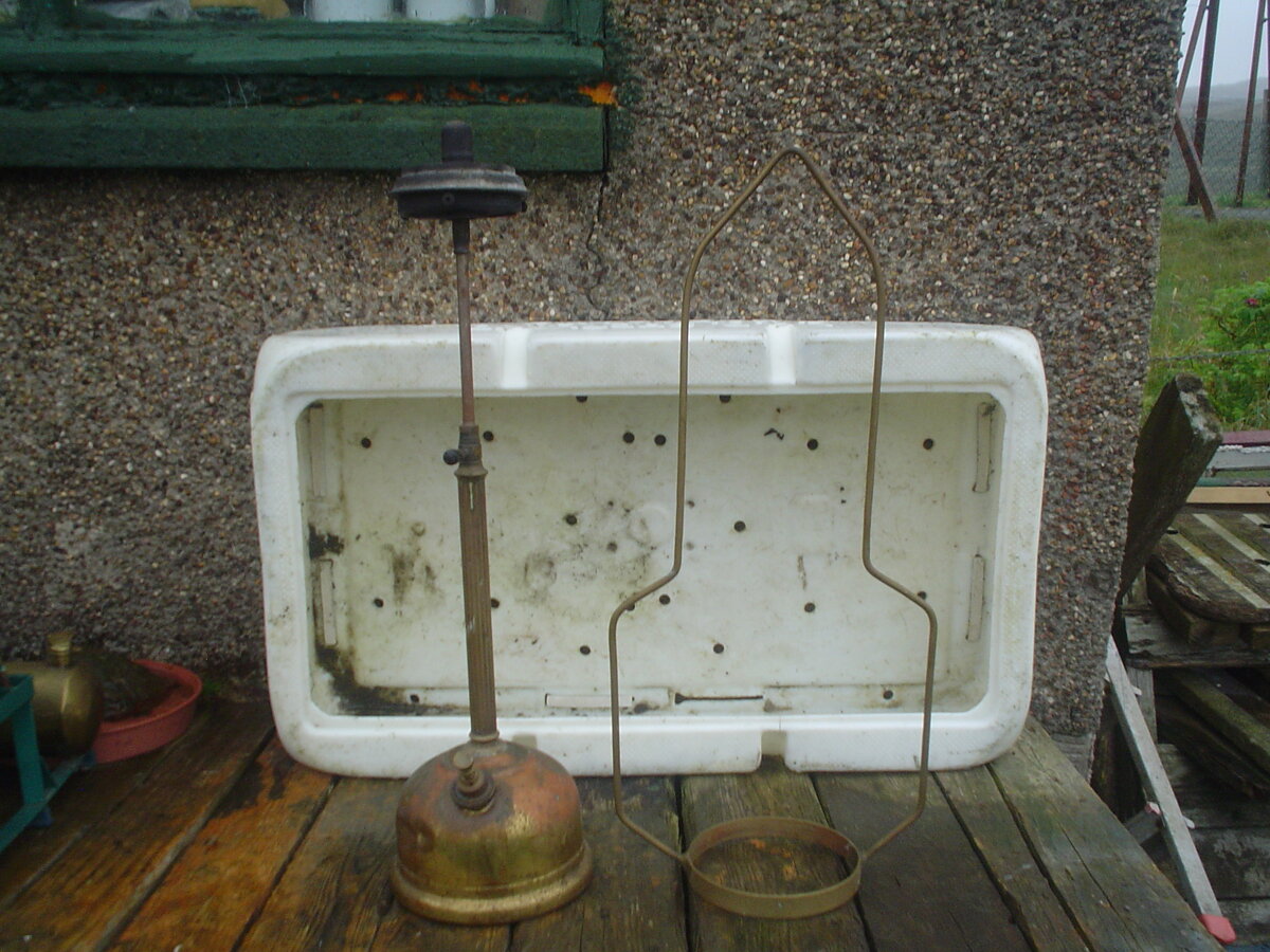

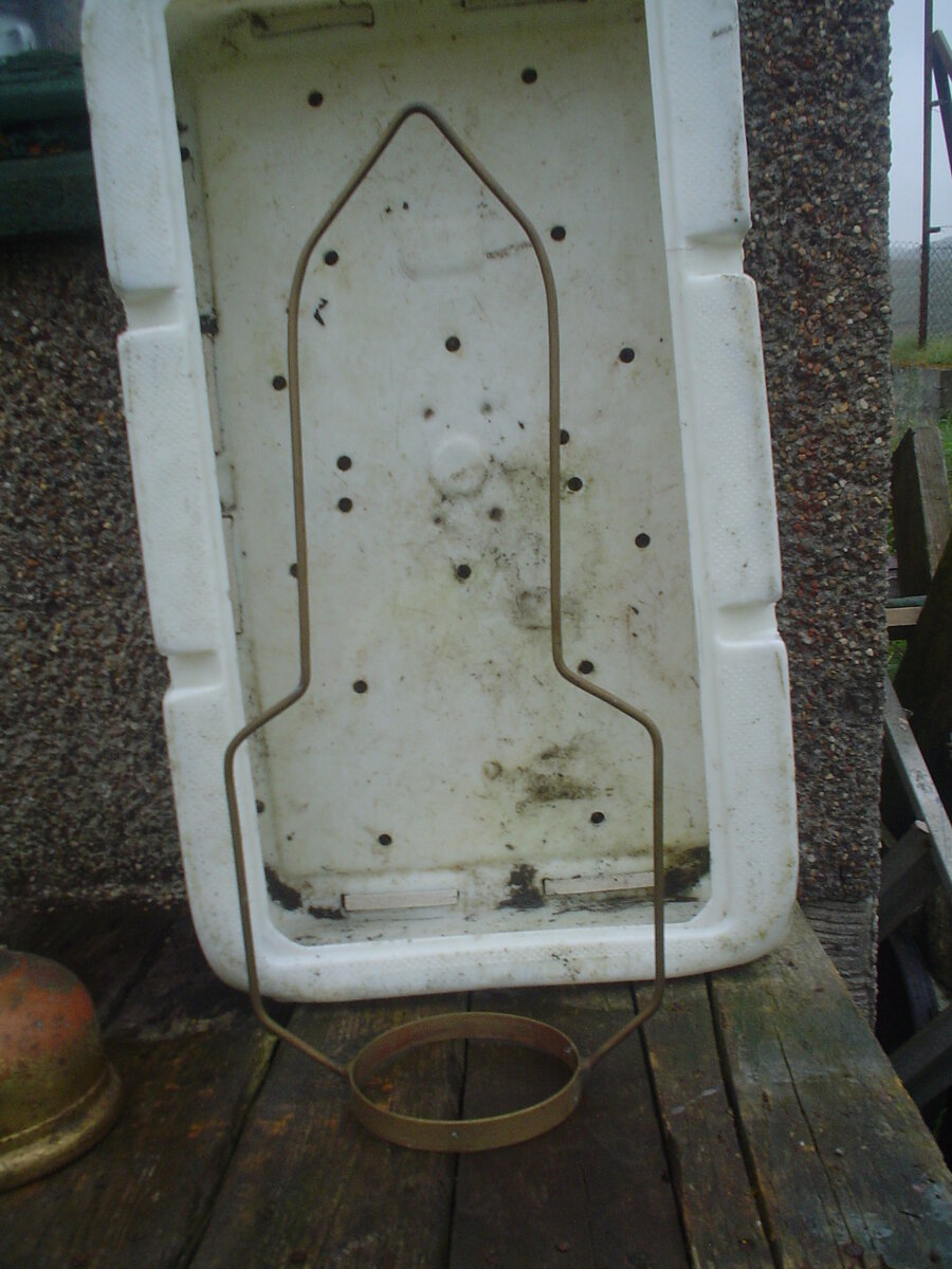

    These images show today's haul.
    One stove is of Indian manufacture and it will require some fettling, the other stove is a Burmos.
    The TL-10 is from the 1930's, but the original XN control cock has been replaced with a GF., control cock.
    The hanger is made from brass, but it's not a Tilley hanger, however, a Tilley ML., tank fits perfectly.

  27. JEFF JOHNSON
    16,893
    Hello Martin, I enjoy the fettling and I now have a hanger for the Tilley ML., tank which is shown via this link.
    Junk shop finds.

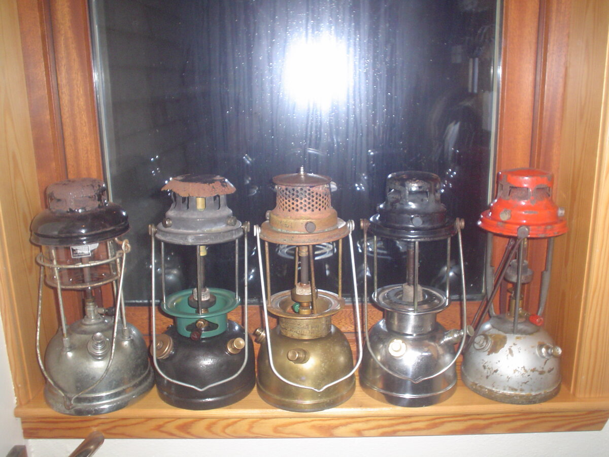

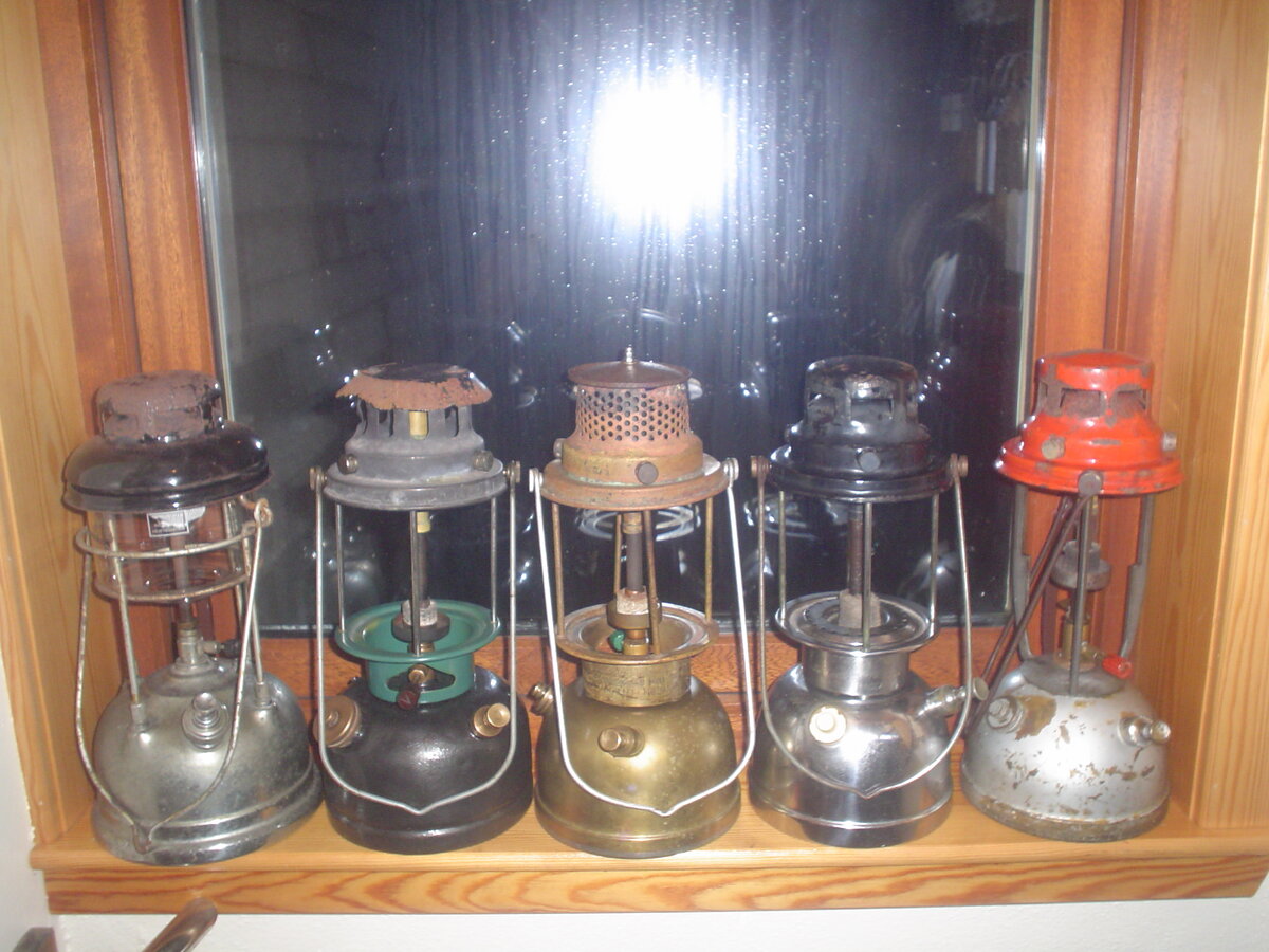

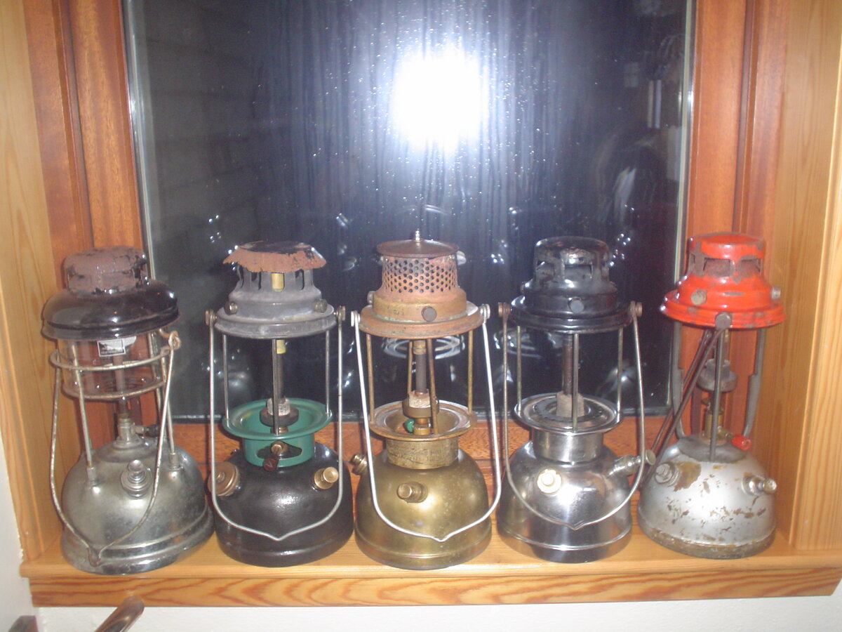

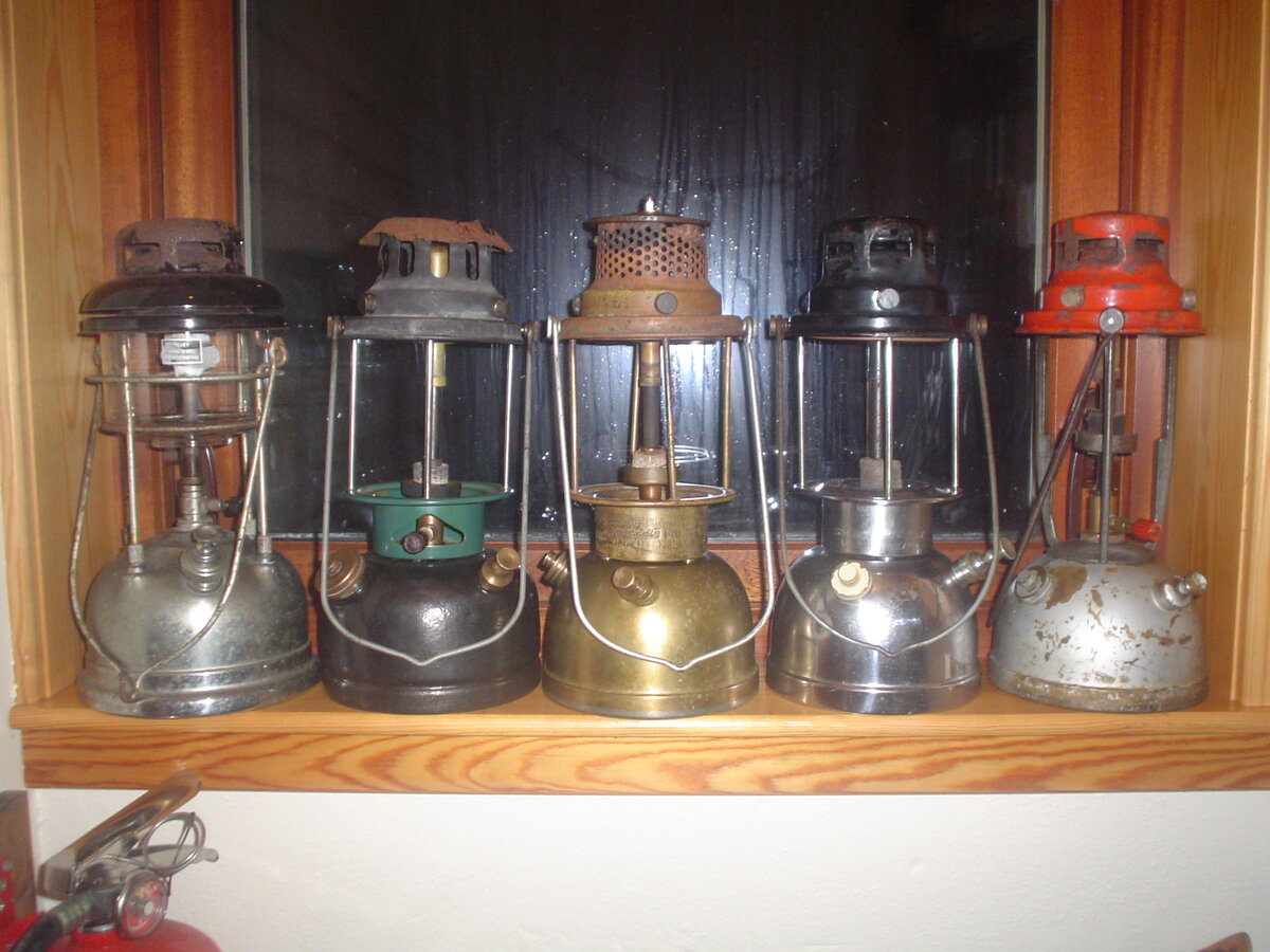

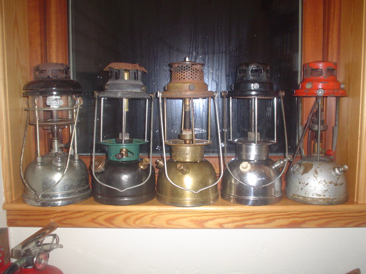

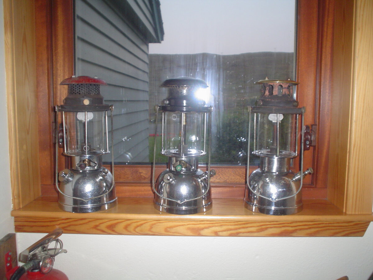

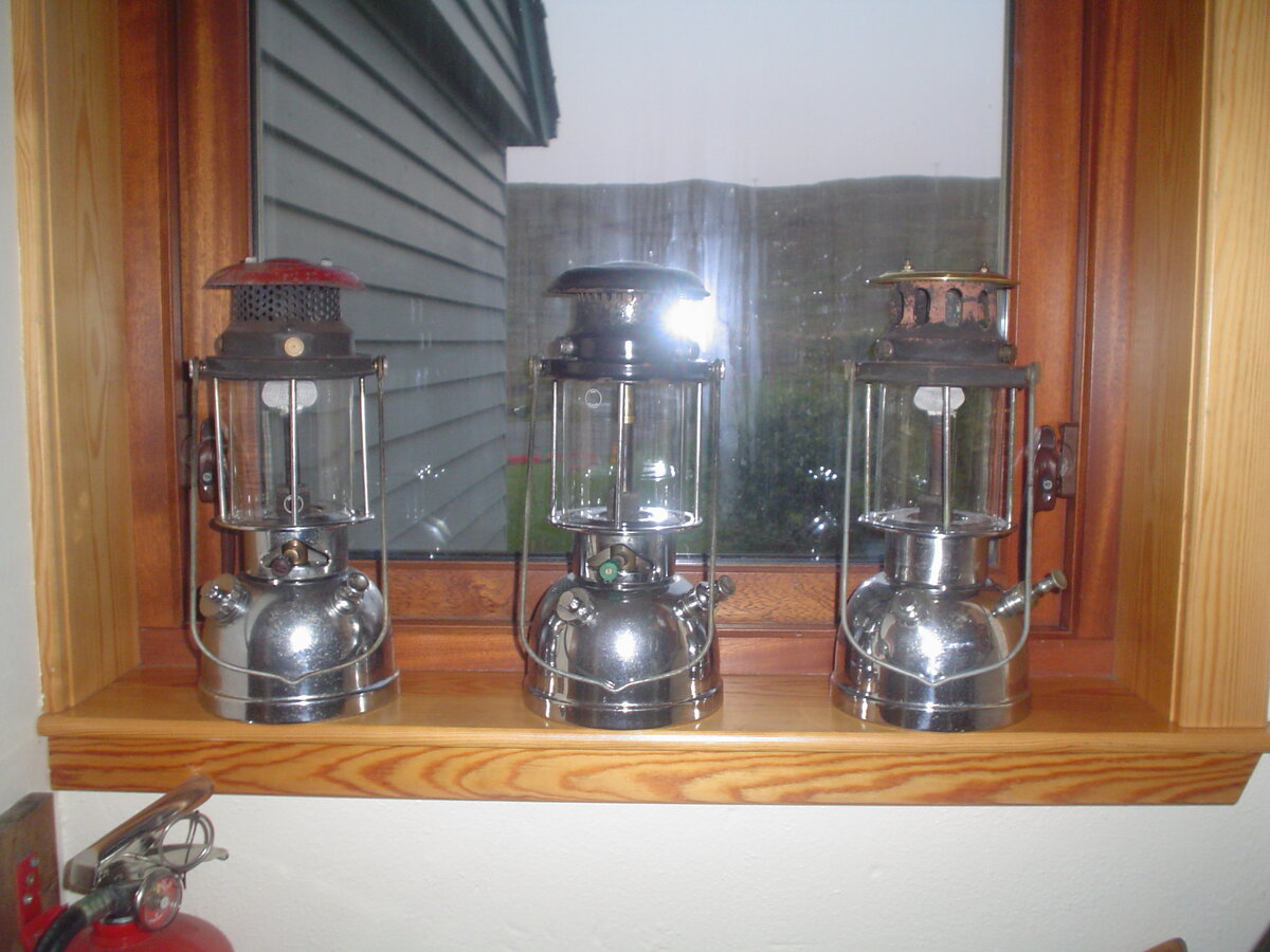

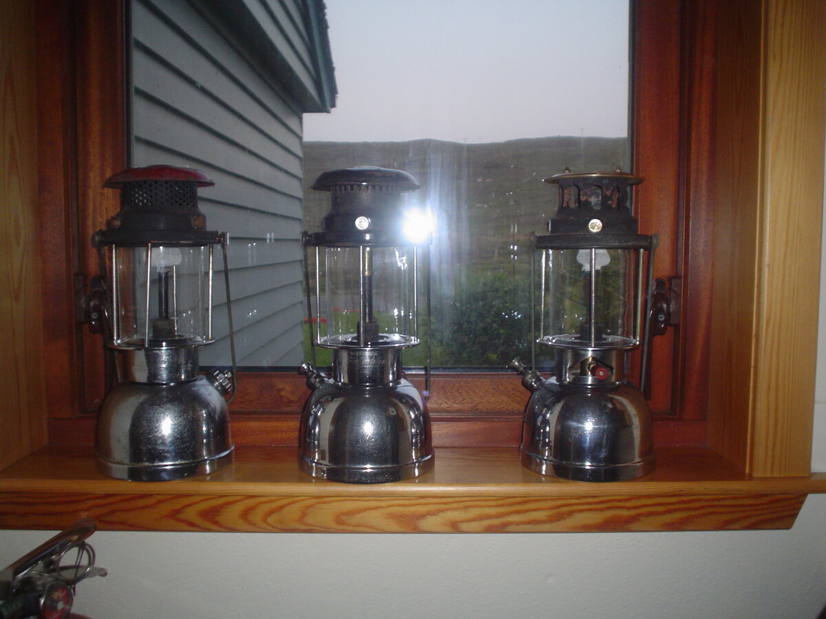

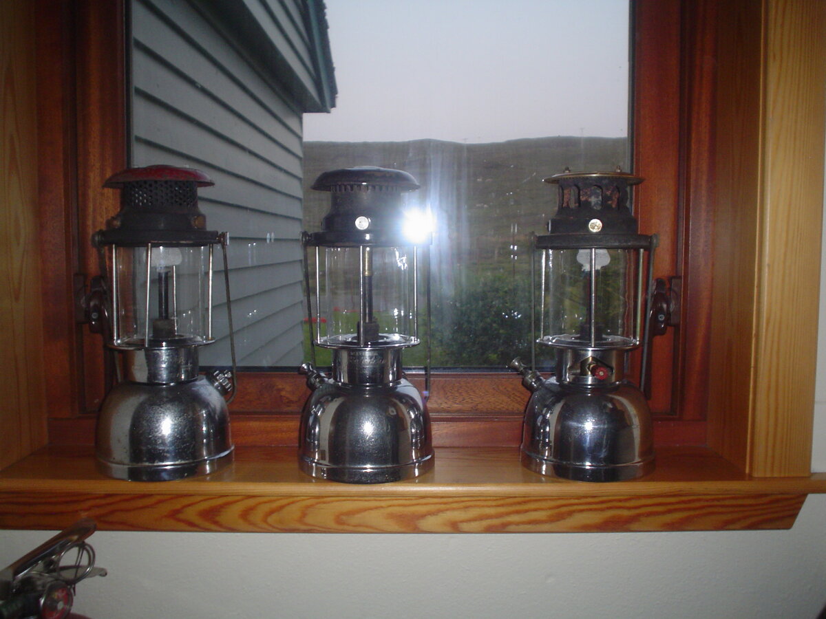

    These images show a project which I have been slowly working on for several months.
    These shiny lanterns are from left to right, a Bialaddin 300X, a Bialaddin 305, and a bitsa lantern which consists of a Bialaddin 305 tank, the collar is from a Bialaddin 300X and the cage is made up from various spare parts and I fitted a brass dish to the top of the hood because the steel top was knackered.
    Hopefully I shall light up all three lanterns later in the year.
  30. JEFF JOHNSON
