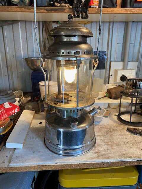

    Well Sands sent me a new pricker to suit my Aladdin A1. It needed a little grinding off the thread so it would sit low enough in the jet. Got that OK, but even though it sticks up above the jet orifice about 1mm, it still 'floods' even when the needle is fully up. Seems to me either the pricker wire is too fine, or the jet is too big. So typically I'll get a little stream of kero out of the jet even though the needle is fully up. Booga!
  6. Tony Press
    @Julian Whittaker
    What do you mean, “floods”?
    If you mean the jet still emits kerosene with the pricker up, it’s normal. The pricker in an Aladdin 1A is not a shut-off.
  7. Tony Press
    Woops! Radius 119. But the same applies.
    In a thread here recently I noted that NOS Radius 119 pricker wires are slightly larger in diameter to NOS Aladdin 1A prickers. That shouldn’t matter in your case, though.
  8. Julian Whittaker
    Dec 9, 2021
    288
    Greendale Vic
    Thanks Tony, yes I observed it 'nekkid', and saw a fine jet of kero even with the needle full up which I (obviously incorrectly) assumed was too much kero.
    I did a quick test without mantle, and got nice blue jets, but it was accompanied by some yellow flame above.
    I'll now put a mantle on it and see how she runs.

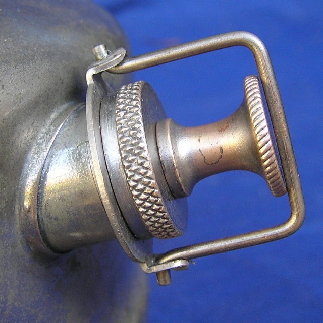

    The older Radius 119 variant has the same position as the A1, high up on the rim of the tank, and that's the model the Aladdin A1 was based up on.

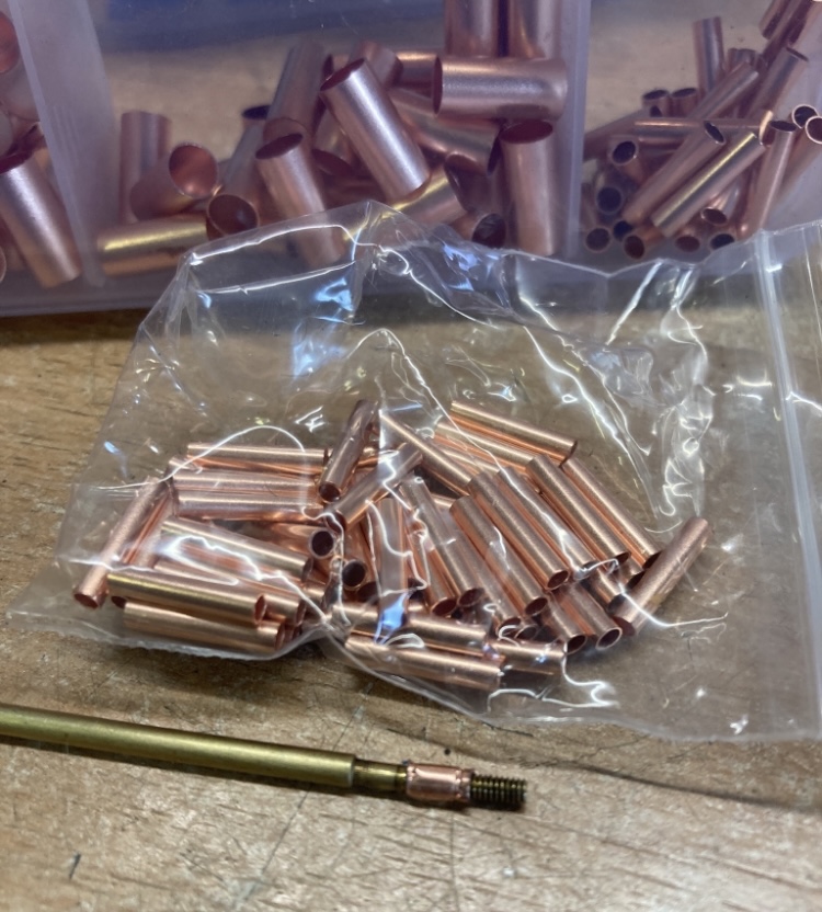

    I’ve had success with copper electrical crimps for cleaning needle repairs, one fine crimp for joining two broken ends and/or two inside each other to create a base block at the bottom of the needle.

    Well, success! (though with slight reservations). It's not that bright, but usable, -I'll check it tonight. The pricker doesn't shut it down, it 'almost' shuts it down but not fully. I'd have to purge tank pressure to stop it I think. It did have a very small yellow flame coming from just around the centre nut that screws to the fount. I'll see if that persists.
    Good to see it running anyway.
    Thanks for your help lads.
    Ooh, just out of interest I measured my new pricker wire at 0.13mm. Perhaps a little thin? (Though how accurate the vernier gauge is down to hundredths of a mm I don't know).

    I spoke too soon. Upon relighting it, it gave nothing more than a dull orange glow. Ah well back to the DB!
  14. Julian Whittaker
    Dec 9, 2021
    288
    Greendale Vic
    Found the problem... the filler cap seal was ancient and over compressed, so I think it was losing pressure, I put an o-ring in and it ran okay for a couple of hours, so maybe it's a user.

  16. X246A
    1,240
    Norfolk, England
    @Scott D
    CCT crimp repair sounds interesting, any chance of a photograph or two please?
    Regards, Jeremy

    Just to add a bit more detail to the design timeline. The Aladdin 12A was the same as the pre 1934 Radius 119 (Radius made all the Aladdin 12A and 14A models). This had the higher positioned pump and the winged filler cap with pressure release etc. The Aladdin 1A was based on the 12A but simplified some parts.
  19. Scott D
    Aug 10, 2020
    756
    Yorkshire, UK
    @X246A - I’ve used them a couple of times now with success but could only find this one photo.
  20. X246A
    1,240
    Norfolk, England
    @Scott D
    Thanks, looks like a good workable solution for someone like me who neither has the skills or machinery and tooling to turn new parts.
    Regards, Jeremy
  21. Scott D
    Aug 10, 2020
    756
    Yorkshire, UK
    Yep, same reason I have to get creative. Not sure I could fit a lathe in the garage anyway!

    What diameter are they?... These are the 'crimps' I assume, I can't seem to get scale. Also DuBro brass tubing comes in a useful range of sizes (at your local Model Shop - if they still exist!)
